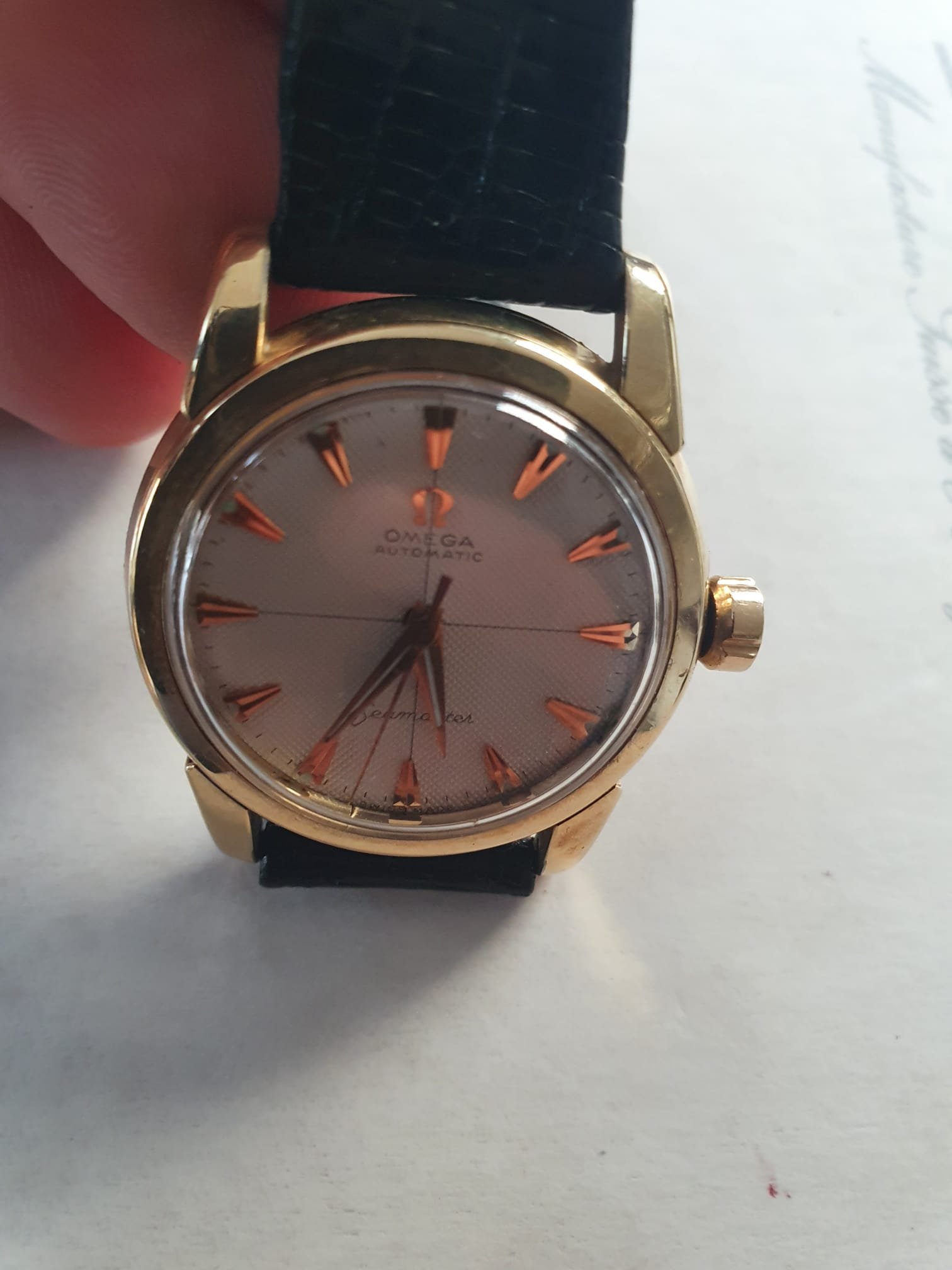

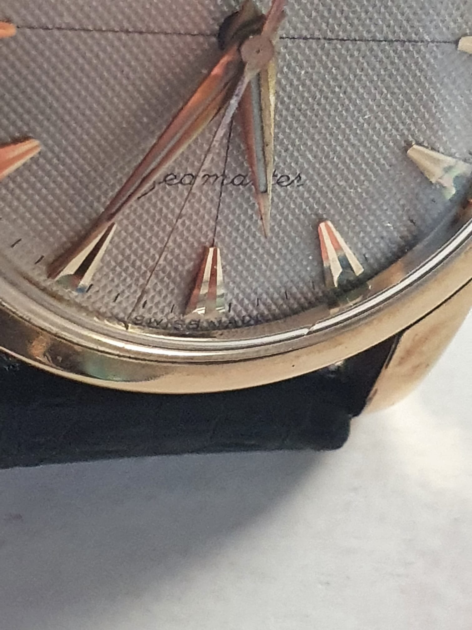

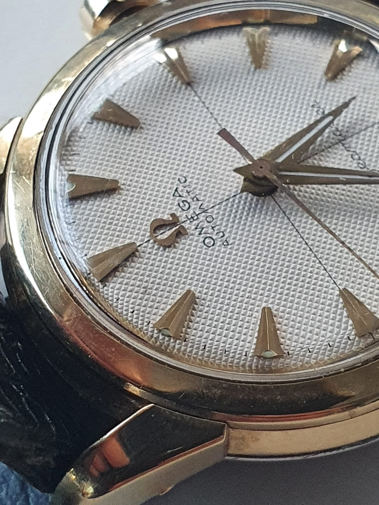

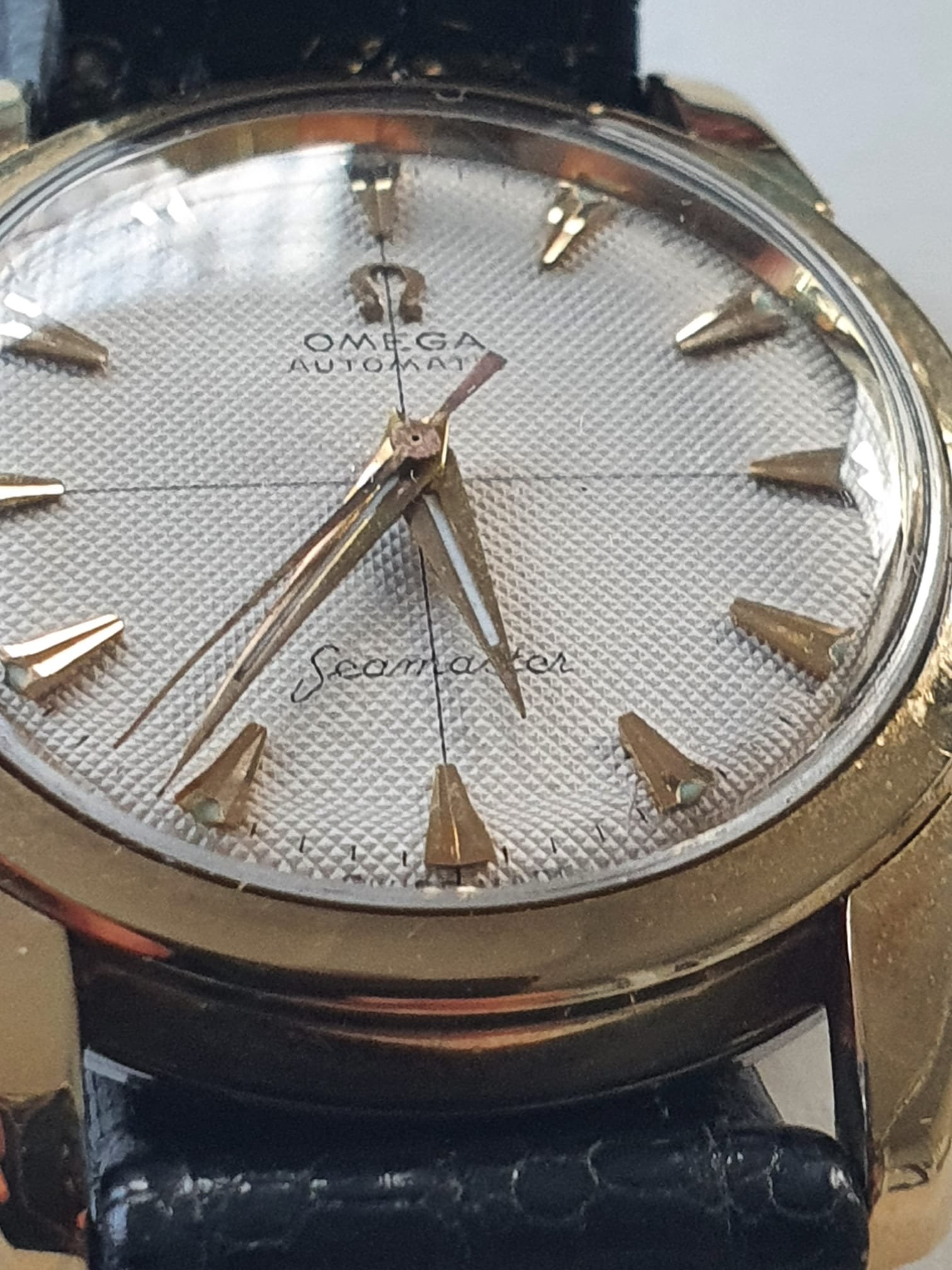

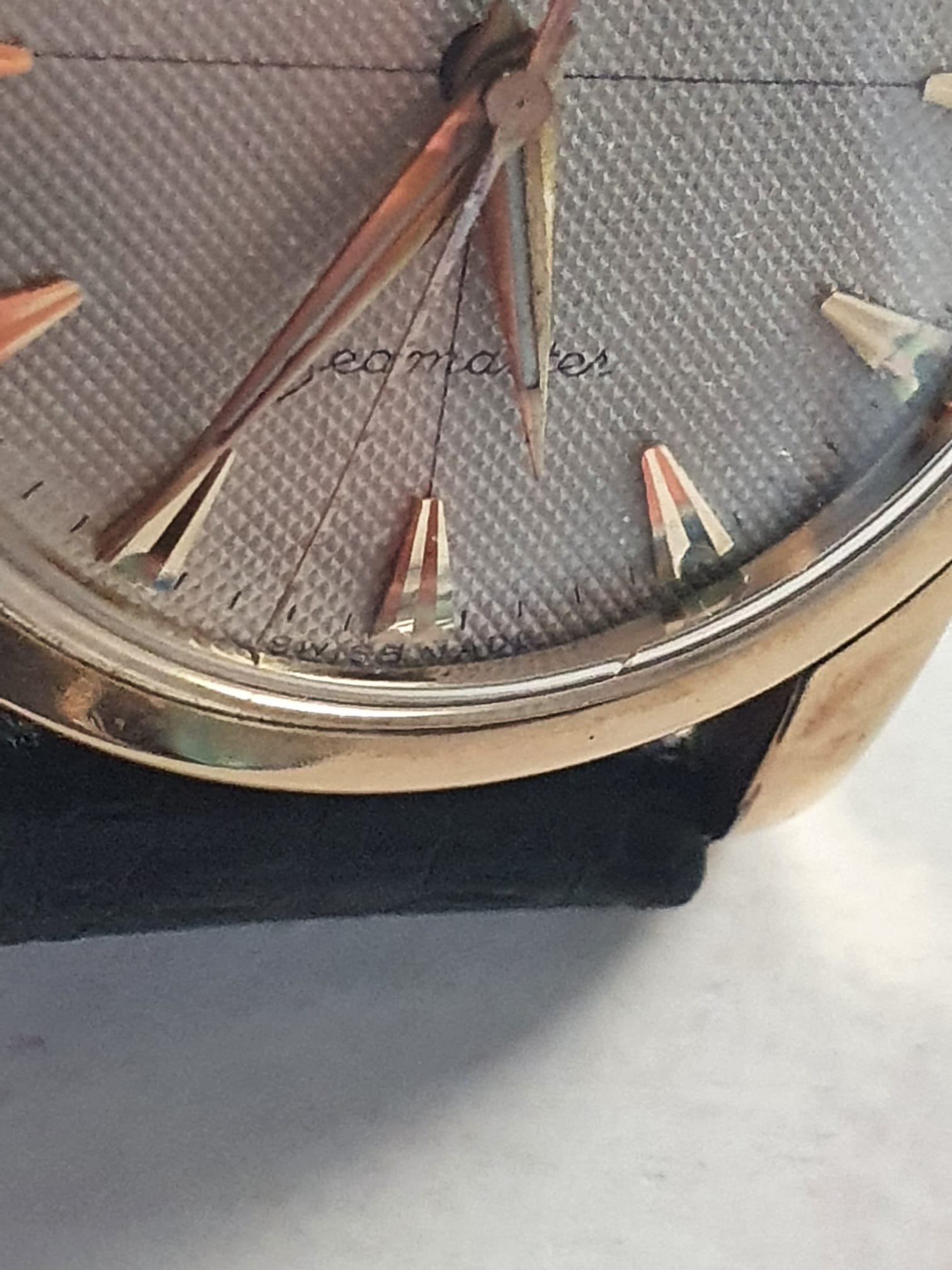

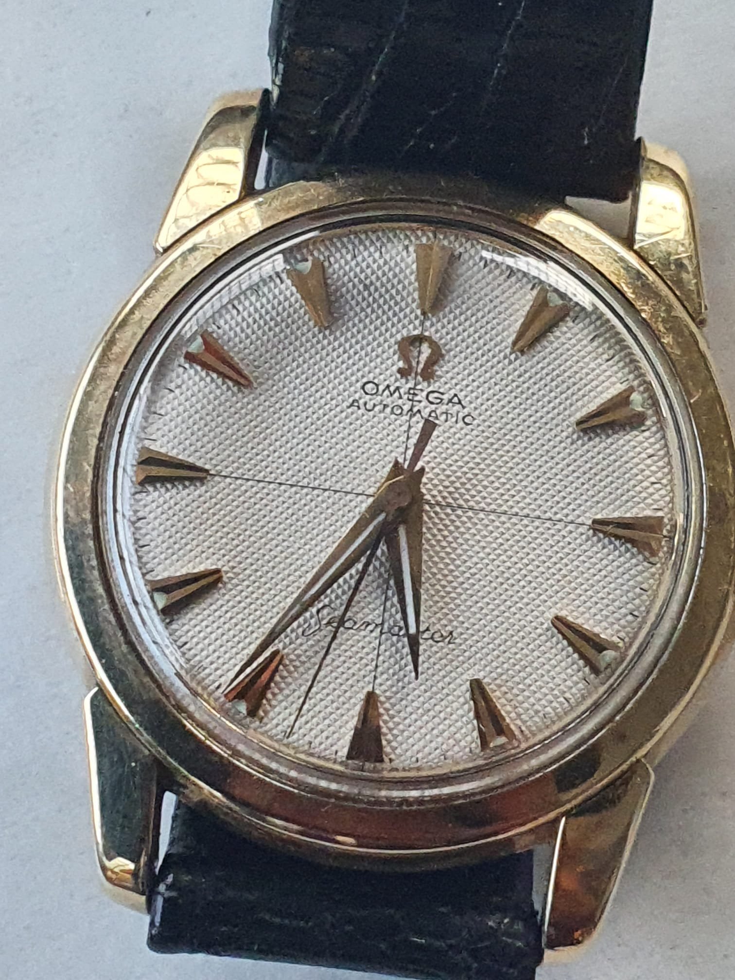

Good evening. I ask for help regarding this omega seamaster 50's. In your opinion is the dial original? Is it gold capped or plated?
Thanks in advance to those who will give their input.
1,178
2,464
It’s gold capped and the dial looks original. It’s been relumed however and crown/stem is damaged.

Thank you for your quick reply. What do you think is a fair price?

As a seller or a buyer?
In either case, what’s the asking price?
9,251
77,029
As a buyer. Asking 850 US dollars
Others may disagree but I’m afraid that I think it’s overpriced - probably by at least $250-300.
You have to factor in a service, a new crown, lume removal and, despite the dial and hands looking good, you’re still left with a worn gold-capped 70 year old watch.
Unless you’re desperately in love with it, I’d keep on looking

My thoughts too, more like a $450-$500 watch. The cold cap top is not in great shape and the re-luming hurts value considerably.

It is a vintage omega seamaster and I like it precisely because it is over 70 years old. I don't understand why you say it needs a new crown?

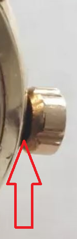

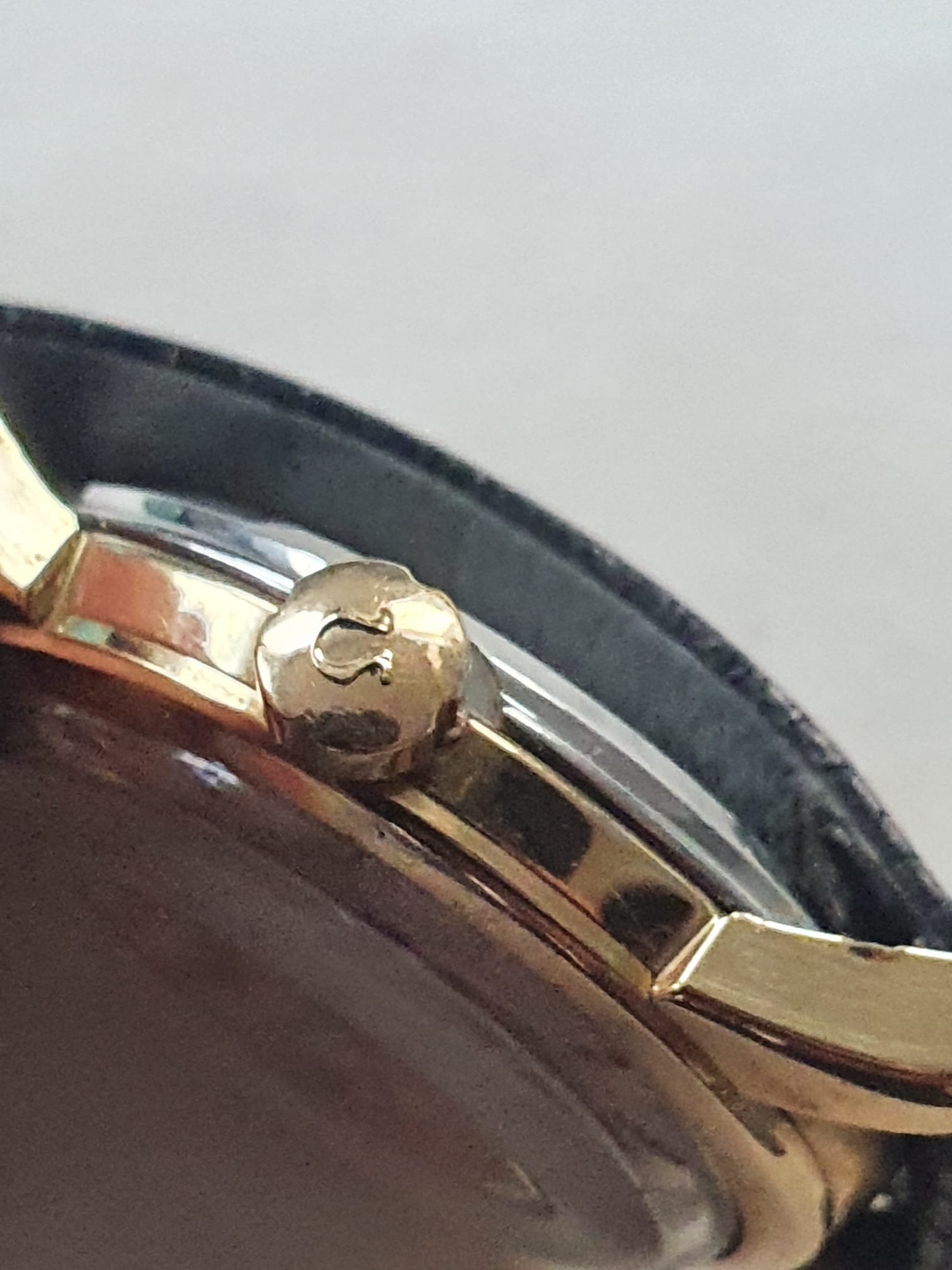

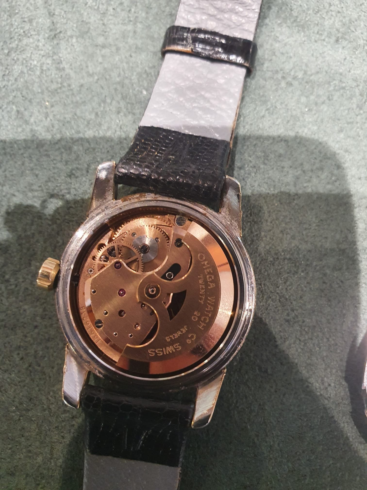

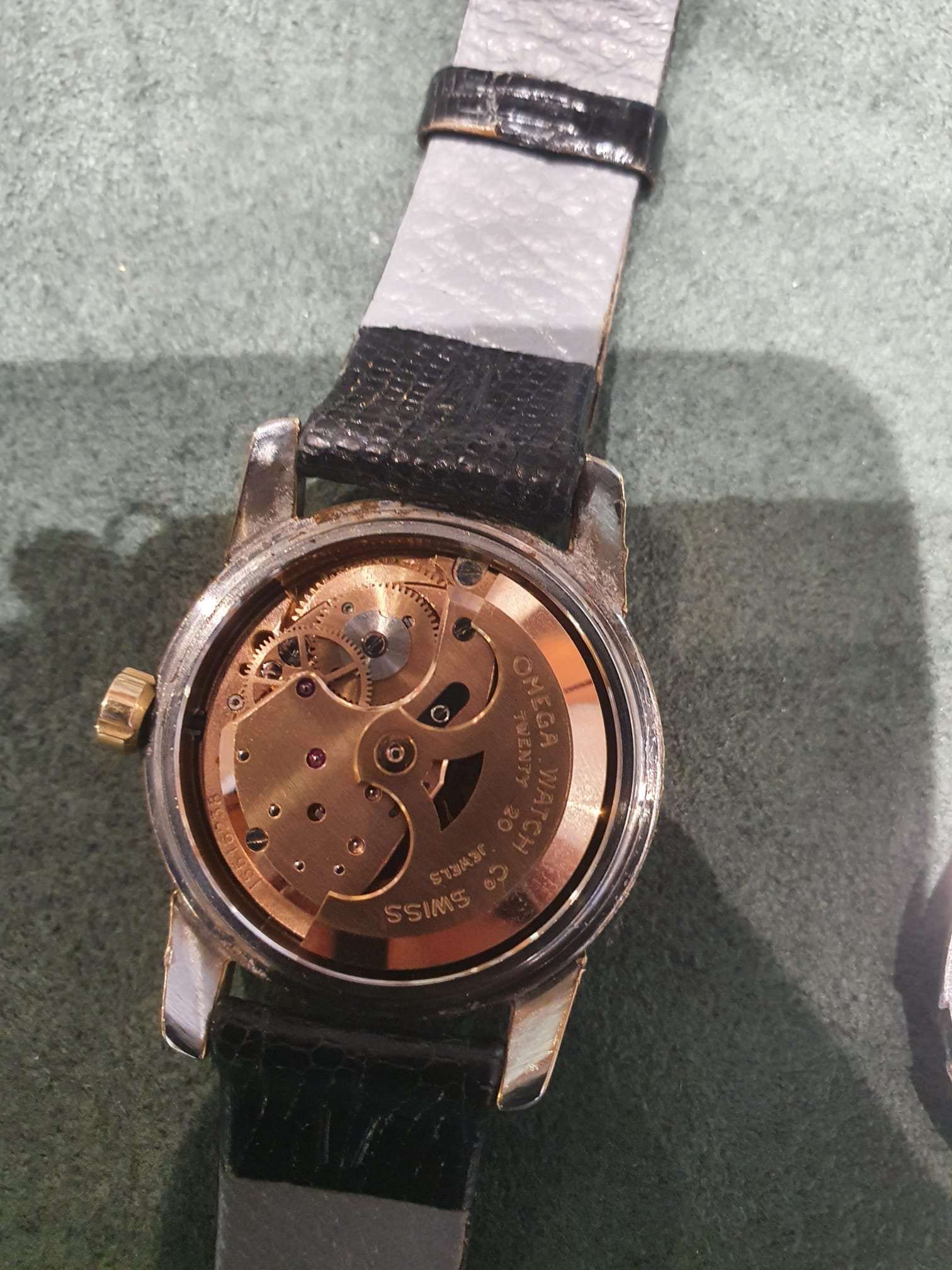

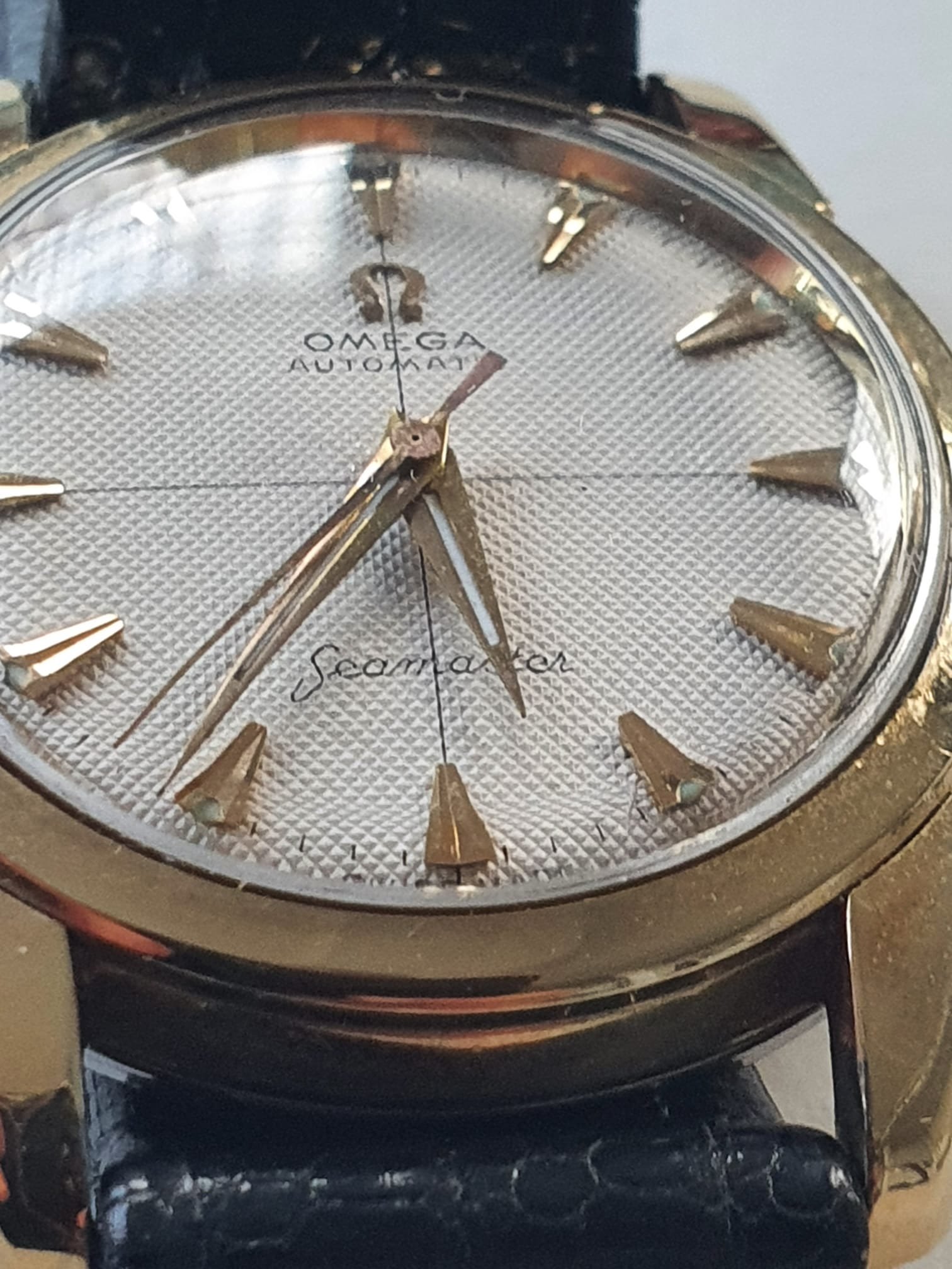

On the only photo you have posted, showing the crown (with the movement), it is crooked and appears to be a different colour.

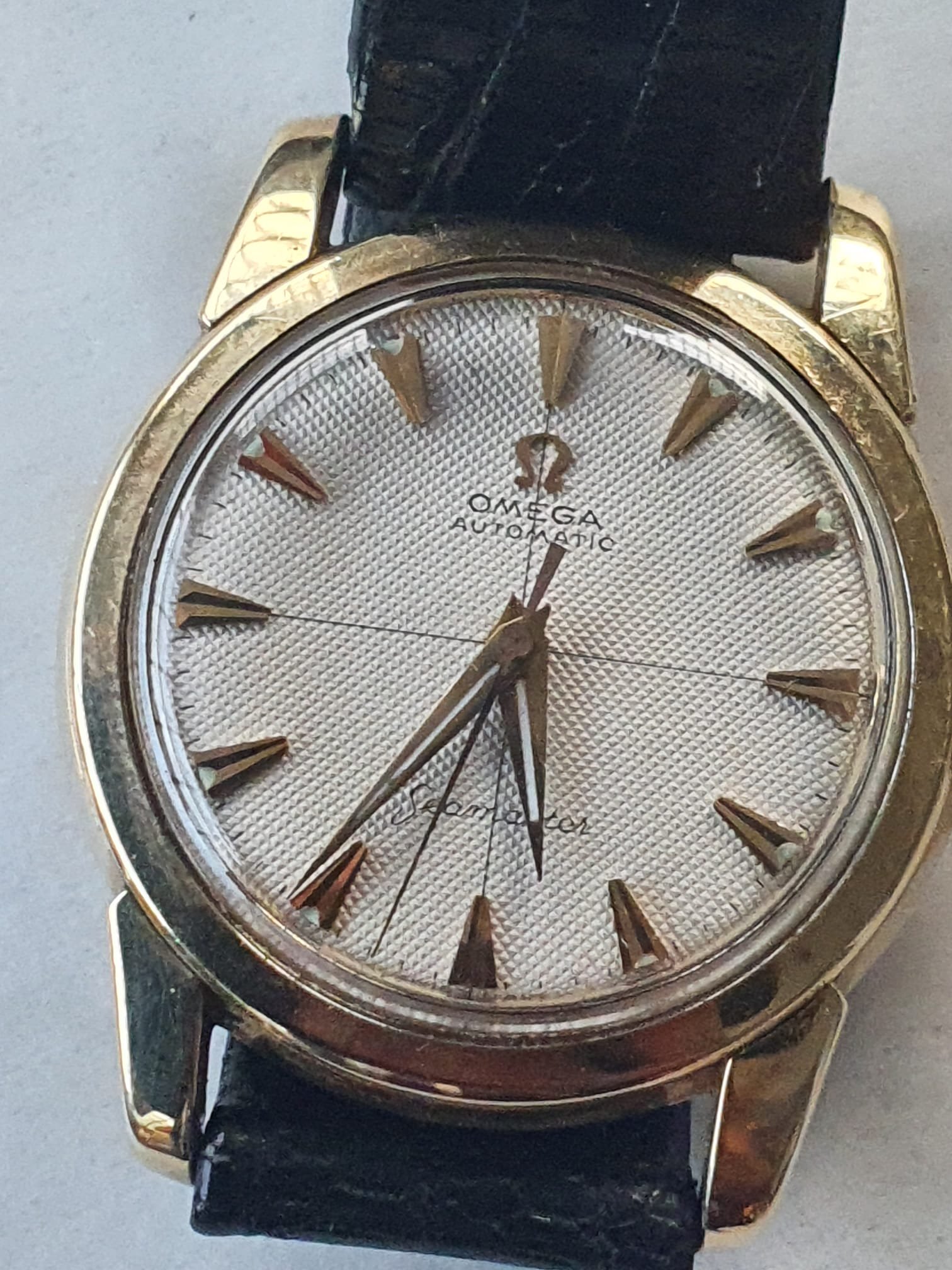

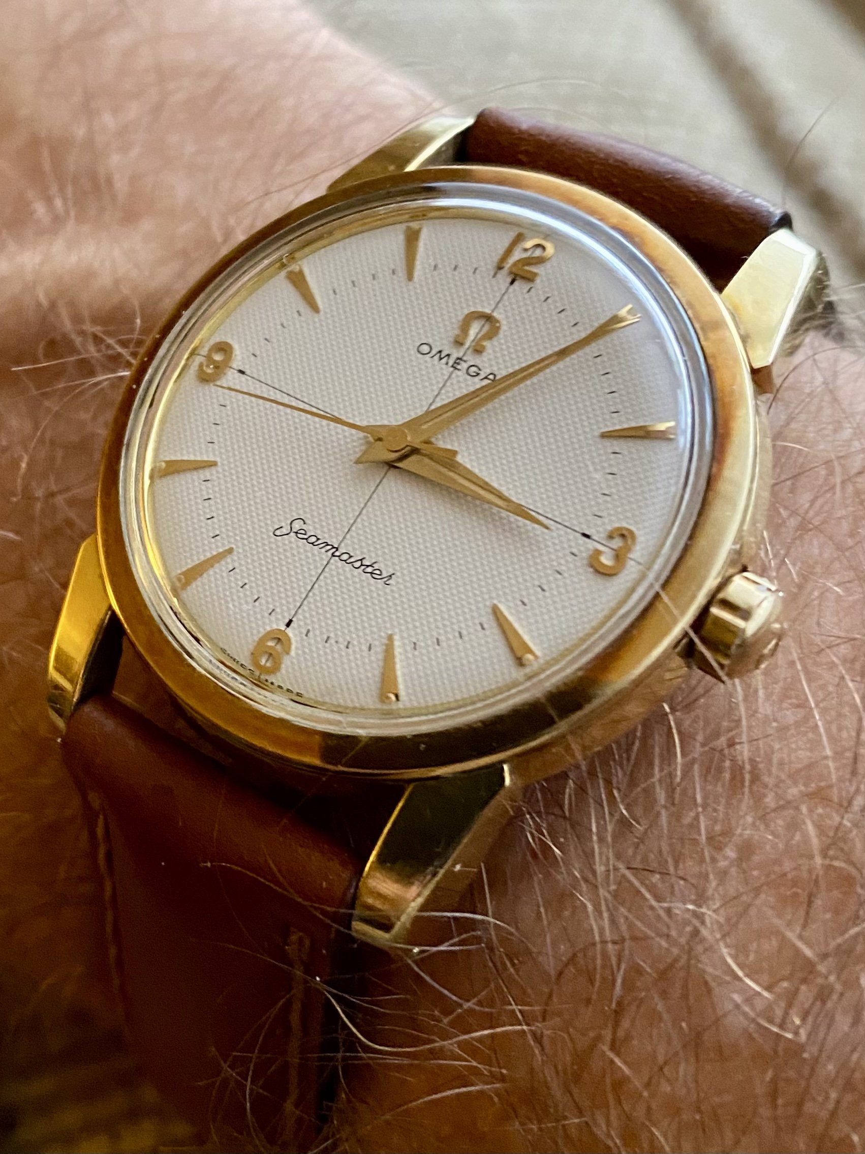

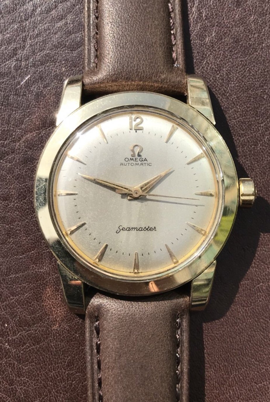

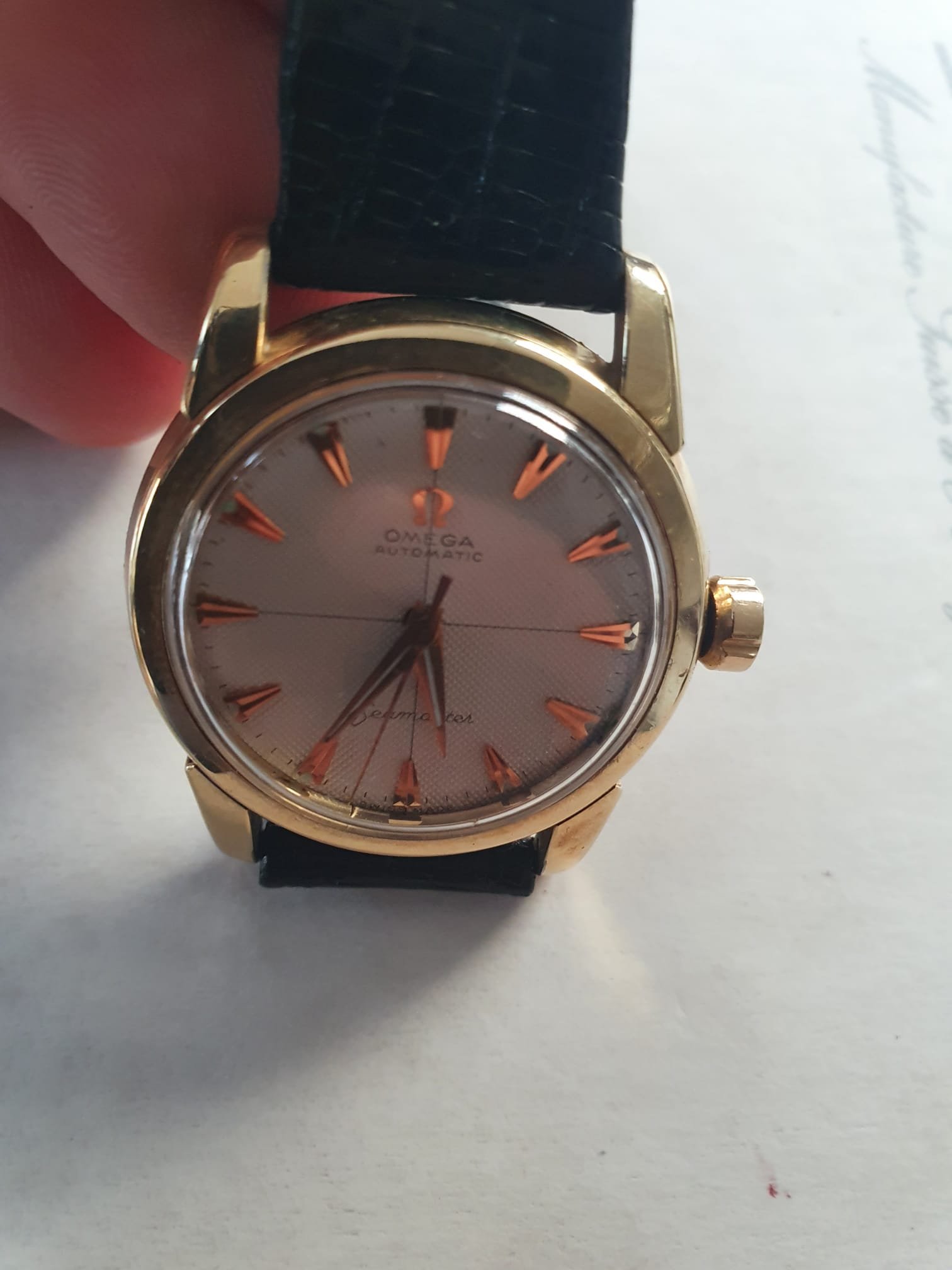

This is my 1954 Seamaster, correct crown, correct colour and on straight.

Might be worth a shot to negotiate lower given the crown stem and lume. It was going to need a service anyway. I like the dial.
Have the lume redone to match the indicie pips better.
Try for $500 no higher.
There is always another watch.

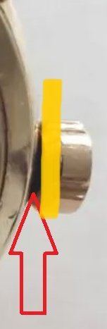

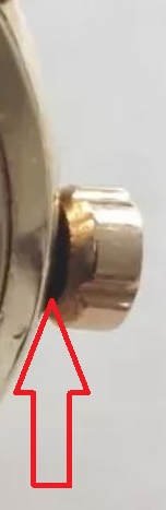

The area of concern is this gap. Either the crown, stem or case tube is bent. Or all of the above.

Excuse me, but why do you say too much work? My watchmaker takes very little time to fix the crown and I think with a good wash in the ultrasonic washing machine the case could be in very good condition. I agree the asking price is high but maybe on the $550 US I can get out of it

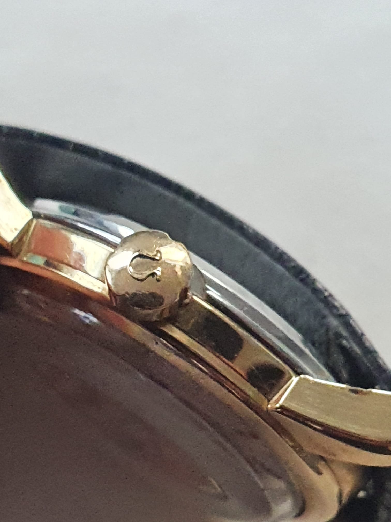

Still thinking it’s the wrong replacement crown plus all the above
60
8
Why do you say the crown is wrong? Can you please explain?

People are trying to help out because that’s what you requested 😀 the crooked crown is not a great symptom, and is something that needs to be addressed at a cost, the gold capping could be in a better shape, the re-luming is so obvious you probably want that fixed aswell. Add the standard cost of a service. I would probably pass, there are lots of these that pop up on eBay and on the forum’s watch selling thread (in way better condition to be fair), but if you’re confident, as it seems, about your watchmaker’s skills, cleaning processes and the overall pricing, and you really want it go for it 👍

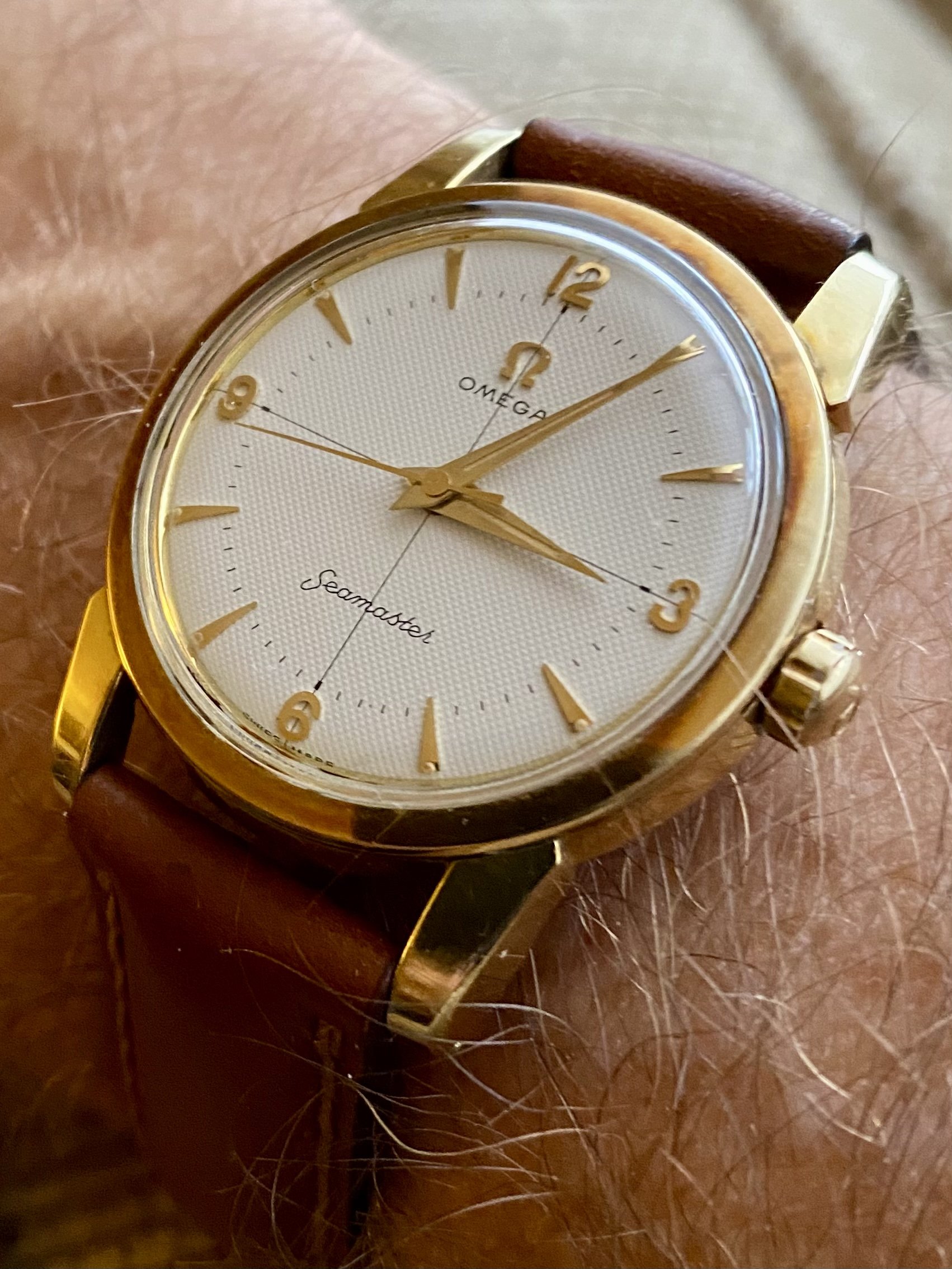

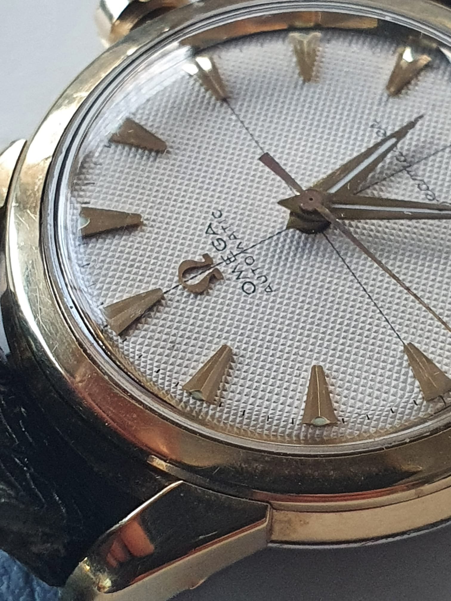

All of the issues have been mentioned. Damaged crown, gold cap in poor shape and the reluming work was poorly done. The service history is unknown, so you’ll also need to factor in the cost of a full service. This is not a rare reference. With a little patience you can find a much better example for comparable money. For example, here’s a 1956 Seamaster 2761 with a gold capped case and a perfect crosshair waffle dial that I purchased fully serviced from an eBay seller for less than the asking price on your watch.
The base of the crown (which I’ve obscured in yellow) has a conical section which is incorrect. It should sit flush against the case as does the one in my watch posted above
