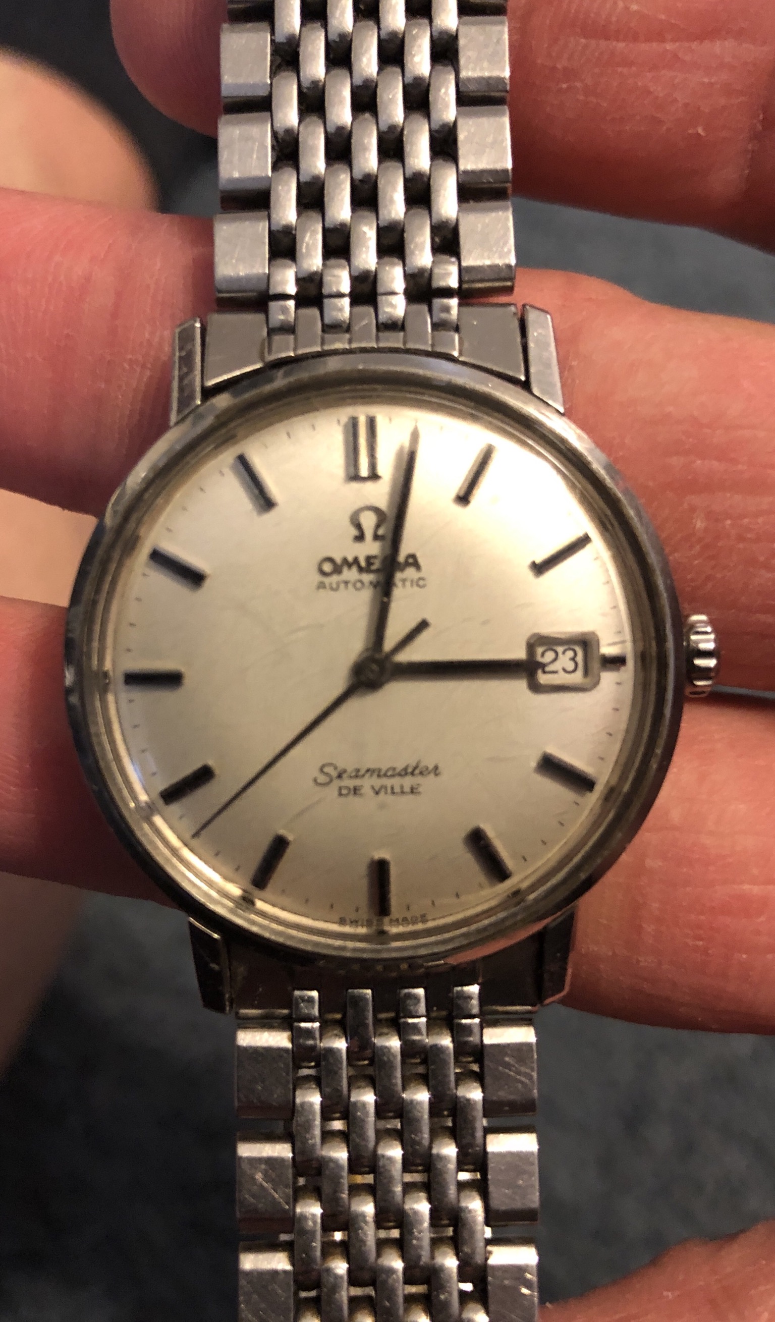

Hello Omega Forum!
New member here. Started going down a rabbit hole trying to learn about Seamaster De Ville’s.
As I’ve seen with other members, my interest began with a family members Omega watch.
Here is my Fathers auto De Ville.
I don’t know much about it other than he’s had it since brand new so say mid 1960’s right?
I like to tinker and have done some work on other watches with Seiko, Ronda, and ETA movements. I’ve never gone past swapping complete movements though. Maybe one day.

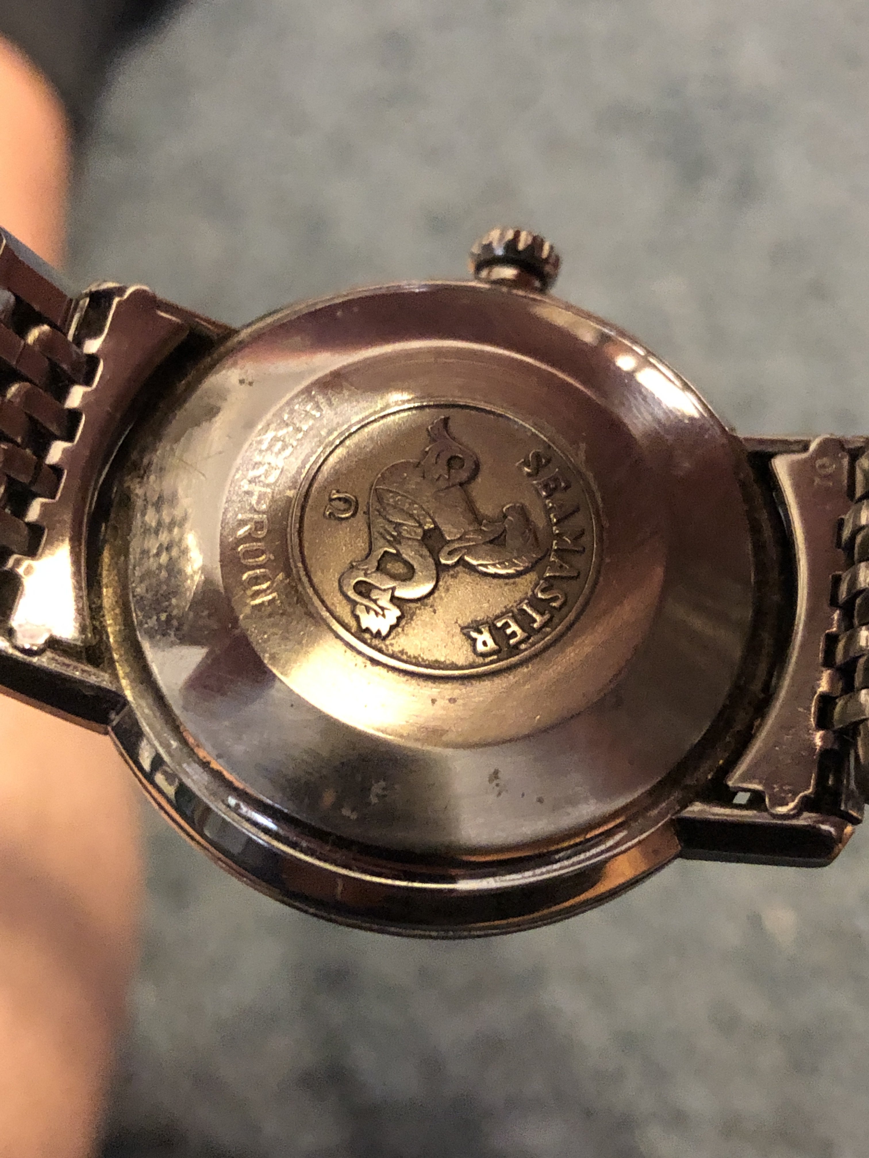

I’d like to give my Dad’s watch a good cleaning and am curious to open it up and identify the serial and case #.
I’ve seen reference to the Unishell where on one the crystal comes off with the bezel and on the other you need to remove the crystal with a tool and then reinstall with a press. Sorry if it’s been covered elsewhere, but how can you tell the difference?
I’ve got my eye on a Case ref 136.0010. When I search this model, it shows as a “press in case”. So that means this does require a crystal removal tool?

You are enjoying the hobby and that's good, but I would not suggest monkeying around with your dad's gorgeous vintage deville at all. It's too nice to experiment on.

I have a good friend who is very skilled at “tinkering” and can do a full tear down, cleaning and replacement of obviously worn parts. But he won’t go any further than crystal swaps and basic stuff on my Omega’s or Rolex’s because he doesn’t have a parts account and parts
/ replacement movements ain’t cheap- in essence, he can’t afford to make it whole again if he breaks it so he won’t do it.
Keep honing your skills on Seiko’s and Eta movements (vintage inexpensive mechanical watches are great to learn on), but send that one to a professional with a Swatchgroup parts account.
And yes, that one comes out through the front, you would need a crystal press with appropriate dies to get the bezel back in properly without cracking it, and that’s a gamble and they are not available.
