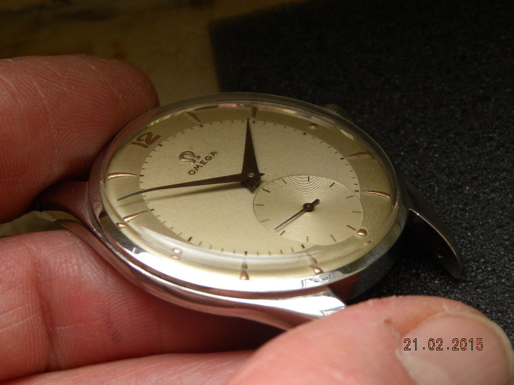

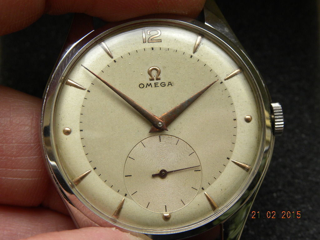

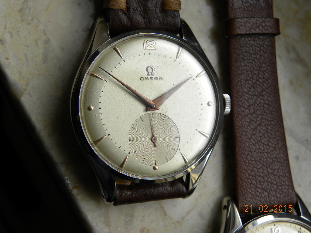

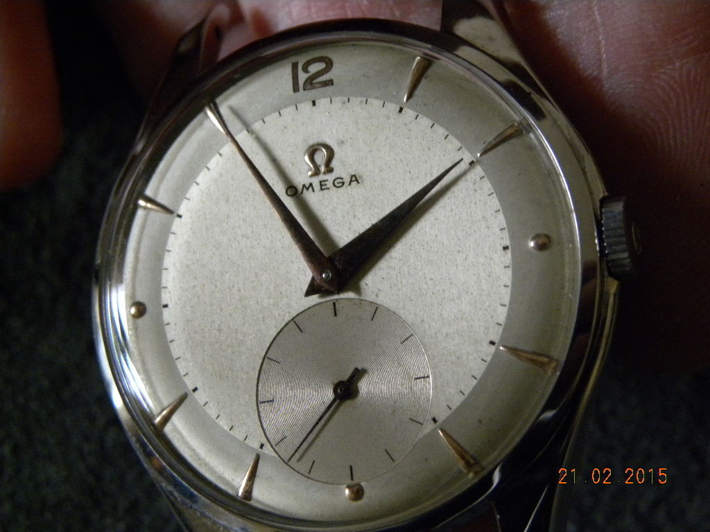

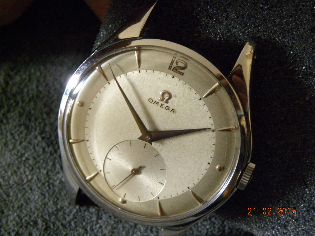

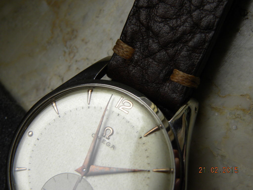

    Hello, new member seeking advise on this vintage Omega 265 in 2505 case. Wondering if this a redial or original, appreciate your input.

    Looks like an original dial to me.

    Ditto

    I'd say original and has been cleaned at some stage. A reasonable job was done, just a bit of shadow aound the Omega letters.
    We need @hoipolloi to ejudicate on the hands though :D

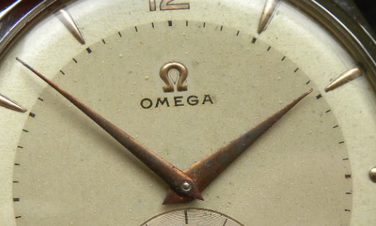

    I've been quietly playing "is it a redial" and seeing if I agree with the experts. I haven't been scoring very high, I'm afraid. I thought redial on this one so I thought I'd ask.

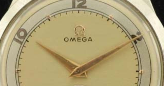

    My assessment was mainly from the OMEGA. The M just didn't look symmetrical and the spacing not quite right. The second photo is from jackmond.com. Just the closest example I could find, a 1952. Hands are the same too. He calls the dial original, but correct that if wrong. Font is different but I'm looking at the spacing and the M. Of course I may be comparing apples and oranges. Natural variation of the day? Is the font itself a key? I'm seeing more sans serif on examples.
    Anyway. Trying to learn. This dial does look very nice, but please help me with the evaluation.

    The Jackmond is a redial.

    Ha. He disclosed redial on other examples so I thought he would do so with all.
