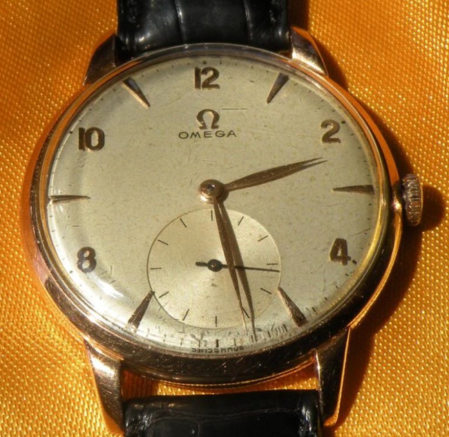

    I'm ashamed to say I've never even heard of a Tresor, can you post some pics?
  4. ulackfocus Mar 27, 2012
    25,983
    26,972
    It's a manual wind 3 hand with a 30 series caliber.

    Hope you don't mind I used your picture above to show what a Tresor is.
