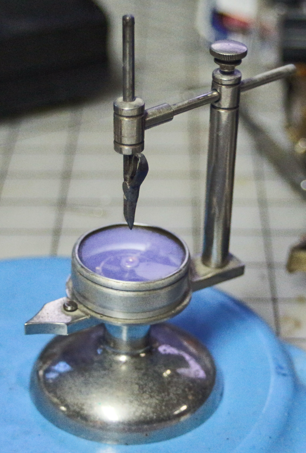

This reminds me of one of my Grail objects. One of my friends offered to teach me watchmaking, when I was between Apple Contracts. (I wanted to go to the Swiss school, there was also a program in San Francisco, but it was winding down.) He had one of these balance timing tools. On one of the horological trips, a member found one at a flea market, and he wanted to flip it, and would not sell it to me as I knew what he paid for it. I wanted it to use and not look pretty on the shelf. (which Ironically it has done for the last 18 years or so.)
Took a while but one showed up at the NAWCC mart.
Back in the day a watchmaker was expected to be able to turn a staff or vibrate a hairspring. This can also be done on a reference watch. The tip of the staff clicks against the glass. One has to have super powers of observation to count and do math in the head. I am not too good at the later.
