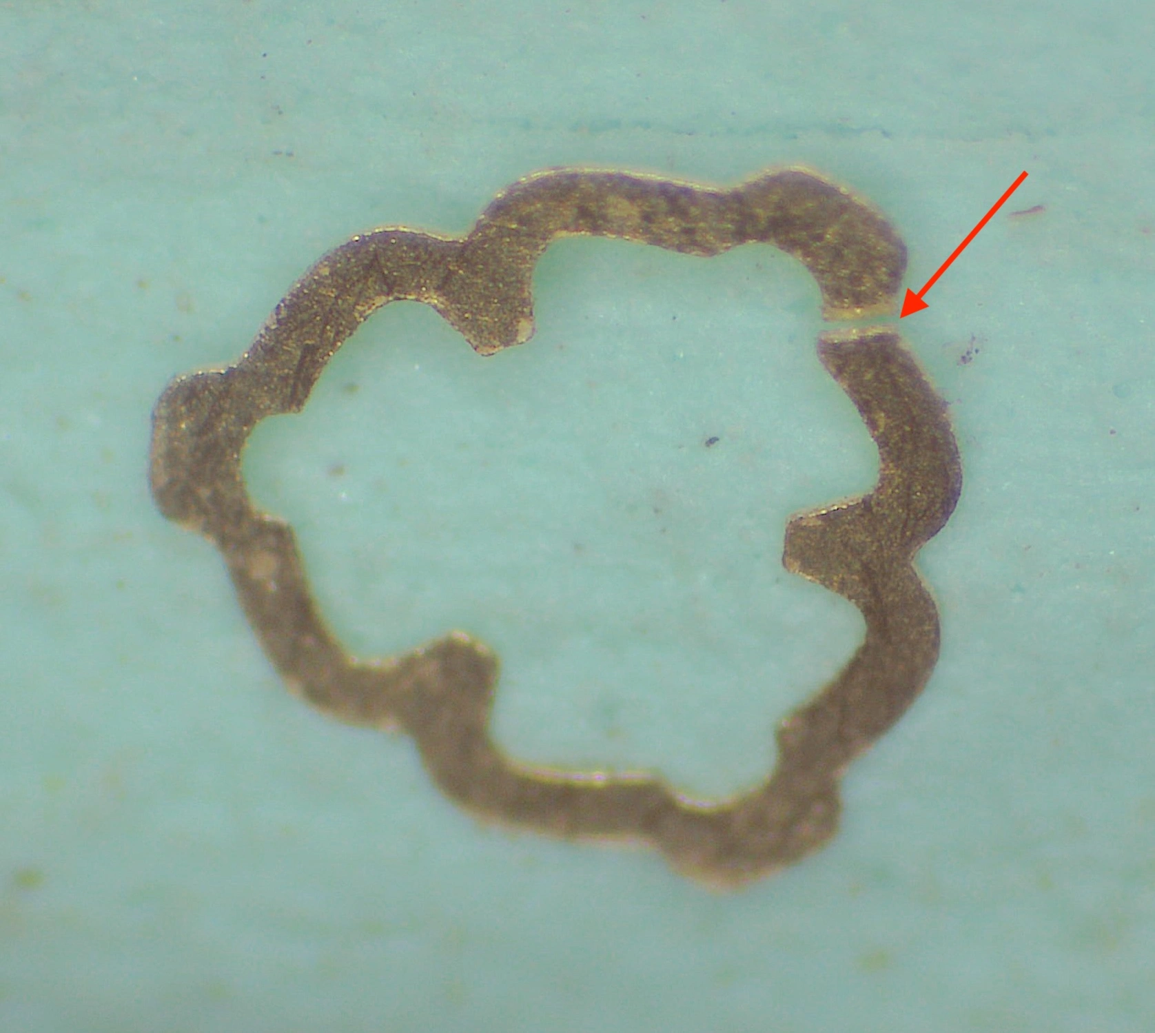

I'm servicing a 1947 Tudor with an ETA 1080 in it.

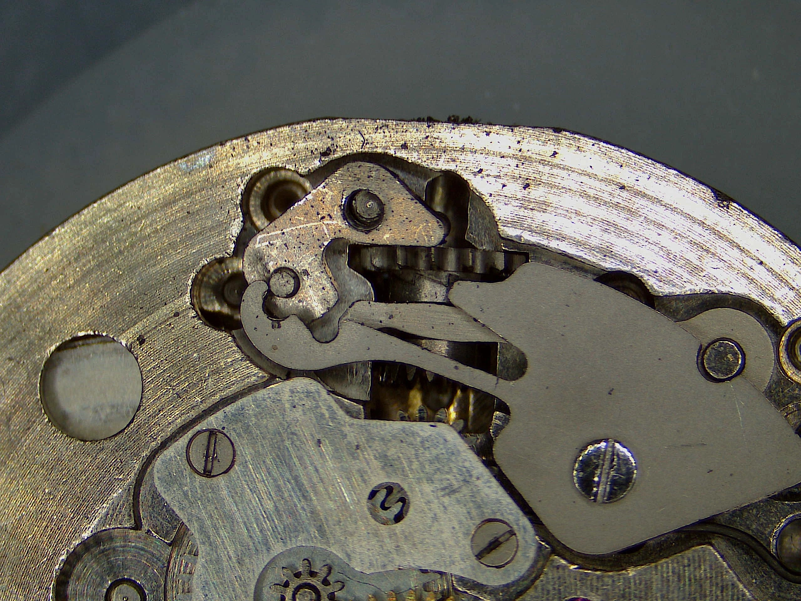

Inspecting the tiny parts after cleaning and found this 🤬.
Not surprising actually. Some of the previous work must have been done by a blacksmith.

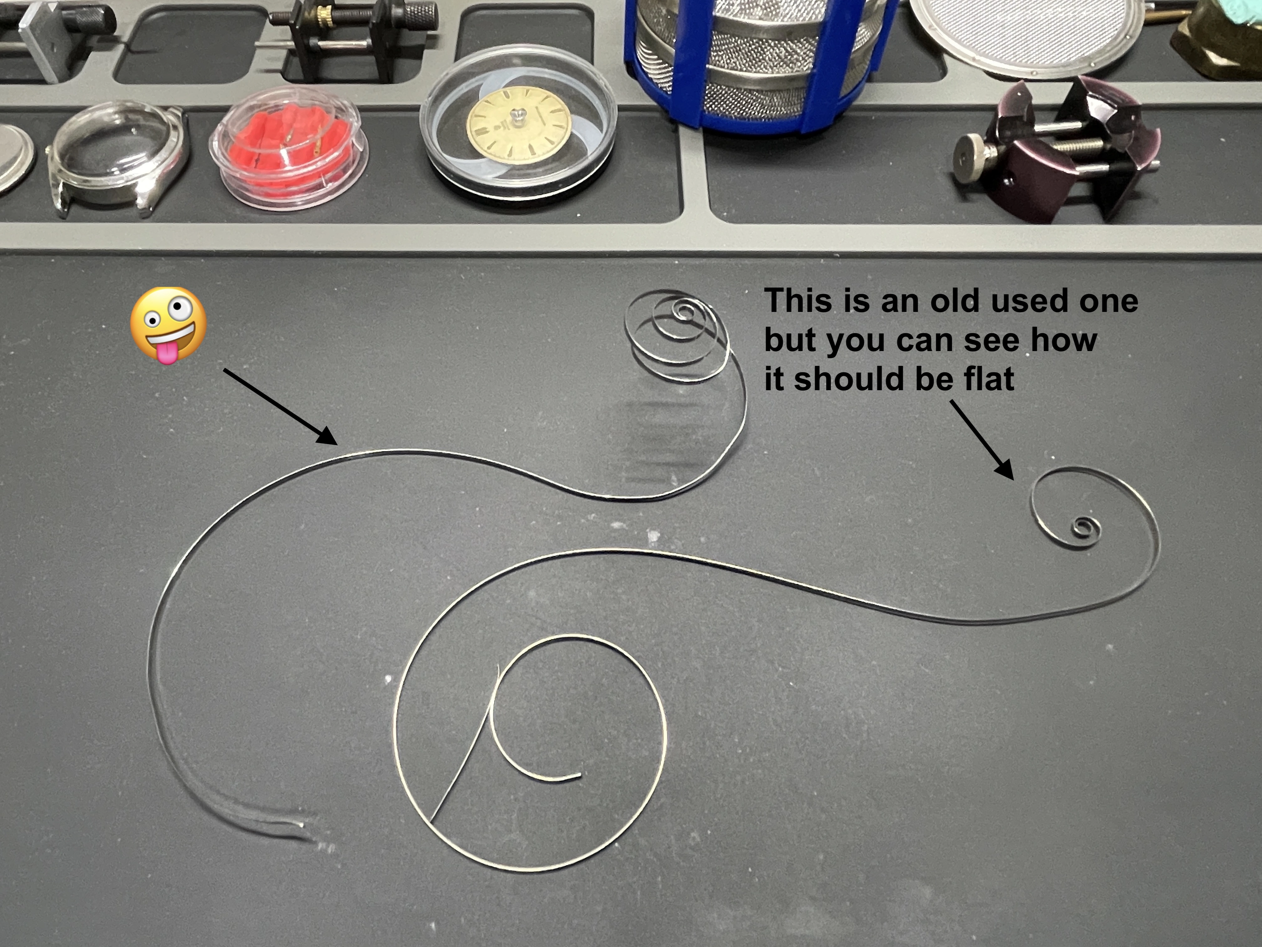

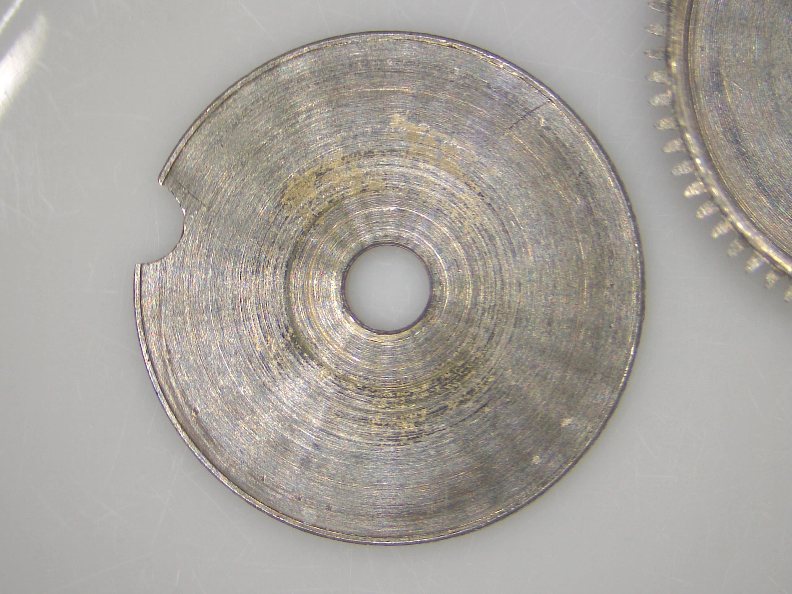

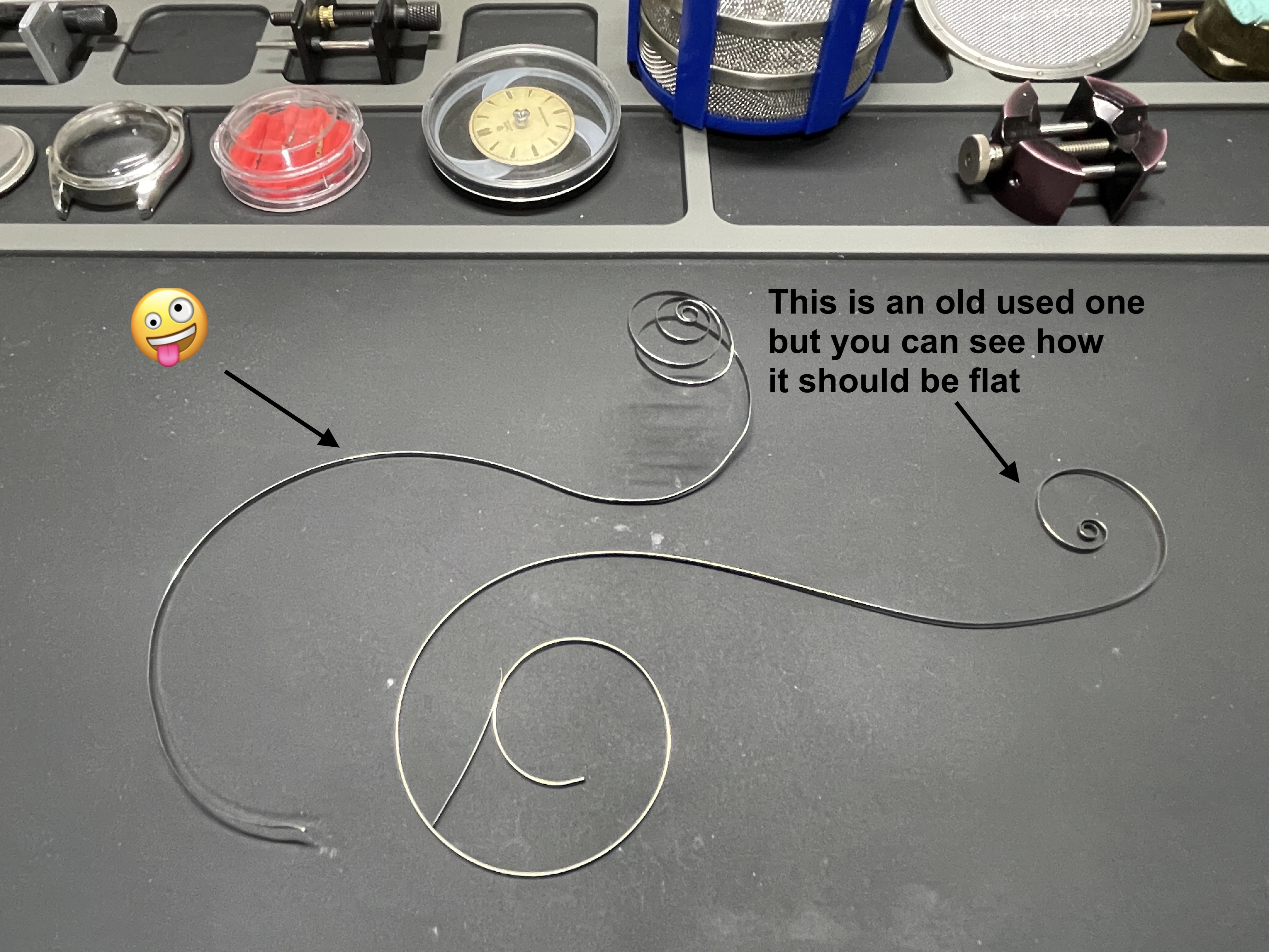

Evidence........... the mainspring.

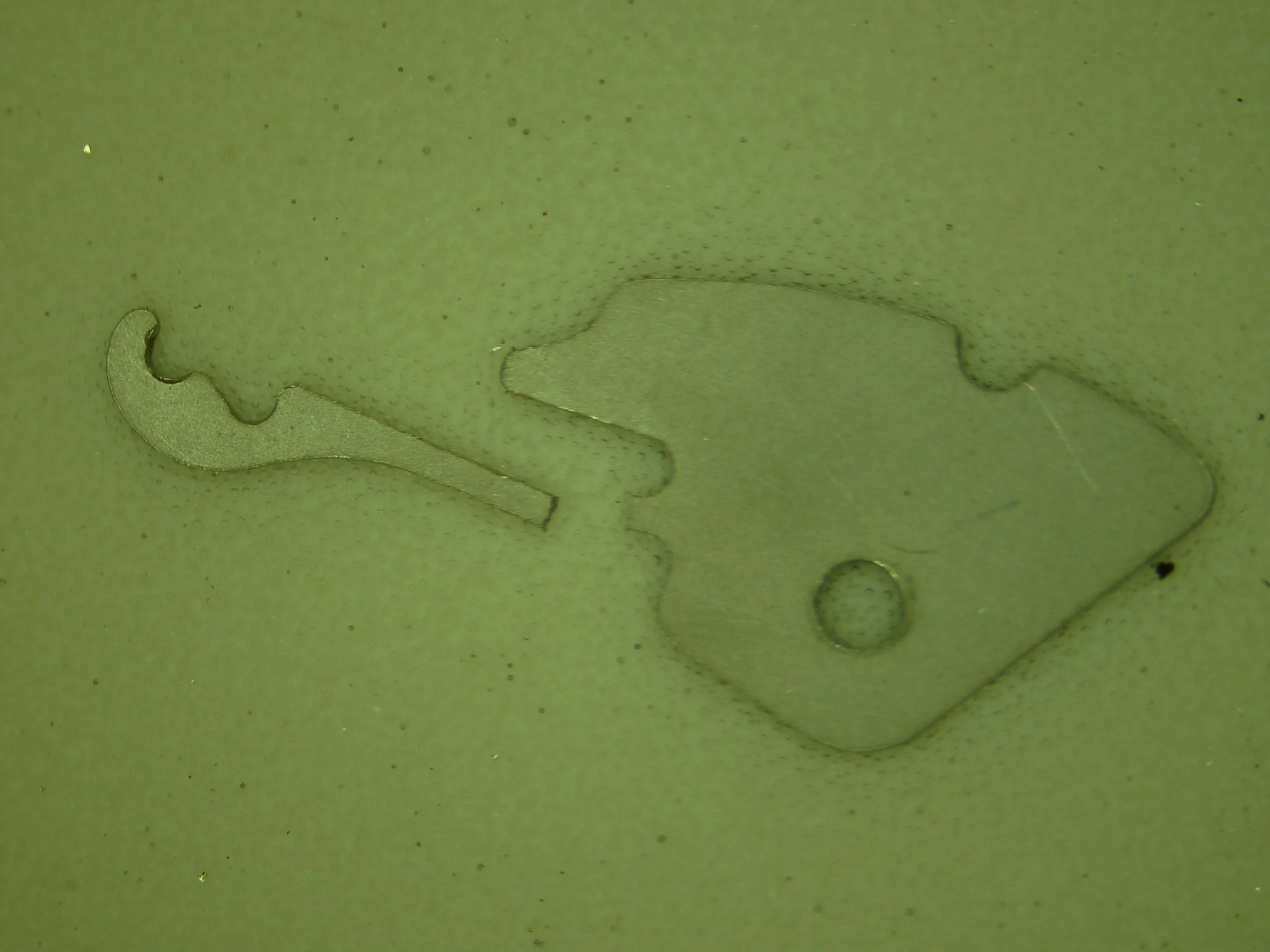

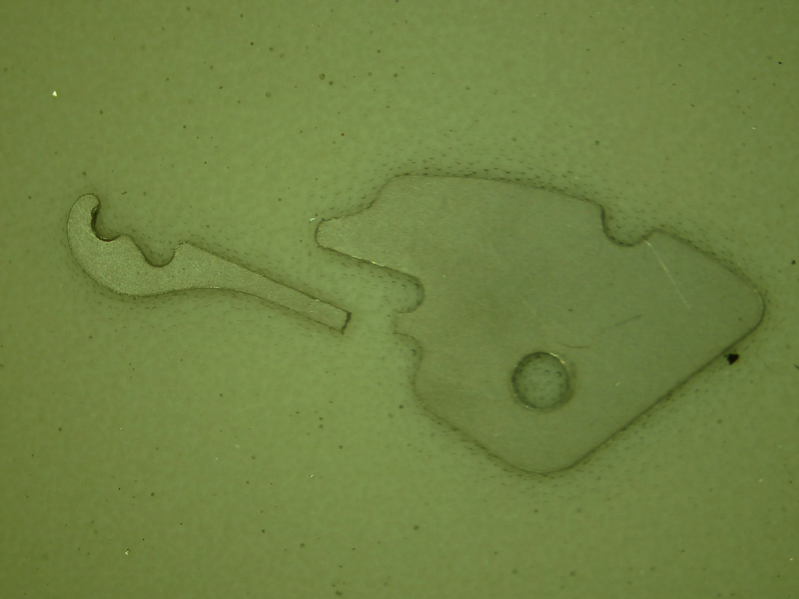

One of the symptoms the owner reported was "it's difficult to wind and set the time.
I know why.

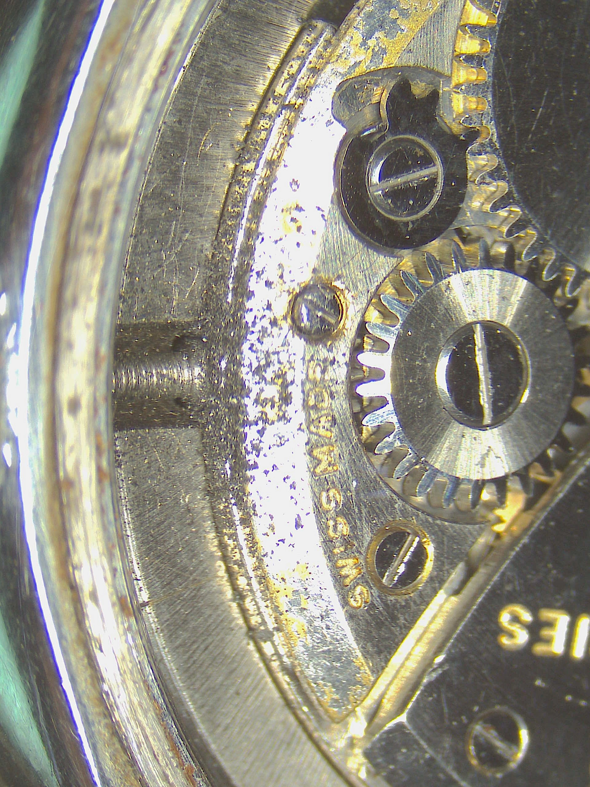

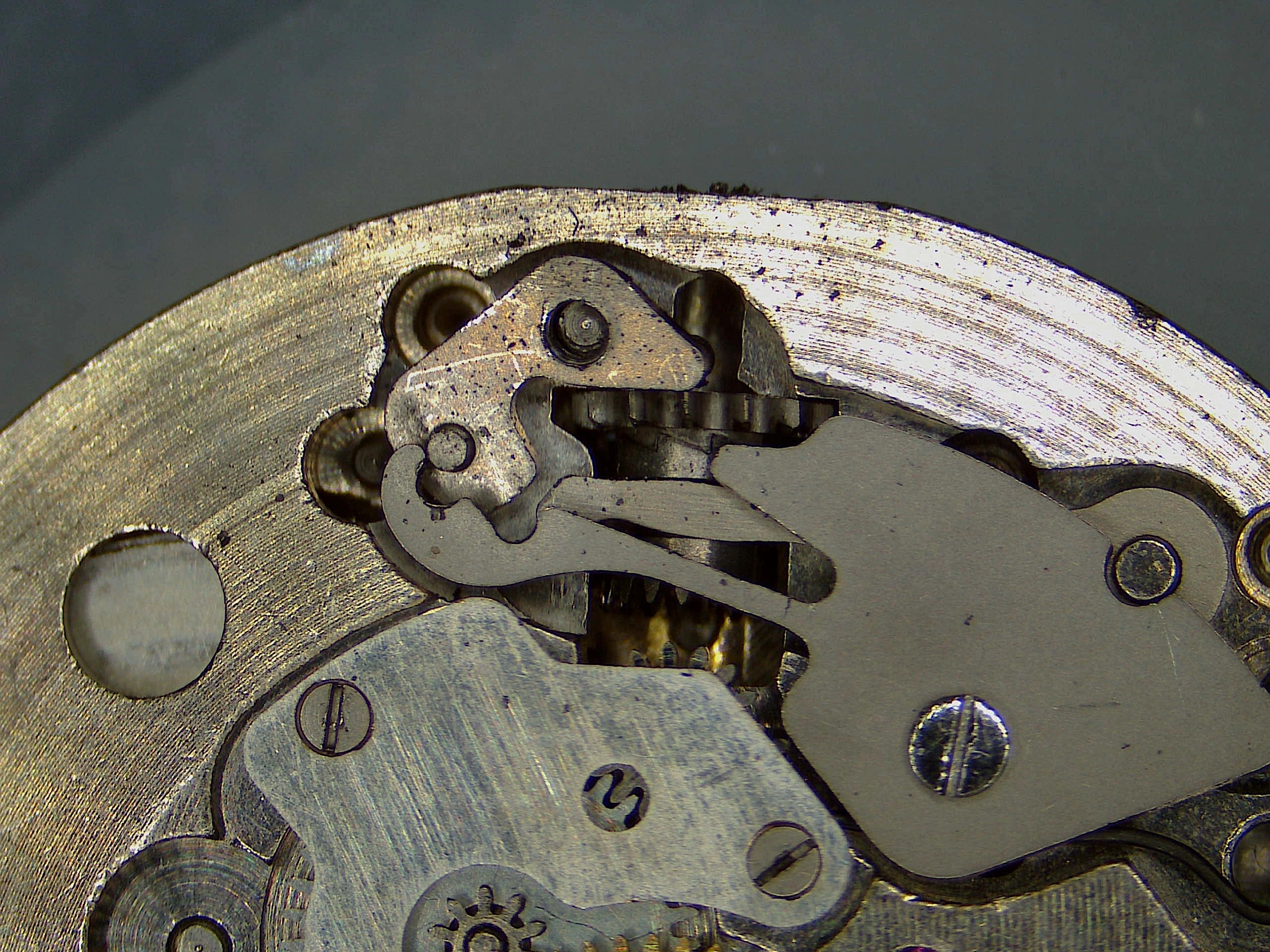

In the pic above, the setting lever spring looks OK, but when I was hand washing the parts in a dish (to reduce crud in my cleaning machine) I noticed this!
The two parts were actually being held together by grease and magnetism.
There were other signs of rough work, but I don't want to scare you.

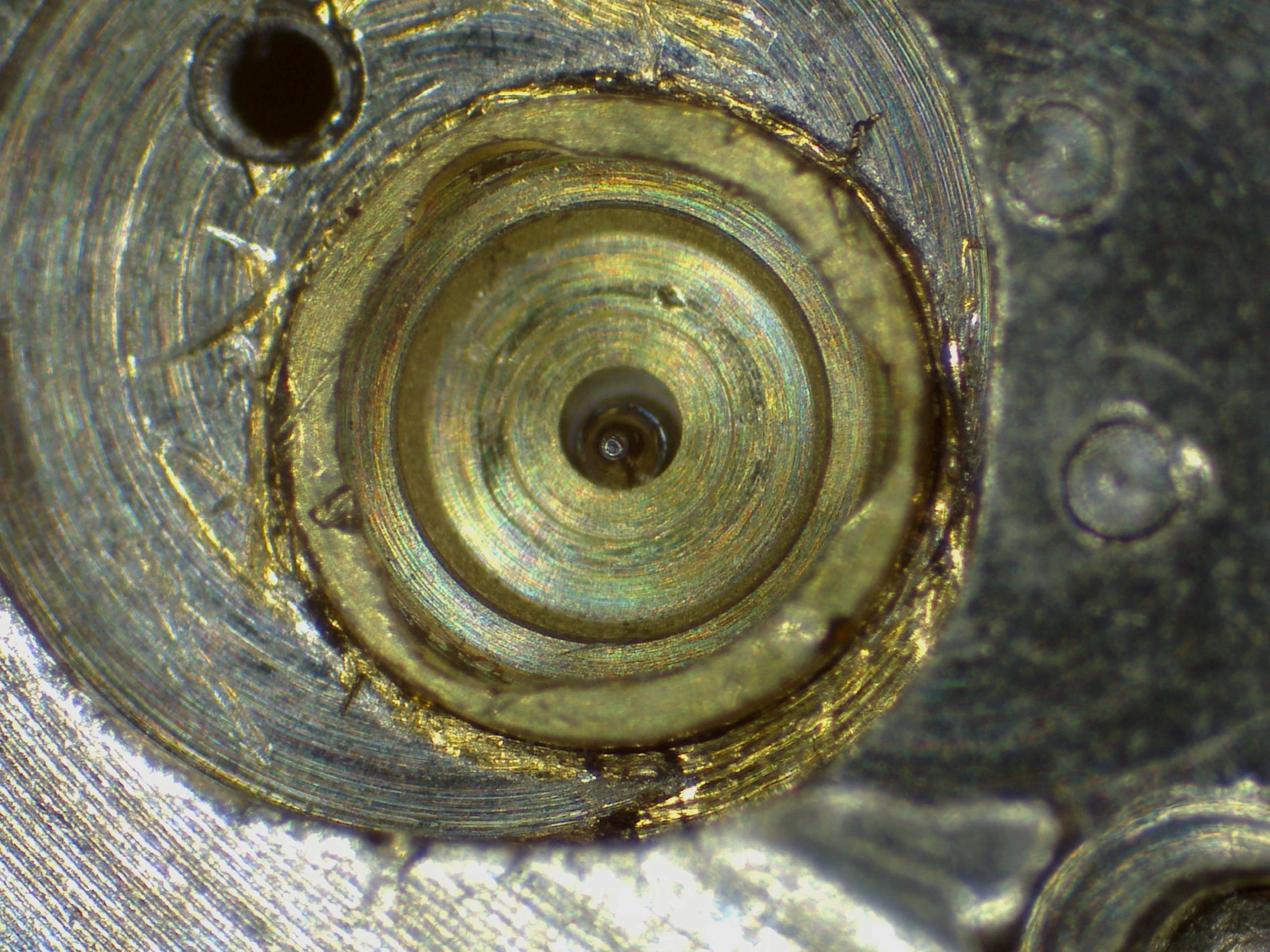

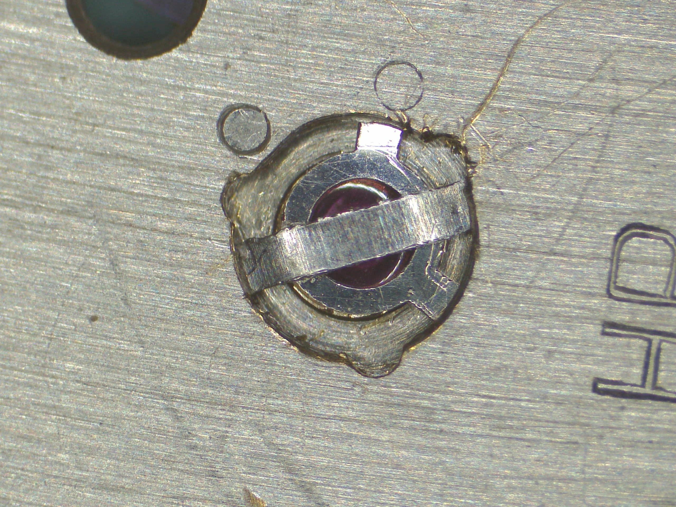

Oh what the heck, you're all brave people.
The previous person only had one screwdriver.

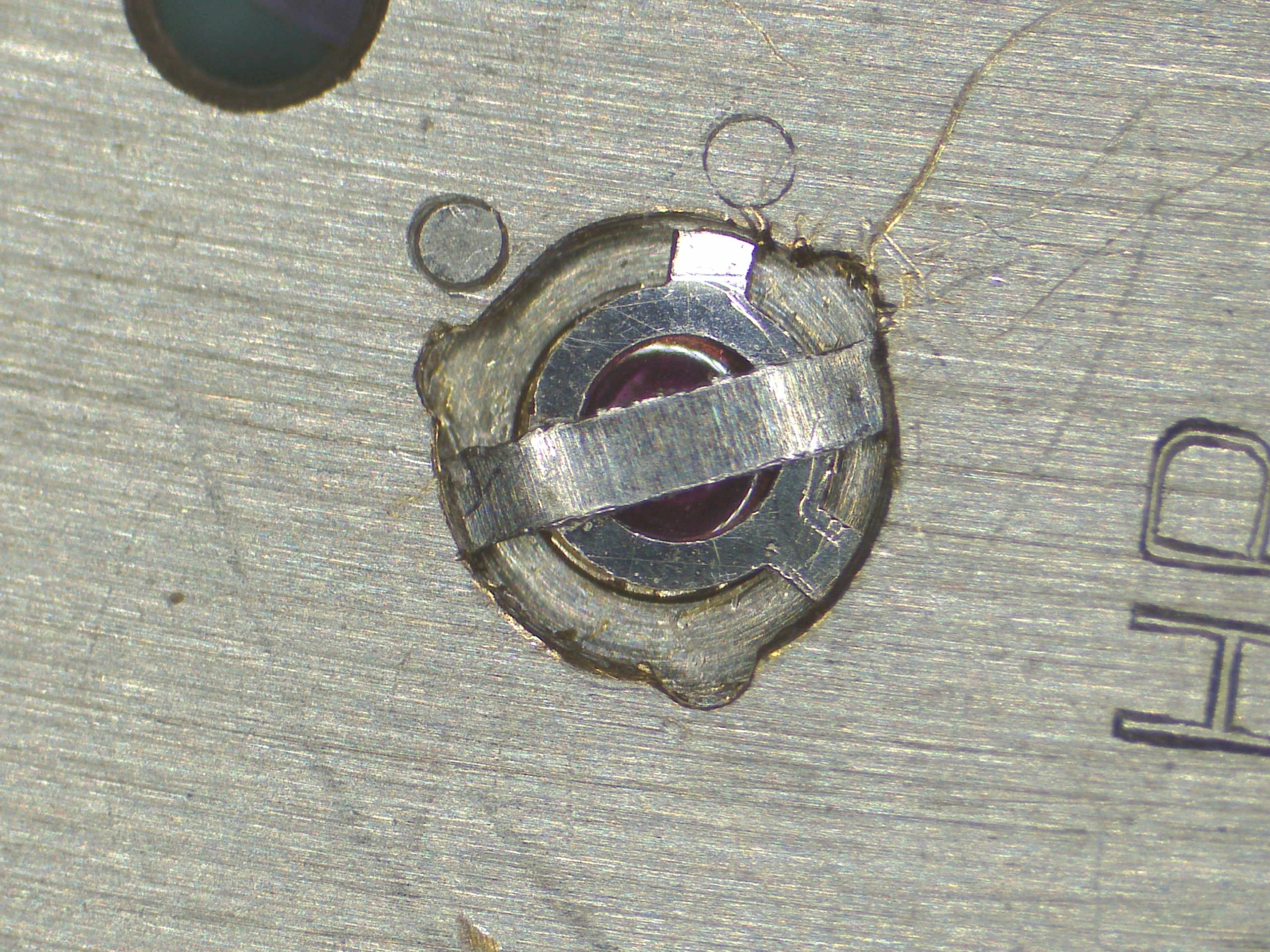

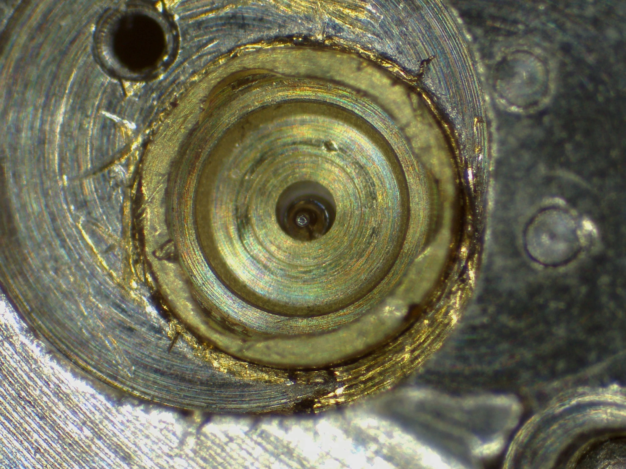

Some balance shock jewel replacement.
Anyway, it's a sentimental piece so it'll be good to get it ticking again.
Anybody have a secret stash of Novodiac springs?

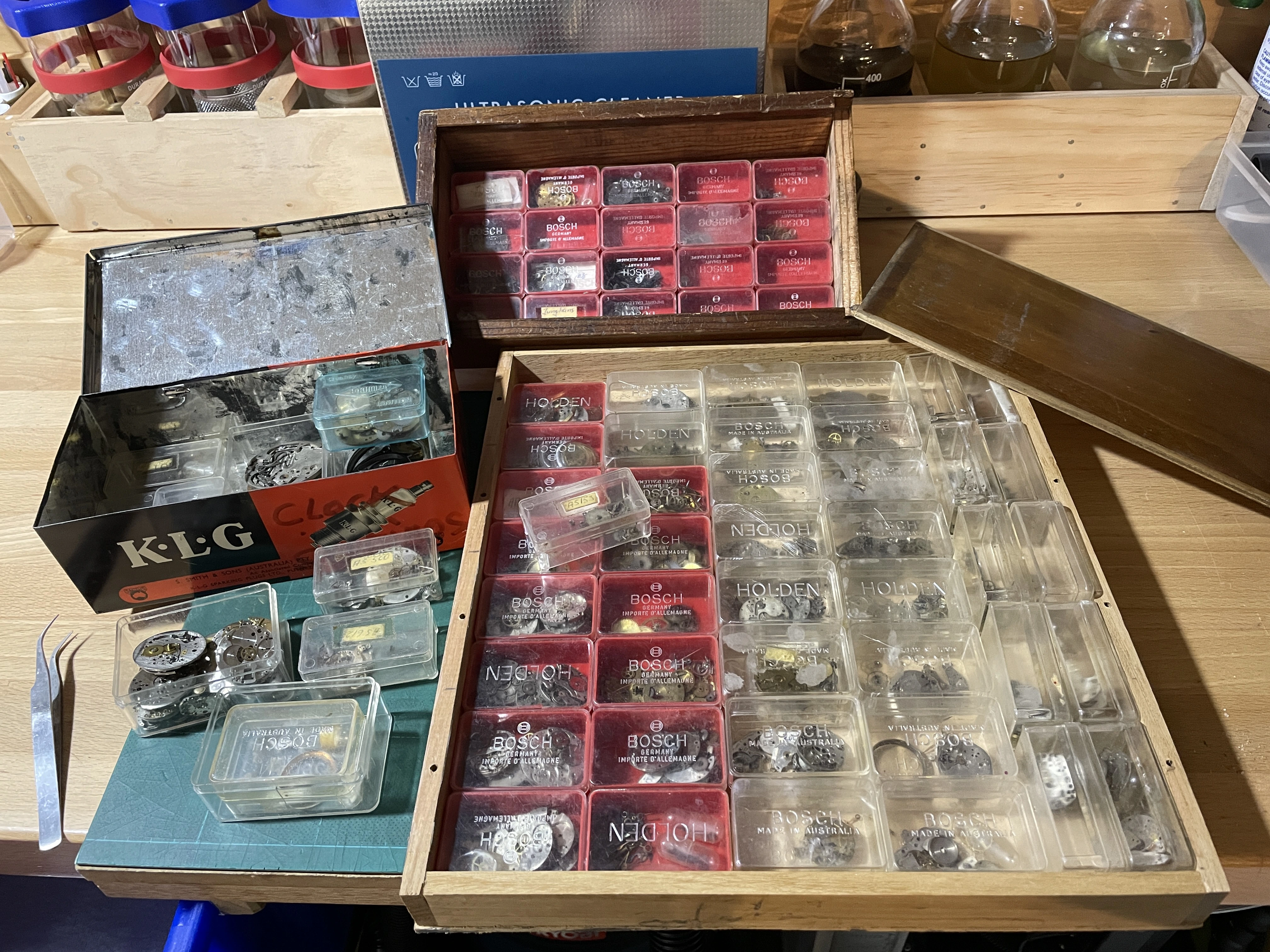

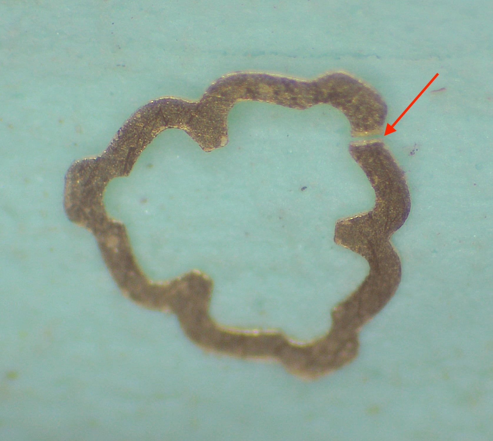

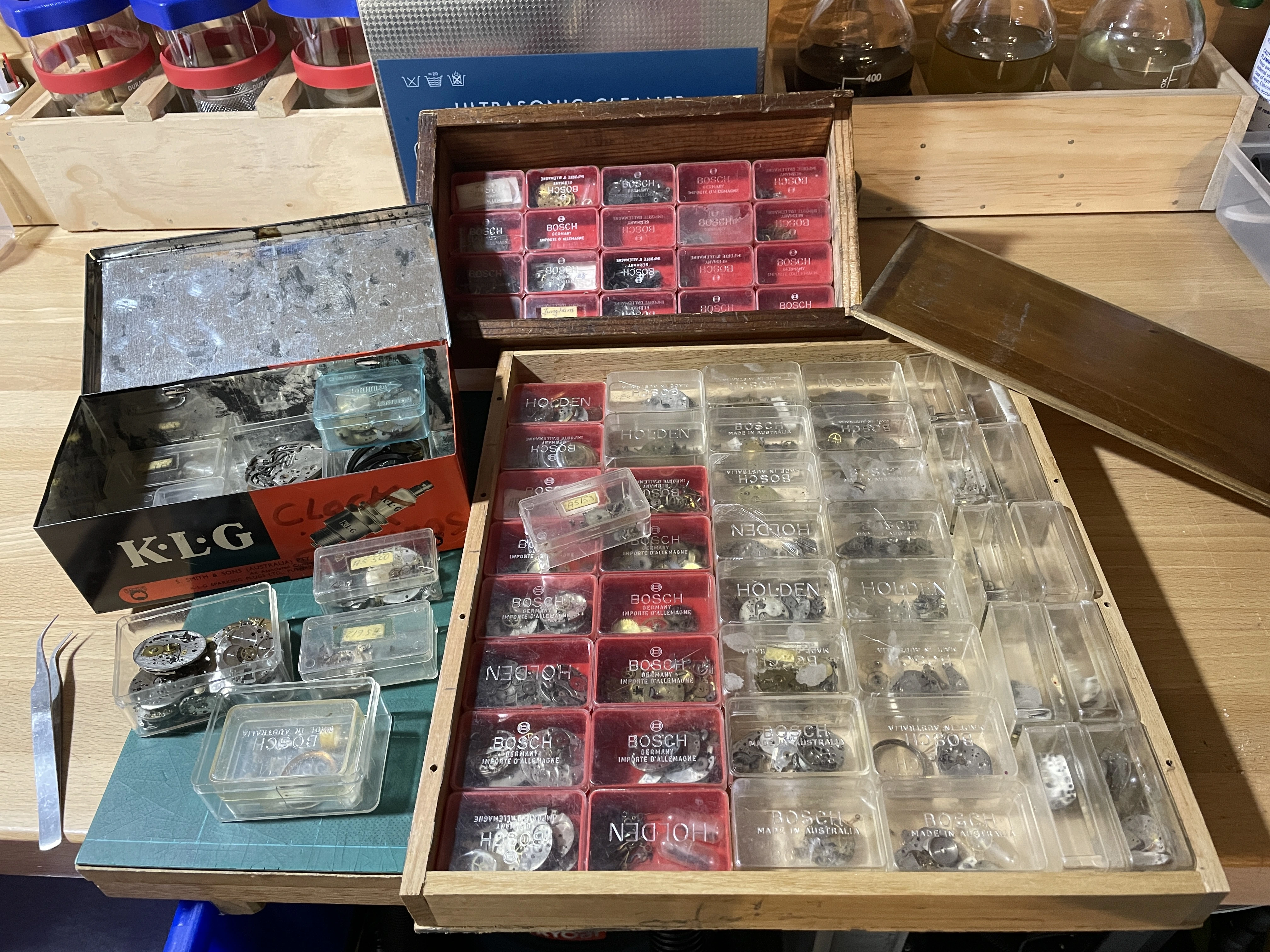

I was going through my vintage Swiss movement graveyard in the hope of finding a donor with a Novodiac spring.
and came across this 😵‍💫
Must have been the guy who worked on the Tudor 🙄.

Is that first triangular piece with a crack some sort of shock protection device?
30,217
78,015
Yes.

Ooof, that is all really rough! The setting lever spring and the incablock spring are both understandable perhaps... perhaps it happened 'after' the service? That shop-made replacement though is funny. That replacement jewel is sad, seemingly he didn't have a proper reamer to size it right.

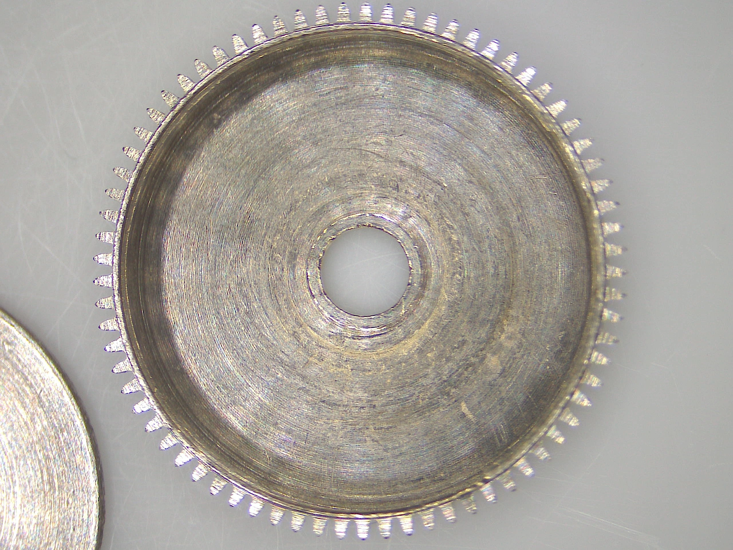

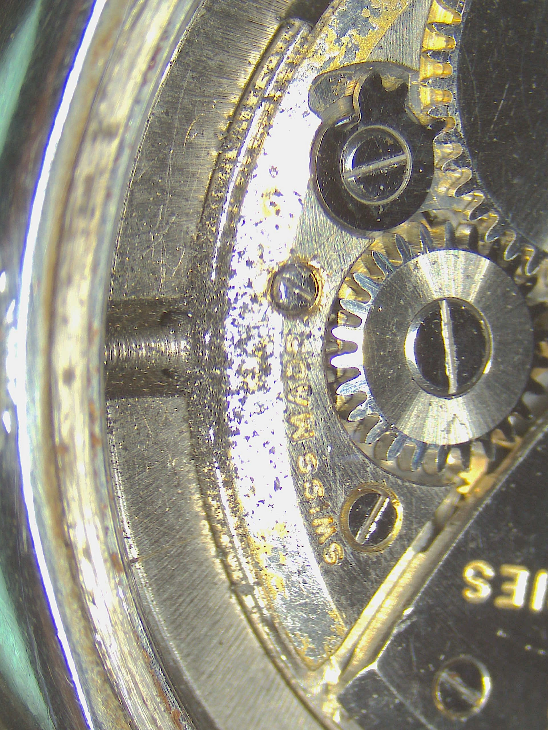

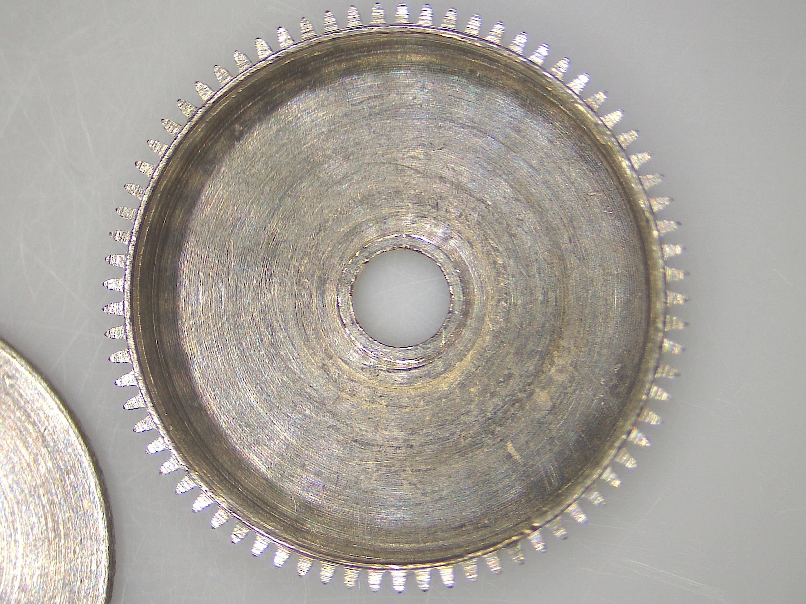

I feel bad for that movement. How does the inside of the mainspring barrel look based on the condition of that mainspring?
1,615
3,862
Meh. I even saw a train bridge secured by double tape. My daily driver speedy was also a horror show: some screws were rusted under the dial and the incabloc is hard to access without removing these. So, the previous guy left the screws alone, somehow broke the incabloc spring and glued it back... cleaning that mess properly took some work.
18,802
39,060

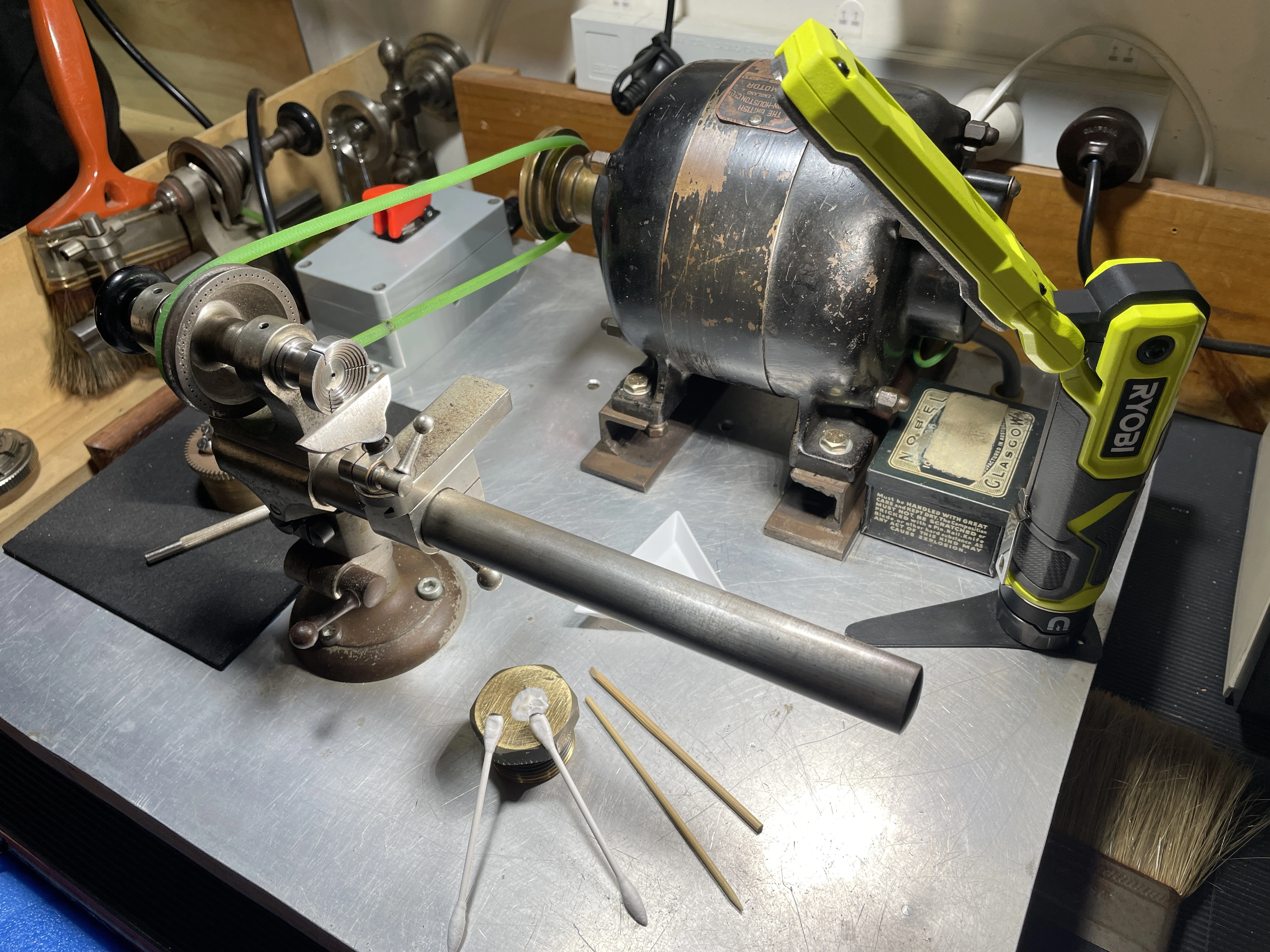

Surprisingly not as bad as I expected. It's been cleaned but I'll polish the surfaces before I fit the new mainspring.
18,802
39,060

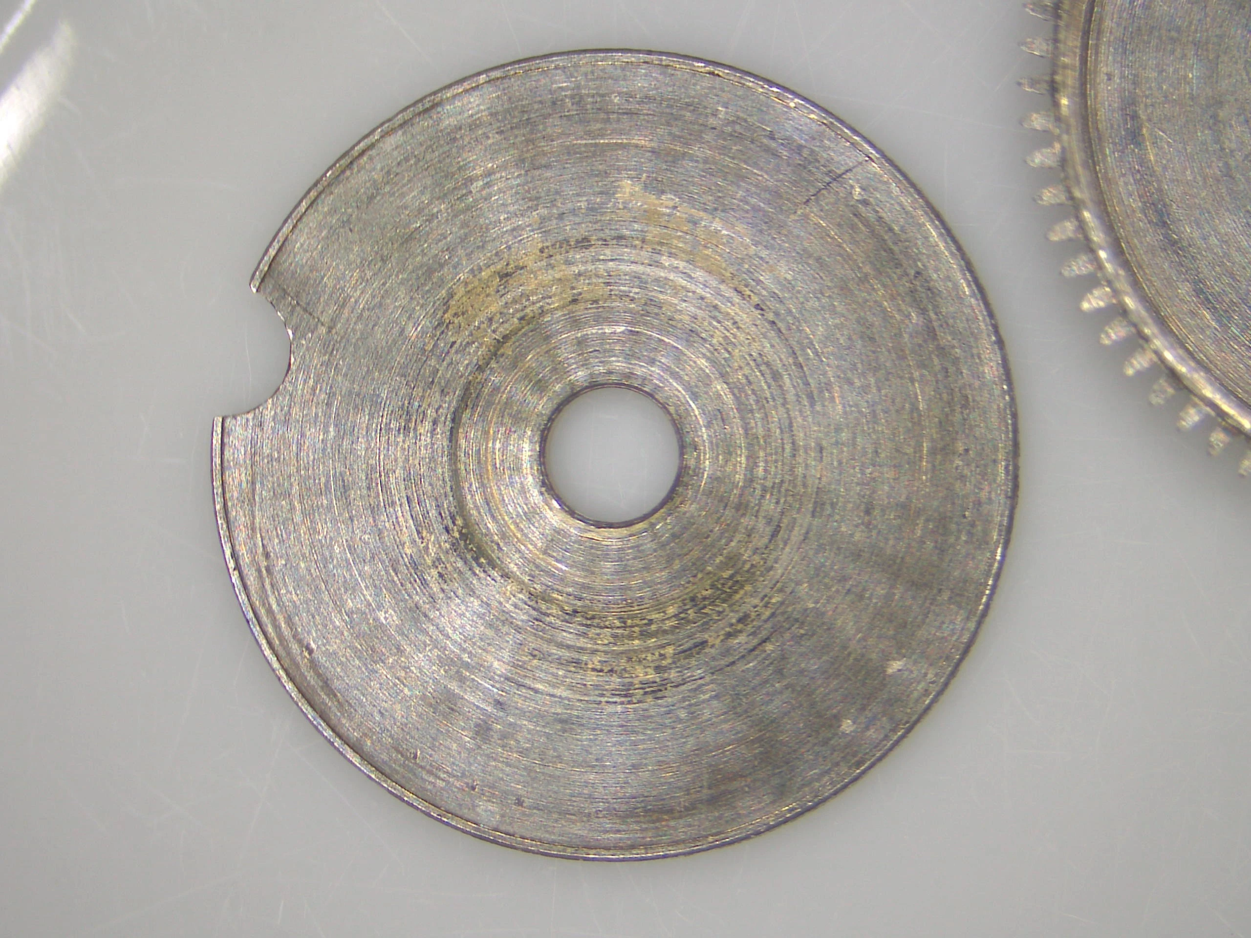

I think they'll be OK after another go in the cleaner.
Still some tiny pits, but no ridges.

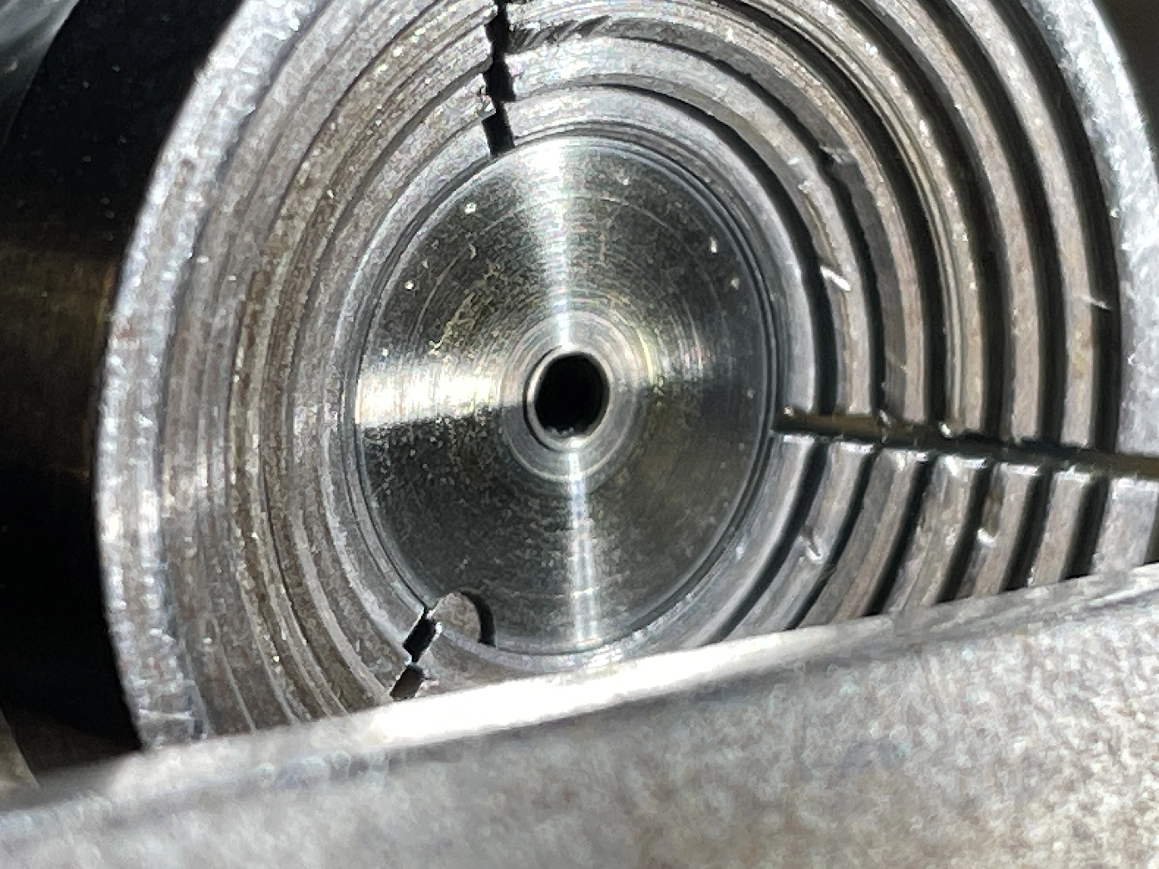

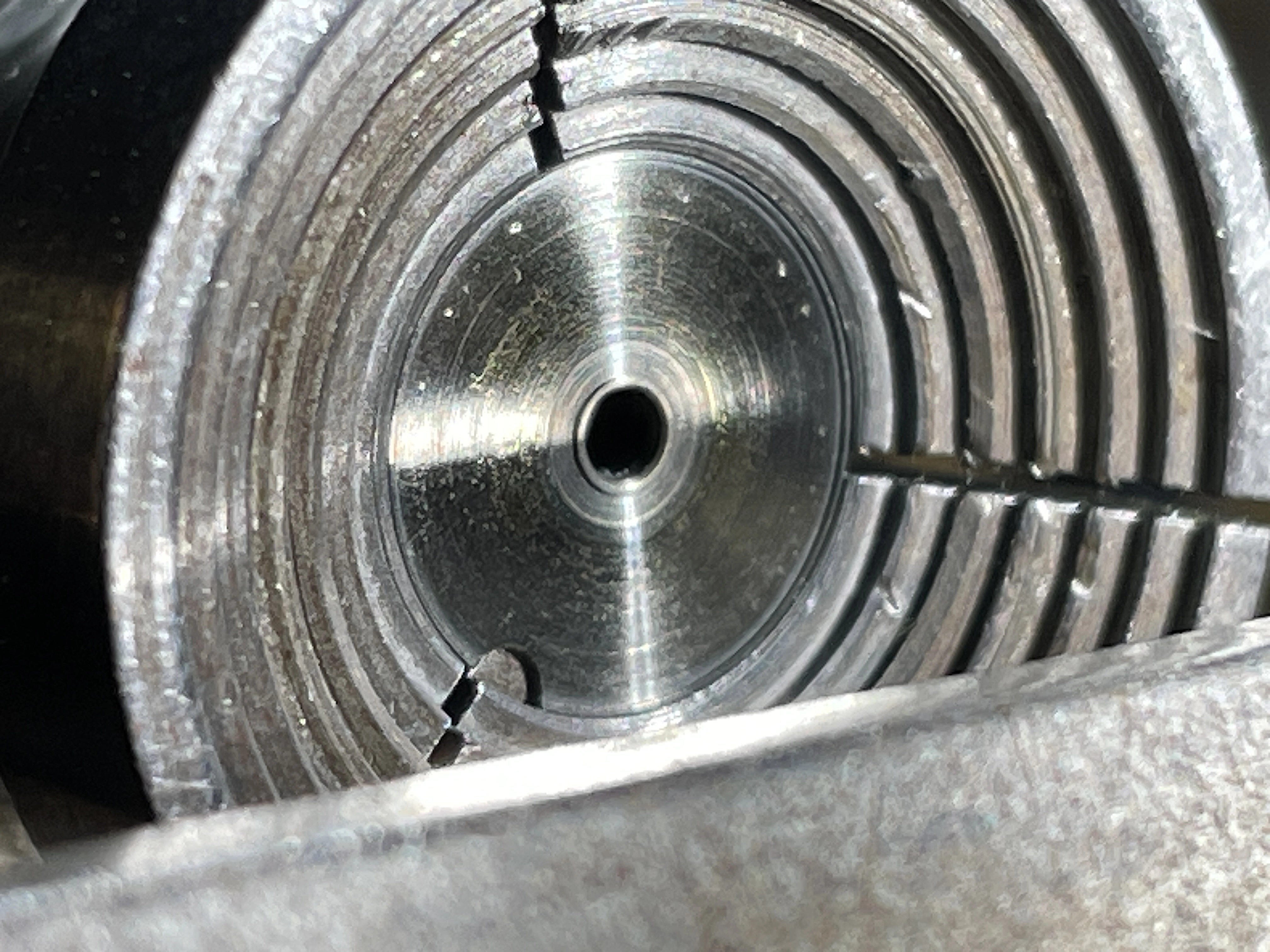

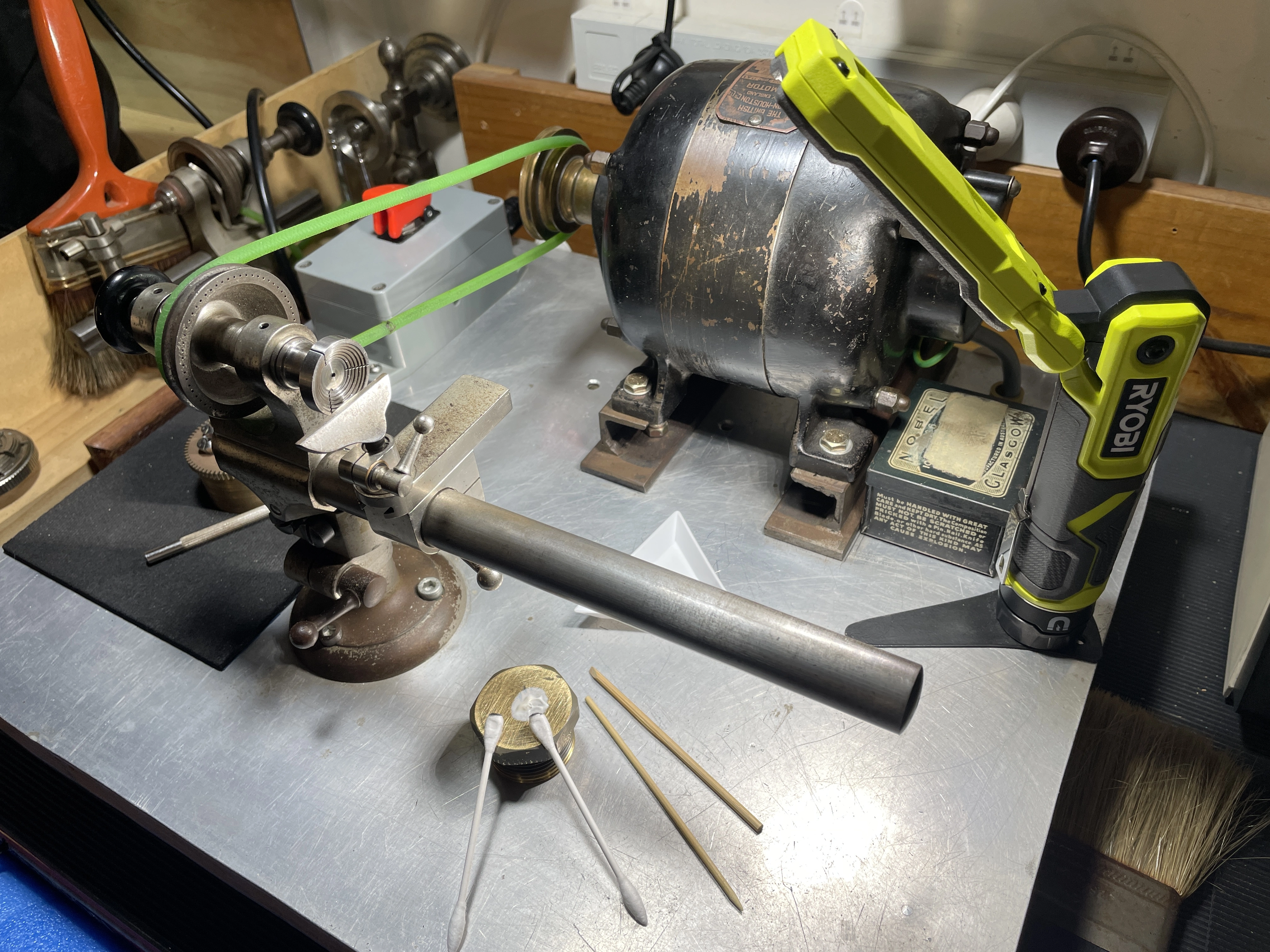

2,644
2,831
Thats a neat collet fixture there! I work with larger stuff in my hobby shop, but that sort of collet seems like a neat addition to my lathe. I'll have to make one!
Did you just use a polish, or tooling to remove the material smooth?
18,802
39,060
I'm not skilled enough to use a graver for that so I just used a flat ended hard pegwood stick and metal polish and finished with cotton buds.
PS: the collet is called a concave step chuck, there are also cone shaped ones called ring step chucks.
2,644
2,831
Cool, I'll look into that! I have a 16" lathe, so quite a bit bigger than that, but no reason I couldn't make a chuck like that.
