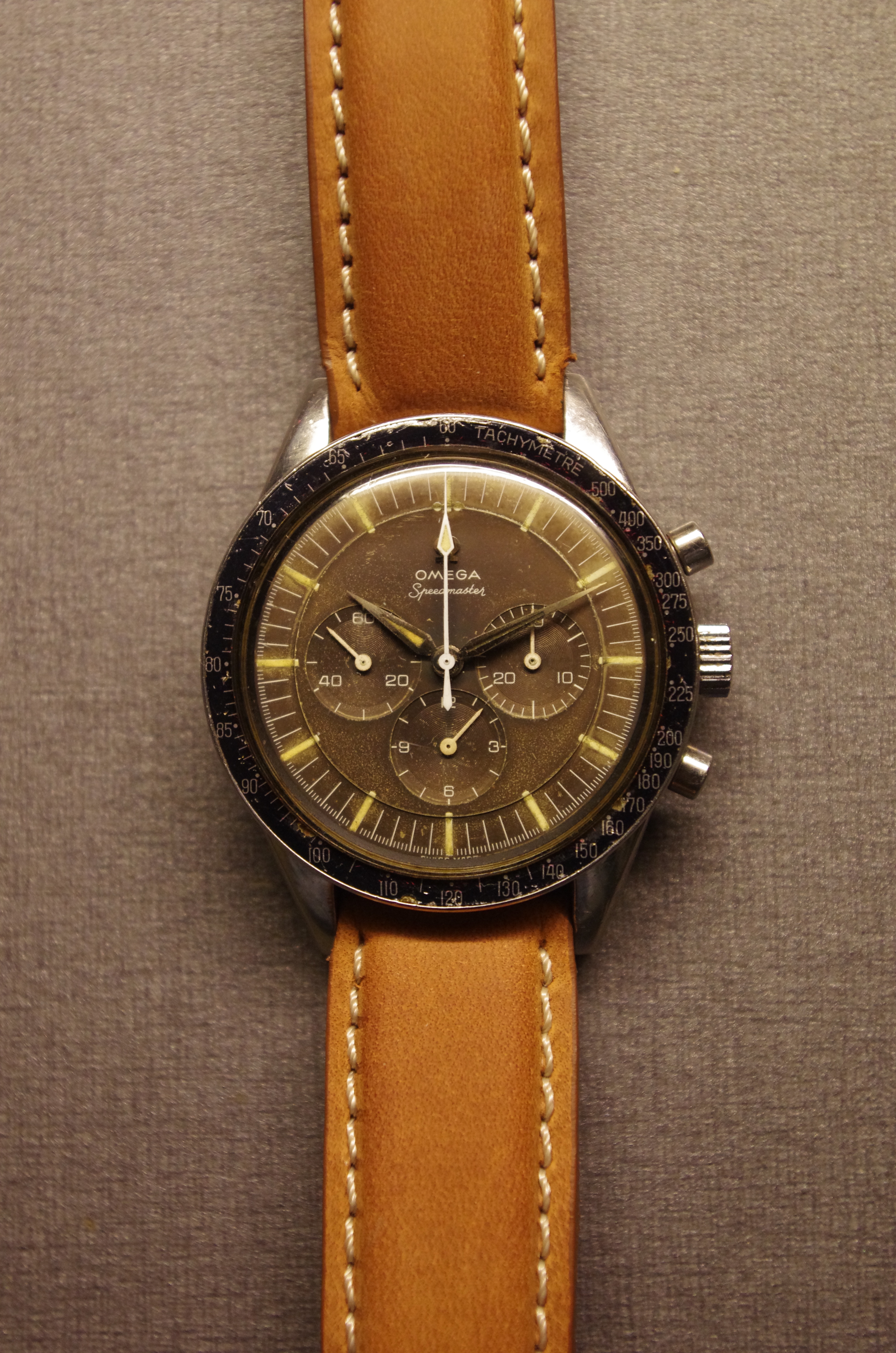

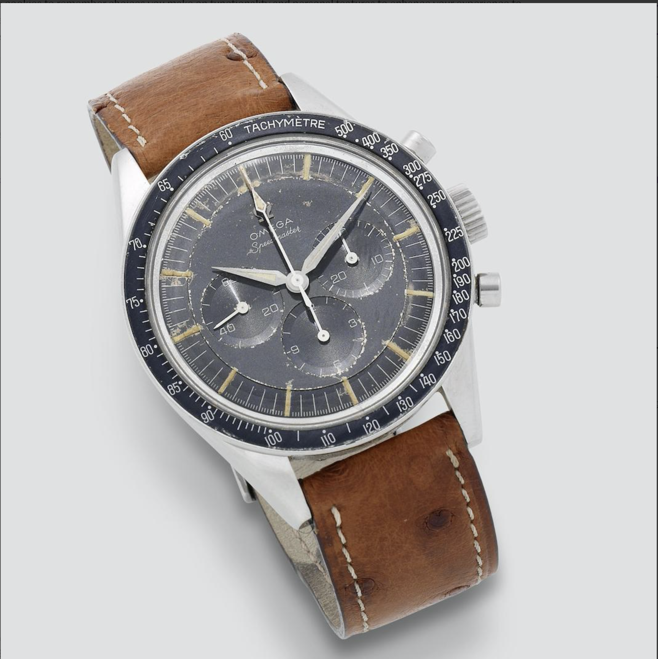

So meeting in Zürich. And the least that I can say is that it's... Crazy. just crazy. I wanted it in a second. Love at first sight. 🥰
It's almost impossible to make a decent picture of this dial : Grey in the shadow. caramel in a regular light. Gold in the sun. it's just incredible.
And good other surprises : the bezel has some blue reflections in the sun, and the case looks to be in a good condition!
I hope you'll like it and if you have one or knowledge about them (pictures, serial, where it has been delivered, everything!) , please share and make this thread live!

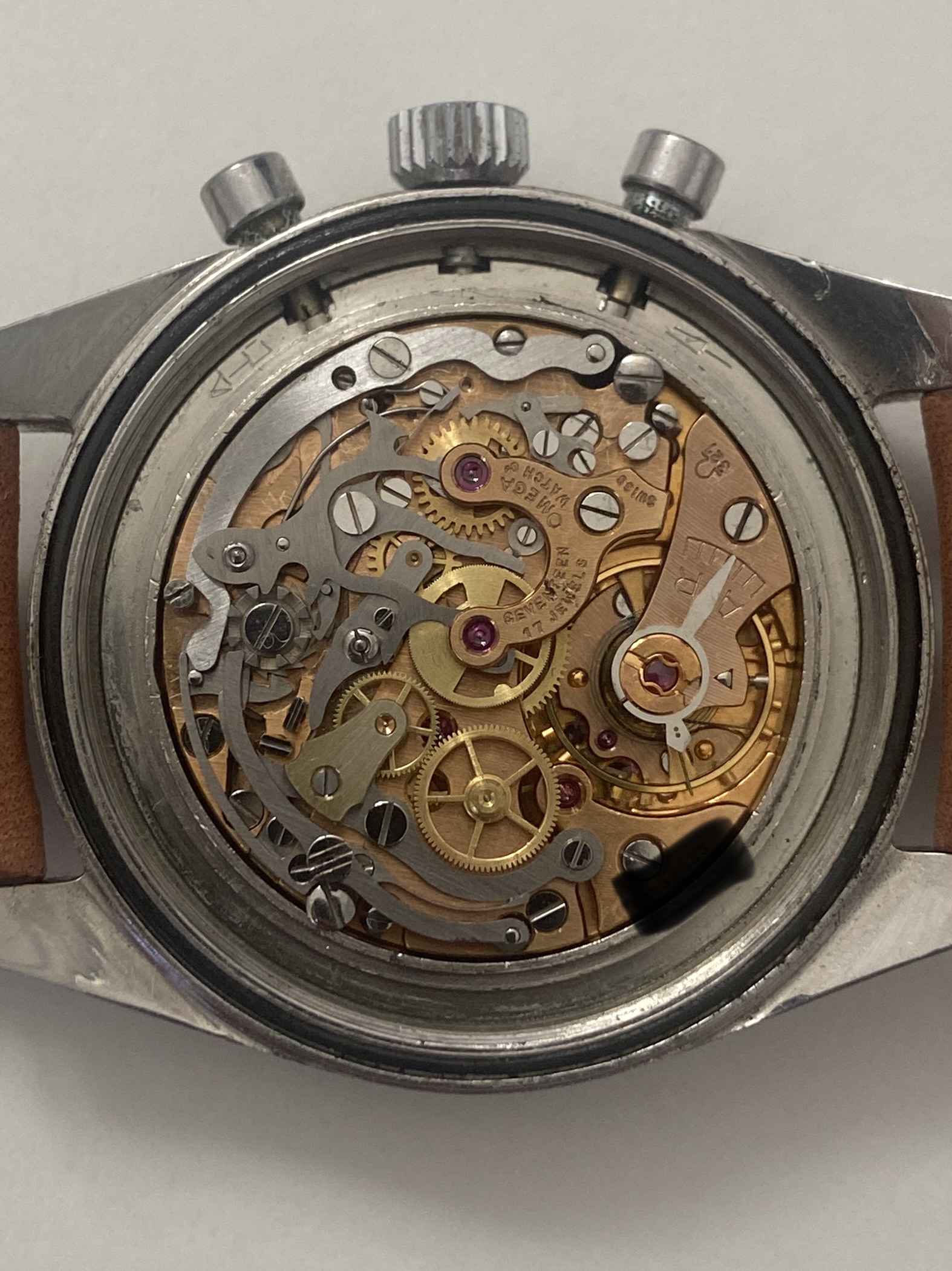

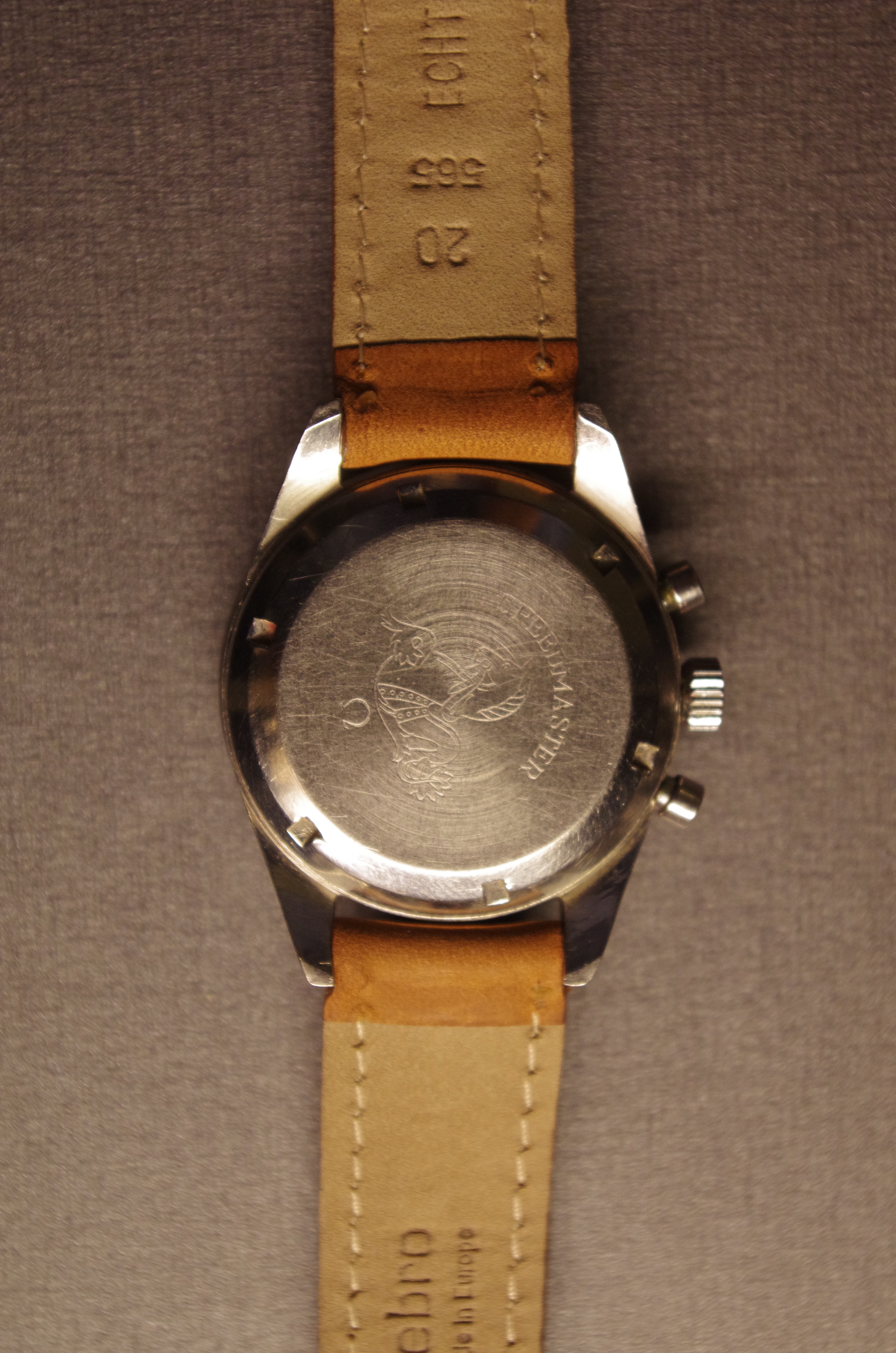

The old paperclip I see 😀
I saw that yes. 😵‍💫
It will need some time with my watchmaker to make it right I guess! 😀

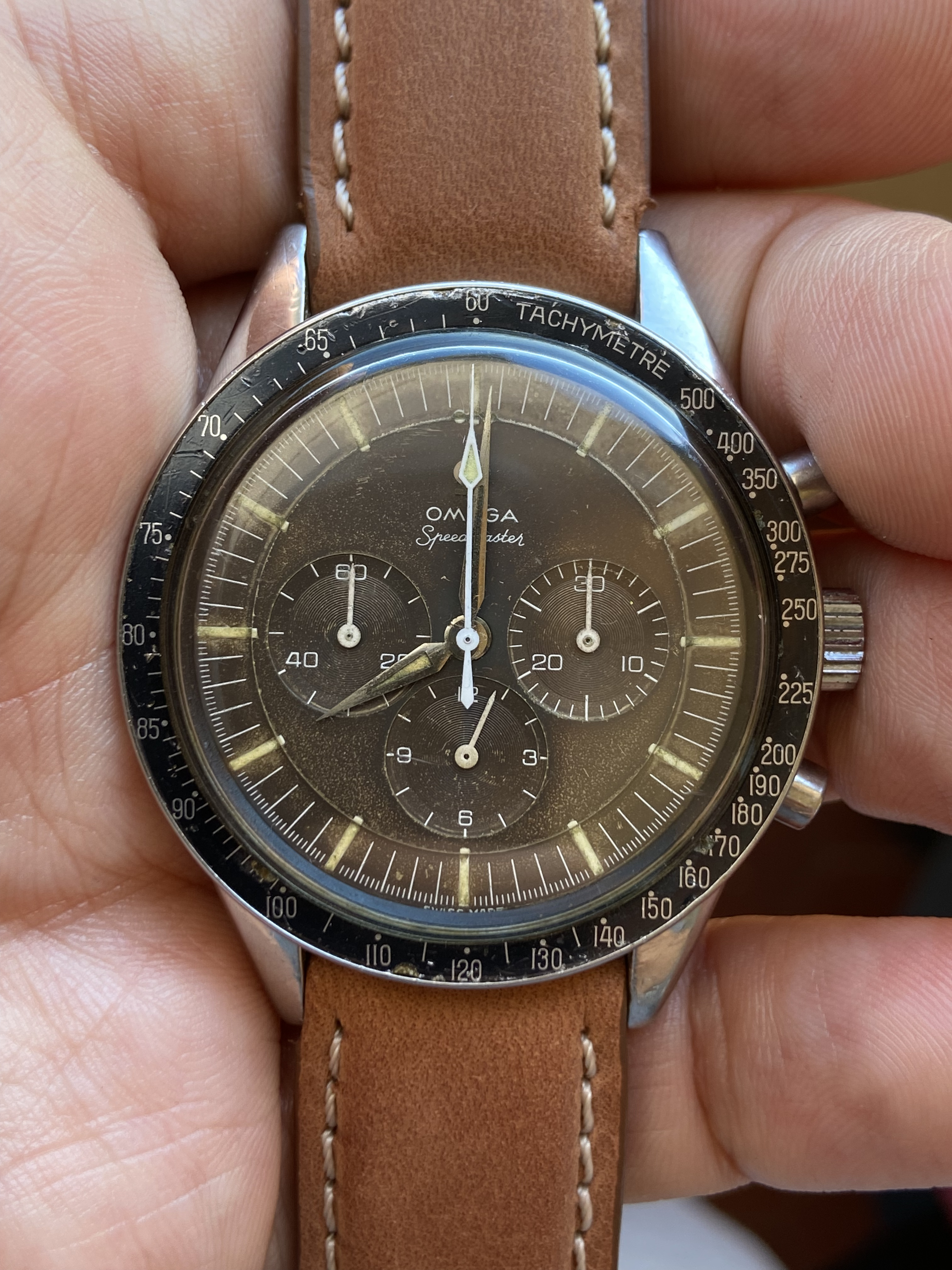

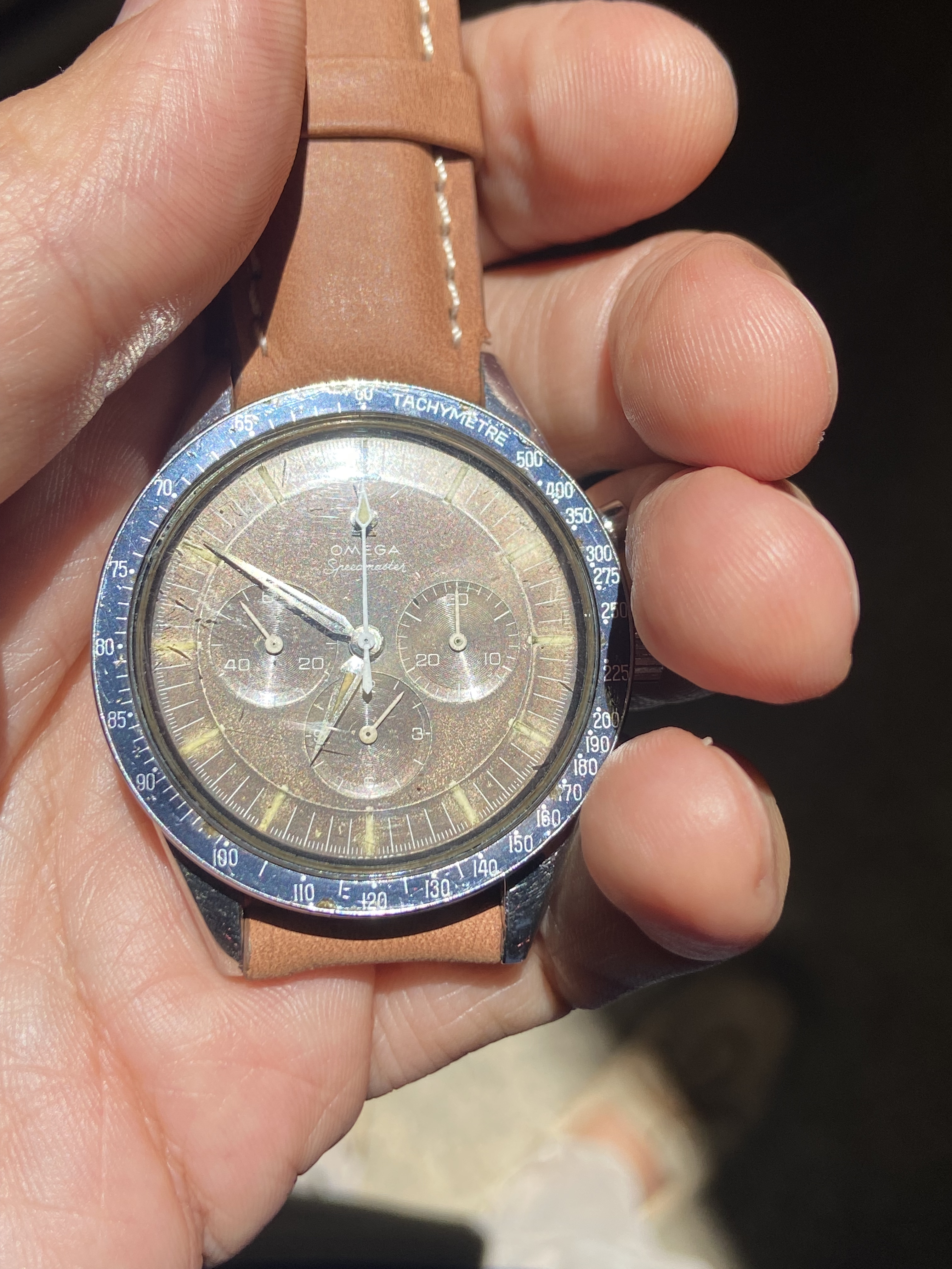

I am less positive towards that I am sorry to say. The lume looks to have been removed (see the halos round the plots) and while it may be a heavily patinated matt grey dial, as seen on SP101 and therefore vanishingly rare, it may also be a heavily water damaged or aggressively cleaned std black dial. I am leaning towards the latter but perhaps one of the big Speedy hitters might want to make comment. It is not unattractive but the movement condition just reinforces the suspicion in my mind.

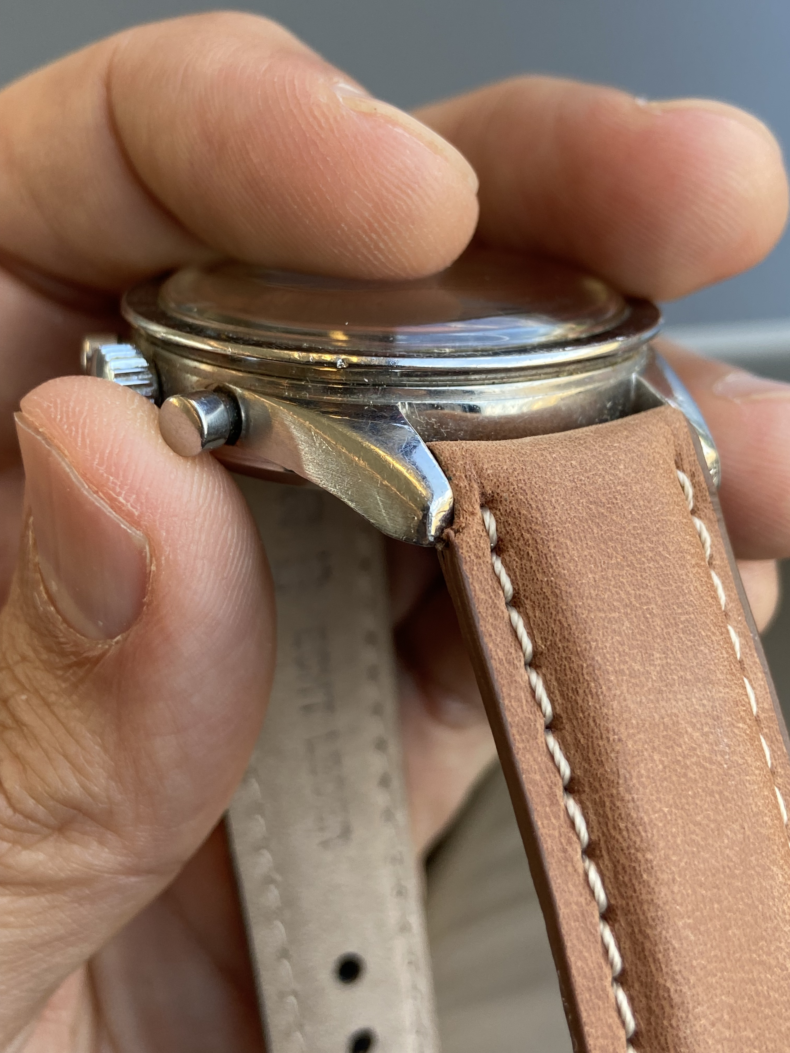

Looks like a bit of a mess to me.Dial is not attractive and the movement is very suspect. Paperclip and strange engravings next to the pushers.
2,587
3,883
Perhaps the extremely rare (never been seen before) Roswell edition of the very first watch in space. ::stirthepot::🤦

I am less positive towards that I am sorry to say. The lume looks to have been removed and while it may be a heavily patinated matt grey dial (as seen on SP101) and therefore vanishingly rare, it may also be a heavily water damaged or cleaned std black dial. I am leaning towards the latter but perhaps one of the big Speedy hitters might want to make comment. It is not unattractive but the movement mismatch and condition just reinforces the suspicion in my mind.
No worries.
There is indeed some lume missing on some indexes , but not everywhere.
I'm sure it's not a standard dial but a grey dial, because of the indexes / step proportion or the color / reflection. It's really different.
About the mouvement, yeah it had a good life and was badly maintained. but it can be fix...

Only you can tell, what it is. Having it in your hand. From the pictures provided , I can not see the desired gray dial. They age different. Have a closer look at the grainy structure of the dial in the lower half of the dial. Every step in that dial, incl. the subdial rims, show some kind of mechanical abrasion. Rather Man made. The rest is subjectiv. I'd think, this dial was washed and relumed. But, pics. are not detailed enough. It all comes down to price and liking.Good watch to wear. Not sure, what that paperclip in the movement tells me about the level of care.... Enjoy it for what it is. The bezel could be replaced and this one preserved. That blueish colour is original and quite rare.....

One positive thing, I initially said 'movement mismatch and condition', I retracted the mismatch part that since I realised the serial was in range so that at least shouldn't be a concern,

Dial is not attractive because you didn't have the watch in your hand... As I said, impossible to make a decent pictures of it.
The engraving... Well who really cares? It's clearly not a museum condition but it can be fixed easily.

For what I saw on the other grey dial, the "abrasion" of the step or subdials is an usual deterioration. I really don't think it's man made.
This one for example.
About the aging, I saw 3 105.002 with a strong patina like the one sold by watchfid recently.
https://www.watchfid.com/watches/omega-speedmaster-105-002-62/
About the relume, I don't think it has been. The lume is partially missing and what's left react as it should. And this degradation can be seen on other dials too.

Congratulations! Indeed a blue/grey dial. I too have observed quite a handful of 105.002 in this dial configuration. Personally the issue with the movement in this watch wouldn't stop me from buying it.

The Watchfid example? That is the most questionable " grey" dial example, I've seen. You talk about a business model, which Watchfid invented. That is like every other dealer around.
