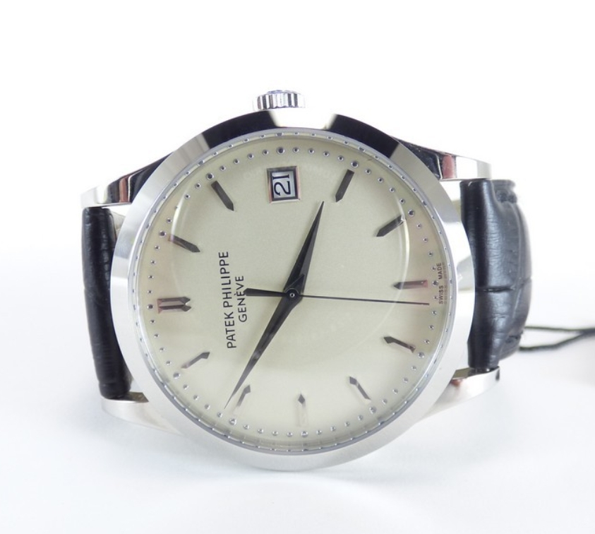

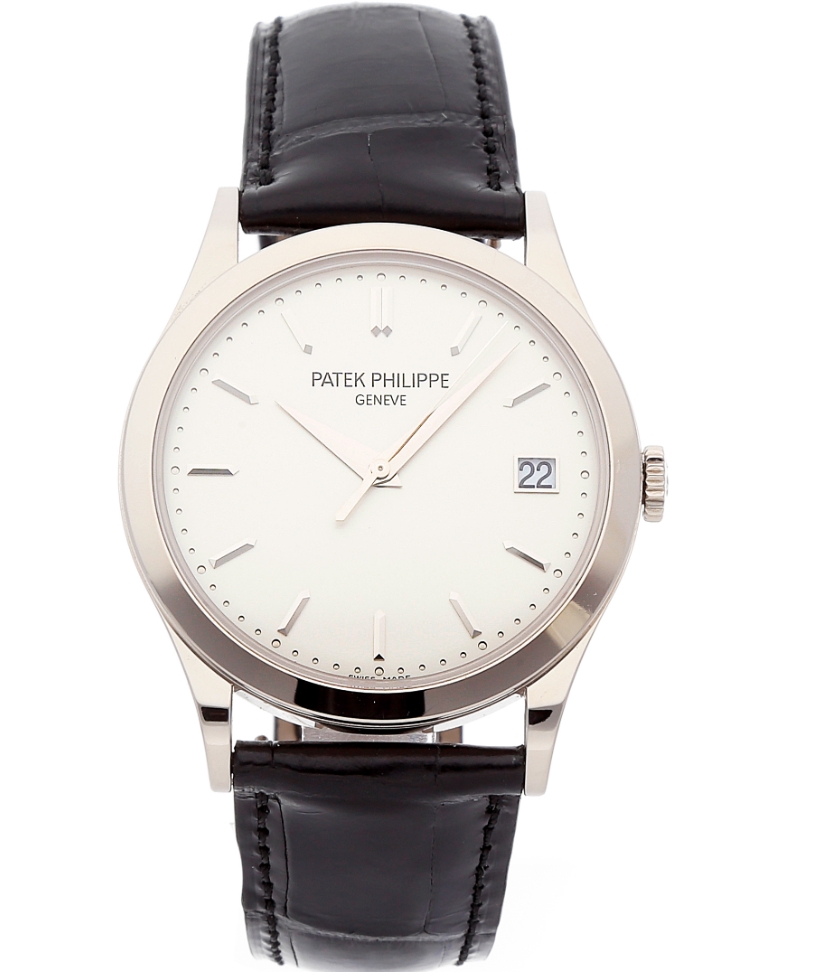

    This was sold recently, for over 8k. They claim to have had it authenticated.
    Problem #1 They say it's stainless steel and not white gold.

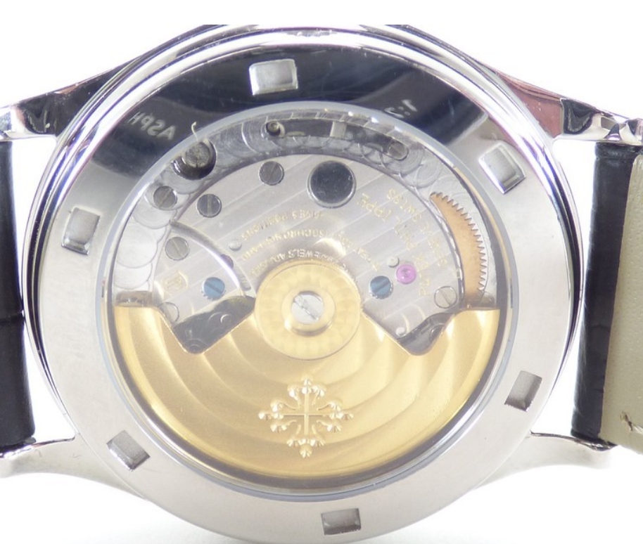

    Problem #2 just look at it. The screw that holds the rotor on..., the poor machine work , and lack of detail ... tell me your thoughts..
    Keep in mind someone paid 9k for this ..
    They Did not know the reference. But it looks to be a 5296g-010

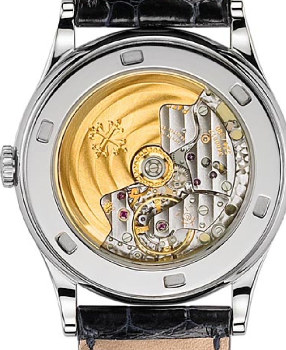

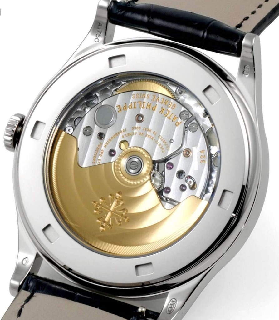

    Screenshot_20190222-183742.jpg Screenshot_20190222-183727.jpg now the real one.
    Edited Feb 25, 2019

    The obvious missed machine work at the 9:30 in the picture is the most obvious tell.

    Like all the fakes that use a plate placed on top of another movement, the most obvious tell is that the jewel that is supposed to be for the barrel arbor has no pivot in it. ::facepalm2::

    If you could serve for educational purposes show me exactly what you're talkin about. I'm pretty sure I understand you just want to make certain
  5. Archer Omega Qualified Watchmaker Feb 25, 2019
    26,343
    65,053
    It’s the only jewel visible. If you look at it, there’s nothing coming through the jewel...
  6. i20rider Feb 25, 2019
    597
    1,330
    Lol yes that is a big indicator

  7. Archer Omega Qualified Watchmaker Feb 25, 2019
    26,343
    65,053
    The advantage of looking at this specific thing is that you don’t need to know what the real movement looks like. If it’s a jewel that has a hole in it and there’s nothing in that hole, then this should be a big red flag...

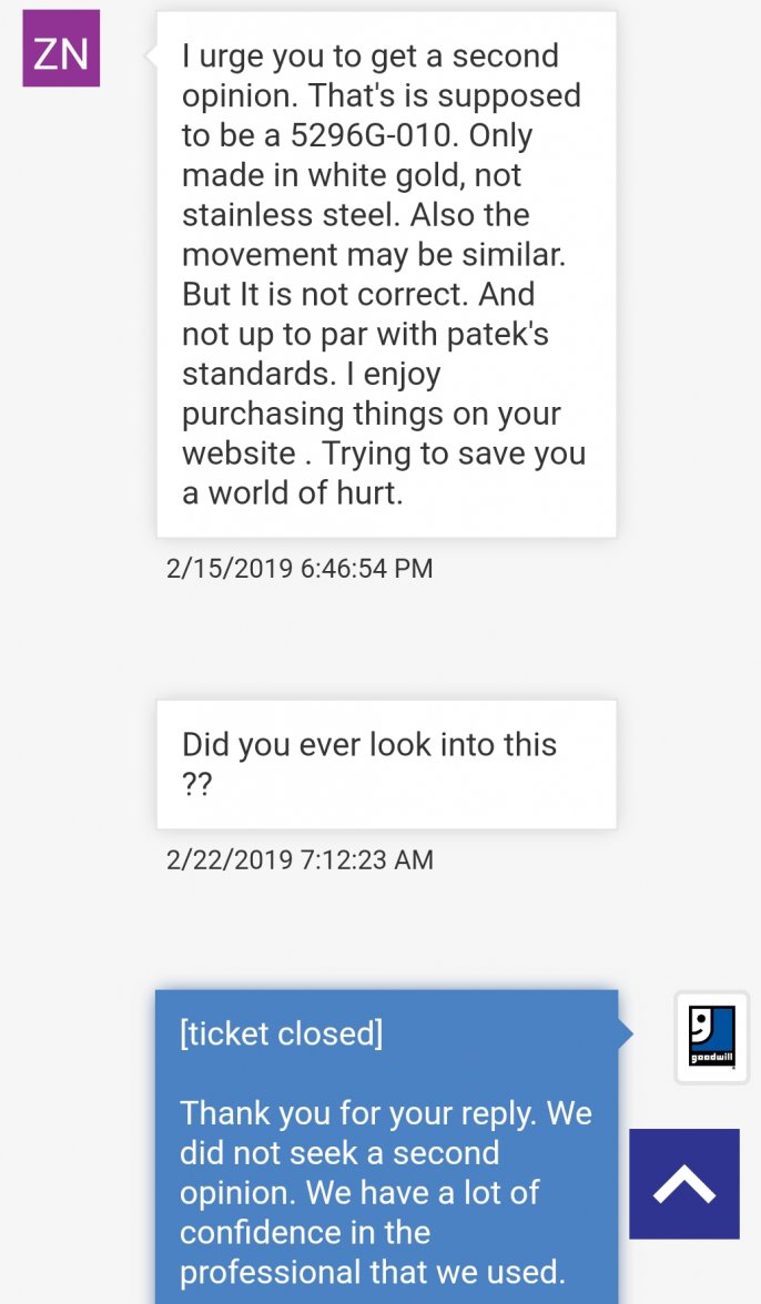

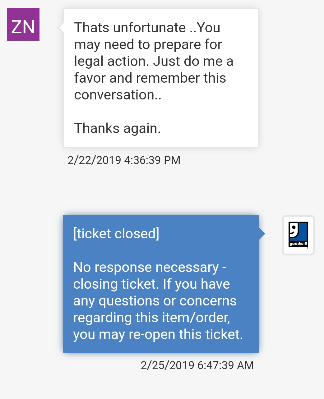

    Believe it or not it was Goodwill. I messaged them letting them know it was a fake a few days bf the auction ended , and was basically told to f*** off. they stated that it was authenticated and came with an appraisal that was guaranteed. Of course that was listed above there disclaimer saying all sales are final and no returns. Urge them not to take my word for it but to get a second opinion. They responded no thank you we trust our Jeweler
