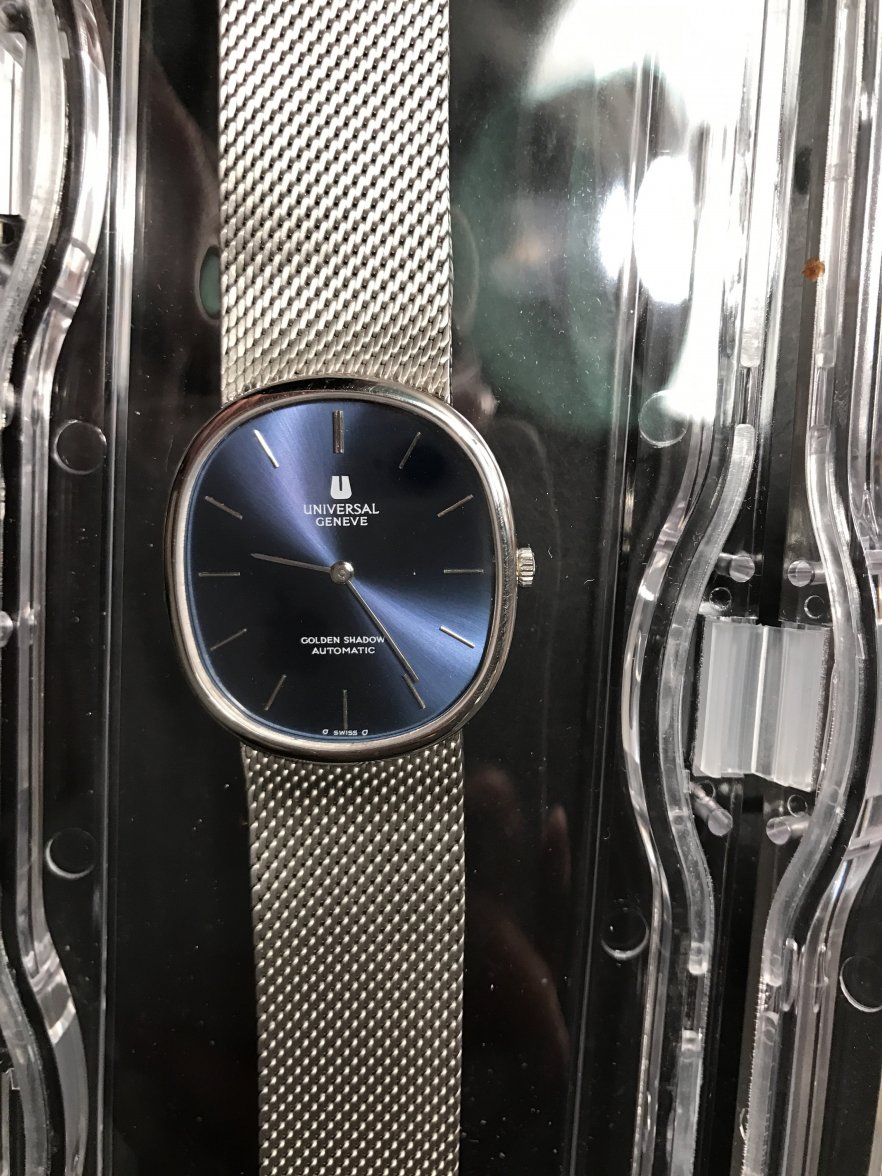

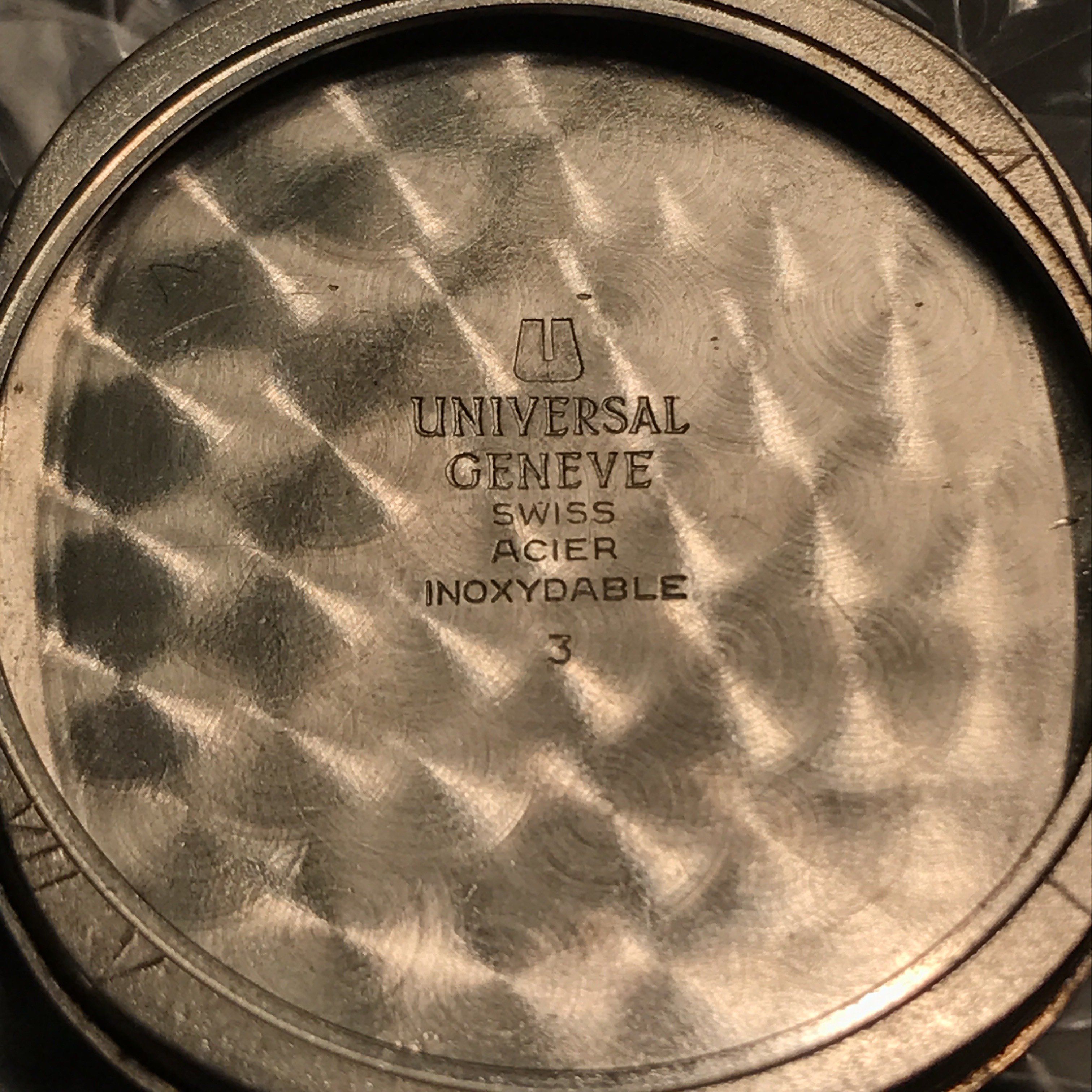

    Hi Everyone,

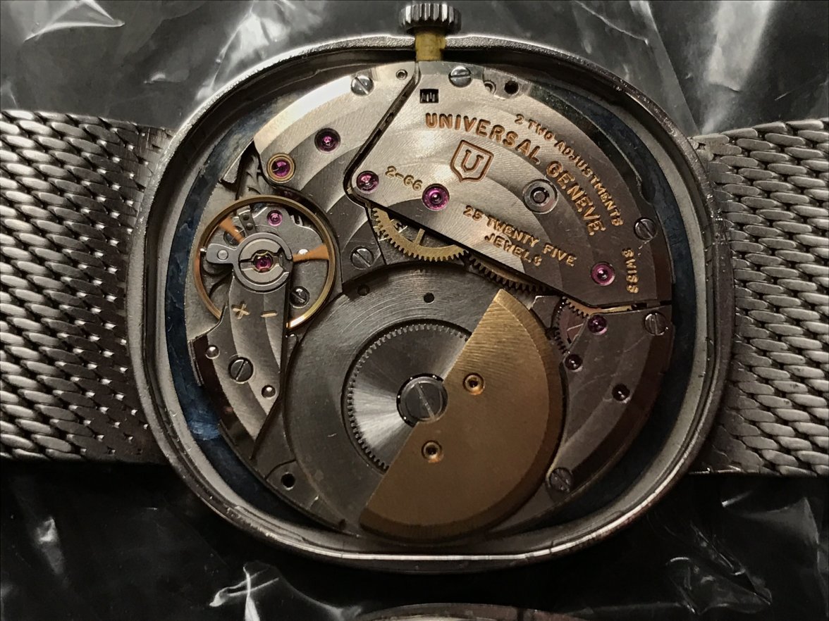

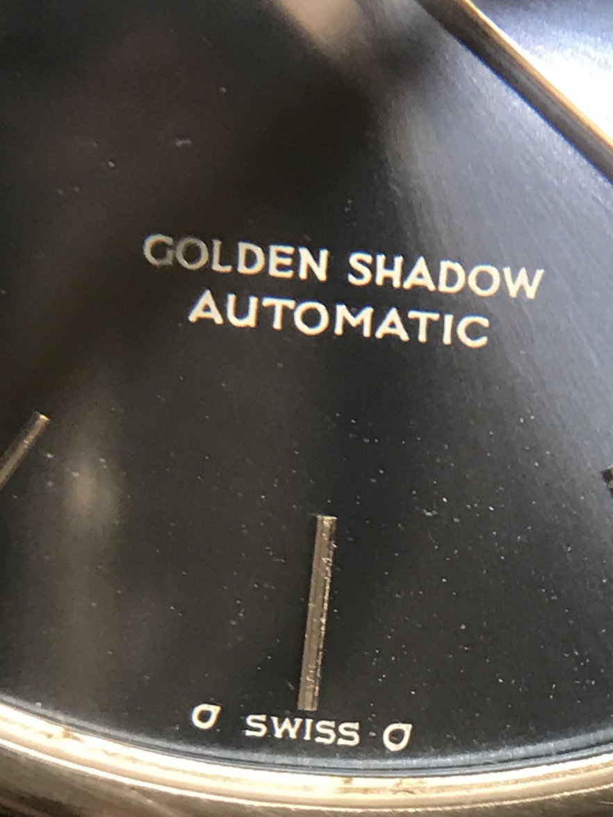

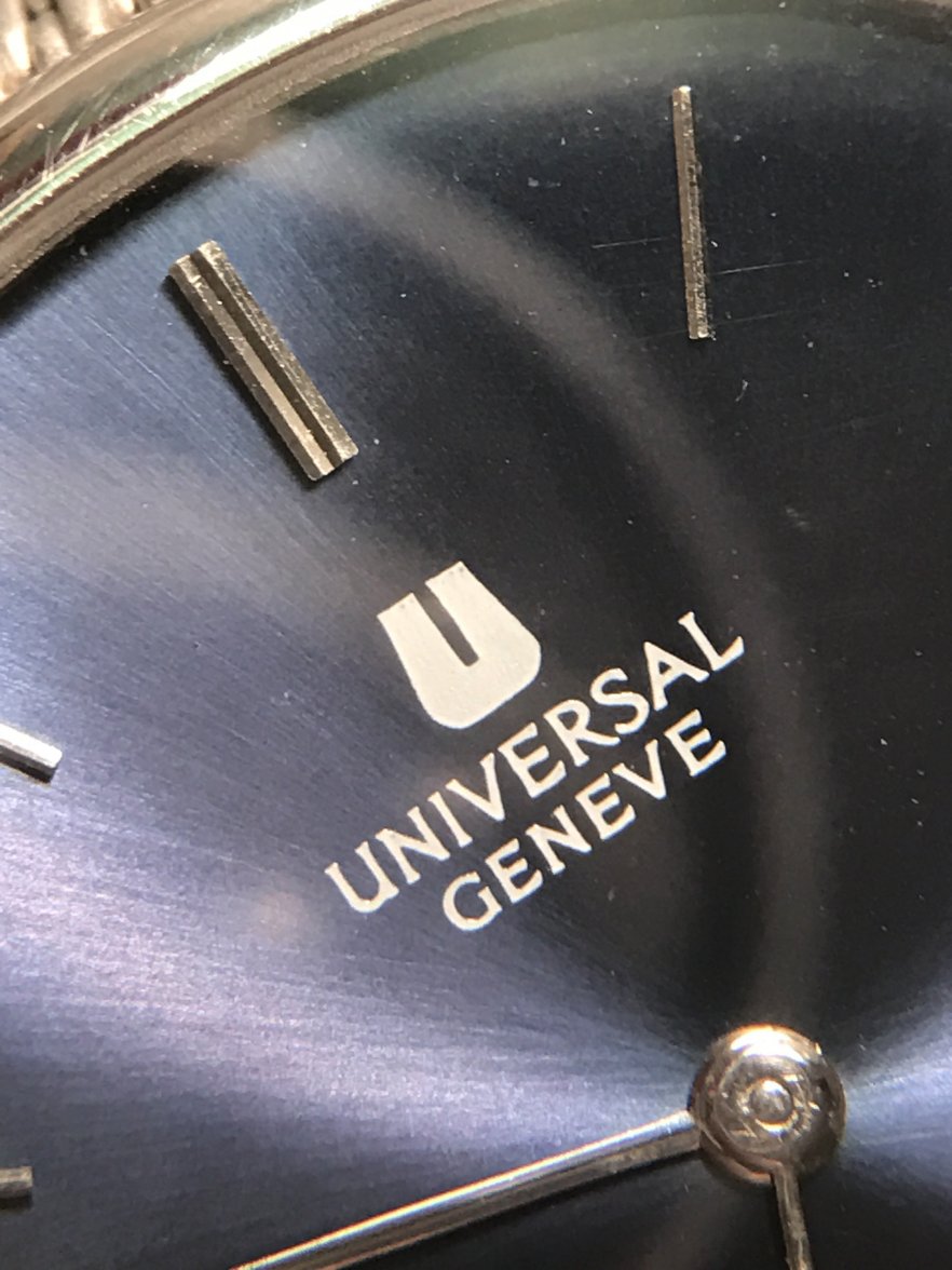

    I purchased this Universal Geneve "Golden" Shadow on ebay, I found the listing from a seller with 100% positive feedback and the price was a third of a similar Shadow model I was looking to buy, so I hastily bid, all be it a low number. Soon after, I realized I had had maybe made a mistake, a few things didn't look right about it. More people bid after me but in the end I was still the highest. The watch arrived today and works quite nicely, the movement seems correct, and quite beautiful, but the dial seems very suspect. Here are some photos:
    I feel pretty dumb about this, my assessment is that it's a White Shadow with a repainted dial (why?!). The sigma marks seem especially inappropriate. I was hoping on getting some second opinions from all of the knowledgable folks on this forum.
    Thanks.

    No worries - I believe it is indeed an original dial.

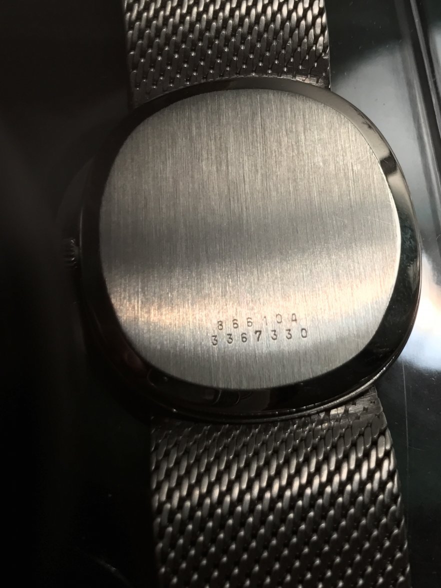

    Thanks for the replies. I don't know a lot about Universal. I've read that the Golden Shadows came in a gold case, and the White Shadow in a stainless steel case. This case appears to be stainless steel:
    That's the foundation of my suspicion. Acier Inox = Stainless Steel, but dial says Golden Shadow. How come?

    I have no reason to believe that the dial isn't completely original but is it more likely that somebody has re-cased a Golden Shadow (presumably from a scrapper) movement and dial into a White Shadow case? I can't say that I've spent a great deal of effort tracking these on Ebay as I am only interested in this (to me Patek Ellipse-like) case-shape with lugs that would allow a leather strap but I'd have a good trawl to see if this case shape has also been made in gold.

    If I've found the listing it would seem that the seller is suggesting that the dial is re-finished but I'm not sure I agree - probably a bit of @rse-covering. To be fair he does state the watch is stainless steel.
    Looking at these two watches I would say there's a good chance this shape was also made in gold and somebody has done a swapsy.

    That dial doesn't belong to that case. That's for sure.

    The dial looks good but doesn't belong to that case. A Golden Shadow should have the reference 166xxx if YG or 366xxx if WG. A case with the reference 866xxx is a White Shadow case

    That makes sense, guess I'm in the market for a white shadow dial at some point. At any rate, the watch was still a bargain and works great.
