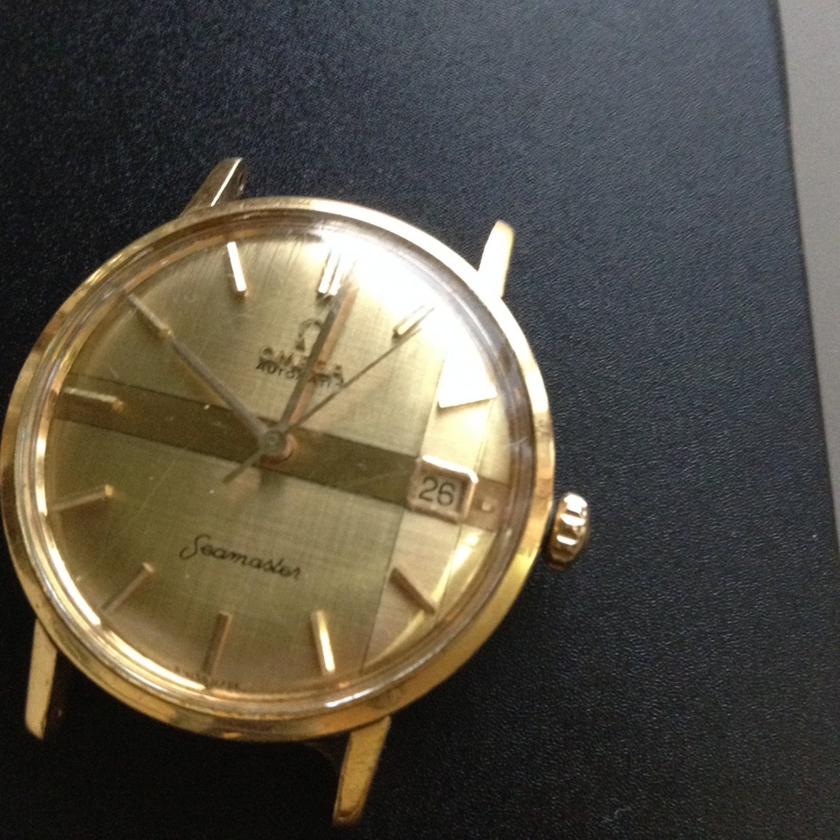

    Hi fellows,
    Coming up is a deal with this Seamaster, which has a 18K gold case and this dial ... the seller's photos are bad, and he is also not sure if the dial is solid gold or not, so... what do you think?

    by the way, I have seen steel version of this one, and the dial was white (of course) :)
  3. peire06 Oct 10, 2017
    585
    281
    The only way for you to know for sure is to ask seller to take picture of the back of the dial. If it is gold there will be a gold marking in the back of the dial. Not sure seller will accept though.

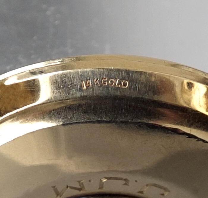

  7. kreyke Oct 10, 2017
    626
    838
    It should have 14k gold marked between lugs if it’s a monocoque case iirc

  9. JimInOz Melbourne Australia Oct 10, 2017
    15,398
    32,153
    Solid gold Omega dials I've seen are marked with "OM" (Or Massif) either side of the "SWISS MADE".
    I'm not sure if all Omega solid gold dials followed this marking rule though.
    And I suspect that this one has been redialed anyway.
  10. tdn-dk Oct 10, 2017
    1,717
    14,547
    Looks like the gold is worn off the lower lugs :)

  13. tdn-dk Oct 10, 2017
    1,717
    14,547
    Well, i cant say for sure but IMHO it looks like a GP case

  14. baoquang Oct 10, 2017
    343
    633
    the case is solid gold, but its condition just does not worth it... thanks all... still, the dial is a mystery, but I am almost sure it is not gold

  16. ConElPueblo Oct 10, 2017
    9,587
    26,961
    Did you see a hallmark? The dial looks a bit like those slightly adventurously designed American cased Seamasters which were also available in gold filled varieties...
