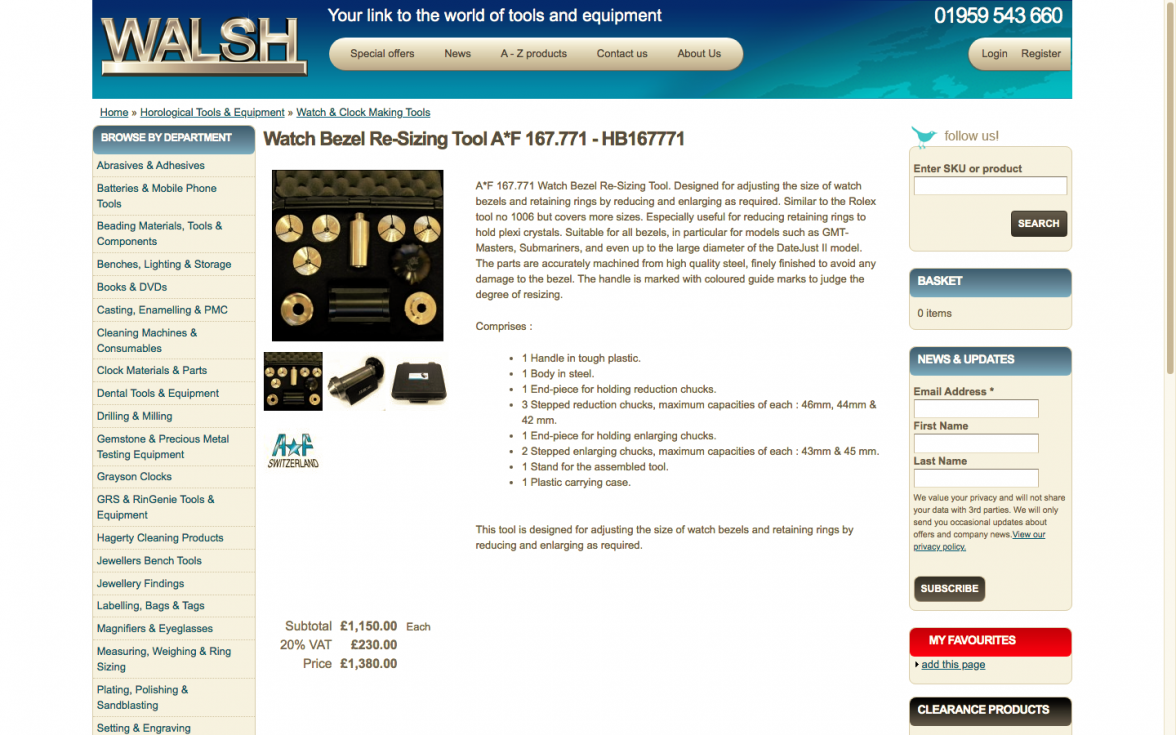

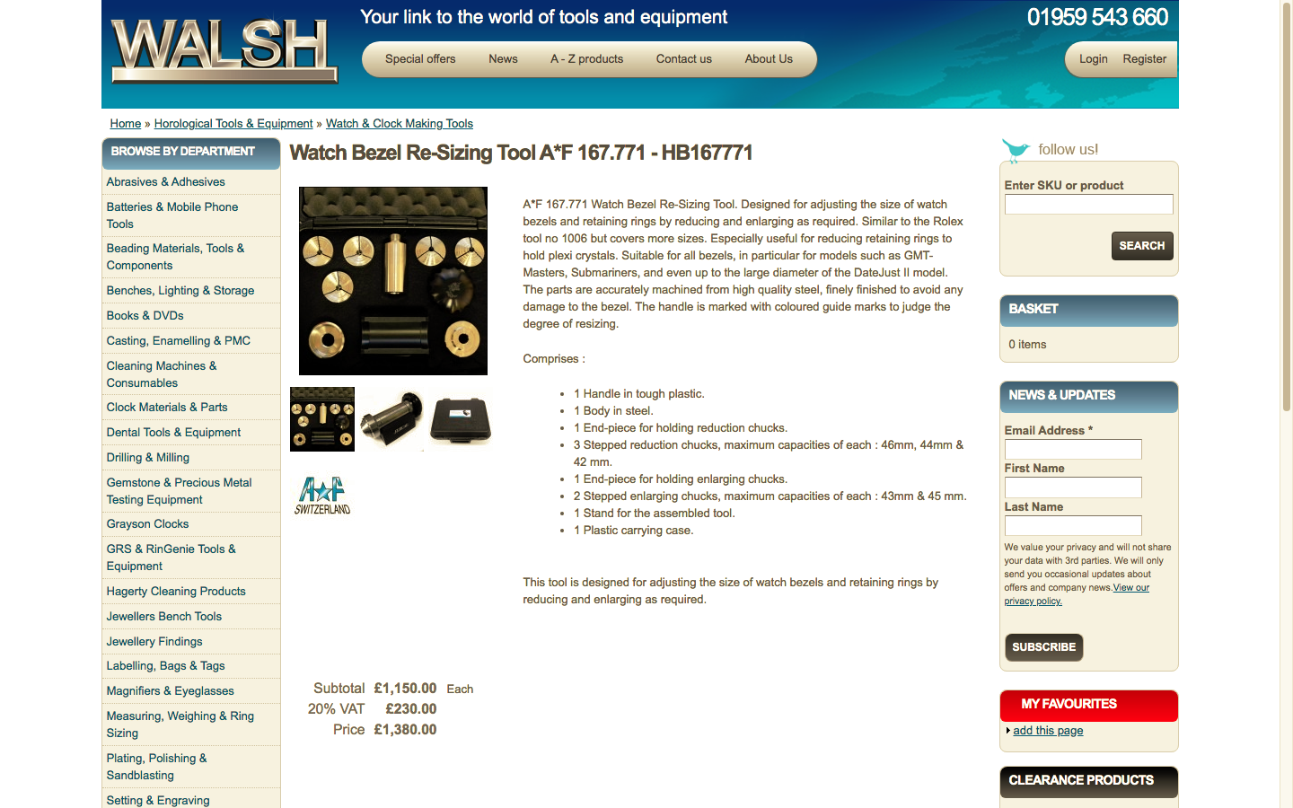

I know that my watchmaker has a Rolex tool like this (and obviously it can be used on non-Rolex bezels), but I'm wondering if there also generic bezel adjusting tools made by third party manufacturers (e.g. Bergeon)? I'm just curious, since this doesn't seem to be something that every watchmaker has in his shop.
