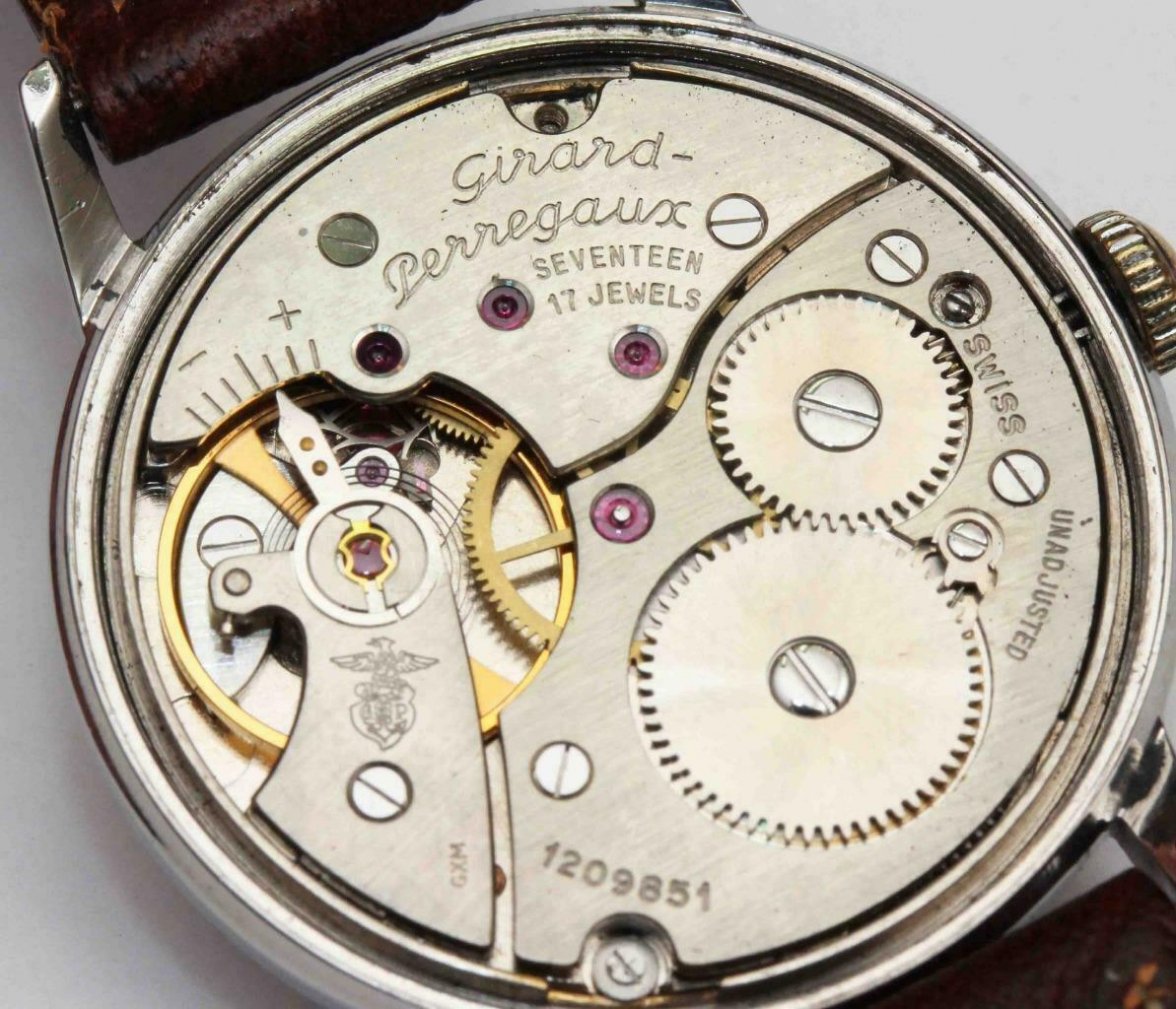

    Also, here's a complete nube question: Is the number 1209851 on this movement (from the ebay listing) a movement series number or individual serial number? I ask because I saw another Sea Hawk of this vintage (but with a different dial) with the same number on the movement (https://www.ebay.com.sg/itm/Mens-Or...-S-Vintage-Swiss-Made-17j-Watch-/382548297596Purchases made through these links may earn this site a commission from the eBay Partner Network) . sea-hawk-ebay-mvt.jpg

    Girard Perregaux watch movements of this era did not have true serial numbers, unless they were chronometers.
    The number on the movement represents the caliber number “12(.)09” and the production run. So there will be many watches with the same “serial number”.
    It may be possible for GP to get an accurate production date from the production run info. However, the do charge for the service.
    For mere mortals, the best way to date a GP is to consult a movement database like Dr. Ranfft’s Pink Pages. Here is info on the cal. 12.09:
    http://www.ranfft.de/cgi-bin/bidfun-db.cgi?10&ranfft&2&2uswk&Girard-Perregaux_12_09
    If you are lucky it will have a range. This listing shows “ca. 1960”. Probably as good as you will get.

    I’ve had good luck by bookmarking this site:
    http://www.ranfft.de/cgi-bin/bidfun-db.cgi?10&ranfft&a&2uswk
    This is the first page of the movement database.
    Then type your brand name in the search box. You’ll get all the listings for that brand.
