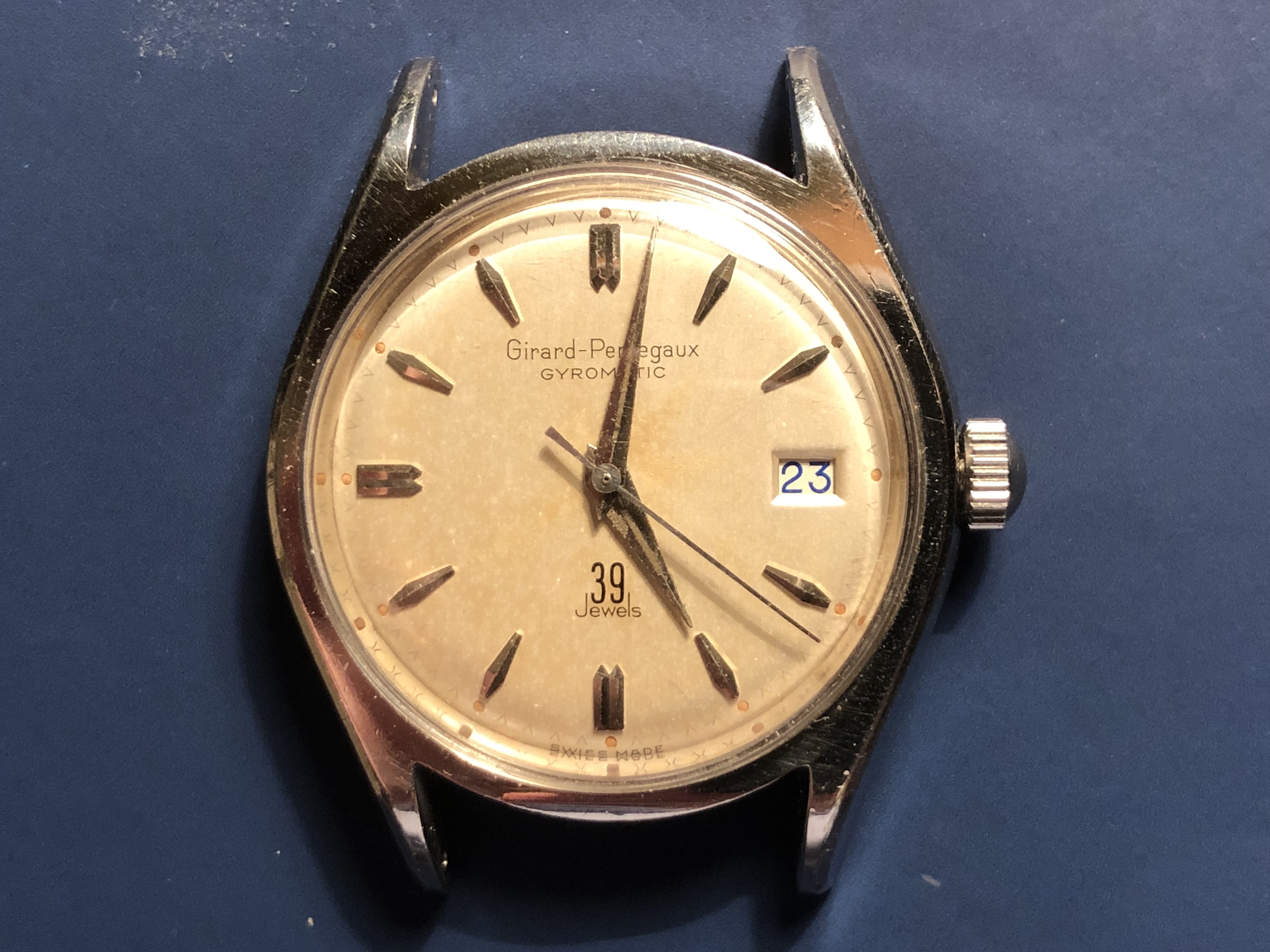

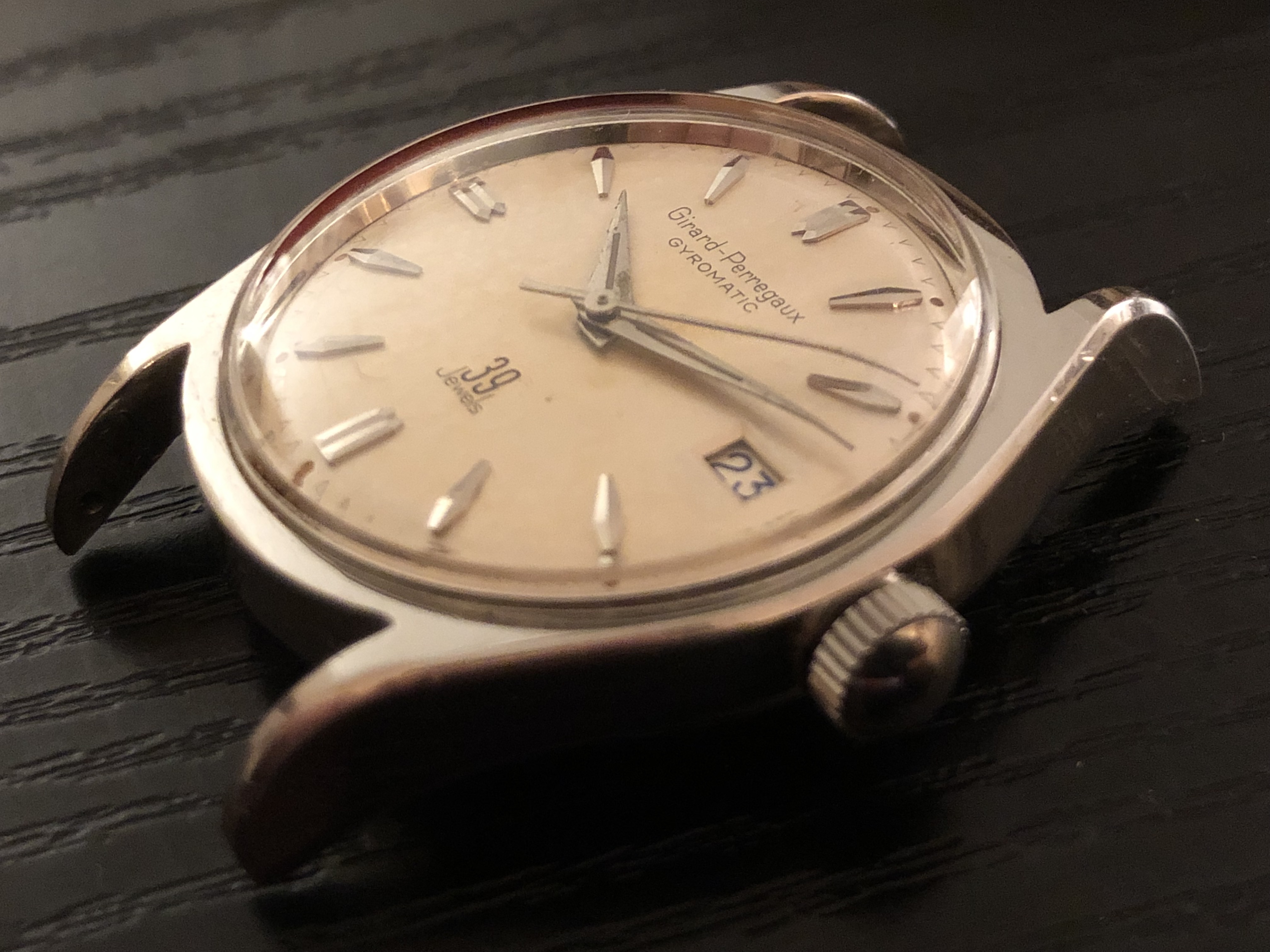

Recently I came across a Girard-Perregaux - Gyromatic:
The watch:

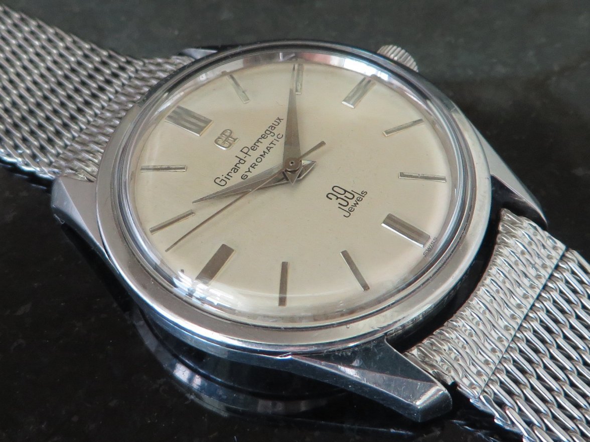

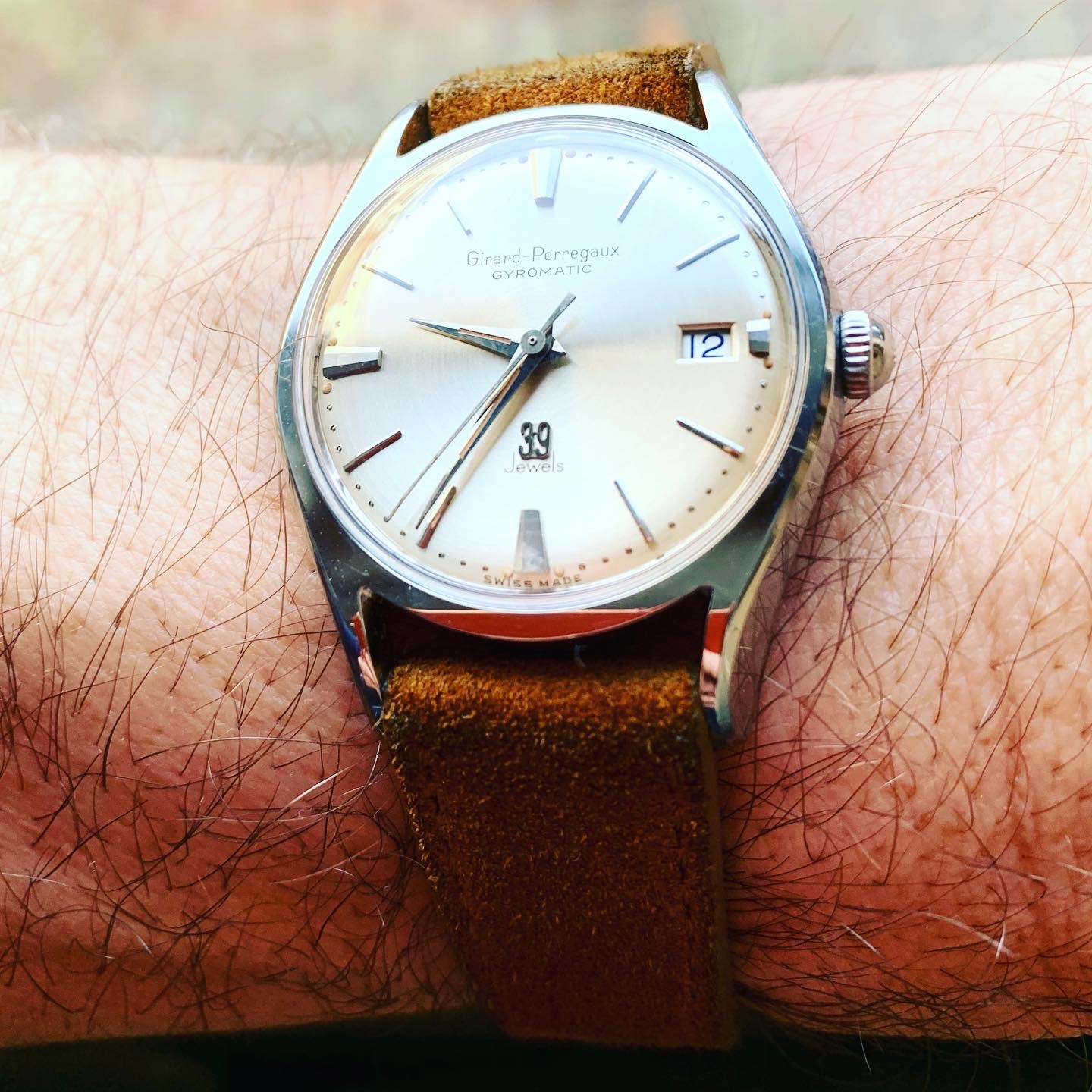

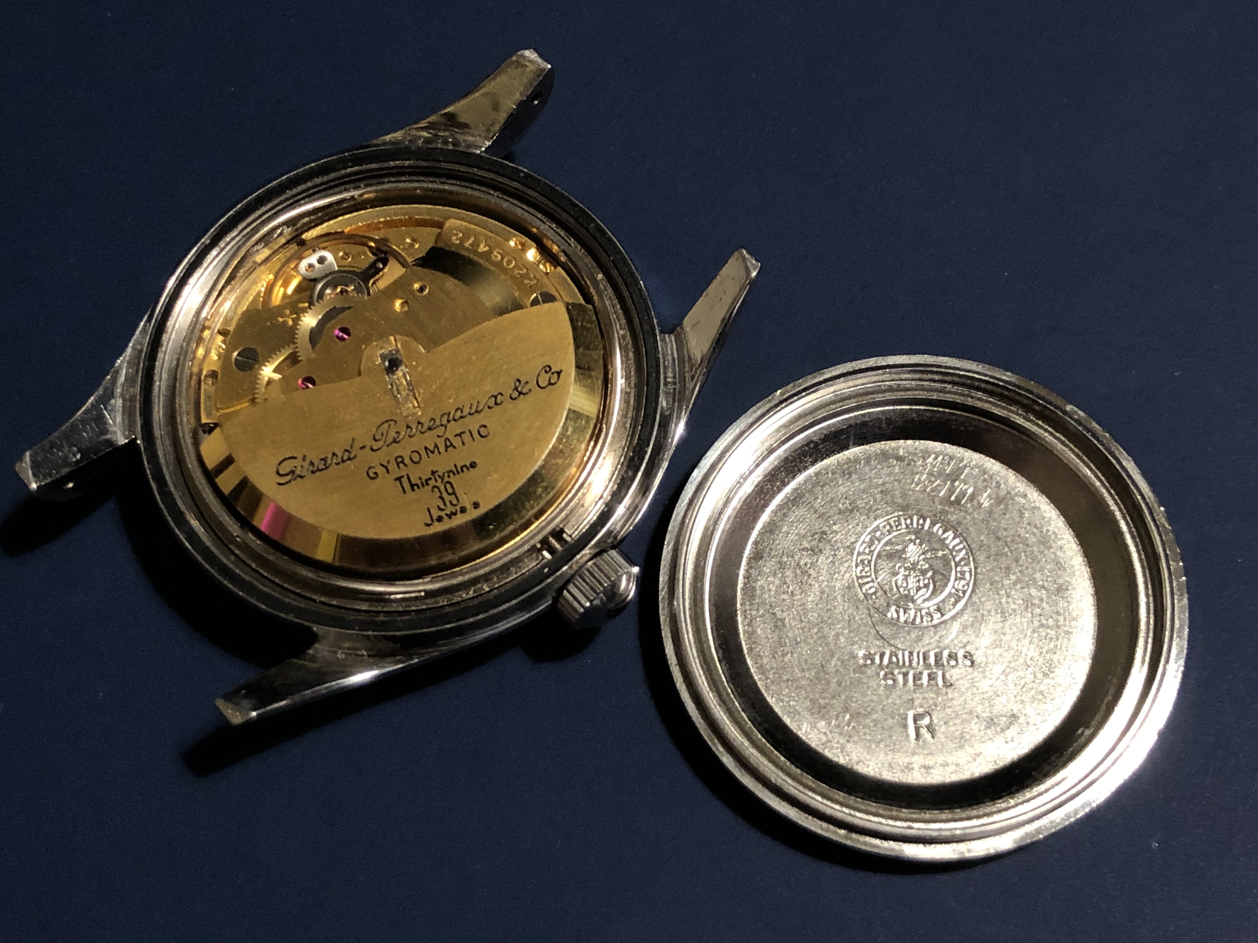

This is a Girard-Perregaux Gyromatic ref. 7317 from around 1958. This model houses a caliber 21, 18.000 vph, with 39 jewels. With a diameter of 34mm and lugsize of 18mm it wears very comfortable. Unfortunately the crown isn't original anymore, but the case seems in good condition. The dial is difficult to capture, has a nice radium burn, applied indices and a very nice blue date wheel.
I wasn't familiar with a "Gyromatic", so I started to read something about it. On different sites are different bits and pieces written about this model. I'll try to combine the essence of those bits an pieces to explain what the Gyromatic is. 😀
The photos of advertisements used below are from Blomman (link: https://www.watchprozine.com/girard...girard-perregaux-gyromatic-39-jewels/8295043/ )
The other photos of the watch are my own.

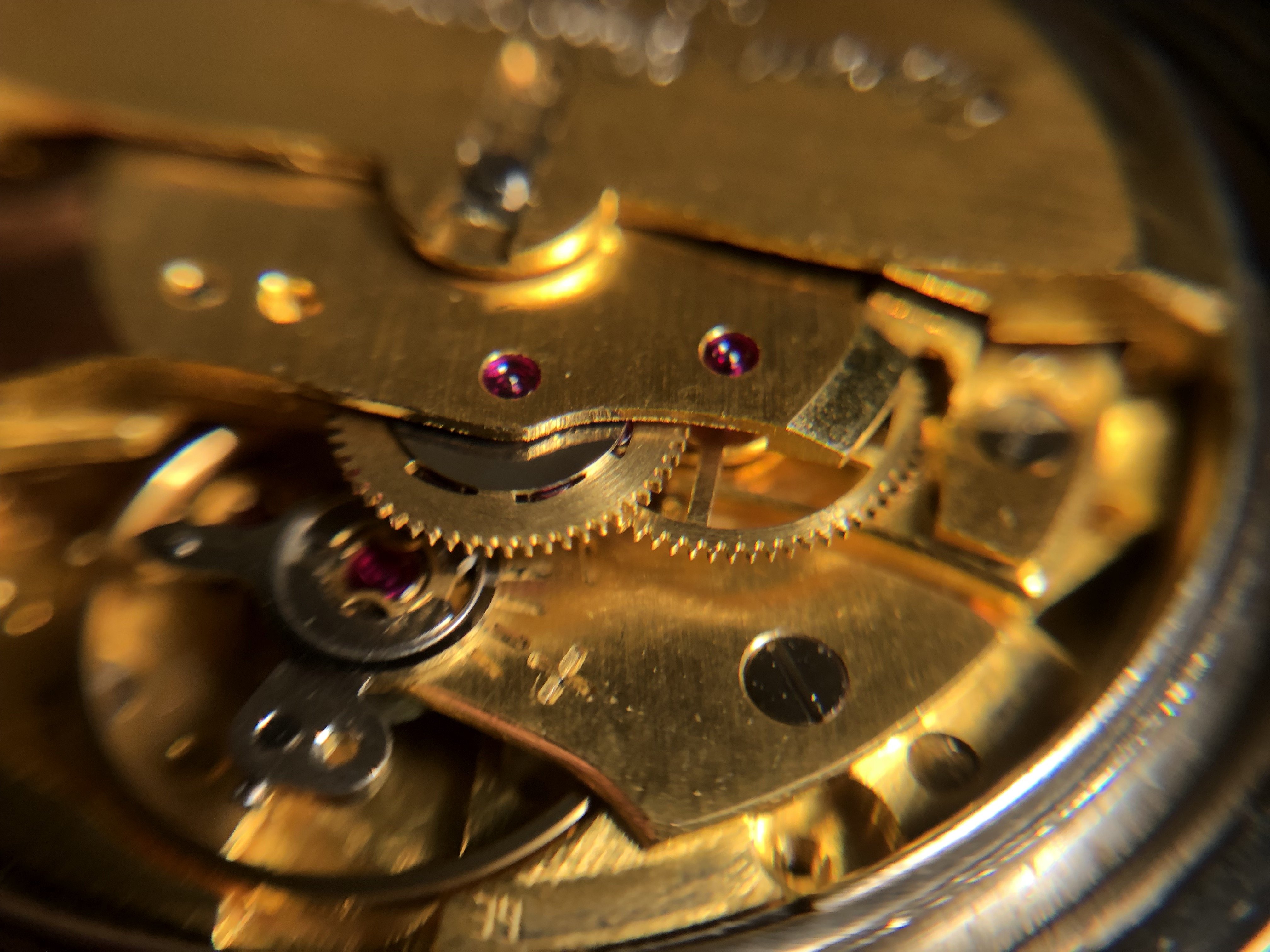

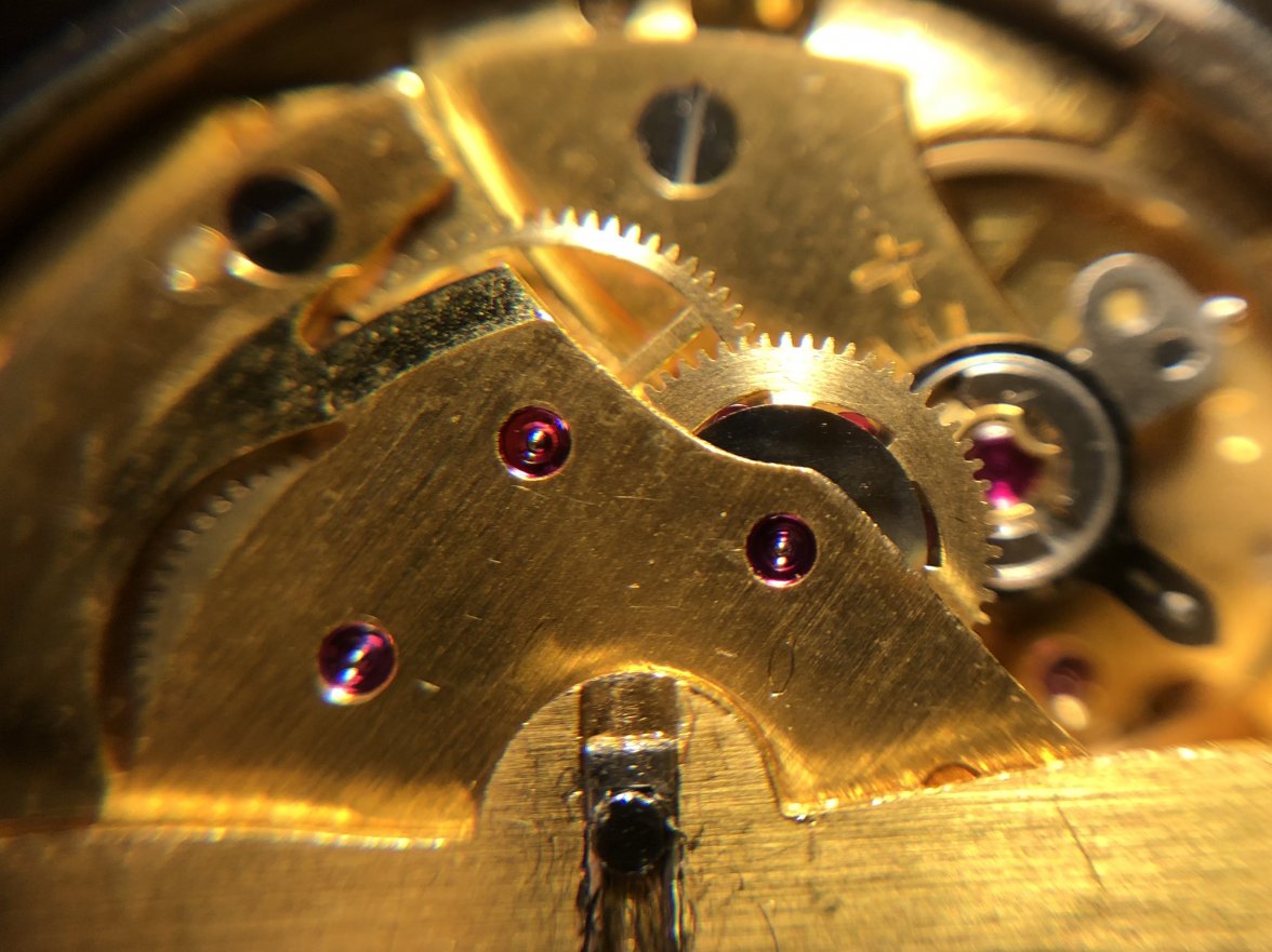

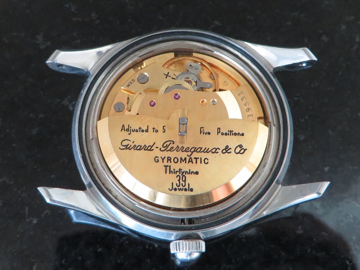

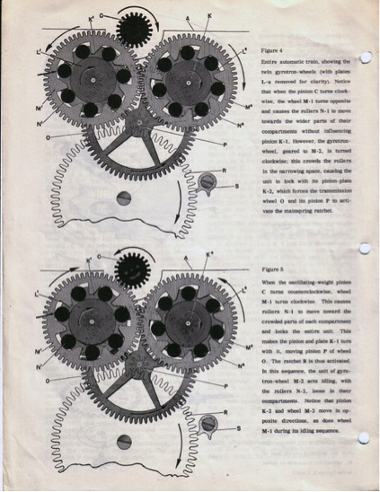

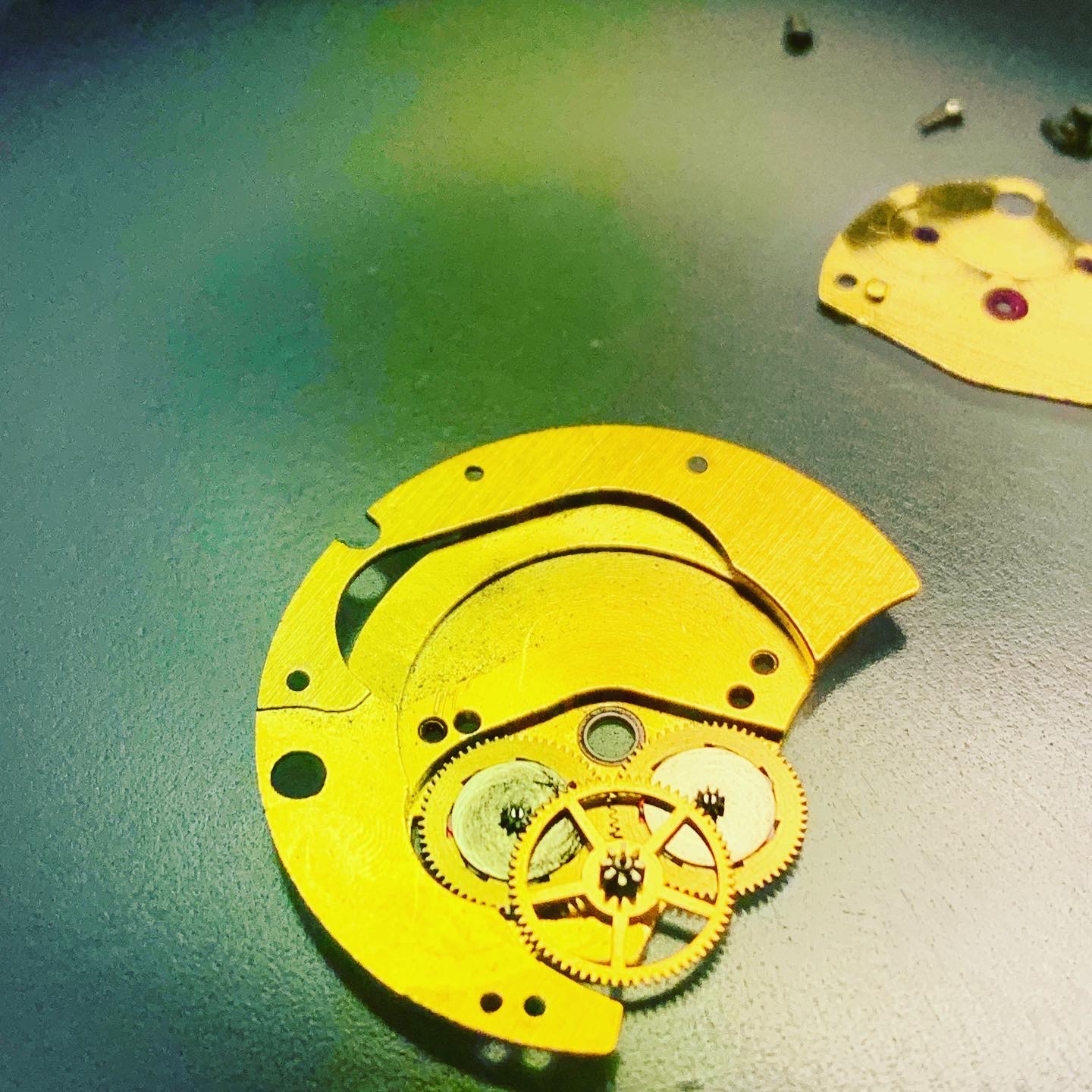

The Gyromatic is a roller-bearing and rotation inverse mechanisme built into automatic watches. This makes the watch bi-directional winding and was supposed to improve winding the watch automatically. The jeweled roller-bearings are between the rotor and the mainspring and reduce friction.

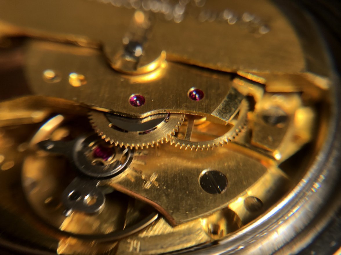

I tried to capture those jewel-rollers on a macro shot, one of which is visible above the balance wheel, the other is closed on the other left side of the bridge.

Jewel counting:
So 14 of the 39 jewels are functioning as a roller bearing between the rotor and mainspring. That leaves 25 jewels in the rest of the movement.

So, are those extra 14 jewels, functioning jewels?
For me, this is unclear. My guess would be that those 14 jewels are non-functioning jewels. I suppose that this is the case seeing GP doesn't produces 39 jeweled calibers and even their tribute to the Gyromatic has "only" 27 jewels. I don't think these jewels improve accuracy, reduce much friction or add to the life expectancy of the watch.
But.. an automatic watch has the highest accuracy when fully wound. The mainspring drives the watch and a constant force would increase accuracy. So if this Gyromatic mechanism would improve the winding it would theoretically add to the accuracy of the watch, right?

And some photo's of my own:

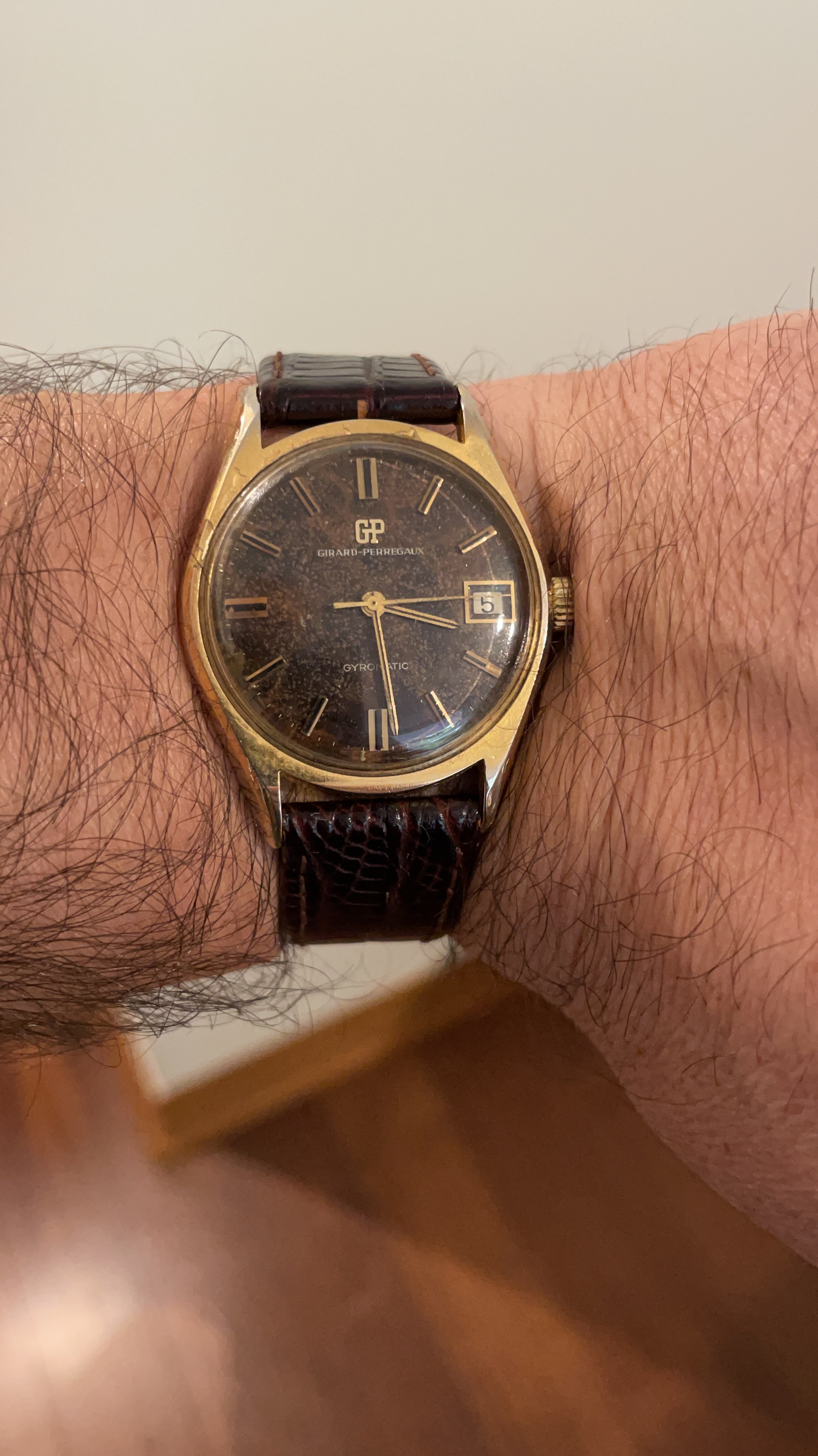

I've worn a Gyromatic for the last week. It wears comfortable on the wrist, I love the dial and the blue date. The applied indices are a real light catcher. I don't notice the Gyromatic mechanism winding the watch more efficiently than other watches I wear. But I like the idea of this mechanism!

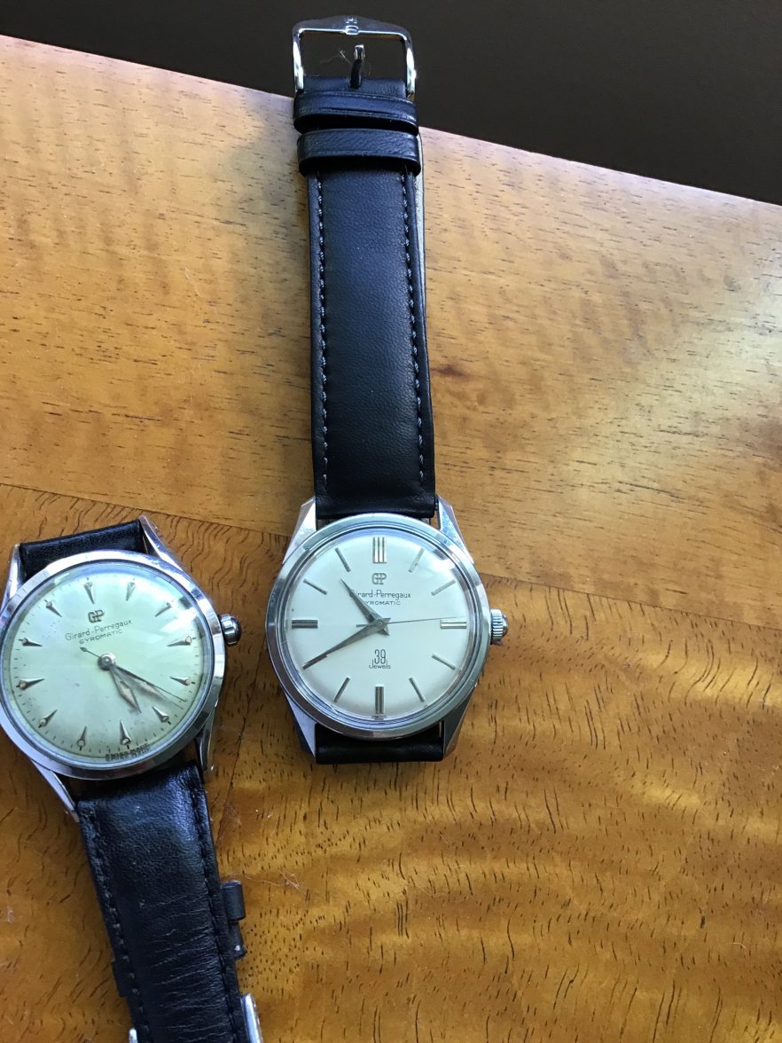

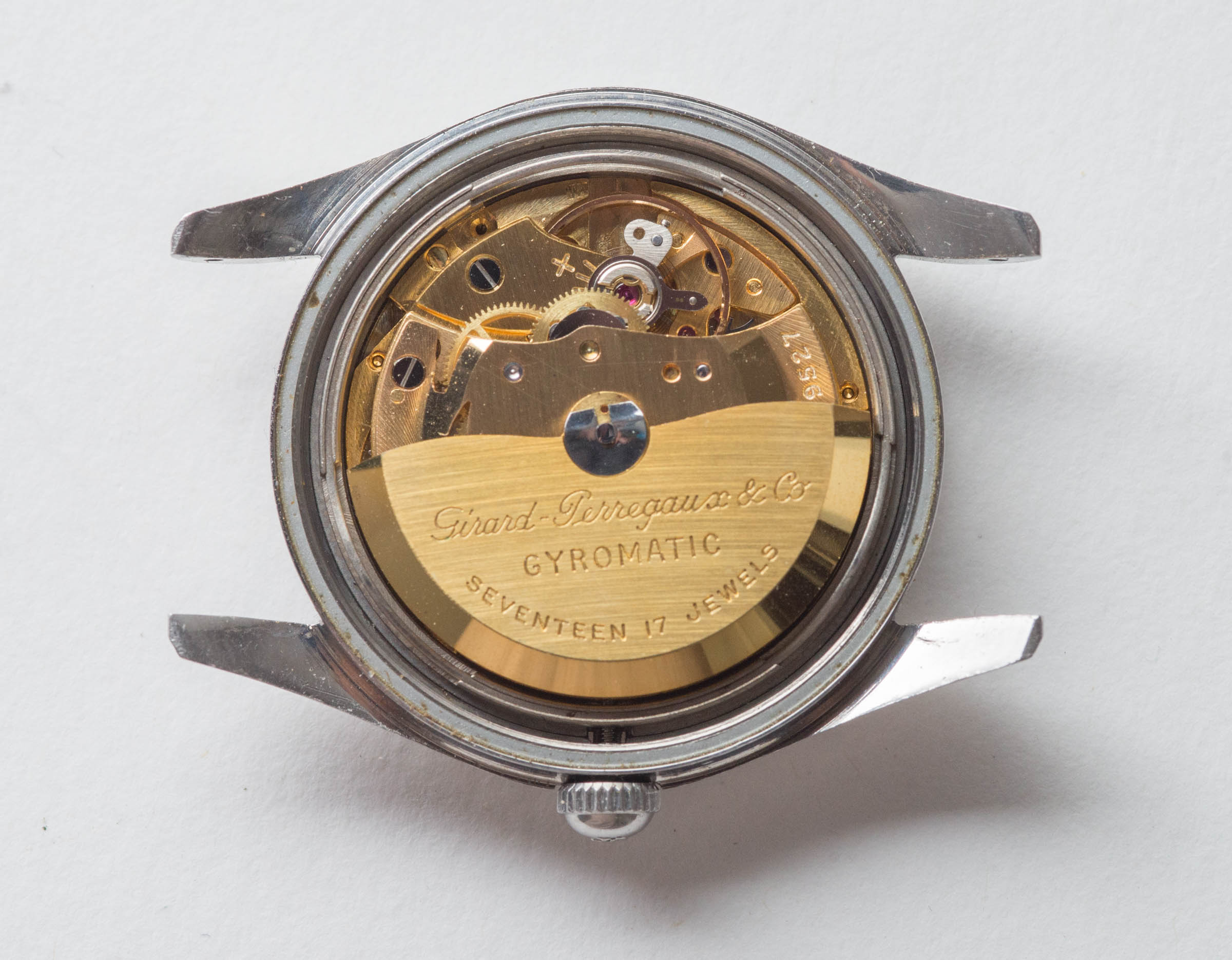

Great write-up. This made me curious about an old Gyromatic in the random watch drawer. Not 39 jewels, though. I looked around and didn't find a serial number database. How did you date yours?
Obligatory pics:

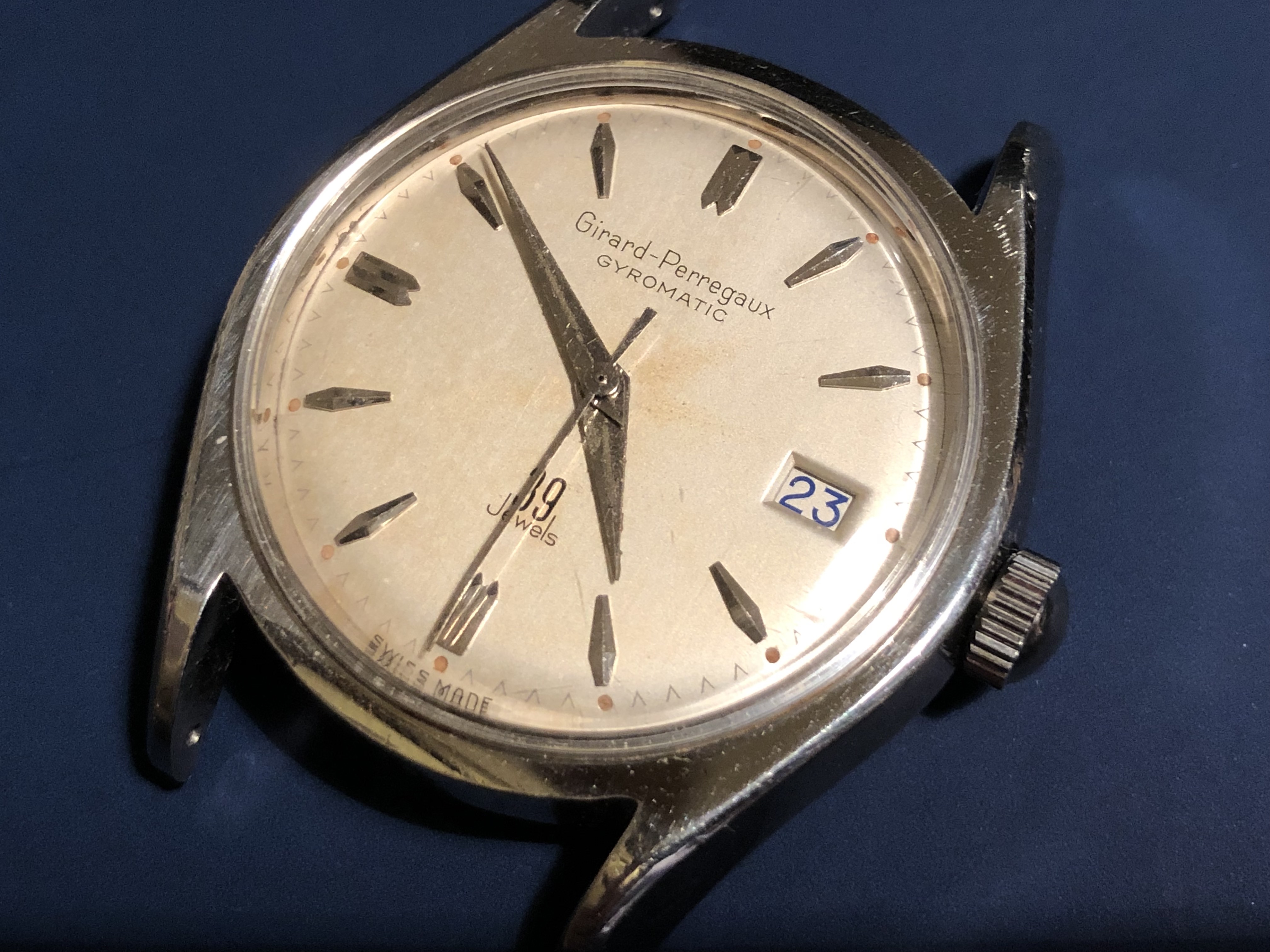

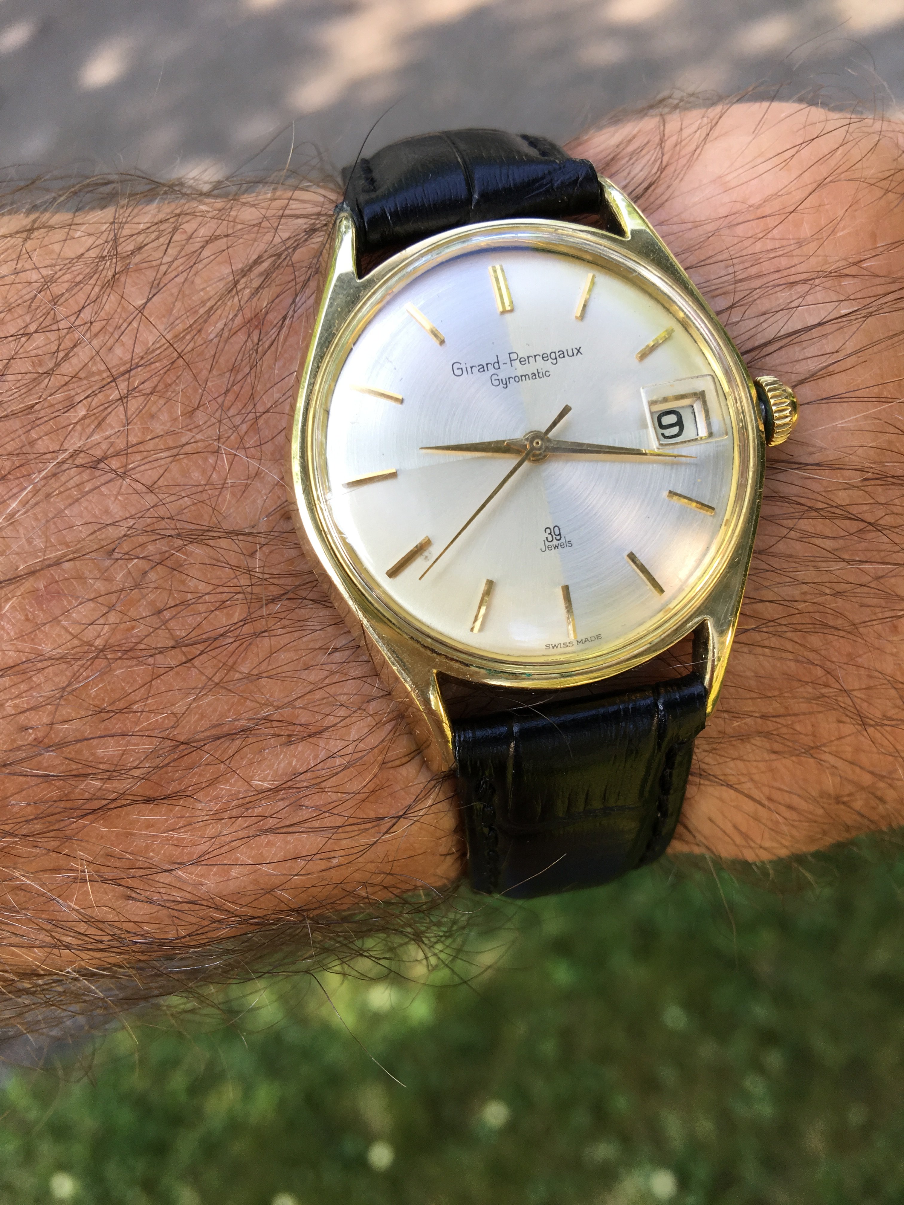

Mauzer,
This is a beautiful watch! Wonderful research that you have done too.

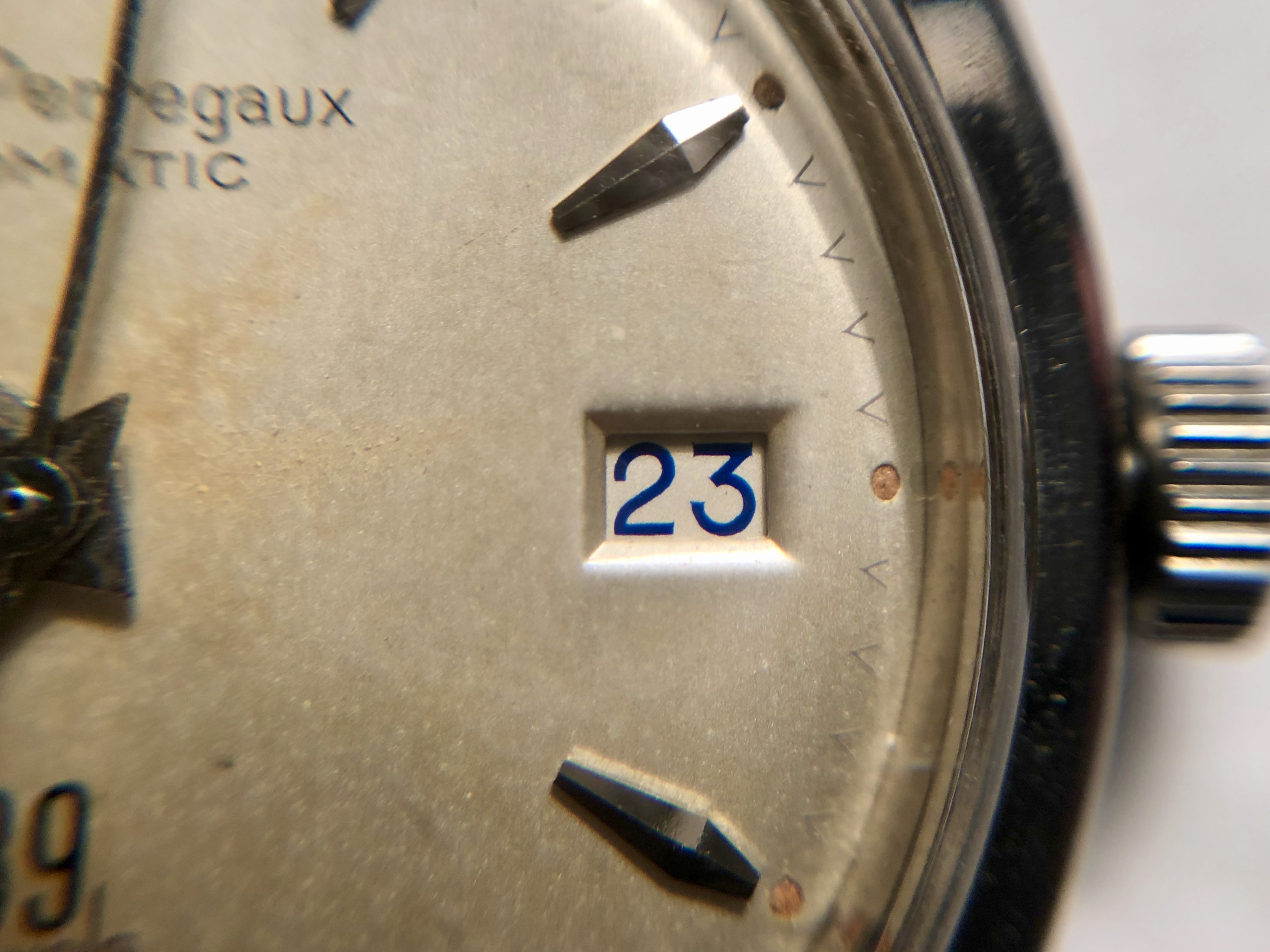

I just recently acquired one nearly identical to yours - but small details of dial are just a little different.
I am not familiar with the GP movements at - but now that I have one in hand - it seems this date complication has no quick-set feature, correct?
I'm under the impression that the quick-set feature was a "later" addition to the date complication, and so I won't be surprised if this has no quick-set (seems the stem only has two positions - winding and time-set).
Lovely watch. When I get some time, I will post pics of mine.
-Paul

Hi Paul, thank you! Appreciate it, but also like to read it back for my own watches, every once in a while. Haha
I just double checked with mine: correct, it doesn’t have a quick-set feature!
I’m curious about your gyromatic! Post some pictures whenever you’ve got some time for it!

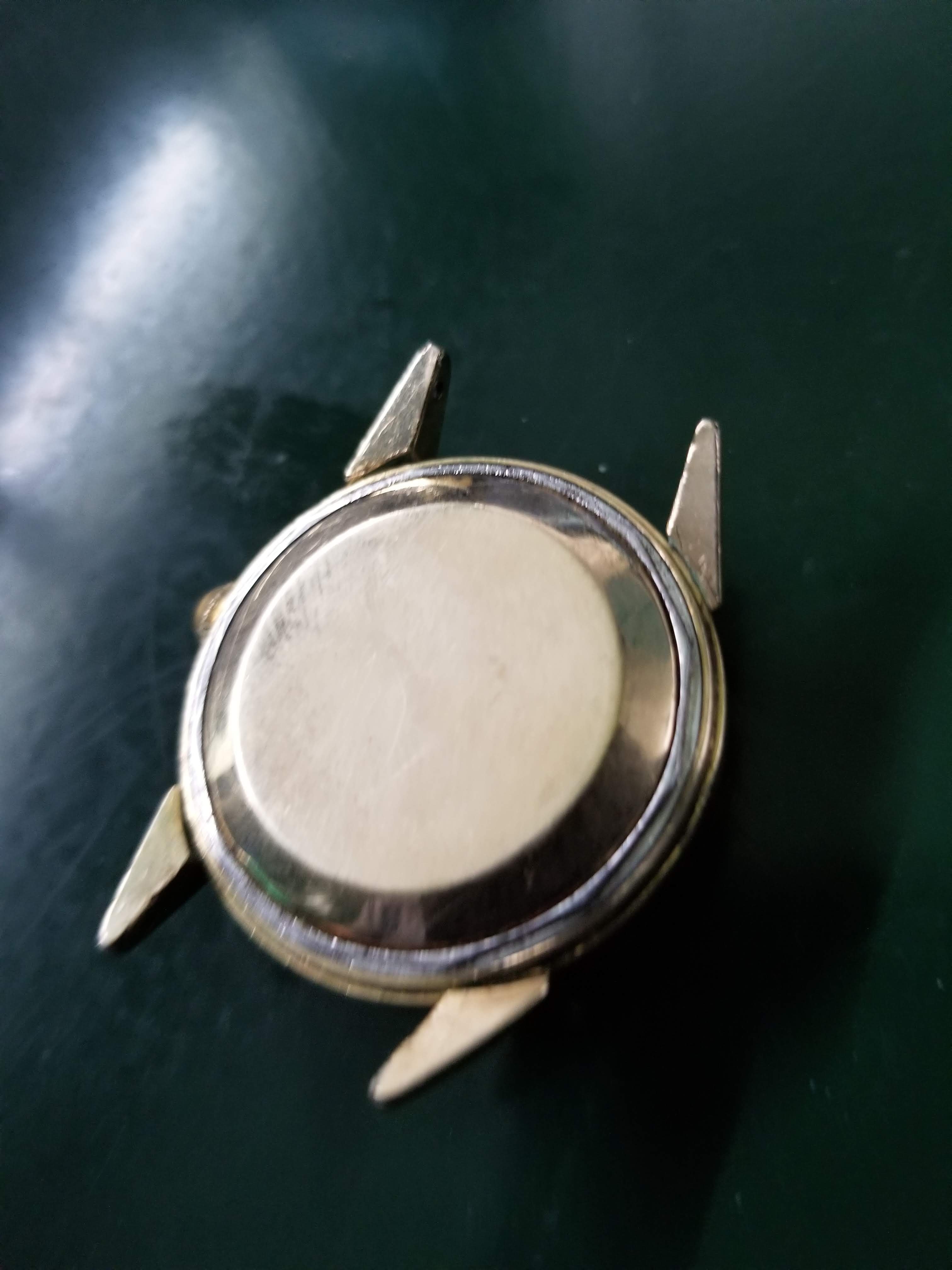

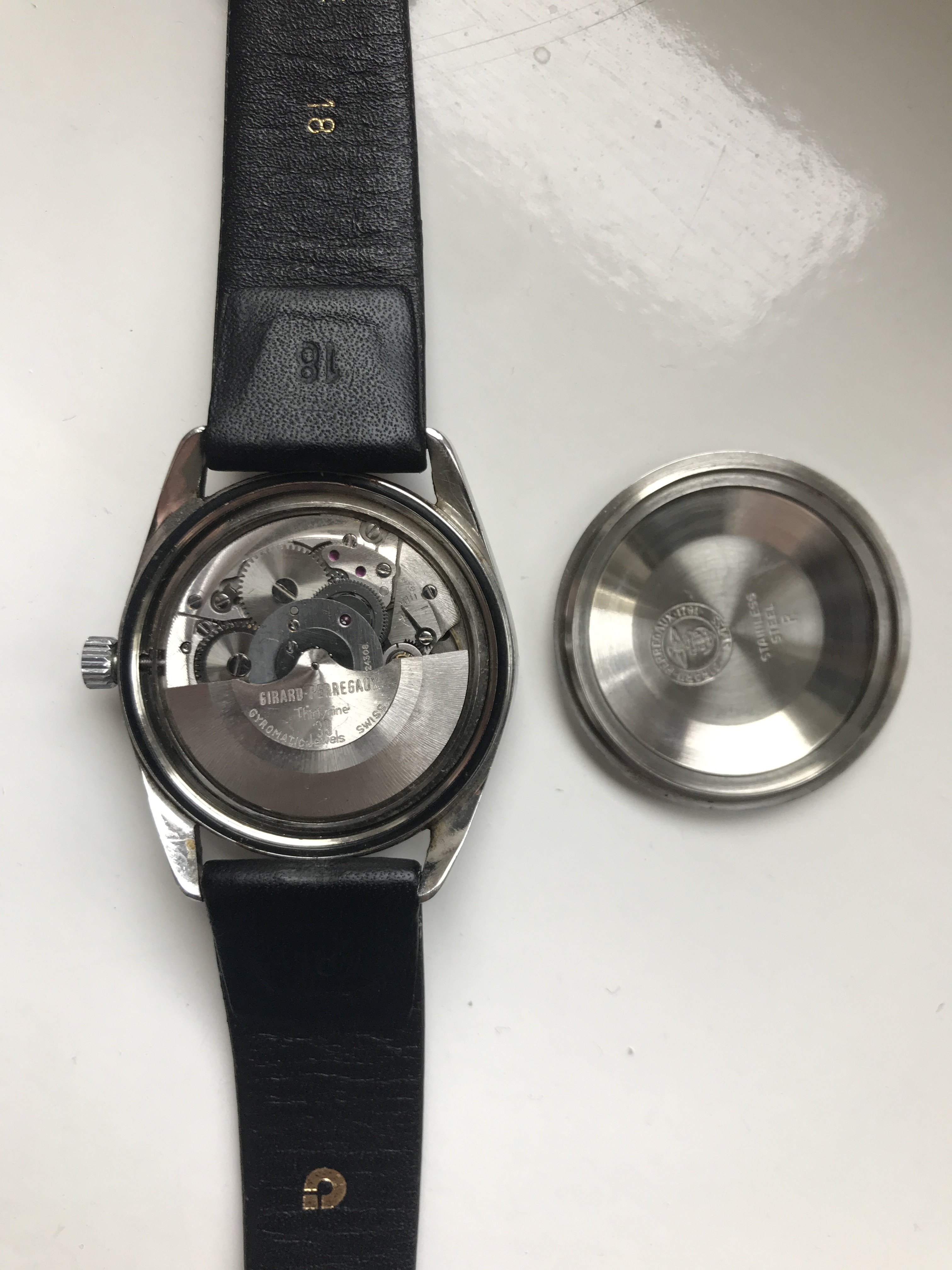

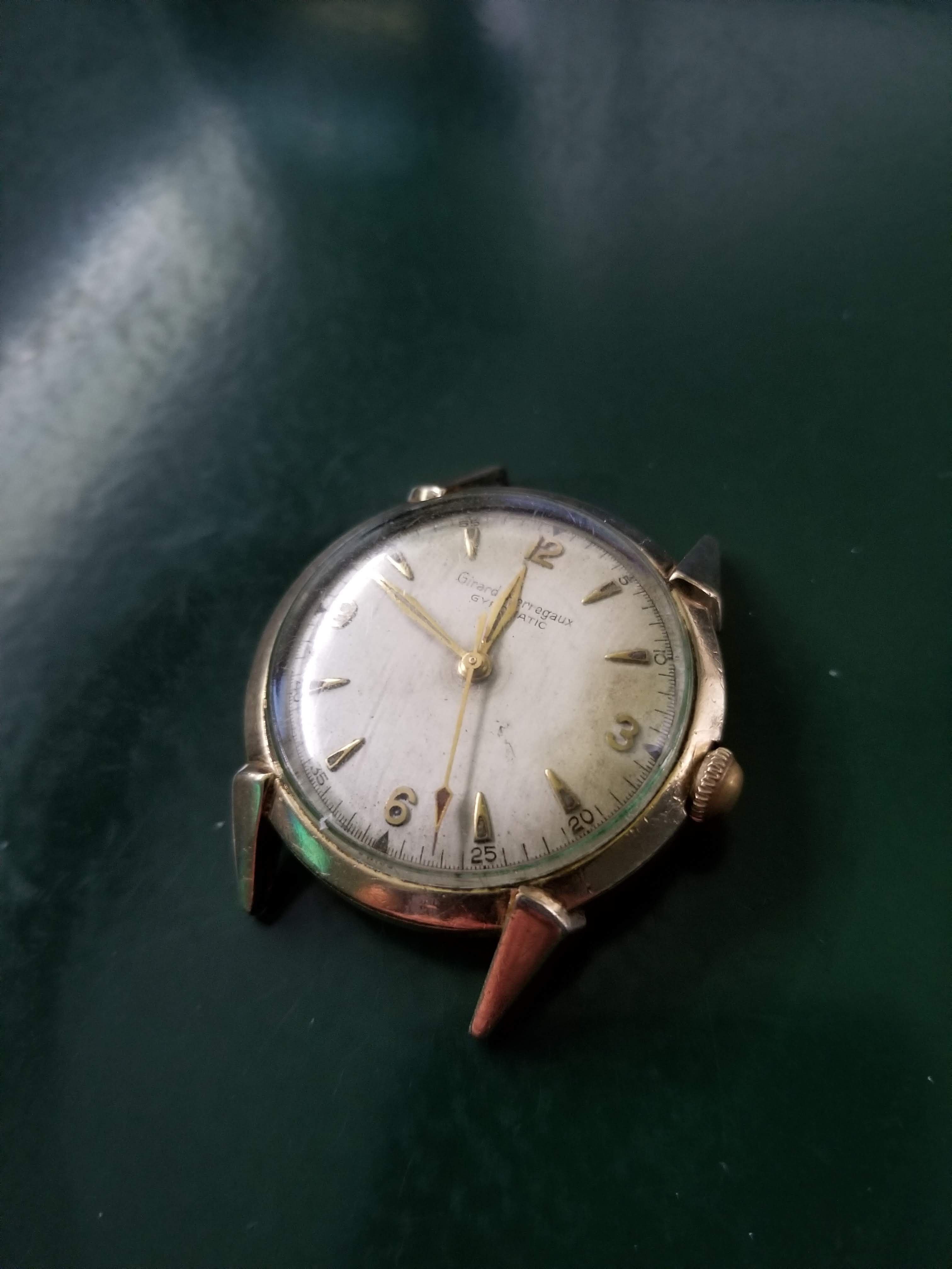

This is a great write up and very timely. My grandmother just gave me a GP Gyromatic that was my late grandfather's. He hadn't worn it in years and I honestly didn't know he had one. I'd love to pop open the case base to view the movement but it's a bit stuck and I'm not entirely sure if it's a screwdown or just pressure fit. Any suggestions?
110
79

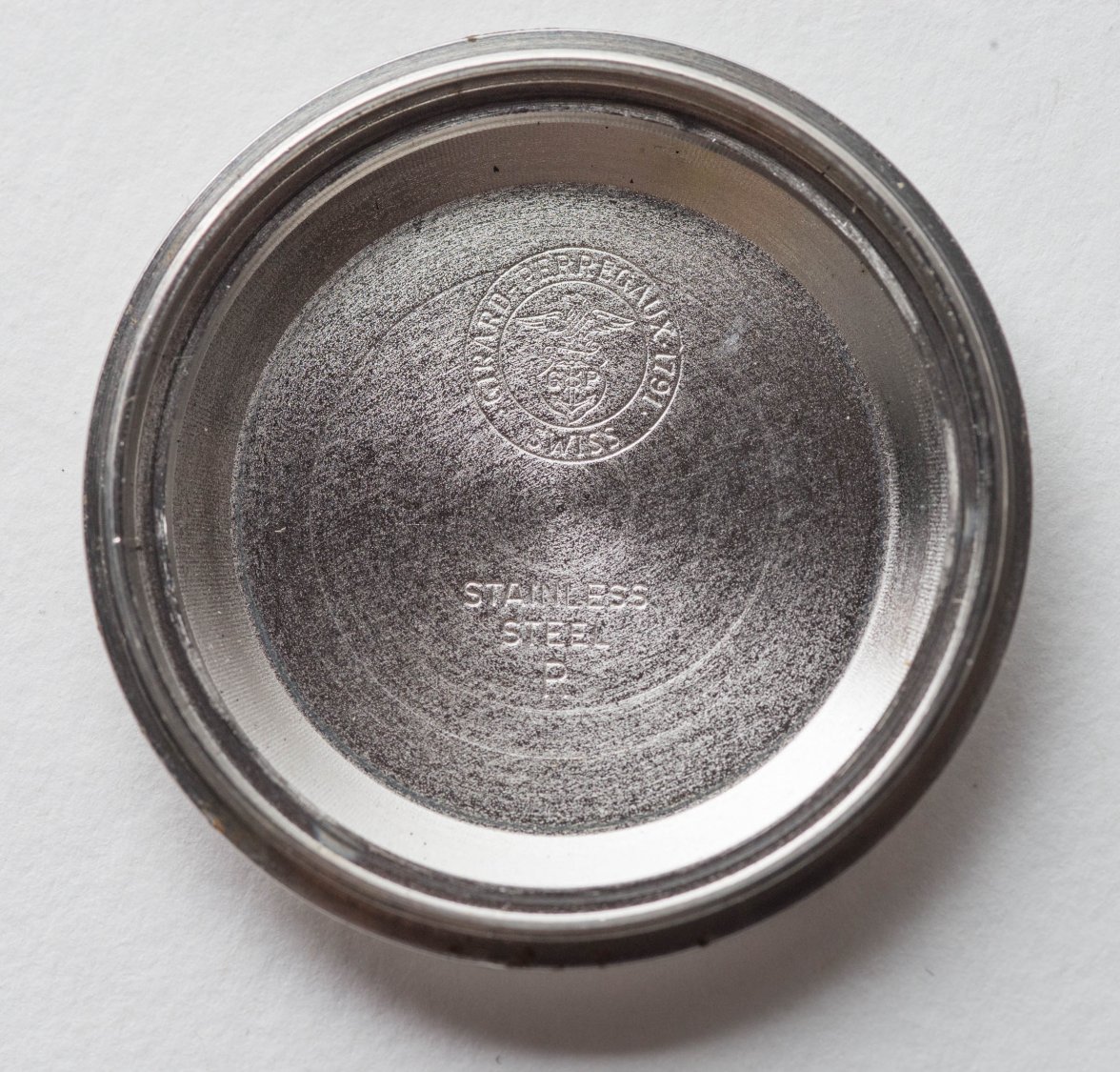

That's beautiful.
The back looks to me to have a screw-down ring (that silver thing - that appears to be faceted like a nut). I haven't opened one of those, but you would definitely want to use a proper fitting wrench (specialty tool) so as not to cause any damage.
Others here will be more familiar and can give more detail.
Lovely watch. I am wondering how old. 1940's?

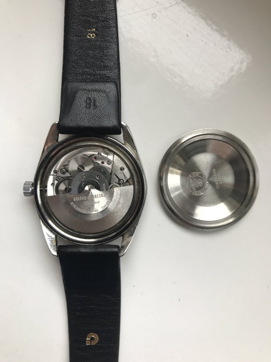

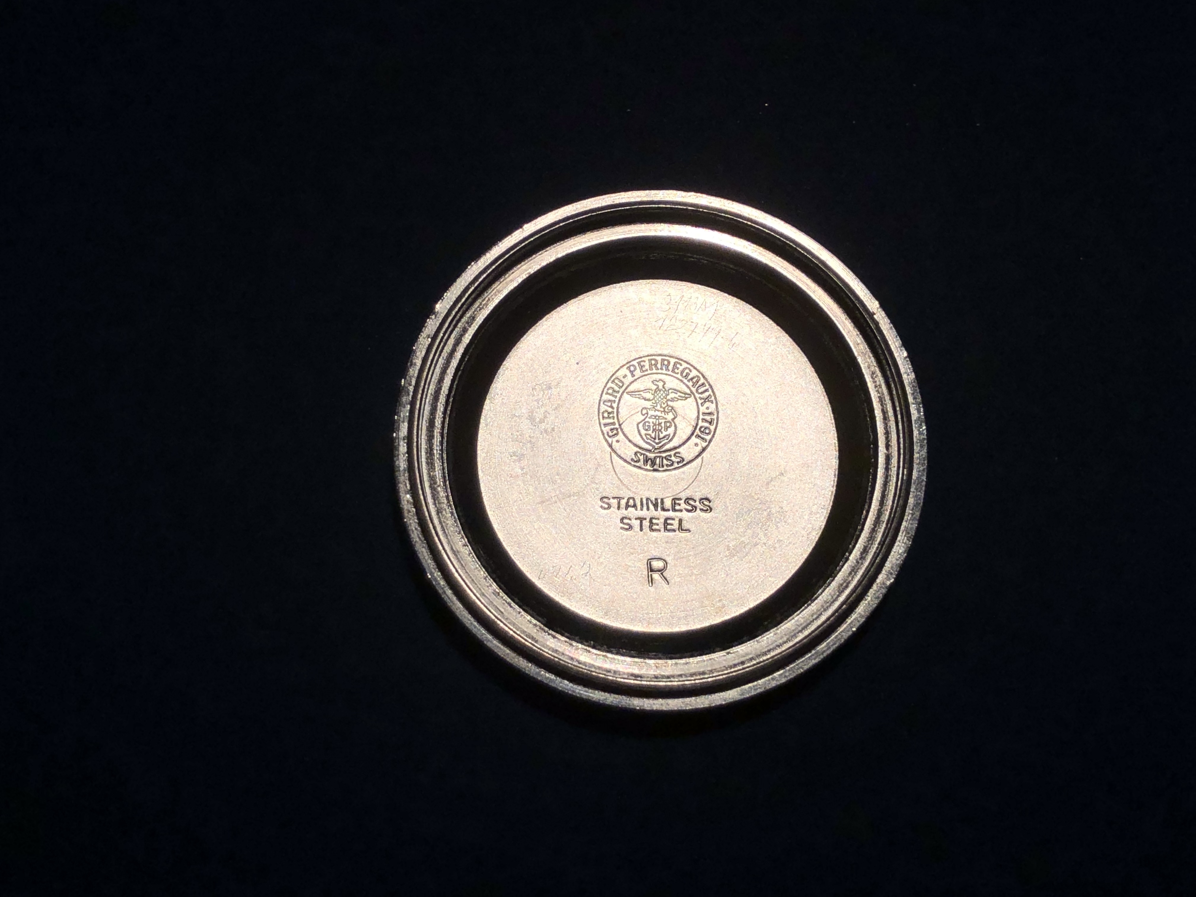

I agree, looks like a screw-down caseback. I was able to open mine with a cheap eBay set: just control the force and set it at the right size.
16,798
47,617

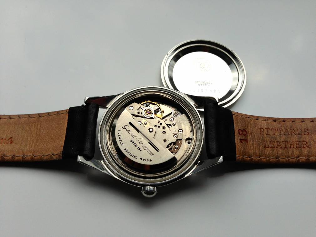

I'd love to pop open the case base to view the movement but it's a bit stuck Any suggestions?
yes Take it to a watch maker

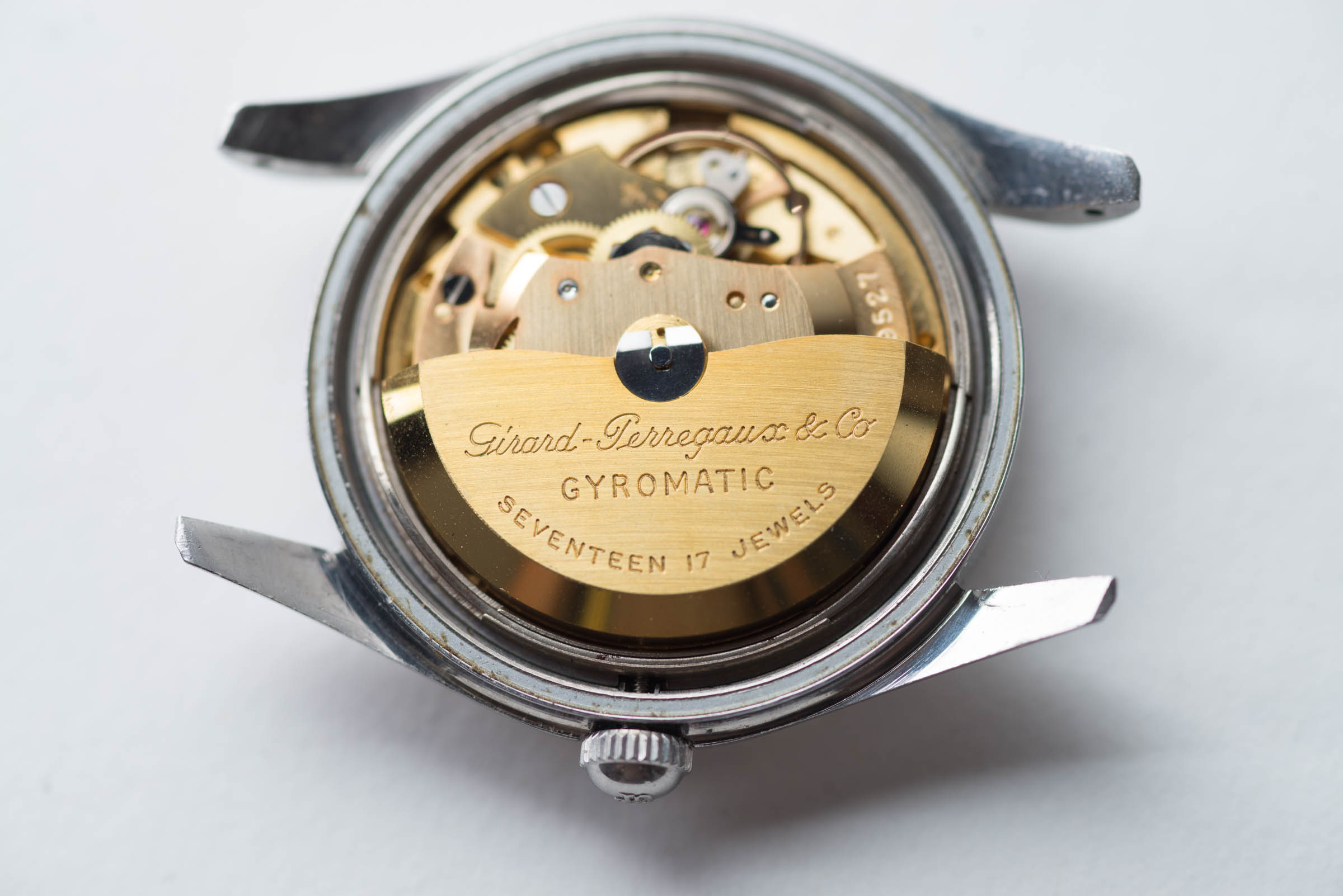

I have a picture of what is inside (probably)

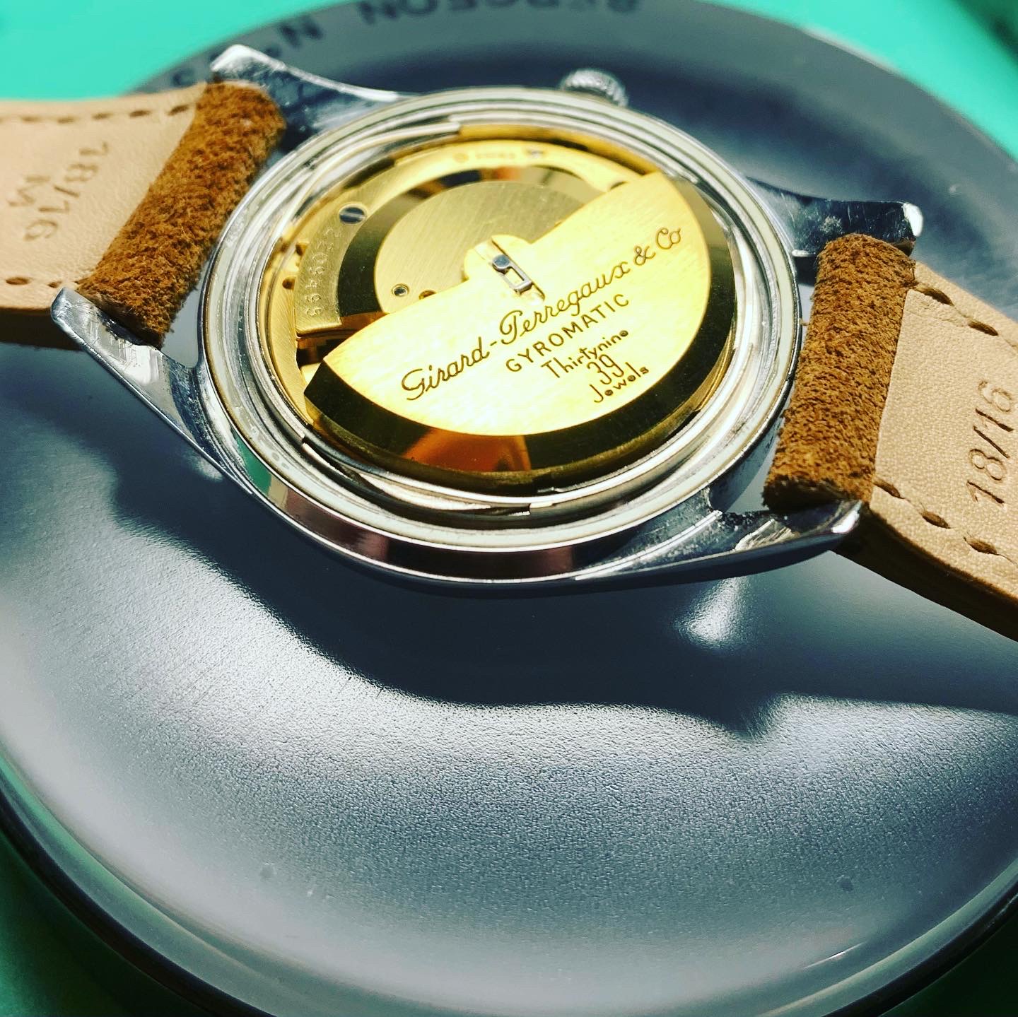

Here is my Two
the 39 Jewels
Thanks for sharing your thoughts. I might just need to fiddle with my case back opener to get the fit just right. I wont push it too hard before I take it to a watchmaker.
I was told it was his graduation gift from High School which would put it in the early to mid-60s if it was new. It's possible that it was passed down to him from his father so the 40s wouldn't be unrealistic.
Those are beautiful pictures you've shared and one of the reasons I'm excited to see what's in this one.
Dear Route514,
I inherited my Father watch that is EXACTLY like yours only Daddy’s is the stainless steel version. It’s engraved on the back with his name and the date of April 4, 1952 if that helps you date yours.
After all these years all I have to do is wind it and it’s still keeping perfect time!!!

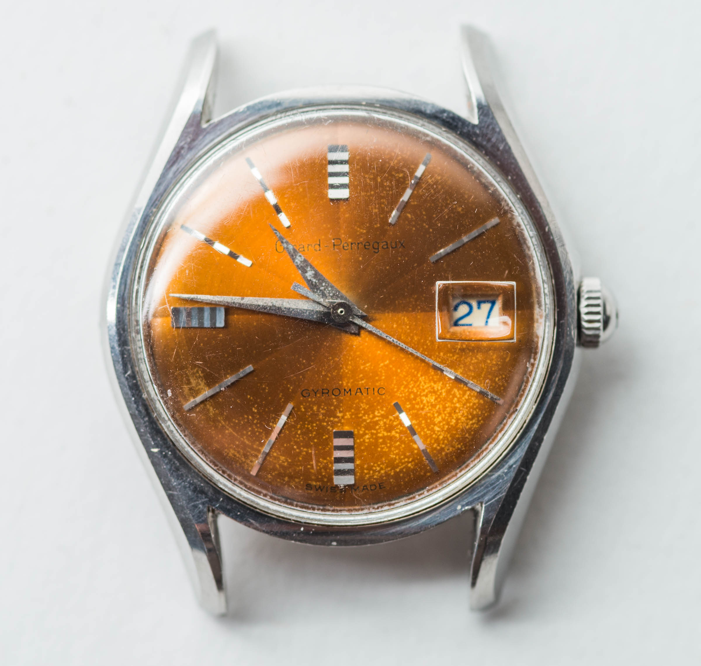

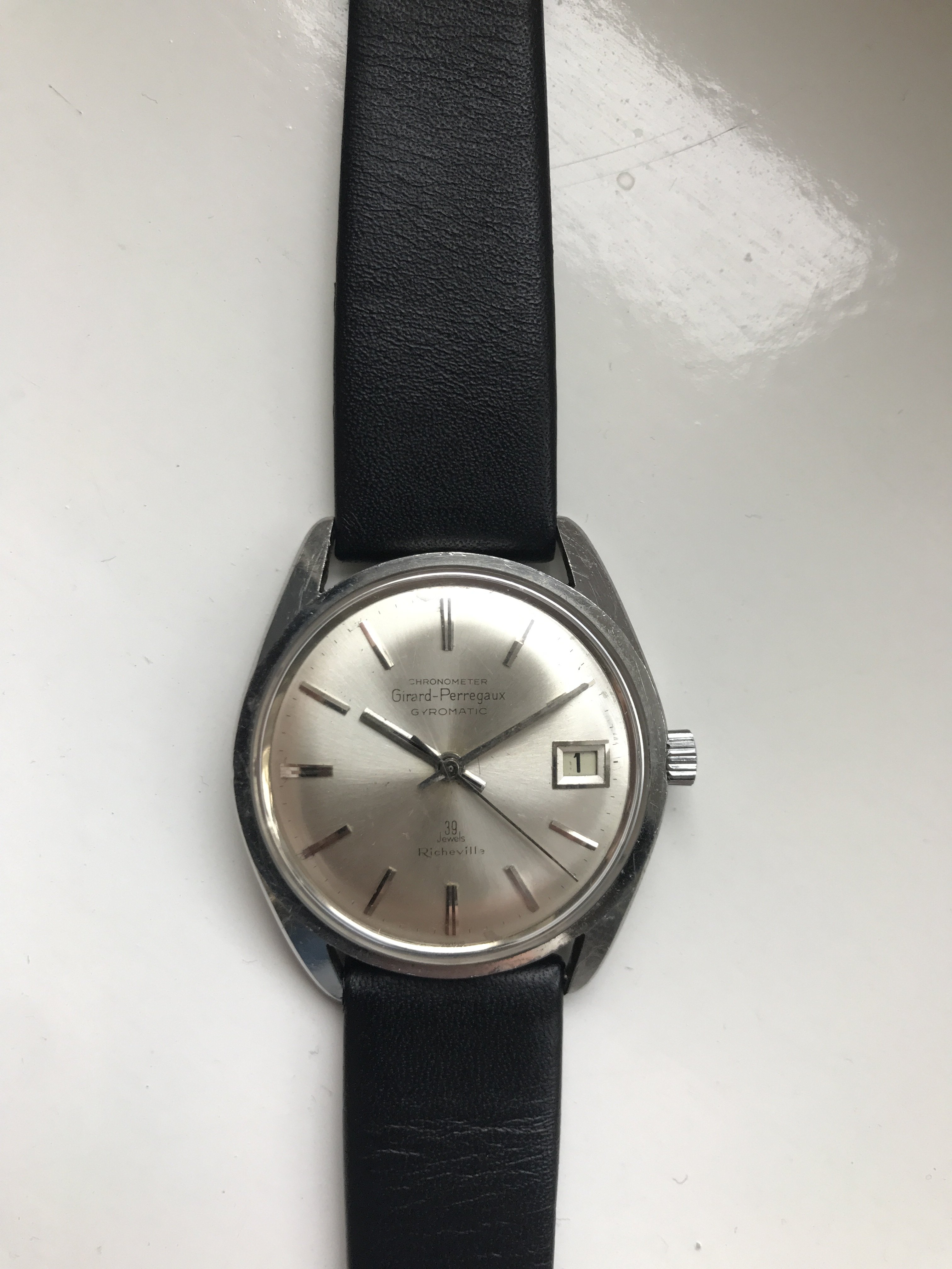

I was looking for info tonight on this watch and found this wonderful thread. I bought this one in Chile, with this wonderful tropical dial.
196
1,128
Nice to hear! Though the information in this topic isn’t fully complete.
Your Gyromatic has a really interesting dial, case has his marks. Congratulations

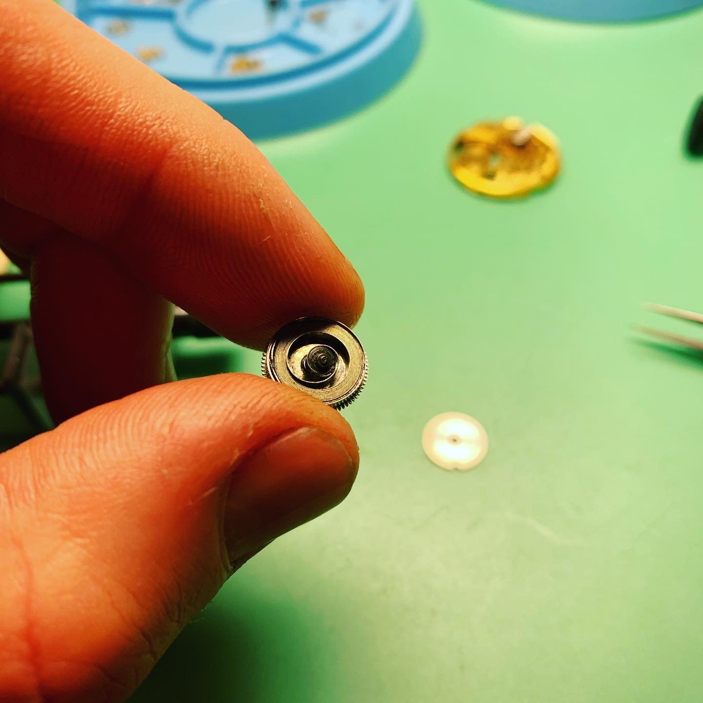

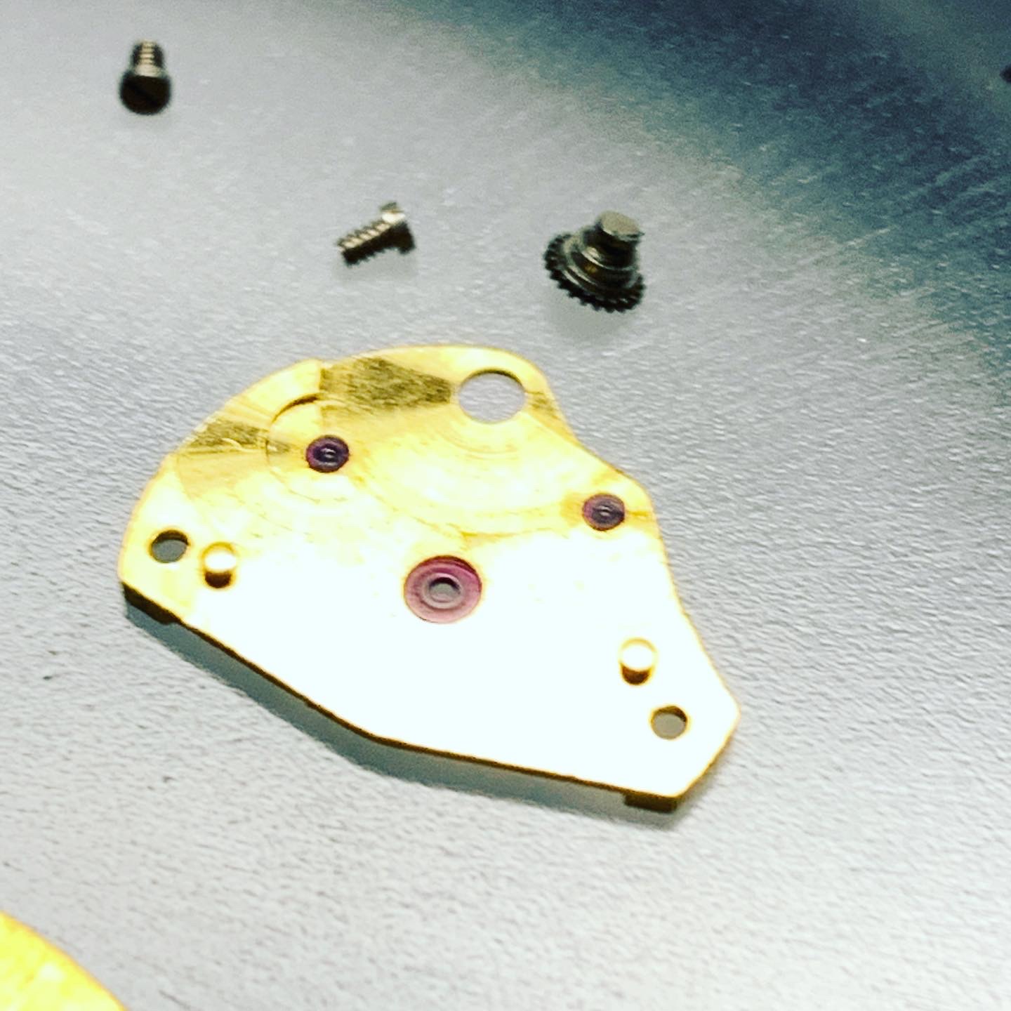

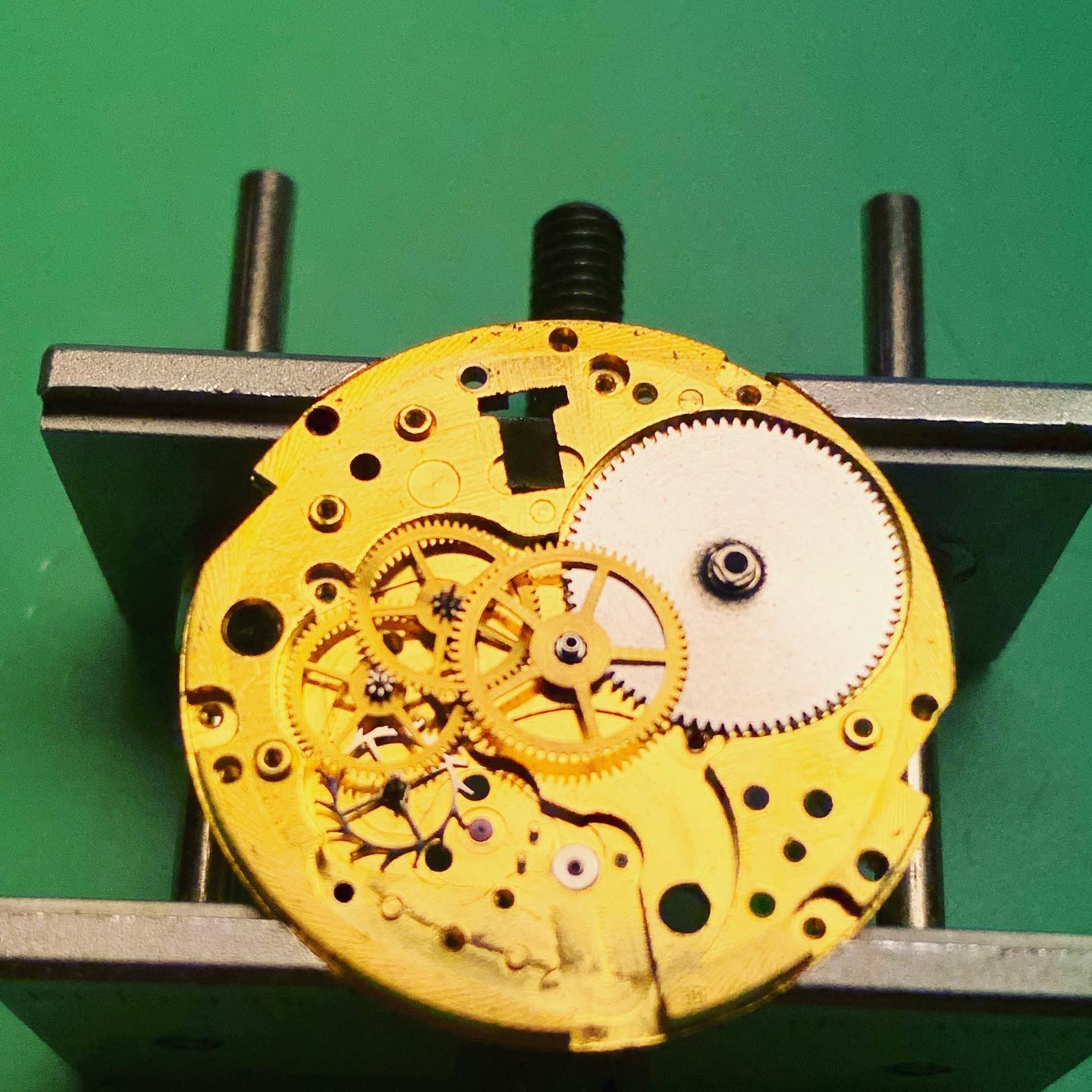

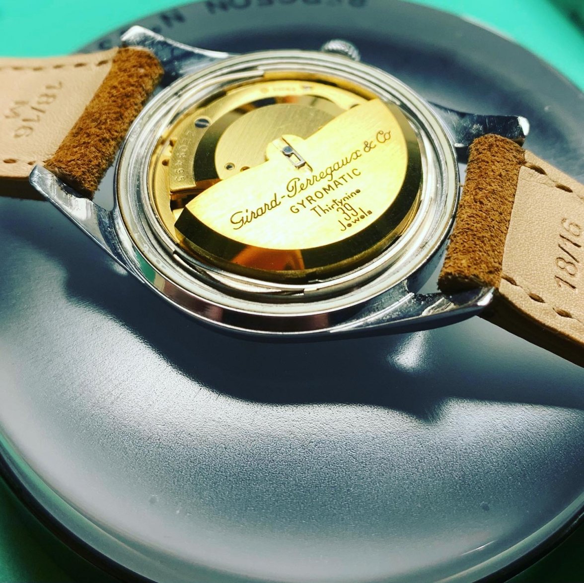

Hey Everyone, just wanted to say that I really enjoyed the story about the GP. So thank you @Mauzer. I bought one month ago mines and started to service the watch. Also to service of this kind of calibers is very enjoyable! Sinds then it’s on the wrist today with a green leather strap. really like love the looks of the watch even the indexen and the small sec dots . And the history story is awesome in my opinion.
some photos are also there about the service. Enjoy.
