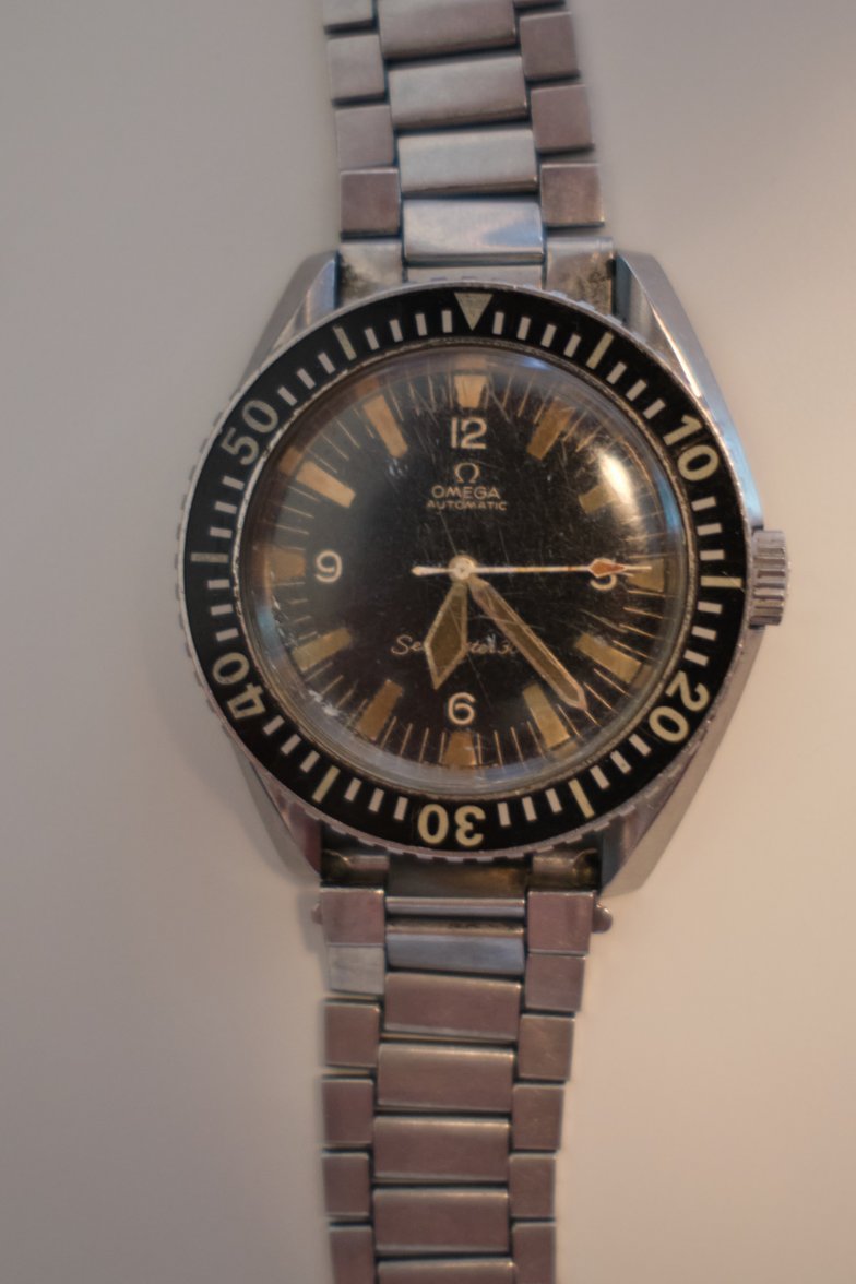

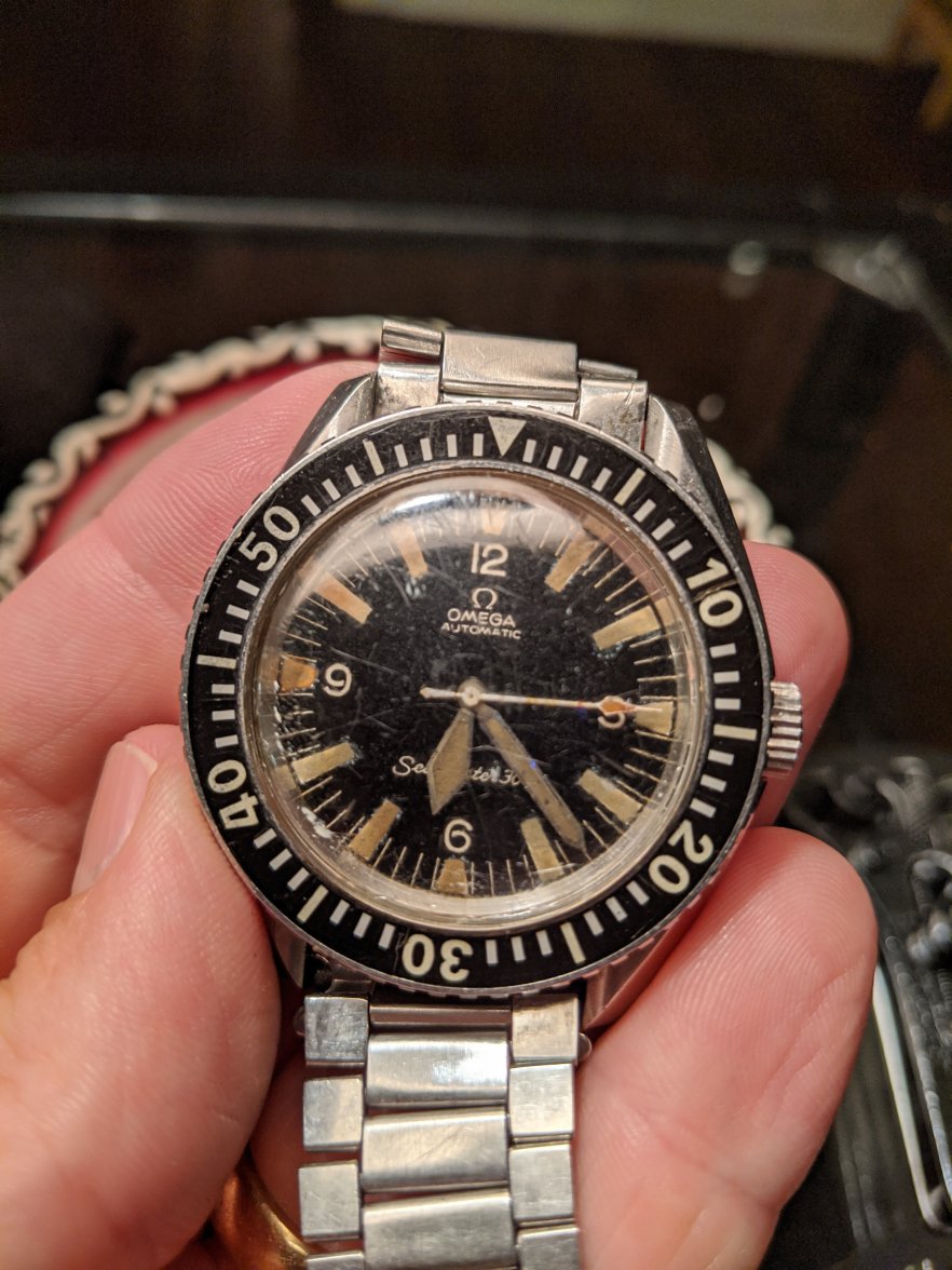

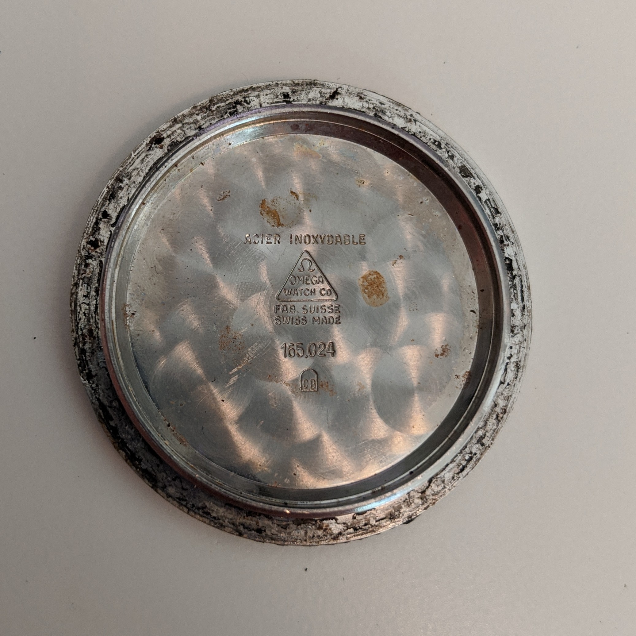

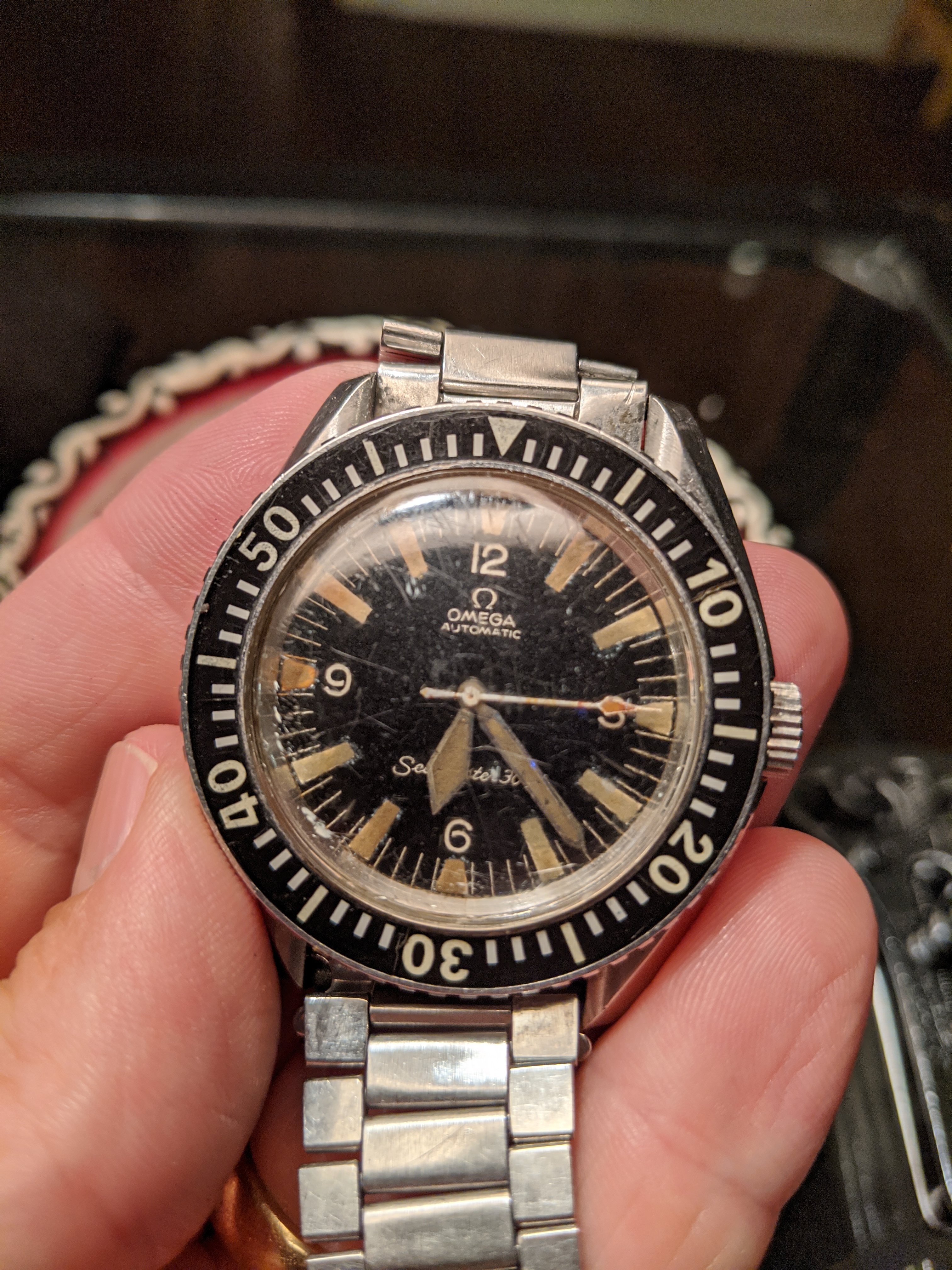

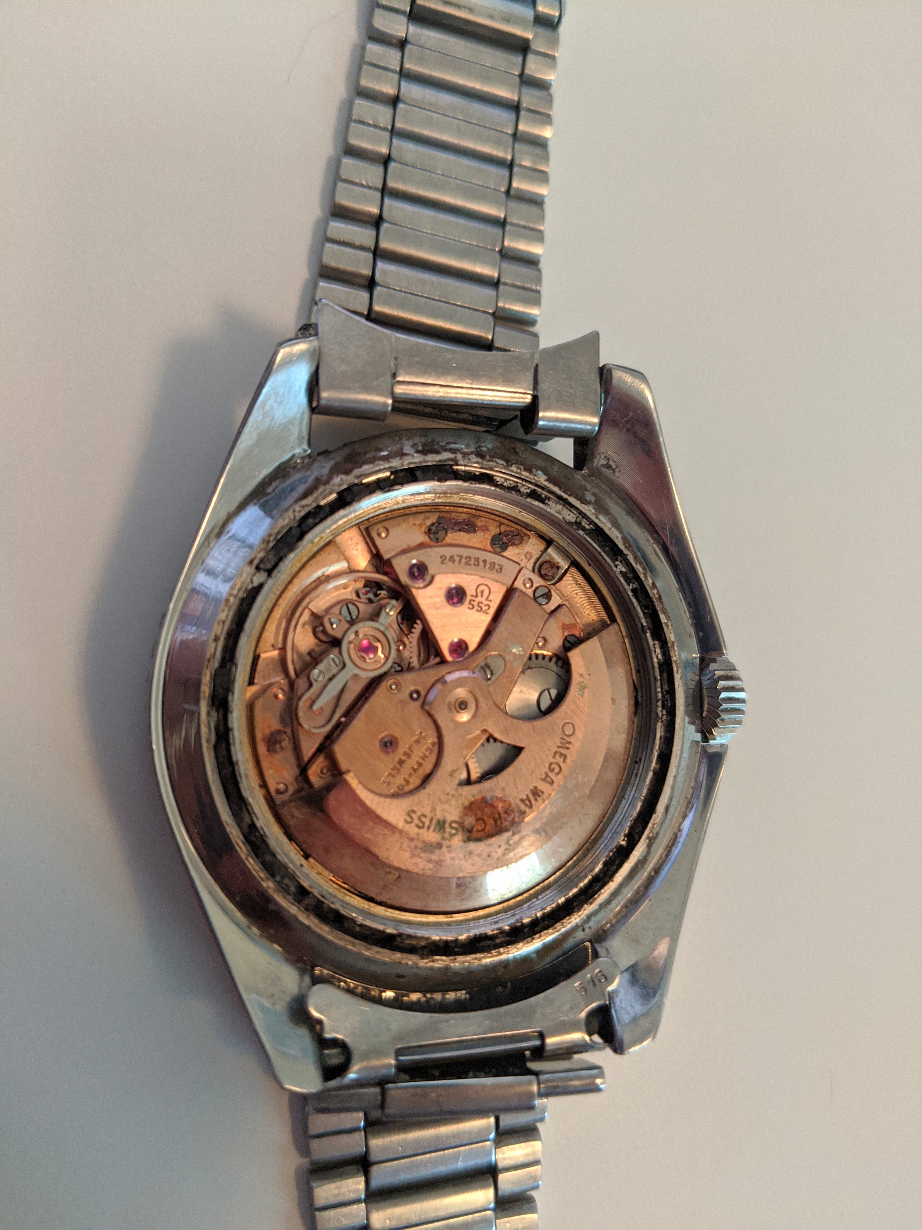

1. Pics attached.

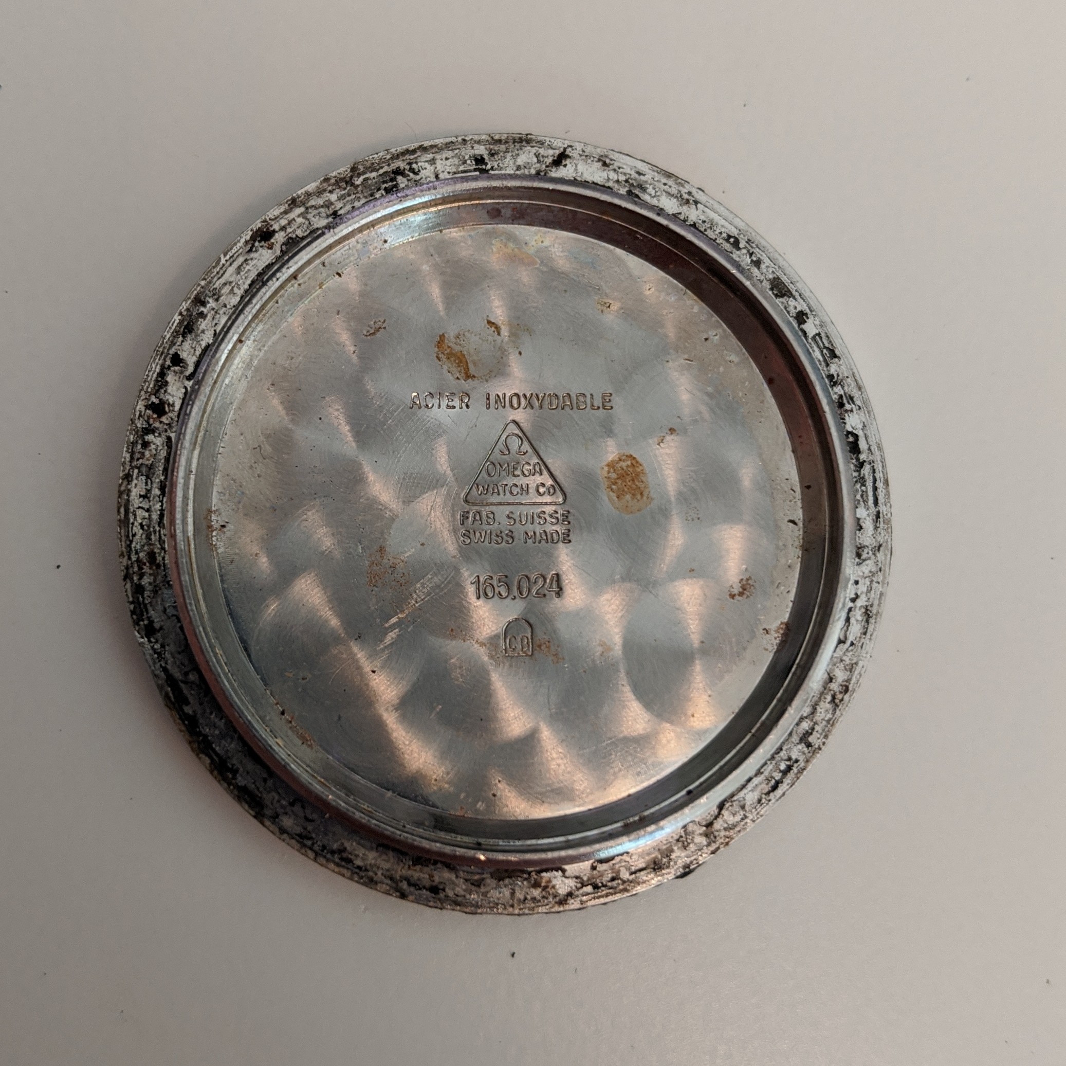

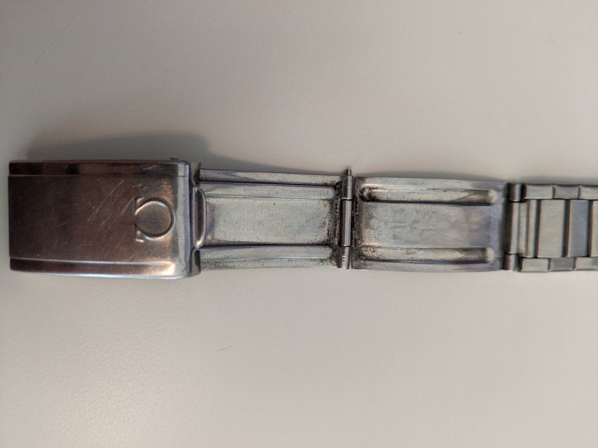

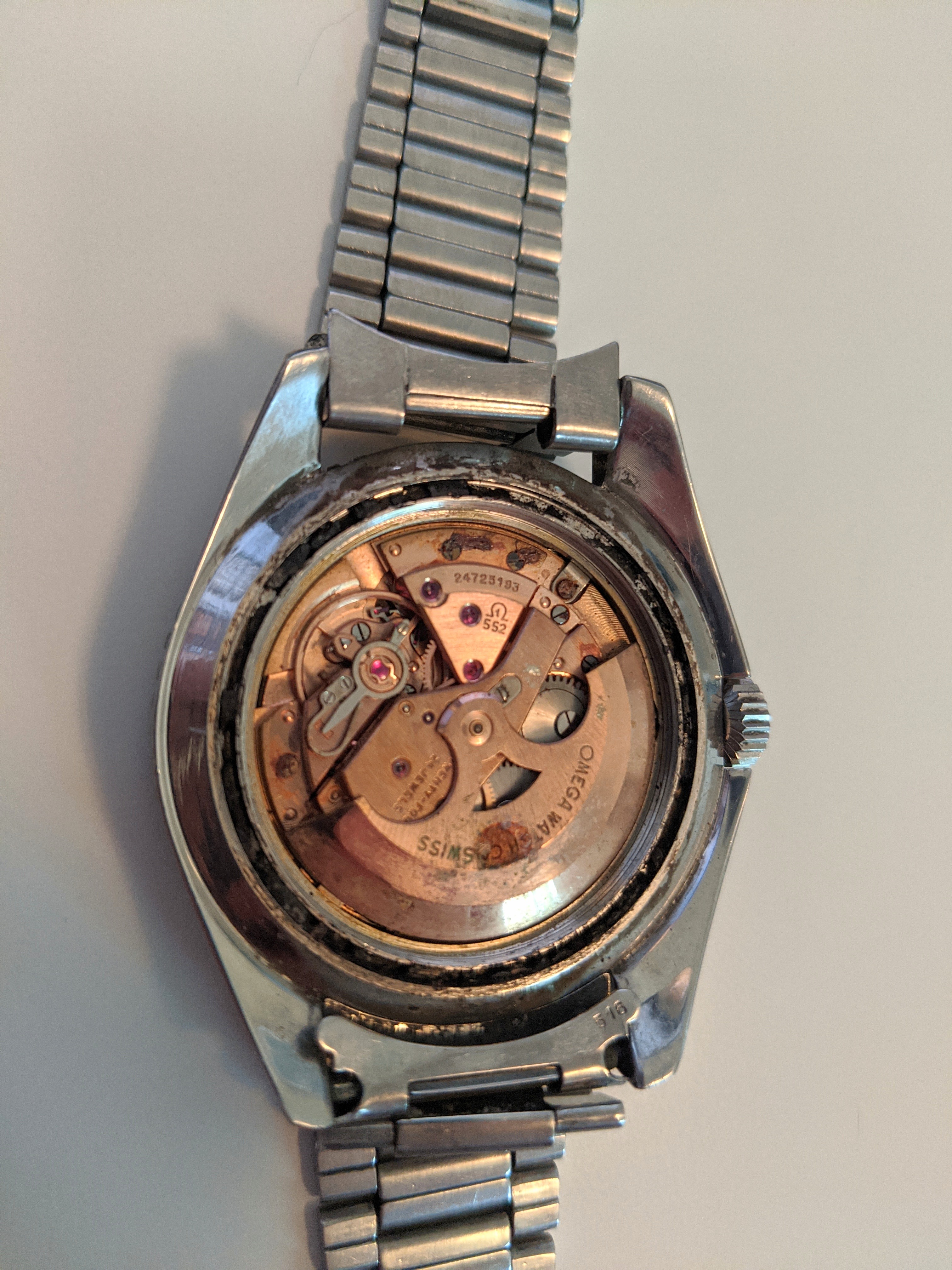

2. My father in law gave me this watch last night. He said his brother bought it for him when he was a teenager while the brother was stationed in the Azore Islands, he's checking on the exact date, mid to late 1960s. My father in law was a recreational diver and used this watch extensively for shallow water diving in mostly freshwater rivers in the central Florida area. He doesn't recall ever having it serviced. It was sitting in a drawer after many years of not being used until one year ago, when he wore it again and wore it into the same fresh water river that he used it in so many years ago scuba diving. A day or two later, it stopped working. (note condition of the gasket). As you can see from the pictures, water got into the case. As far as I know, all original parts, including bracelet.
3. I'd love to get it running again and replace the crystal. As of now, I have no interest in re-luming or doing anything to the bezel, nor polishing the case. I'm located in Louisiana, USA, but am willing to ship the watch anywhere that can do this service for me. I don't currently know any watchmakers or repairmen, as my only watch is a 1 year old Rolex Explorer that was purchased new from an AD in town. I was hoping you guys could recommend someone who could replace the rusted screws, clean and re lube the parts, clean up the face, and install a new crystal or something else that's needed to restore function that I'm unaware of.
I appreciate any advice or help. Thank you

I would get it serviced by a quality independent watch maker ASAP !! I guess with the water intrusion a year ago, the damage is done, but still, I would get on it right away. @Archer is highly recommended, but I have no idea how busy he might be at the moment in terms of getting into the queue.
5,727
9,513
That ship has sailed......the surface rust on screws your minor problem. The movement looks rusted now. Better replace it with a donor movement. That might be your cheapest option. You are looking at min. $1000 to get it back working and water resistant somewhat..... crystal, all seals incl. Crown and clean up the inner case.....good luck. Kind regards. Achim

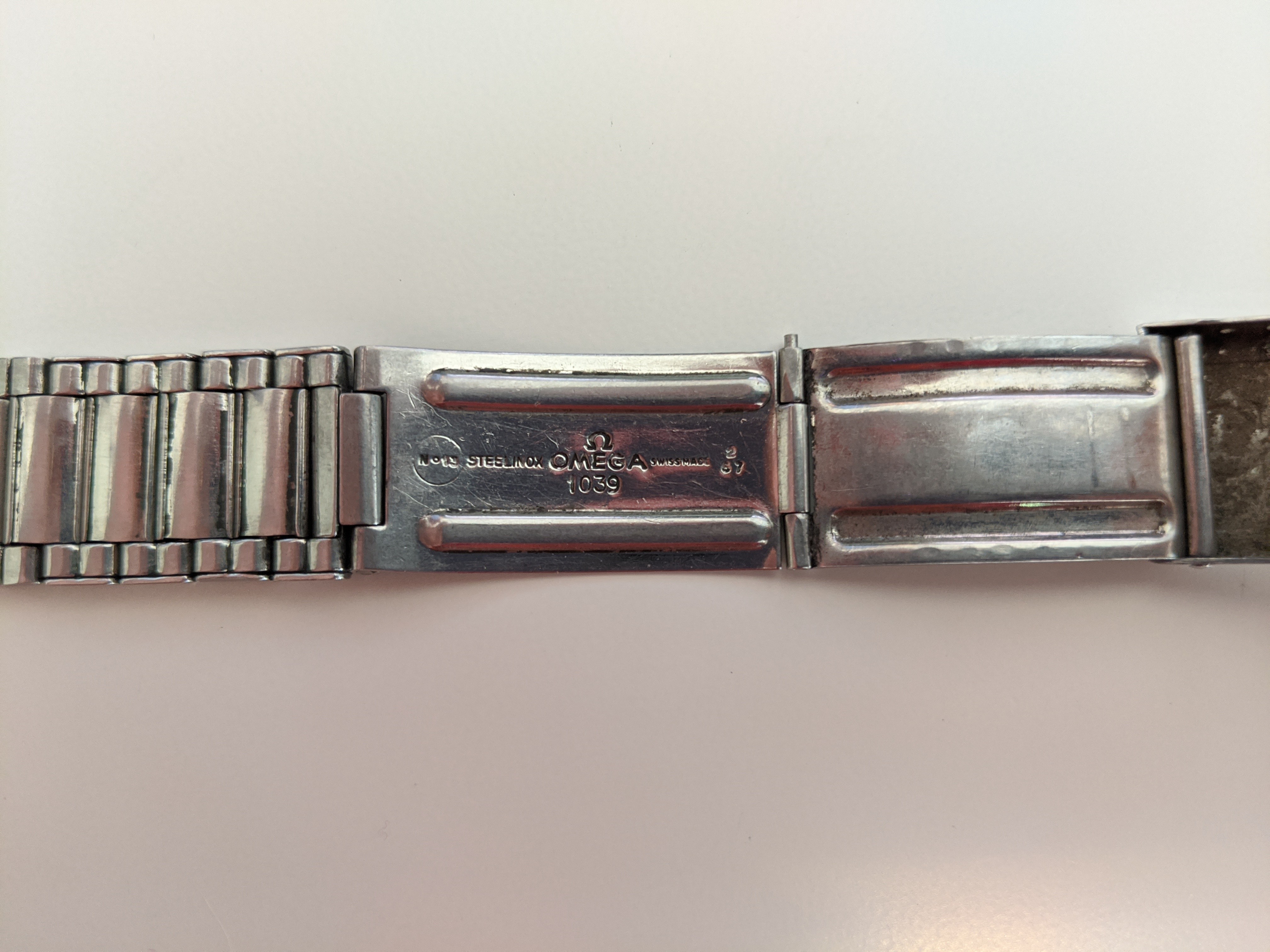

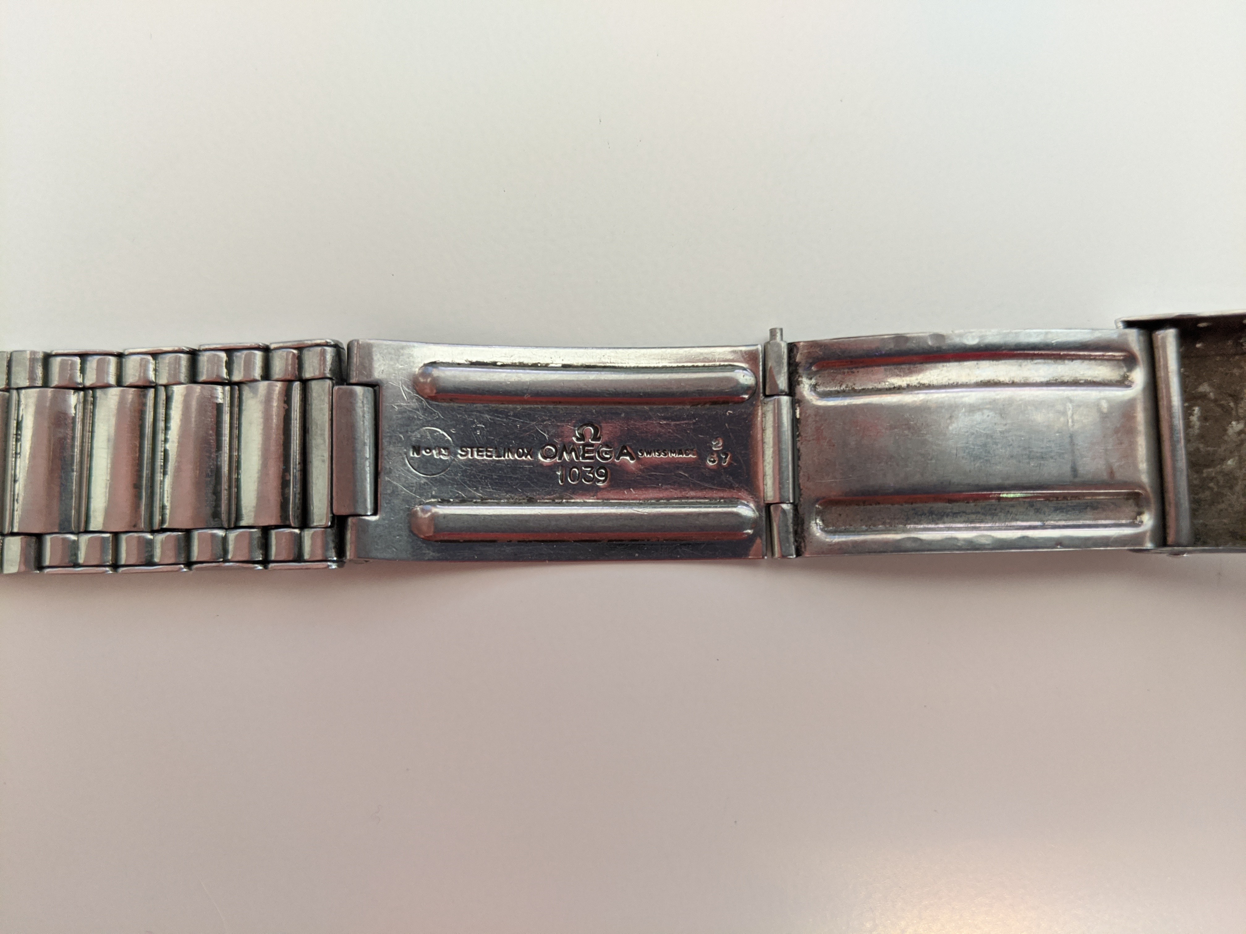

This is a true gem, absolute beauty with it's 1039 !
Lucky you. After a good service (or movement swap), this one will be perfect 🥰
Having seen @Archer bring back some very rusted movements from the brink, I wouldn’t write this one off just yet. 👍

A Seamaster 300 used properly: DIVING.
Unfortunately the gaskets in the years lost their function of water resistant. The result as you can see is the rust in the movement and a damage of the dial, especially near the tritium indexes.
I live in Italy and I brought to my watchmaker worst movements with lot of rust. Summary: a lot of patience in finding broken pieces and a good job of the watchmaker.
This is a nice watch and will be a pleasure to bring it to life. 😀

It is a pity he wore it into the water... But still you can save the watch. Good luck with the project!

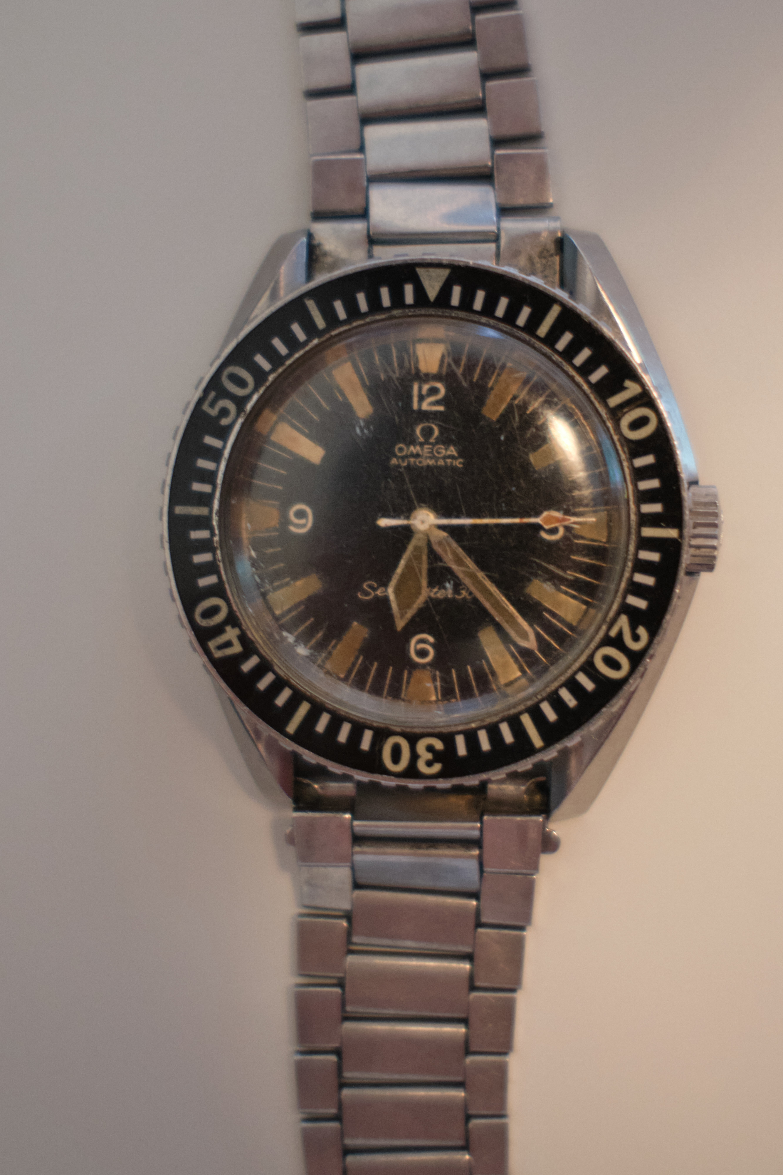

Oddly, I seem to remember seeing more than one other of these bezels cracked around '10'. Brilliant gift, congratulations on getting a great project watch, I am sure it will look fabulous when conserved/restored.
