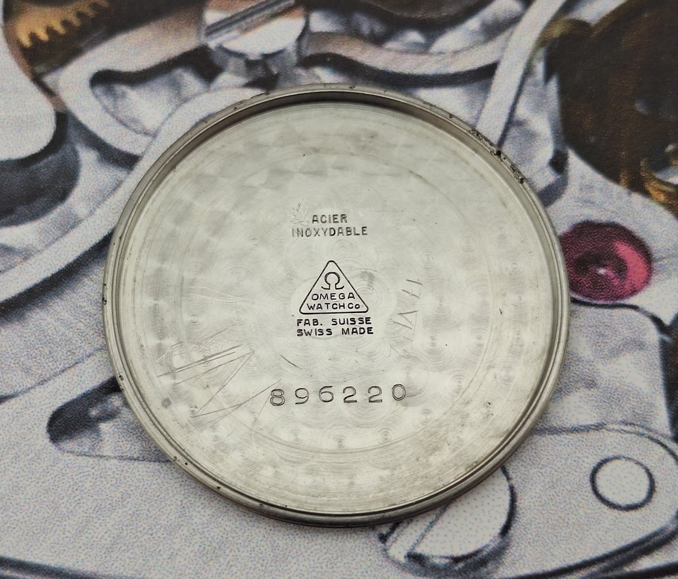

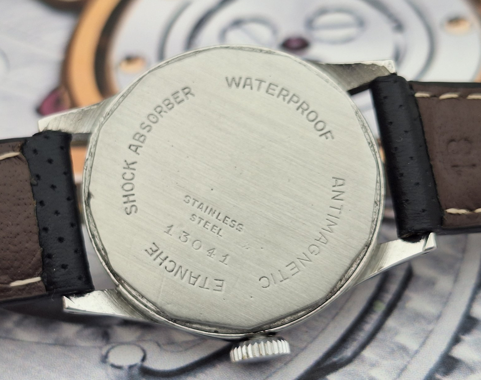

Posts 8,285 Likes 29,301 Tony C. ·Jul 25, 2023·Ωf Jury member Perhaps it is genuine, but have others seen this type of case back previously? And if so, with what reference might it be associated? Thanks in advance!
Posts 13,556 Likes 23,504 Davidt ·Jul 25, 2023 I’m only used to late 50’s to early 70’s Omega, but to my eyes that inner logo immediately looks wrong. It’s too deep and the font just isn’t right.
Posts 13,493 Likes 31,814 X350 XJR ·Jul 25, 2023·Vintage Omega Aficionado It’s the outside that gives me pause, never seen anything like this on an Omega case.
Posts 8,285 Likes 29,301 Tony C. ·Jul 25, 2023·Ωf Jury member X350 XJR It’s the outside that gives me pause, never seen anything like this on an Omega case. That was also my thought.
Posts 4,456 Likes 11,355 kyle L ·Jul 25, 2023·Grasshopper Also don't recall seeing a screwback key pattern like that from Omega. Looks quite similar to the case backs used by many brands in the 50s/60s
Posts 3,013 Likes 4,781 sheepdoll ·Jul 25, 2023 Omega *never* used the word antimagnetic. Or shock absorber. the Ω also has the wrong serifs. Way too long. The number pattern looks more like a fake SN than manufacuring/case references. There are much better watches for much less out there.
Posts 912 Likes 3,845 rendo ·Jul 25, 2023·faux legend Any chance the photos are mixed up and these are two different case backs?
Posts 8,285 Likes 29,301 Tony C. ·Jul 25, 2023·Ωf Jury member rendo Any chance the photos are mixed up and these are two different case backs? That's a good question. Now that you mention it, it appears that the inside photo is of a snap-back, and the other, a screw-back.
Posts 18,841 Likes 39,184 JimInOz ·Jul 25, 2023·Melbourne Australia I'm pretty sure it's a screw back, you can see the raised edge where the thread would be. Definitely something shonky going on, That's not an Omega caseback. Any more pics of the watch?
Posts 8,285 Likes 29,301 Tony C. ·Jul 25, 2023·Ωf Jury member JimInOz I'm pretty sure it's a screw back, you can see the raised edge where the thread would be. But the rim appears to be round, which it can't be based on the other photo...
Posts 18,841 Likes 39,184 JimInOz ·Jul 25, 2023·Melbourne Australia Tony C. But the rim appears to be round, which it can't be based on the other photo... Yes, the rim is round, as in the case of any other screw back. The outer side of the back has a dodecagonal shape caused by the recesses that mate with a special caseback too used to unscrew the back.
Posts 8,285 Likes 29,301 Tony C. ·Jul 26, 2023·Ωf Jury member JimInOz Yes, the rim is round, as in the case of any other screw back. Yes, of course, you are correct!
