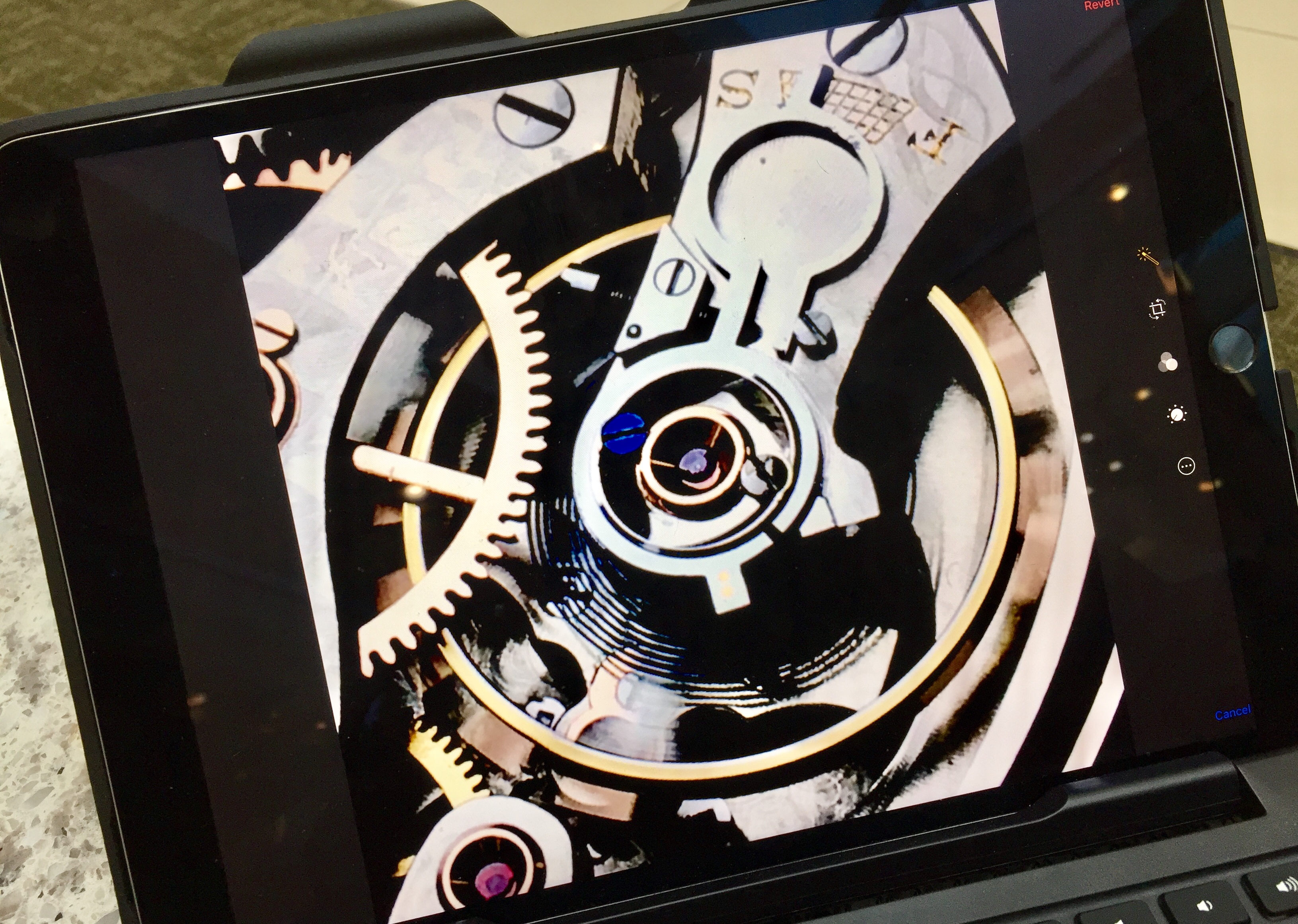

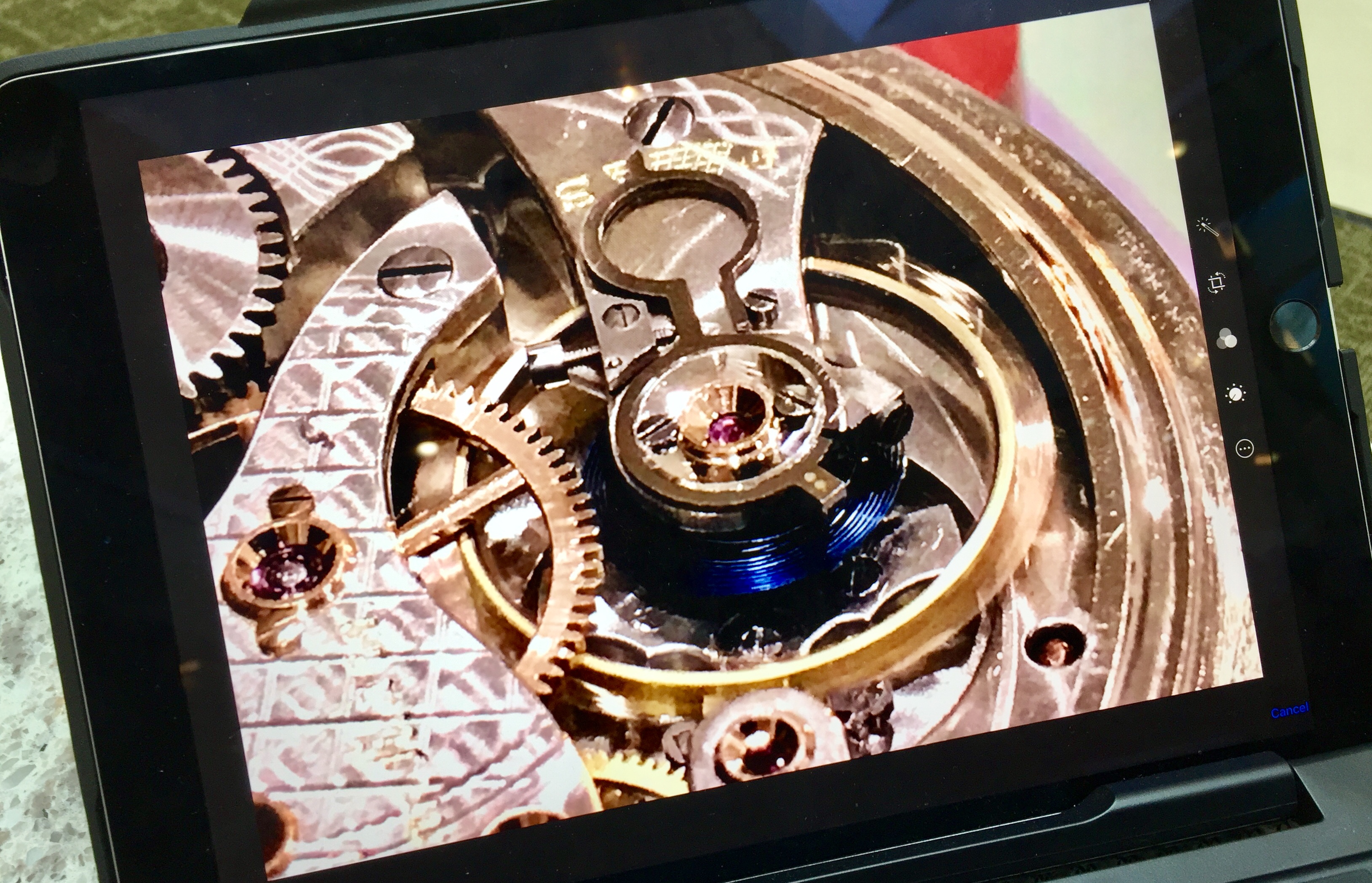

Allow me to explain...one of my railroad grade pocket watches, a 23j Waltham Vanguard 1908, has a pair of color mismatched balance jewel setting screws...one has a normal polished finish and the other has a blue polished finish.
Blue screw from pic previously posted today in WRUW Today thread...

Hey MD...I'm a little confused...
You say the watch had "mismatched screws" and then used a photo to show that, but looking closer at said area of the photo you posted both screws appear blued:
So basically my question is...WTF?

Here are pics [of pics] of the originals...
Not matchy-matchy [or correct] due to the existing blued screw...
Blue screw was removed, blueing was carefully removed, screw was cleaned and then screw was re-installed...now matchy-matchy...

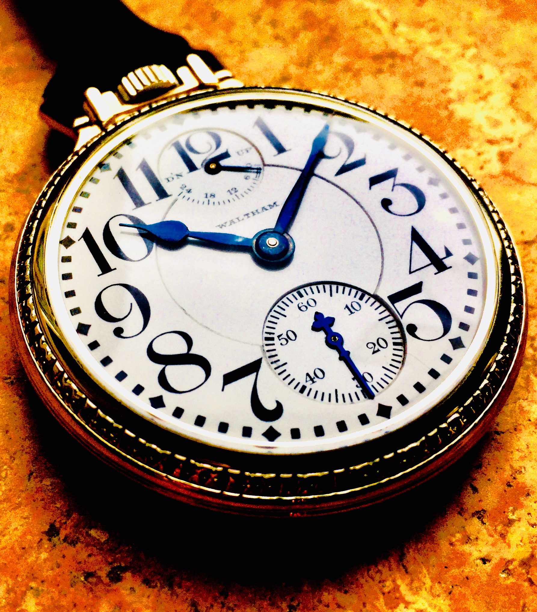

This one looks VERY goody goody 👍
Thanks, sir. 👍
Too bad the pic below doesn’t look bluey-bluey...looks blacky-blacky. 🙁

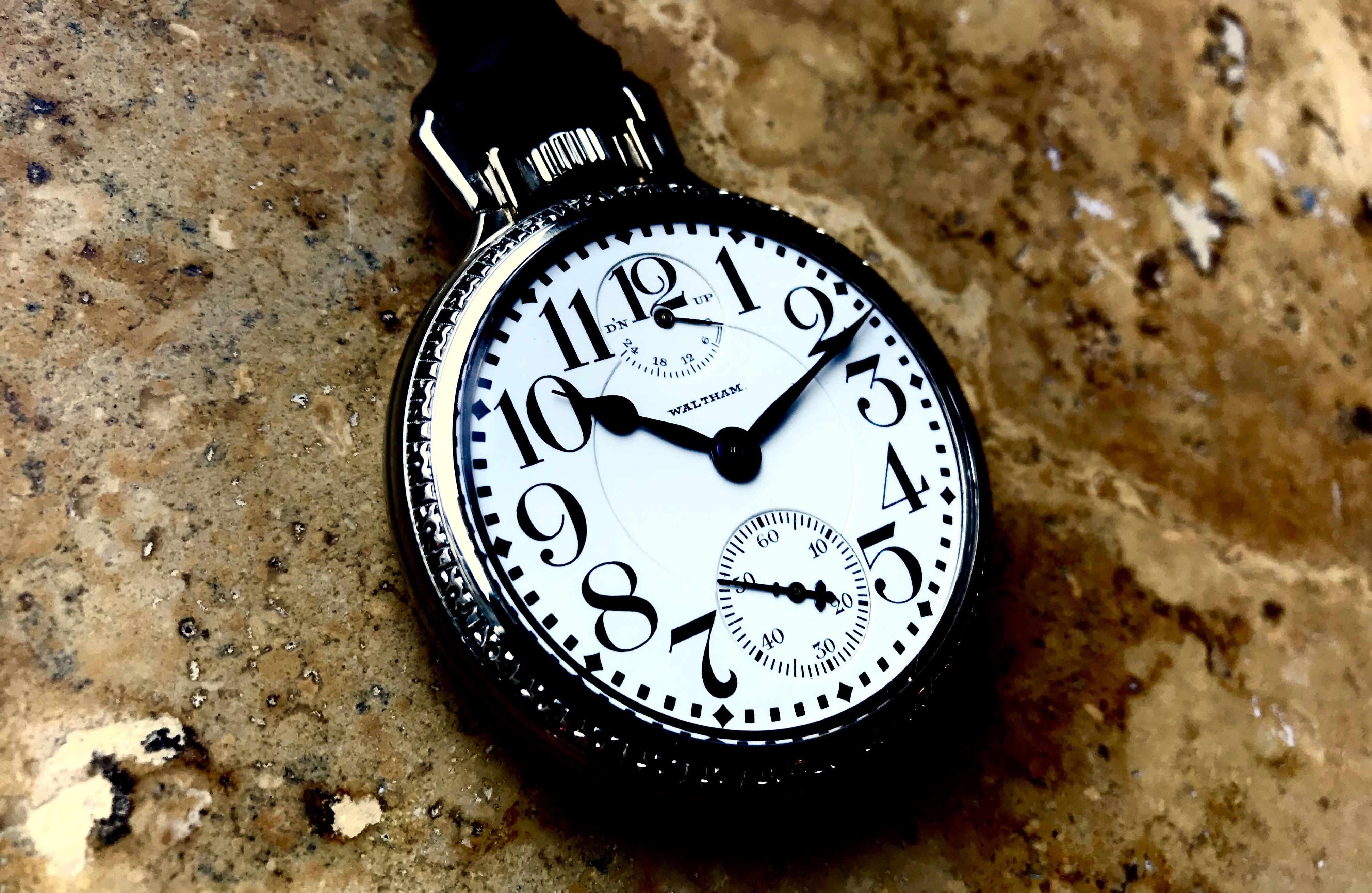

...one of my railroad grade pocket watches, a 23j Waltham Vanguard 1908...
Blue is good, sir...especially on the front side. 👍

Honest question: do these come up for sale, where, and what would they normally sell for?
I’ve always thought pocket watches were cool, and this one is particularly attractive with the blue hands!
Thanks, sir...the watch addressed and pictured in this thread is my railroad grade Waltham Vanguard 1908 with winding indicator which was manufactured around 1929. Many if not most vintage railroad grade pocket watches have blued steel hands.
Like other watches, there are many vintage pocket watches for sale on eBay as well as at forums that appeal to pocket watch enthusiasts/collectors such as the NAWCC and IHC185 forums...and like other watches, the prices can vary greatly based on rarity, correctness and condition, condition, condition...as well as the presence of boxes and/or papers. For example, a basic vintage railroad grade pocket watch such as a Hamilton 992 could range in price from about $100 to $300...hundreds of thousands of these were produced. Somewhat more rare and more complicated railroad grade pocket watches [such as my Waltham Vanguard 1908 with winding indicator addressed in this thread] can range in price from about $600 to $1200...and for even more rare and highly sought after pieces, the prices can climb to several thousands of dollars.
