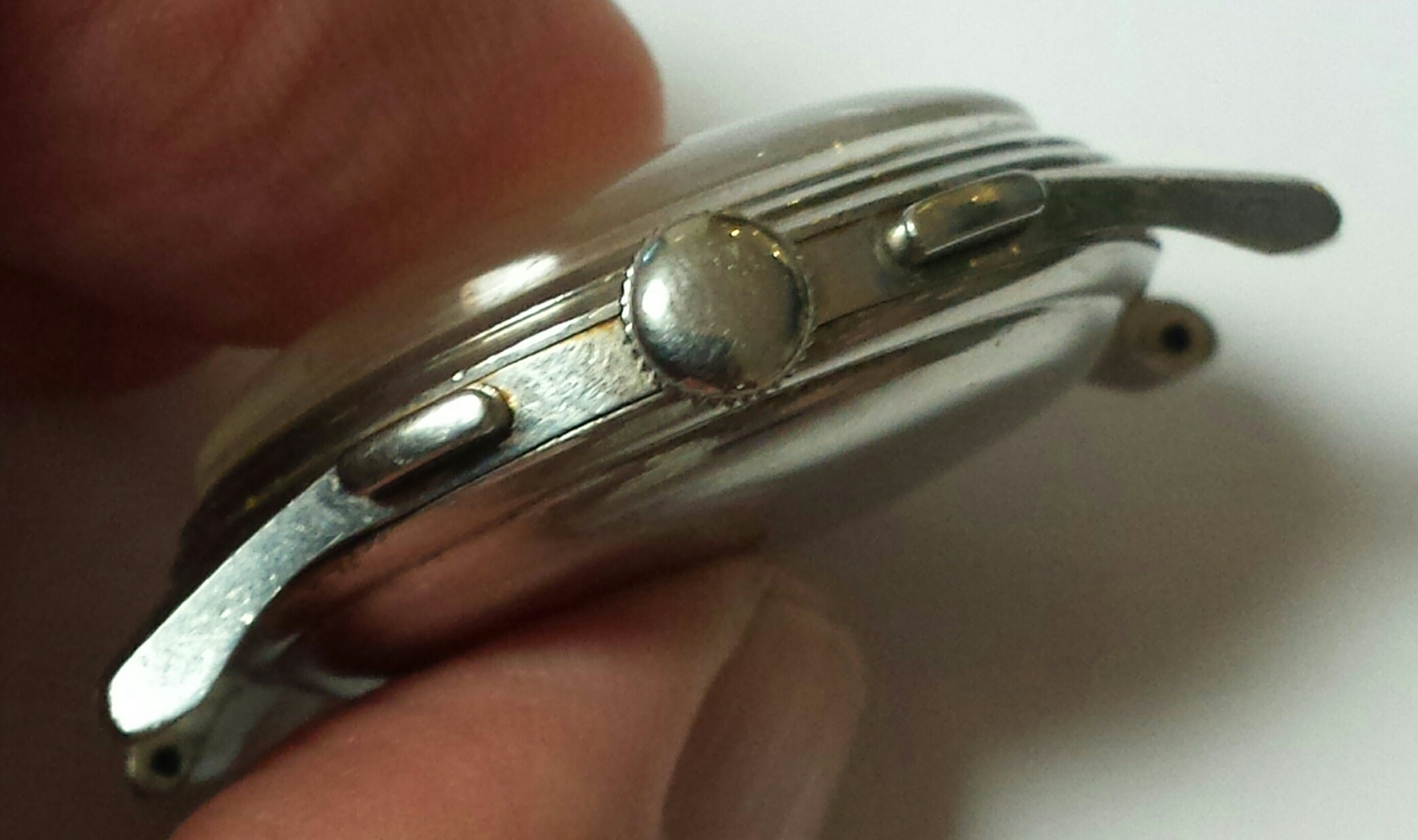

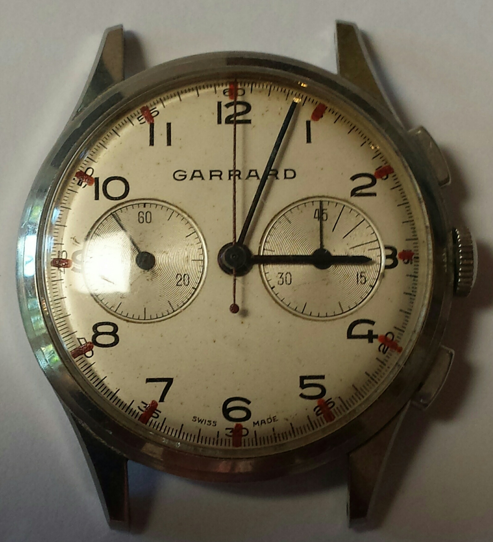

    I open this one up to the brains trust.

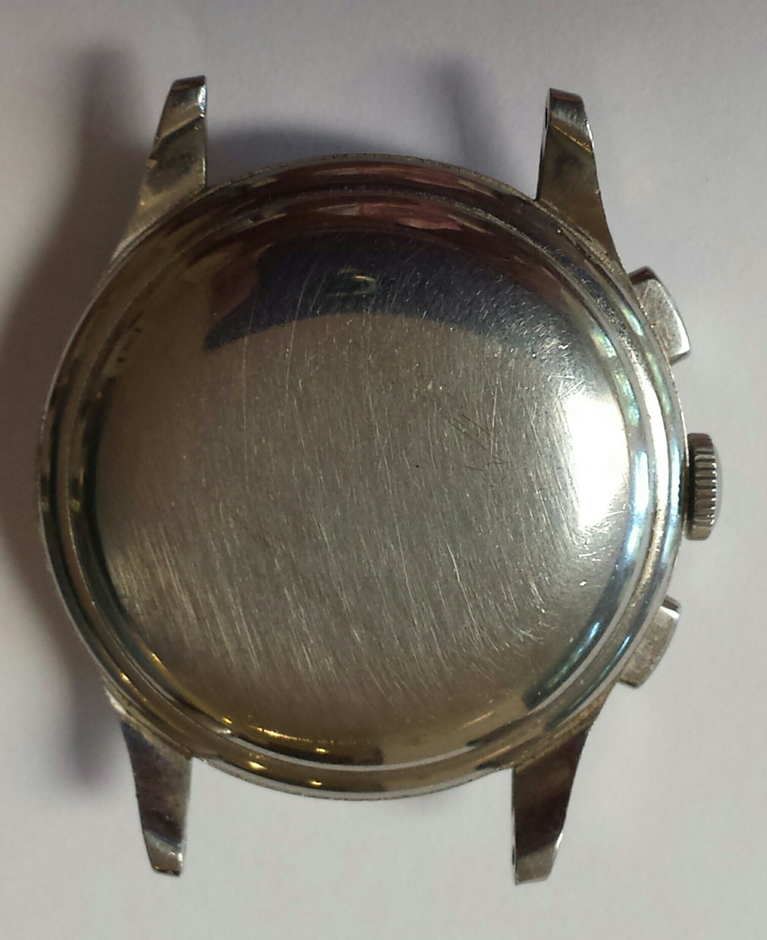

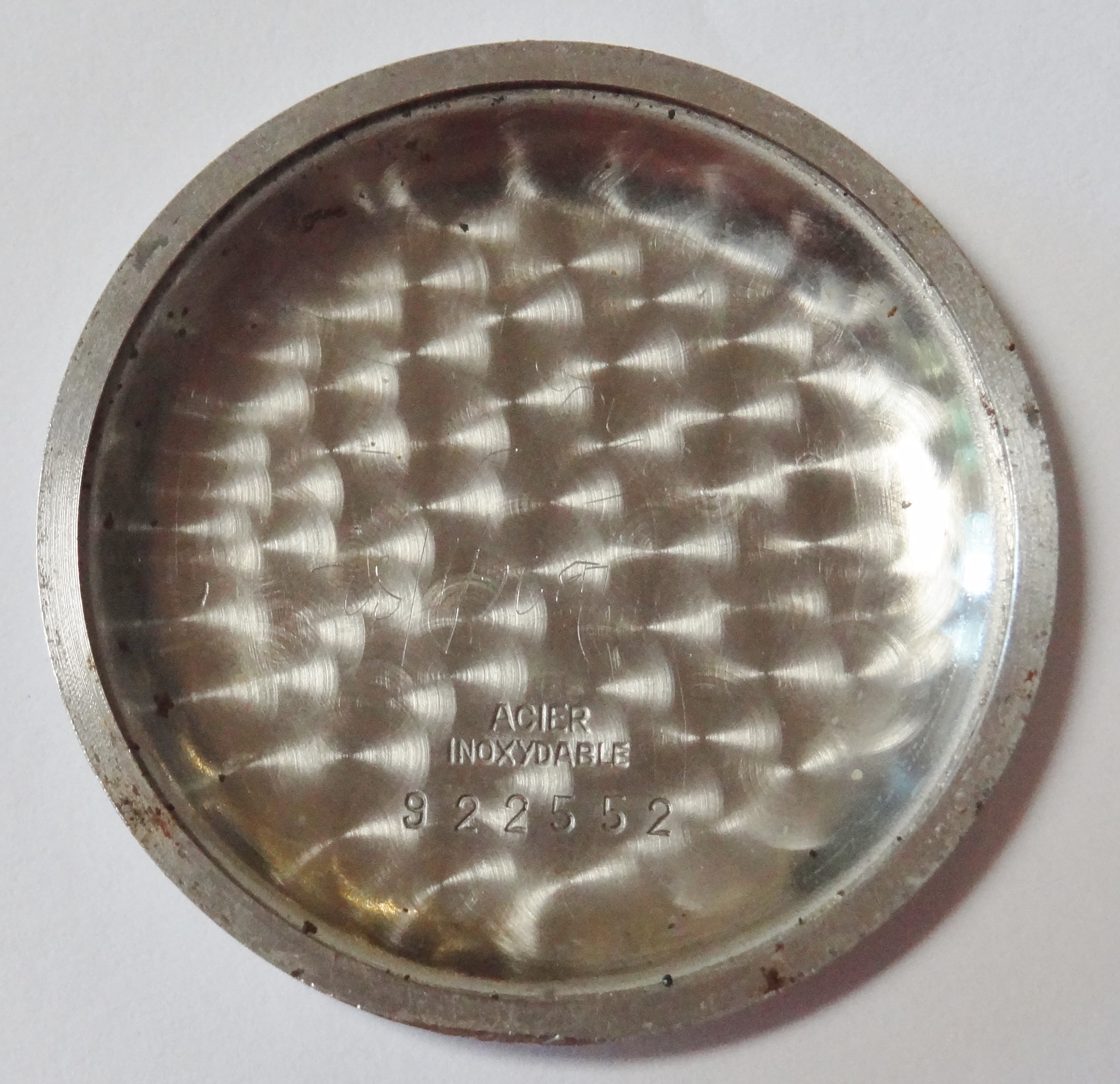

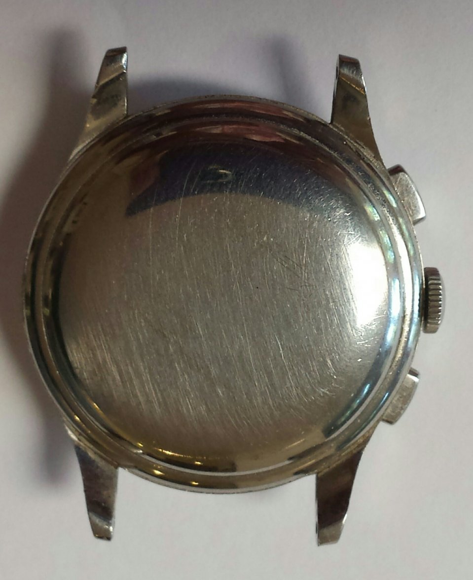

    I've recently acquired this Garrard Chronograph and can't find any information other than it is supposed to be 1940-50s.
    What Movement is it?
    What year?
    Cheers,
    Buster

    She's in for a service now. You must be as old as I to remember, hehe.
    The son said his father wore this as aircrew, private purchase. He definitely added the 'lume' style marks on the dial for readability.

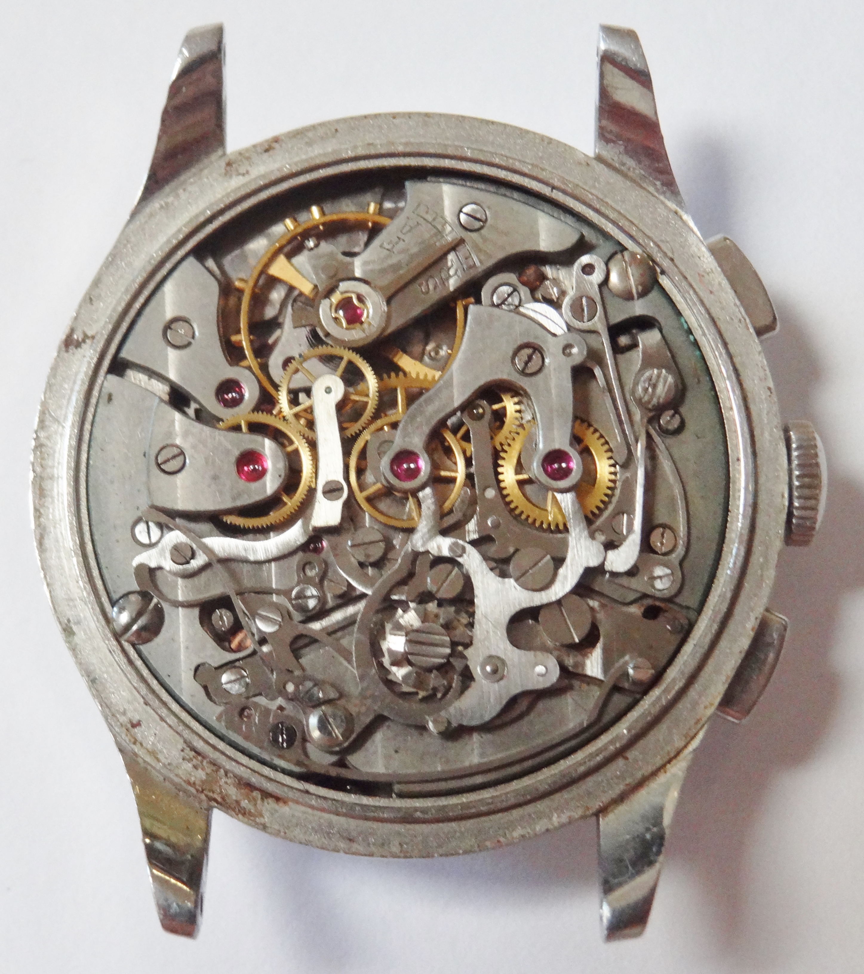

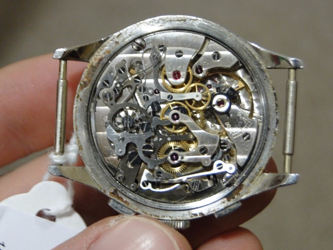

  6. LarryG not KennyG, not OG, just LarryG Dec 10, 2016
    992
    3,836
    Excelsior Park cal. 4 perhaps
    Syrte and Drawarms like this.
  7. RCAFBuster Dec 10, 2016
    675
    2,906
    Hi Larry,
    Upon comparison, I think you are spot on. The EP Cal 4 was also used for Gallet, Zenith and GP.
    Thanks,
    Buster
  8. RCAFBuster Dec 11, 2016
    675
    2,906
    The EP4 seems to have been used from about 1942 and it had shock protection.

  11. Dre Dec 19, 2016
    1,927
    22,622
    Nice one D! EP 4 movement, most likely to be around late 1940s. Hard to pin point the exact year for EP watches as they're not documented properly, dragondan at WUS would be the person I'd ask for this as he has an extensive serial database of Gallet & EP watches.
    Chrono hand seems to have been painted red as well to match the red "lume" marks on the dial, originally blued steel.
  12. RCAFBuster Dec 19, 2016
    675
    2,906
    Hi A, thanks for your input. I will seek out dragondan. under a loupe I can see that the sweep hand has been painted 'old red' to match the lume marks applied to the dial. My research indicates that the EP4 was released about 1942.

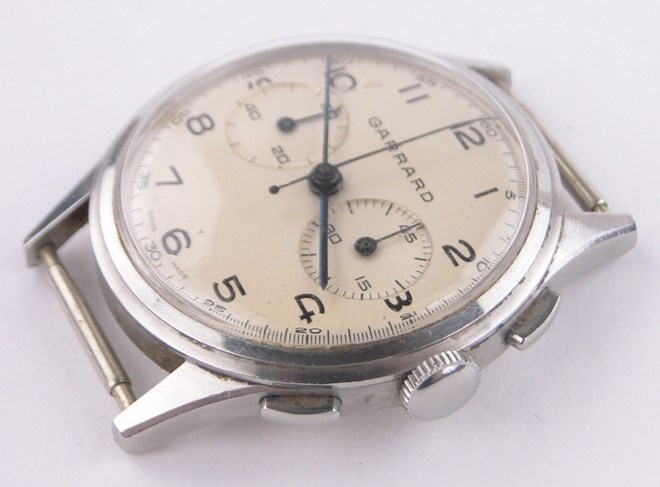

  13. buddman Nov 17, 2017
    190
    148
    Found your old thread RCAFBuster - Ive just acquired the same...but without the customised lume job. Im told by dragondan it might be later -60s and perhaps even early 70s. Im sure your research showed you that Garrard are and were a very high end jewellery shop in London. They would have served the well heeled gentlemen of the era, and I think a tool watch bearing their name is very uncommon . Normally you see 9ct and 18ct gold dress watches with the Gerrard name, housing Smiths movements inside.

  14. RCAFBuster Nov 17, 2017
    675
    2,906
    Looks great. These Chronographs are not very common, as you said, most Garrard's are more of a gold dress watch.
