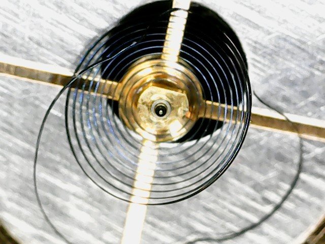

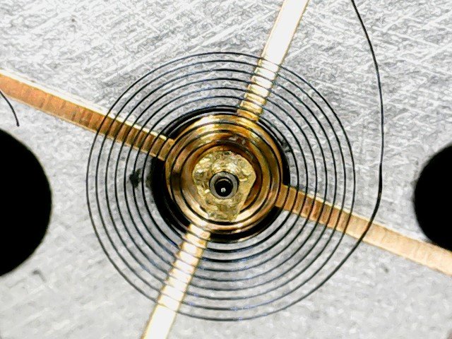

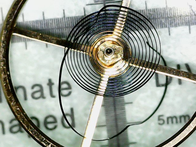

Starting to look at my balance. Urgh. Before I spank $200 on a new one - I'll see how far I can get with untangling it.
Like to think I'm starting to make progress.
Reattaching the stud is future me's problem.

As I was scrolling down I thought "he hasn't mentioned repinning the stud yet!" and then there it was...
So the question I have is, how did the stud become separated from the balance spring? If it broke off, remember that when you repin it, it will now be shorter. Shorter = faster rate, so hopefully you have enough range to slow this down...

It sheared off at the stud entry as I was attempting to move the one of the regulator arms. Me being too heavy handed no doubt.
Ack on the length - I was really using this as a learning experience and was going to cross that bridge when I got to it (I would like to attempt placing a stud). Either way, but it turned out to be a moot point.
I learnt two lessons this weekend
1. Dont attempt hairspring work when you're feeling rushed, or generally p*ssed off at the world
2. Blue hairsprings are a lot more fragile than I realized. (the section that broke did seem 'thinner' than the rest of the spring - almost 'stretched out')
