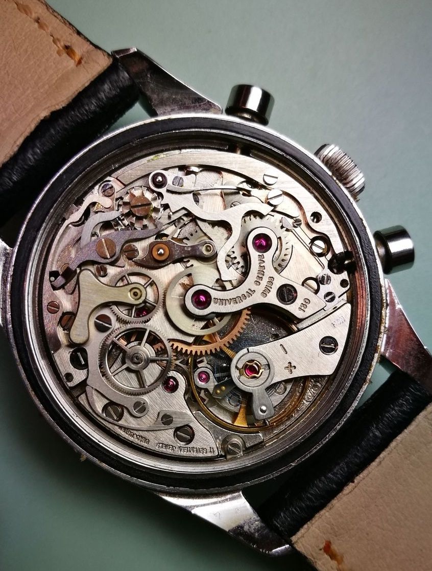

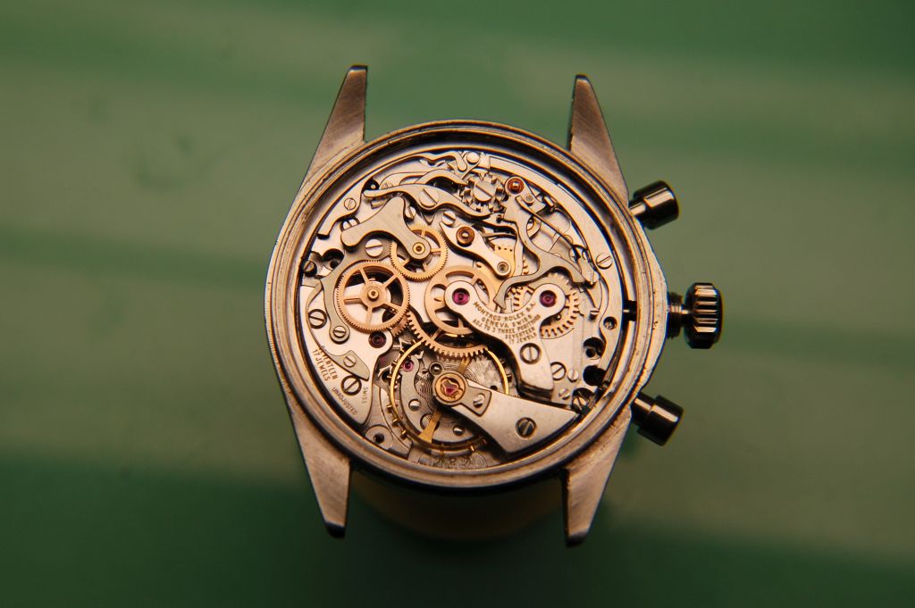

The cal 130 is a Valjoux 72.6...also used in the ref 22703/1 and 22704/1(seen below) and my Rolex 6262 (3rd image)
Can we see the other side of all these watches

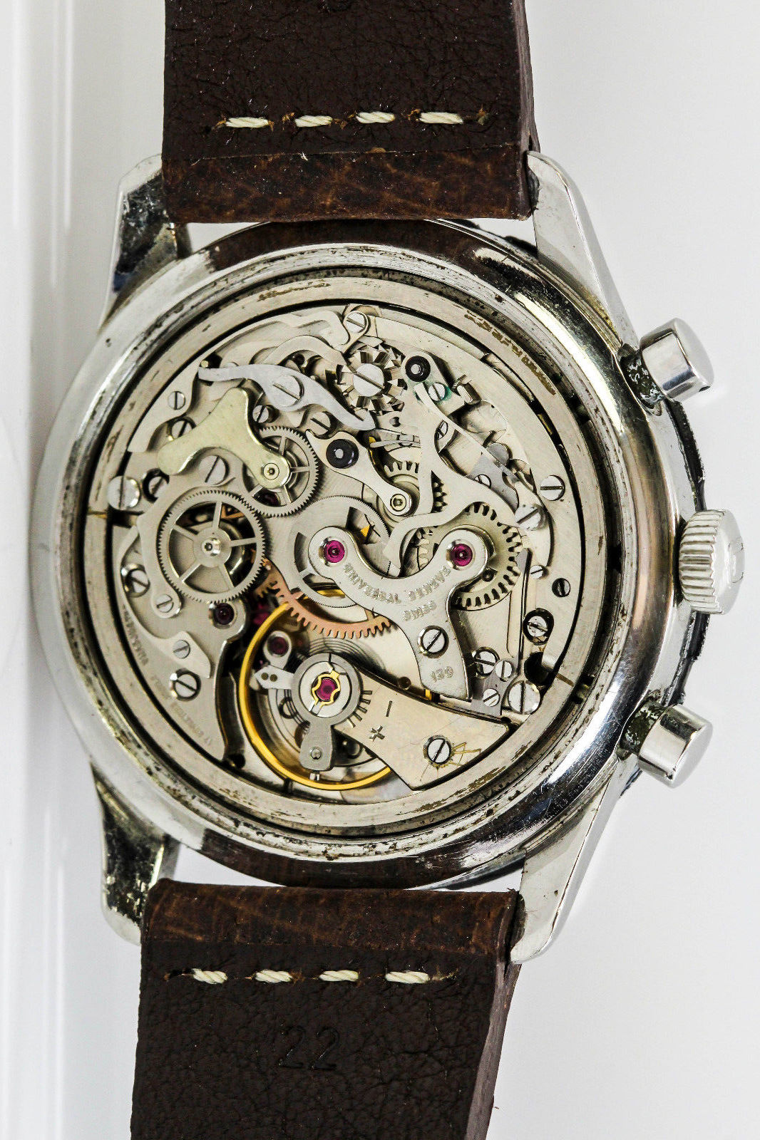

Here is mine also sn 23548xx
BTW- in years of following this reference, Ive not seen another Nina with an earlier serial number than mine. Not saying it doesnt exist, but haven't been able to find one. @southtexas what are the next few digits in your serial?

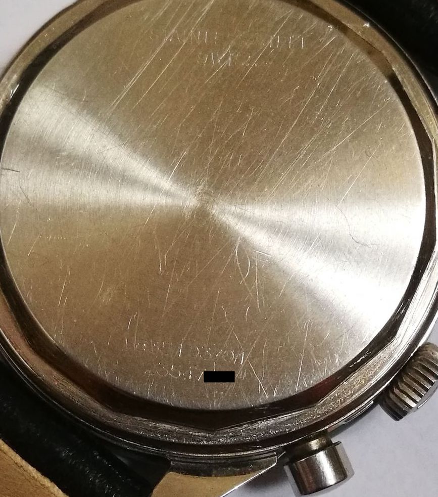

This is an Evil Nina, as found out they started with earlier serials than pandas: 23547XX
also cal. 130

The movement looks pristine. Can I see the dial?
