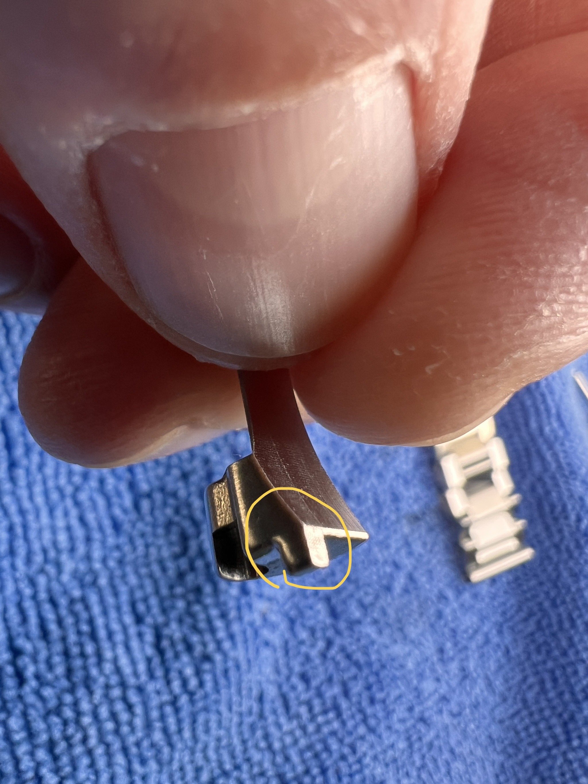

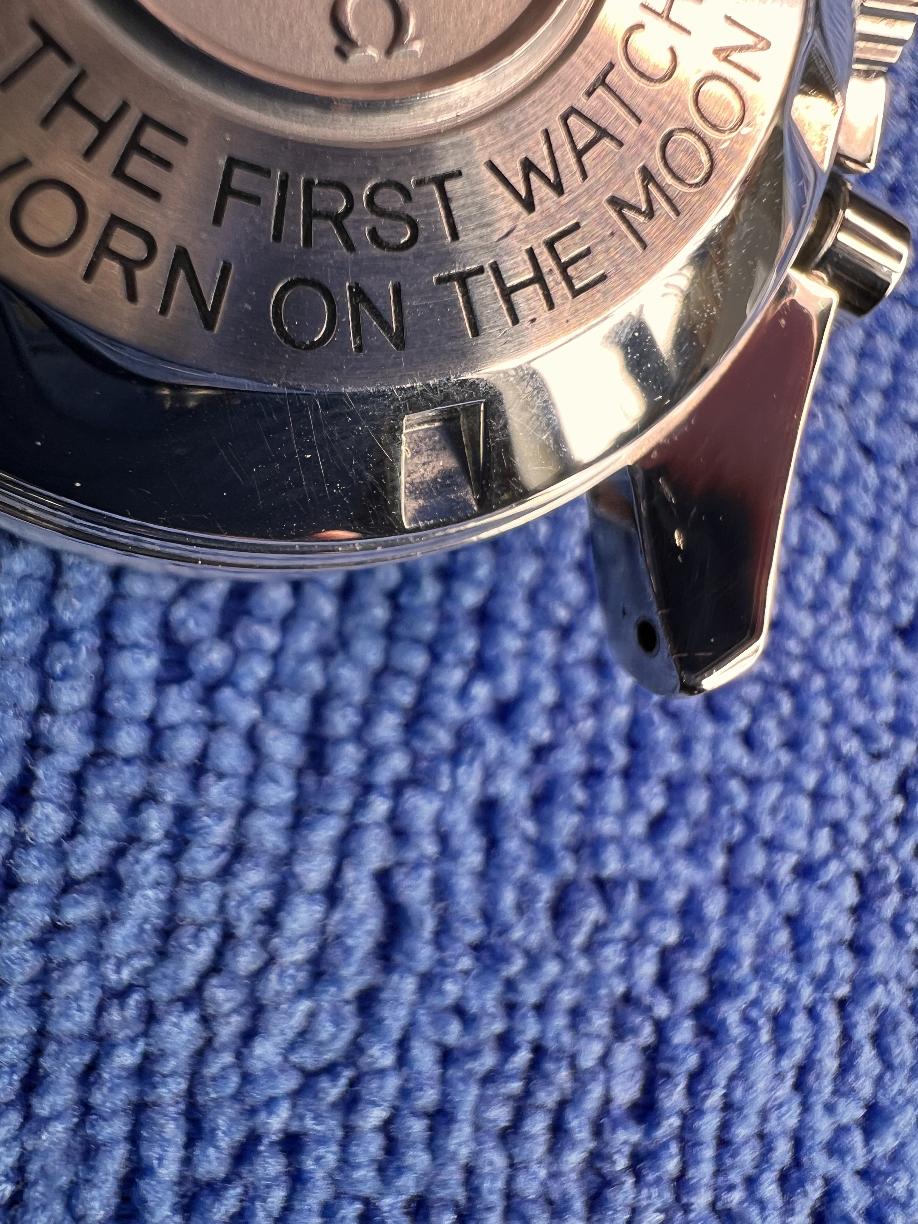

After installing the new Forstner bracelet and changing it out again, I noticed that it had scratched the hell out of the back of the lugs. Now I’m not someone who constantly thinks about these things but it was a little irksome after having it essentially returned to factory spec.

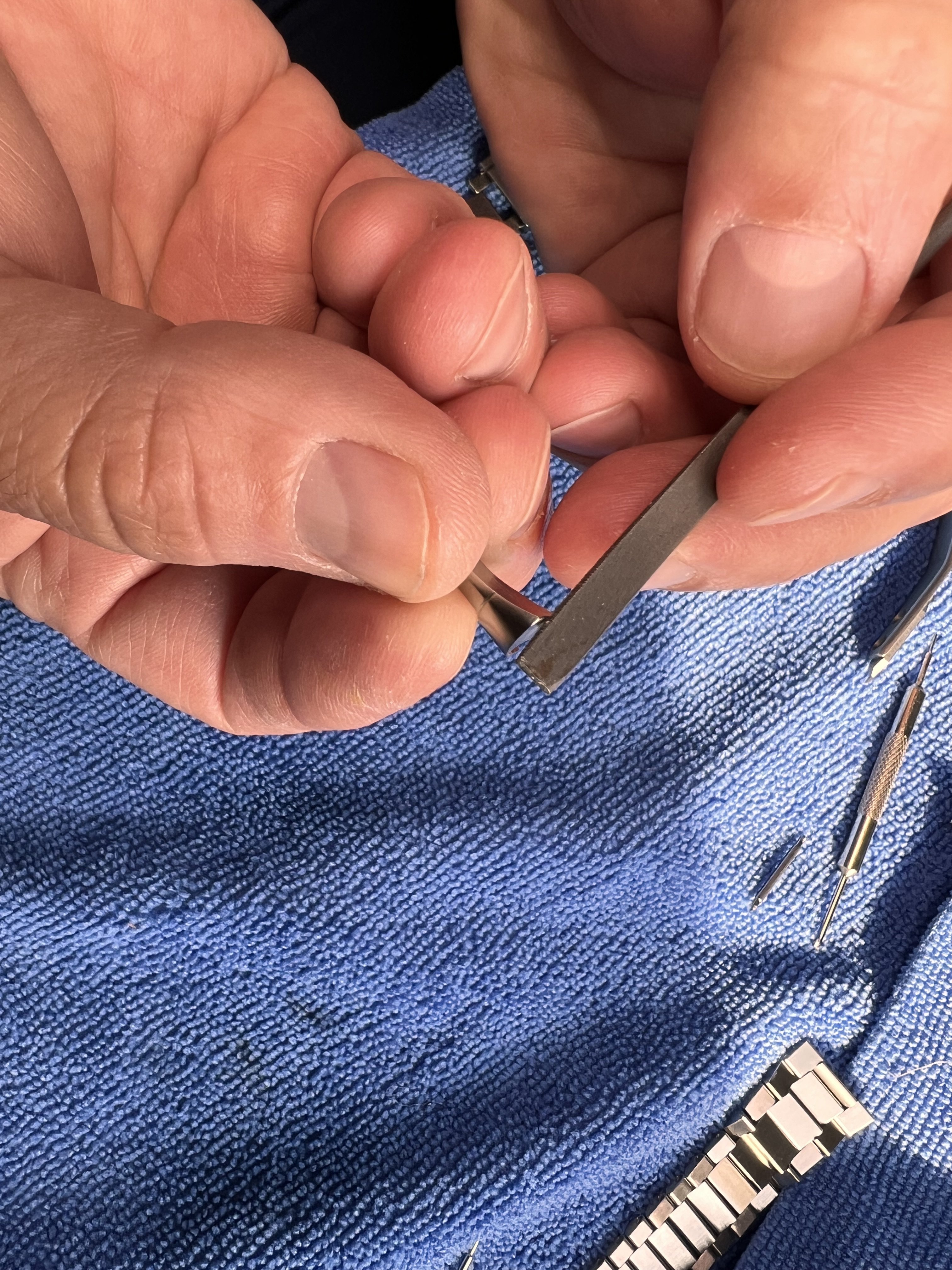

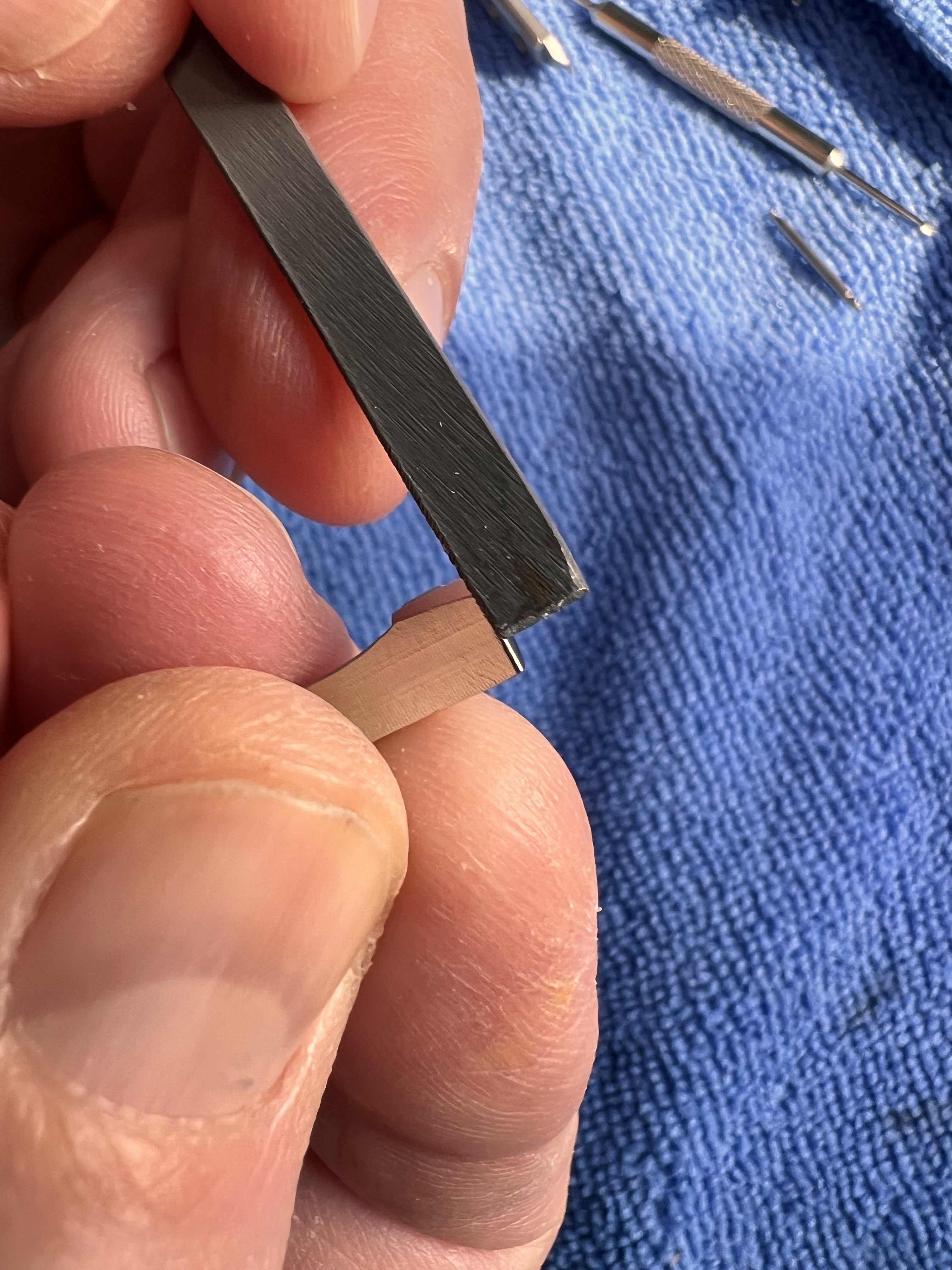

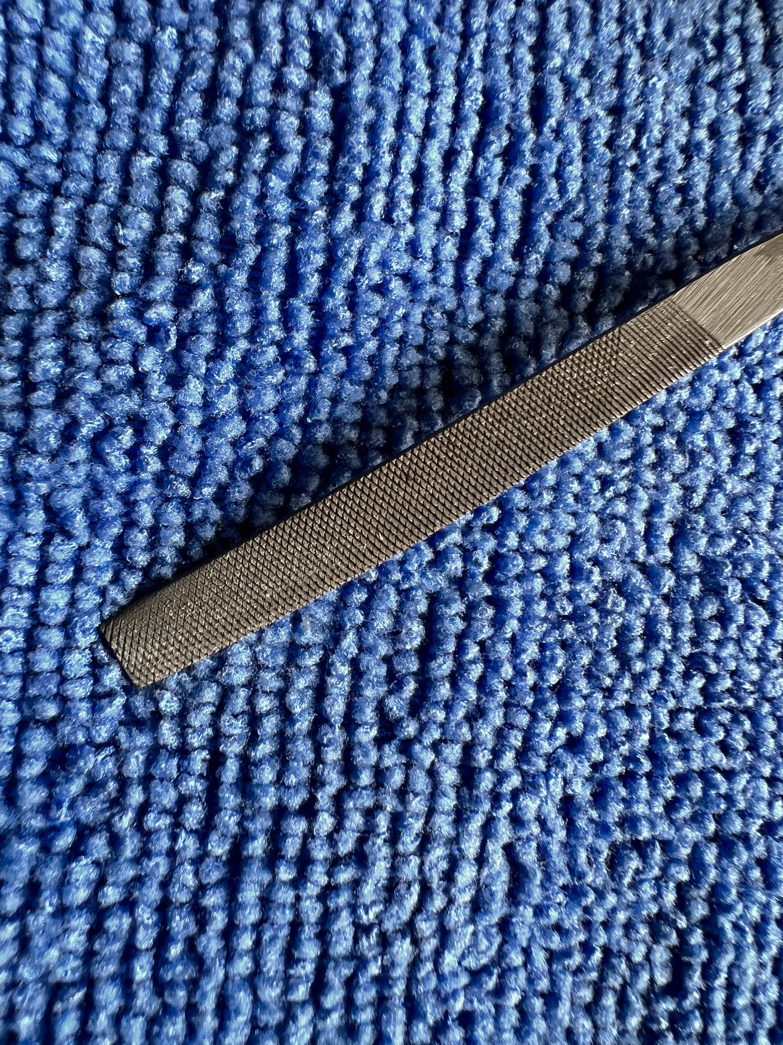

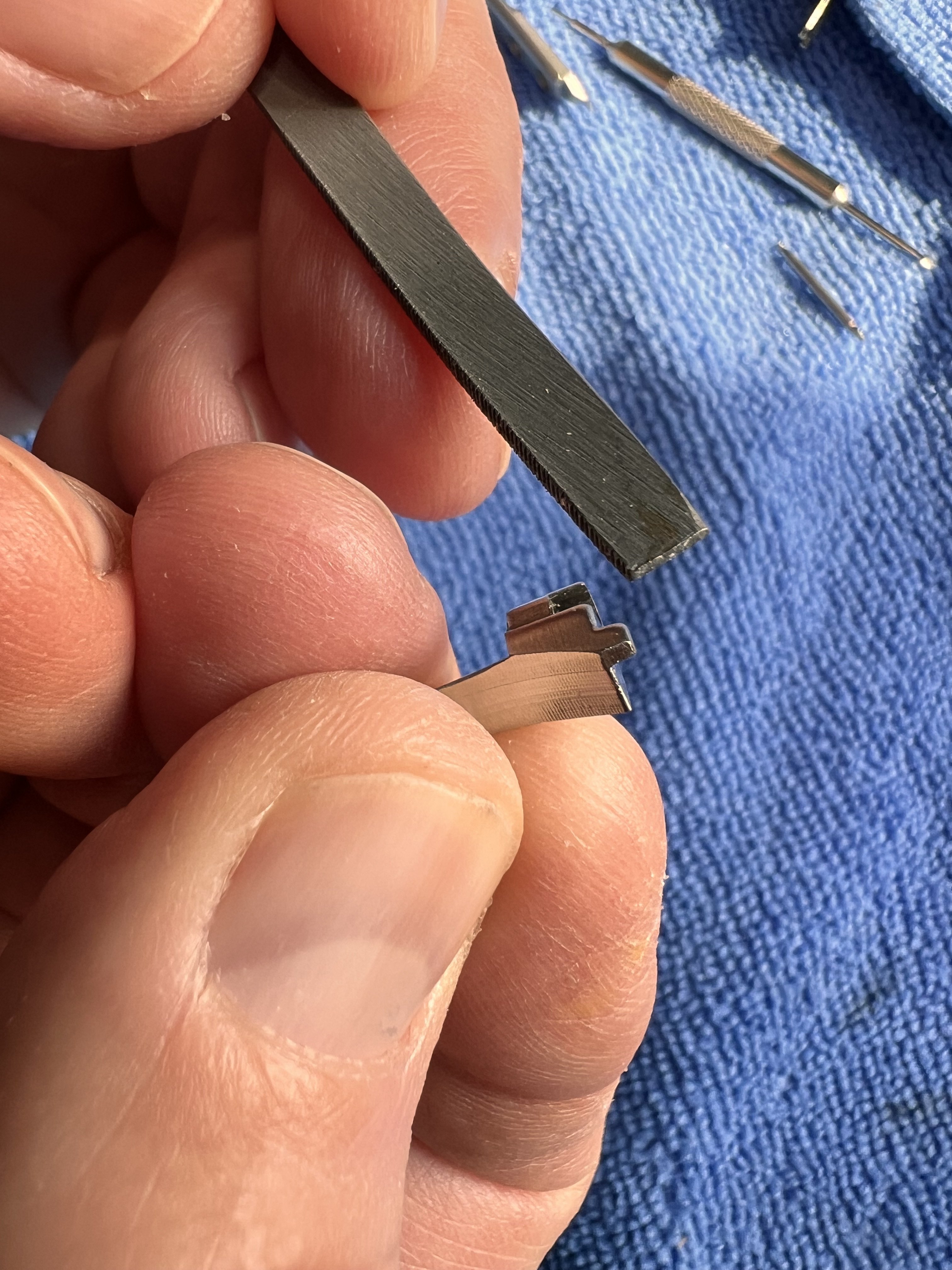

My advice to anyone who attempts to install these Forstner bracelets is to “dehorn” the end-links. I have a few photos showing how I did it. I used a small jeweler file (available in scale modeling stores) and slightly rounded off the edges, which contact the lug rear.

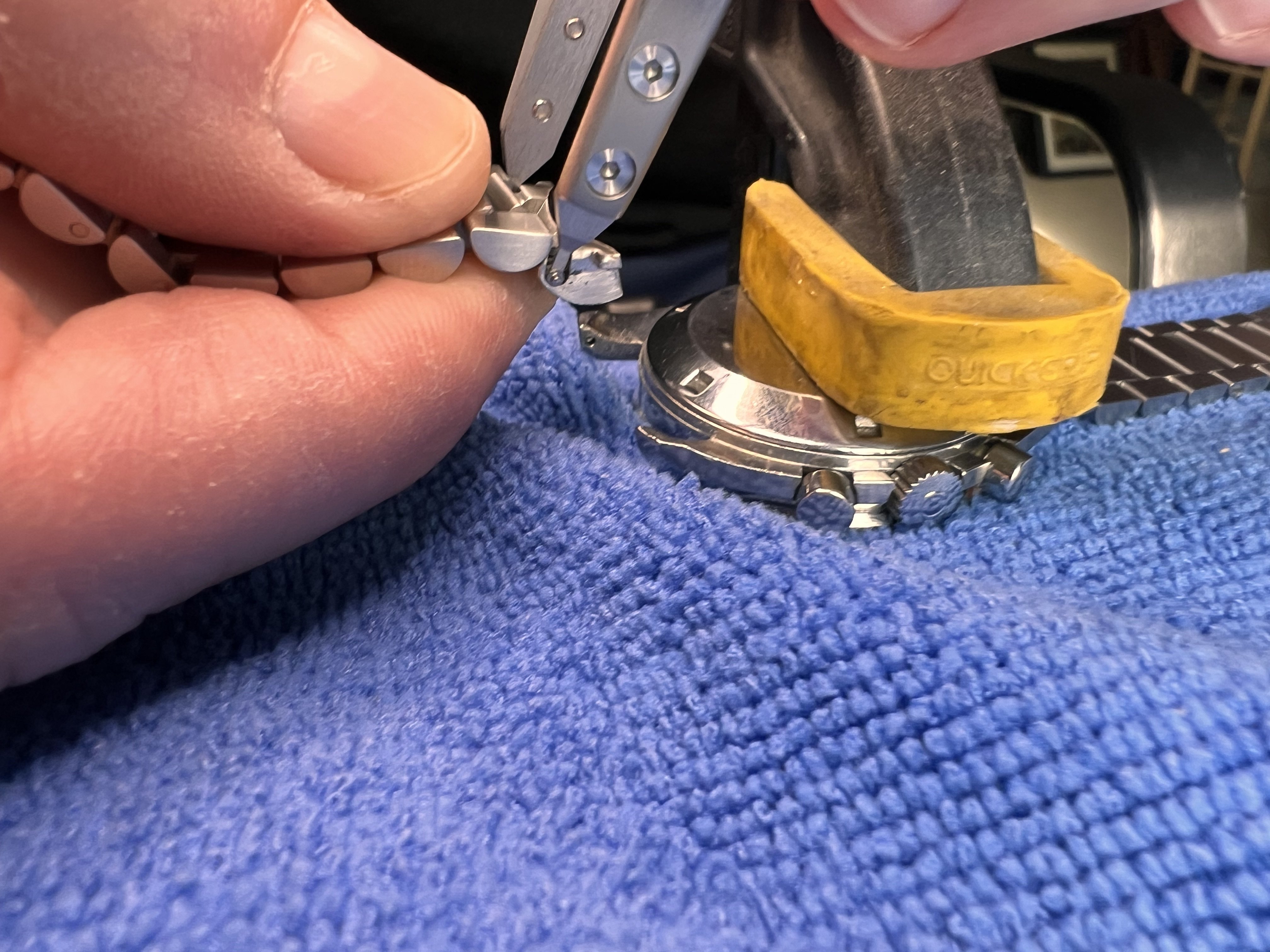

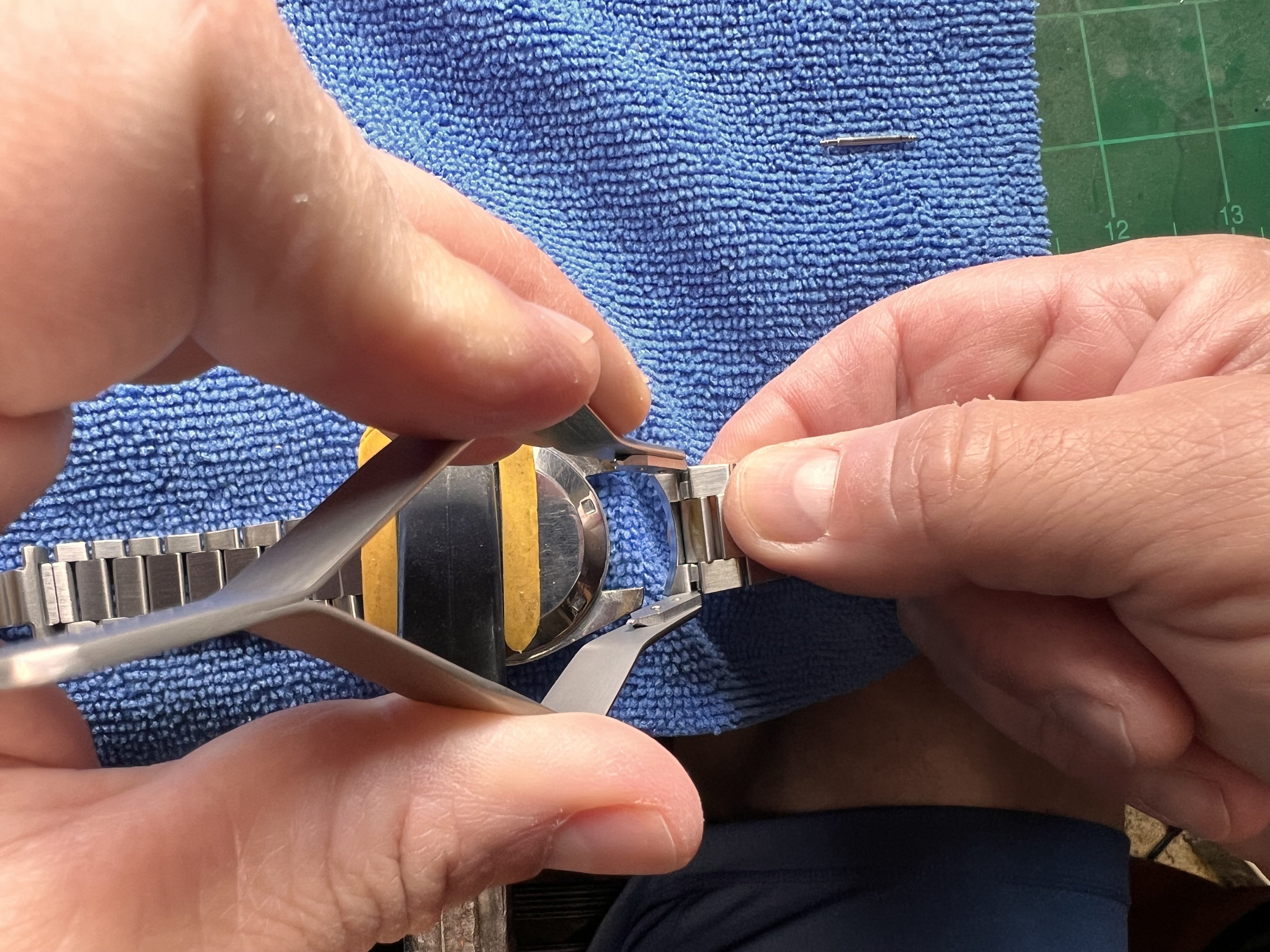

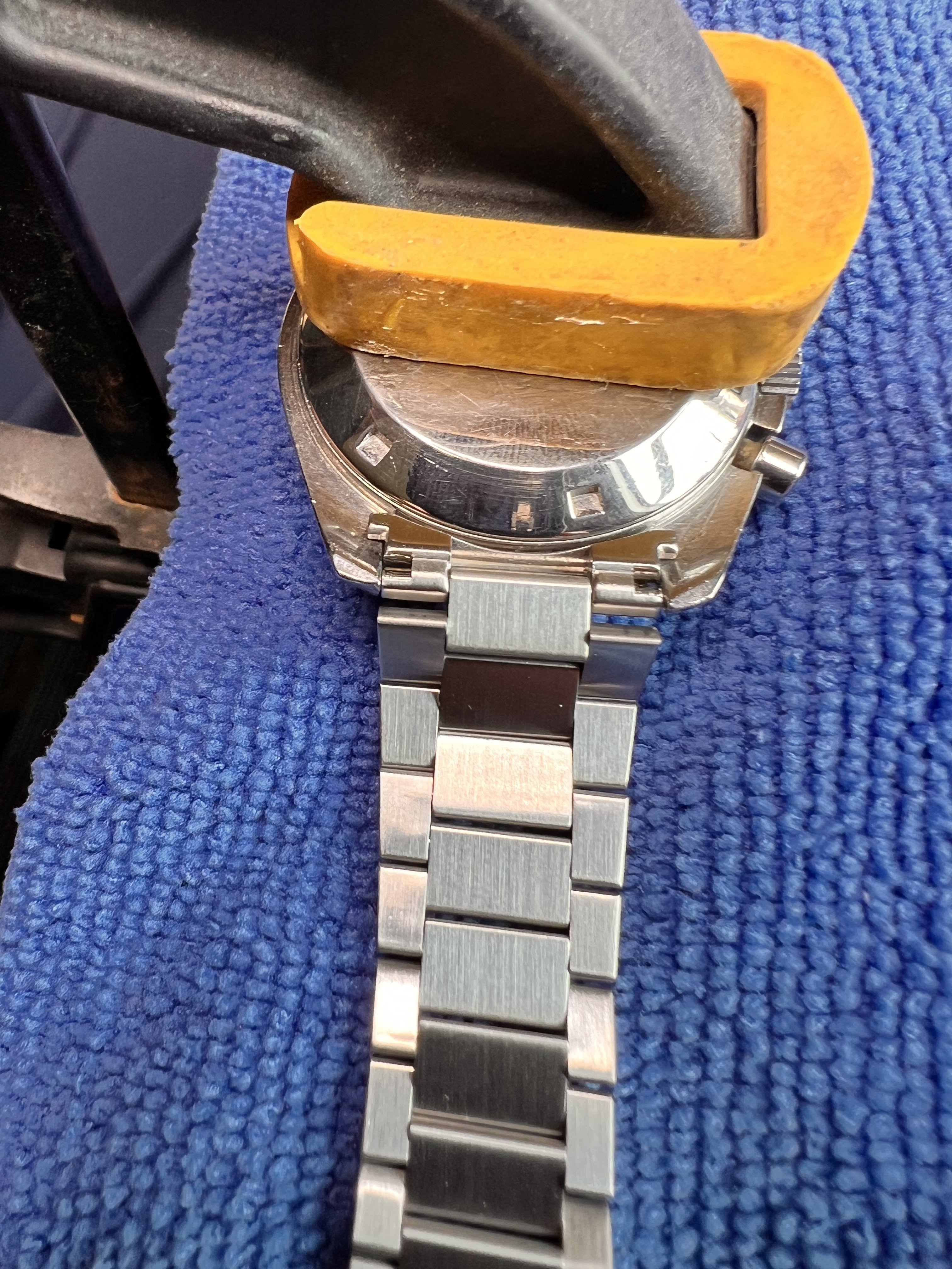

I also included a picture of how I use a hand clamp to create a “third hand” for use with the springbar tool, to avoid further scratching the rear.
