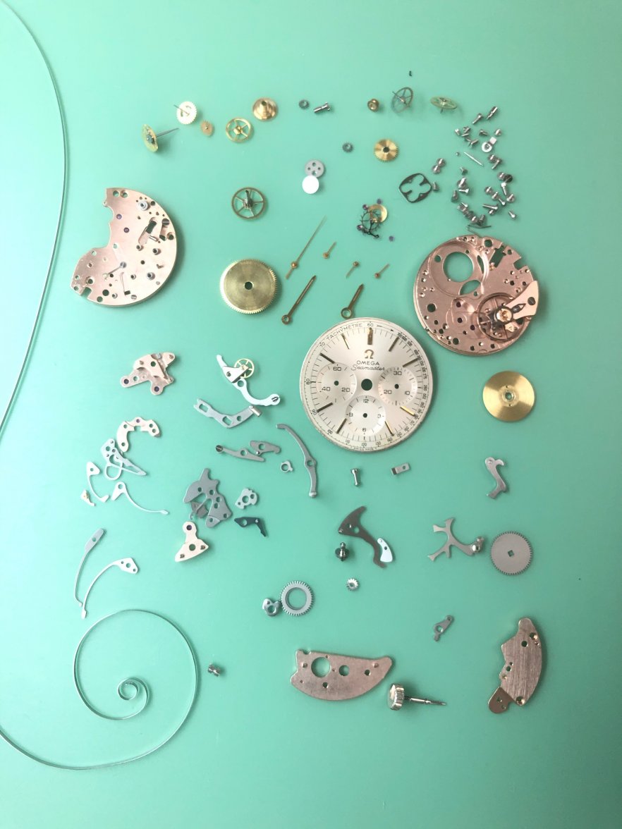

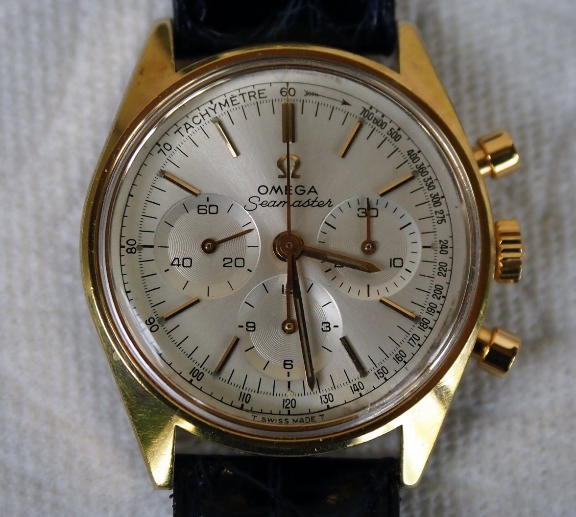

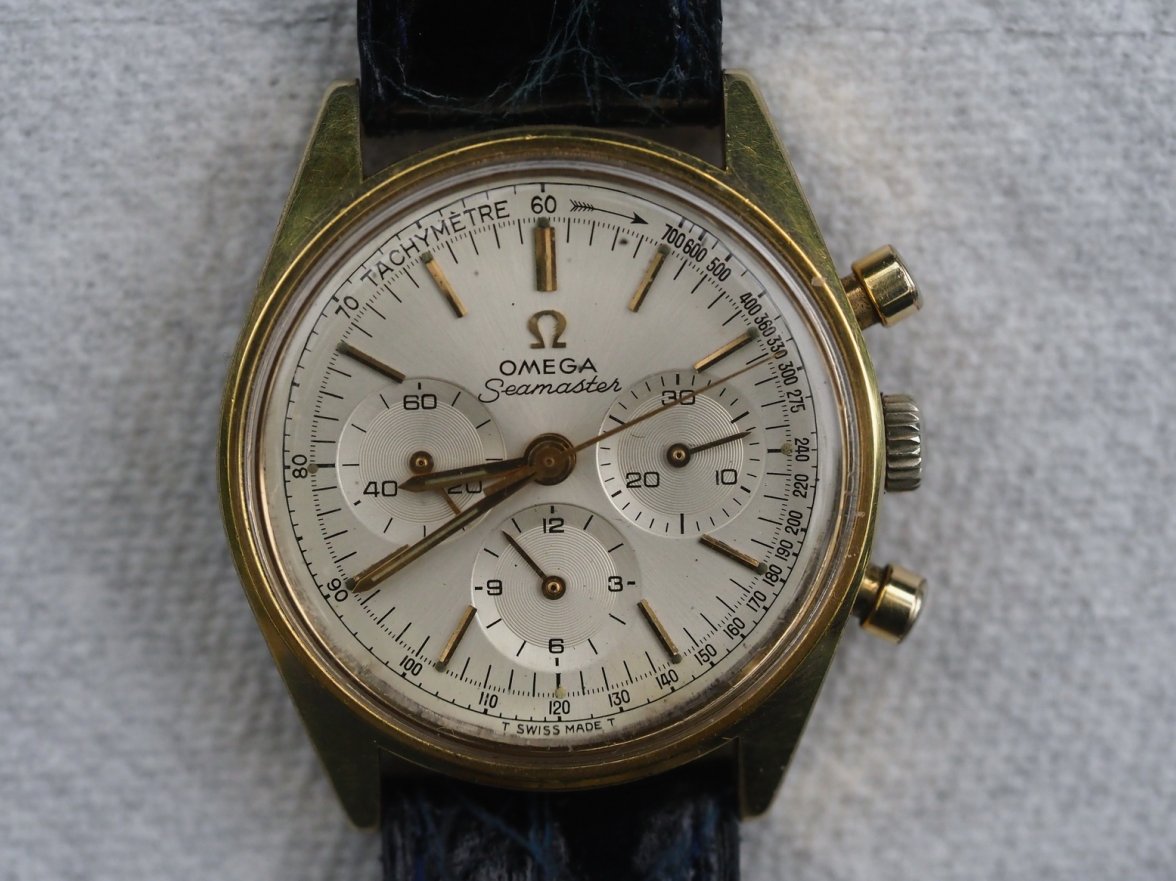

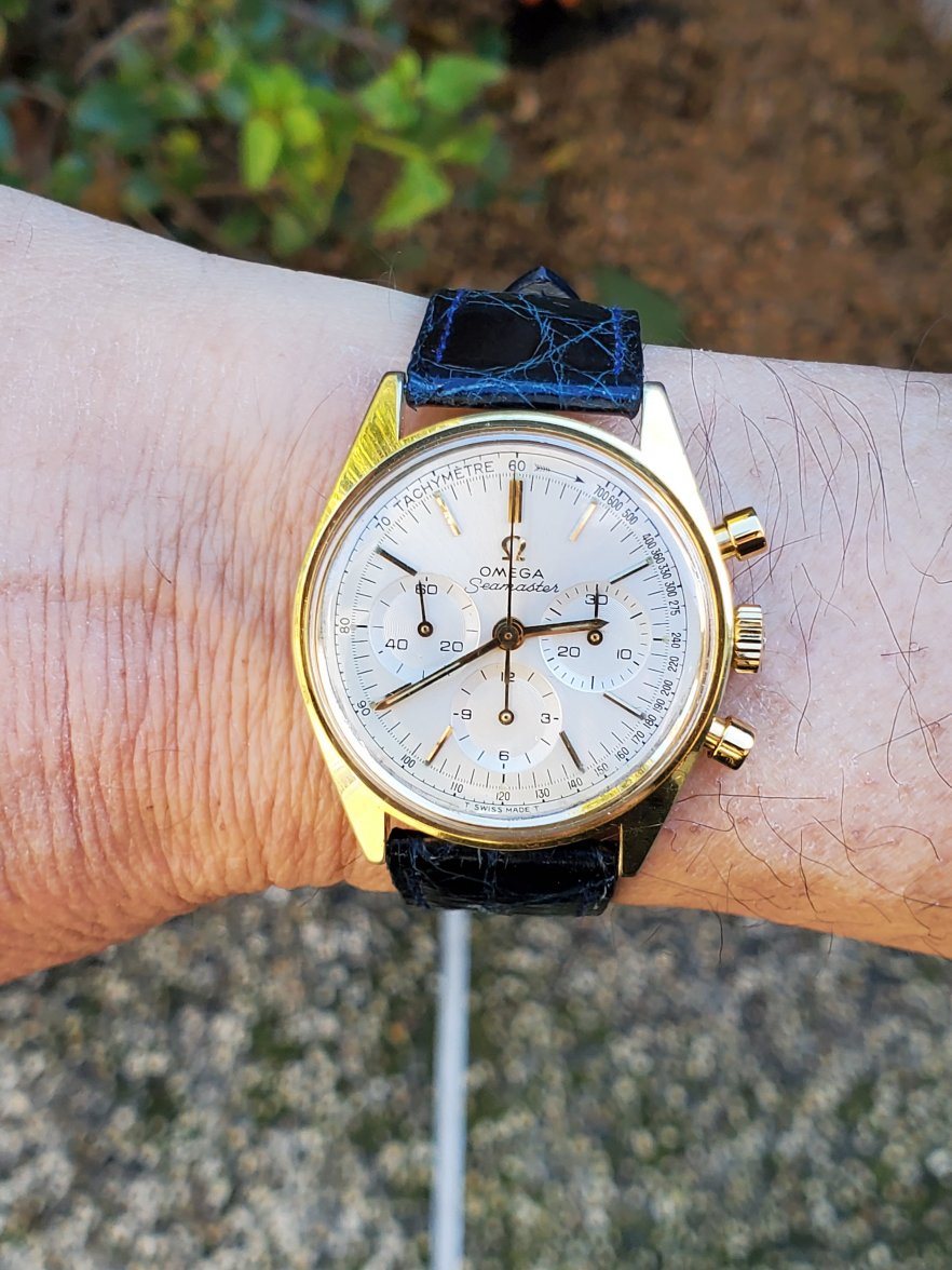

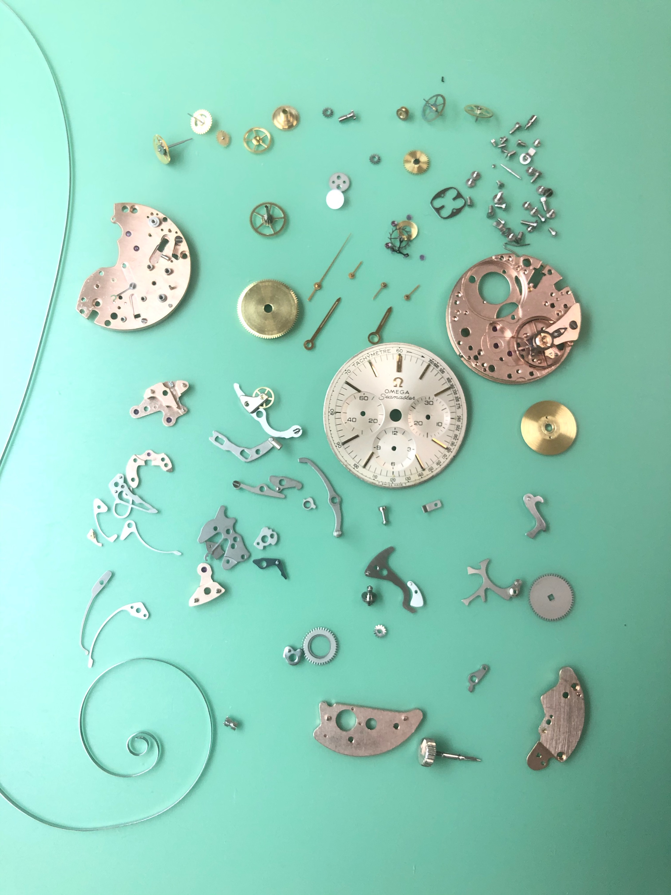

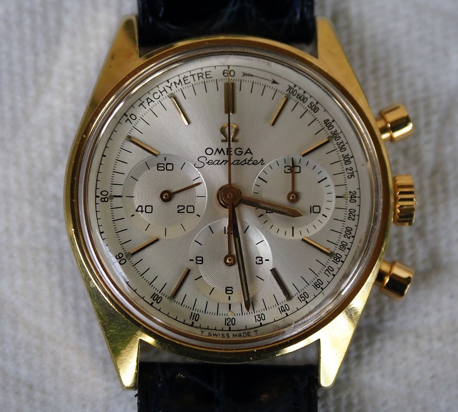

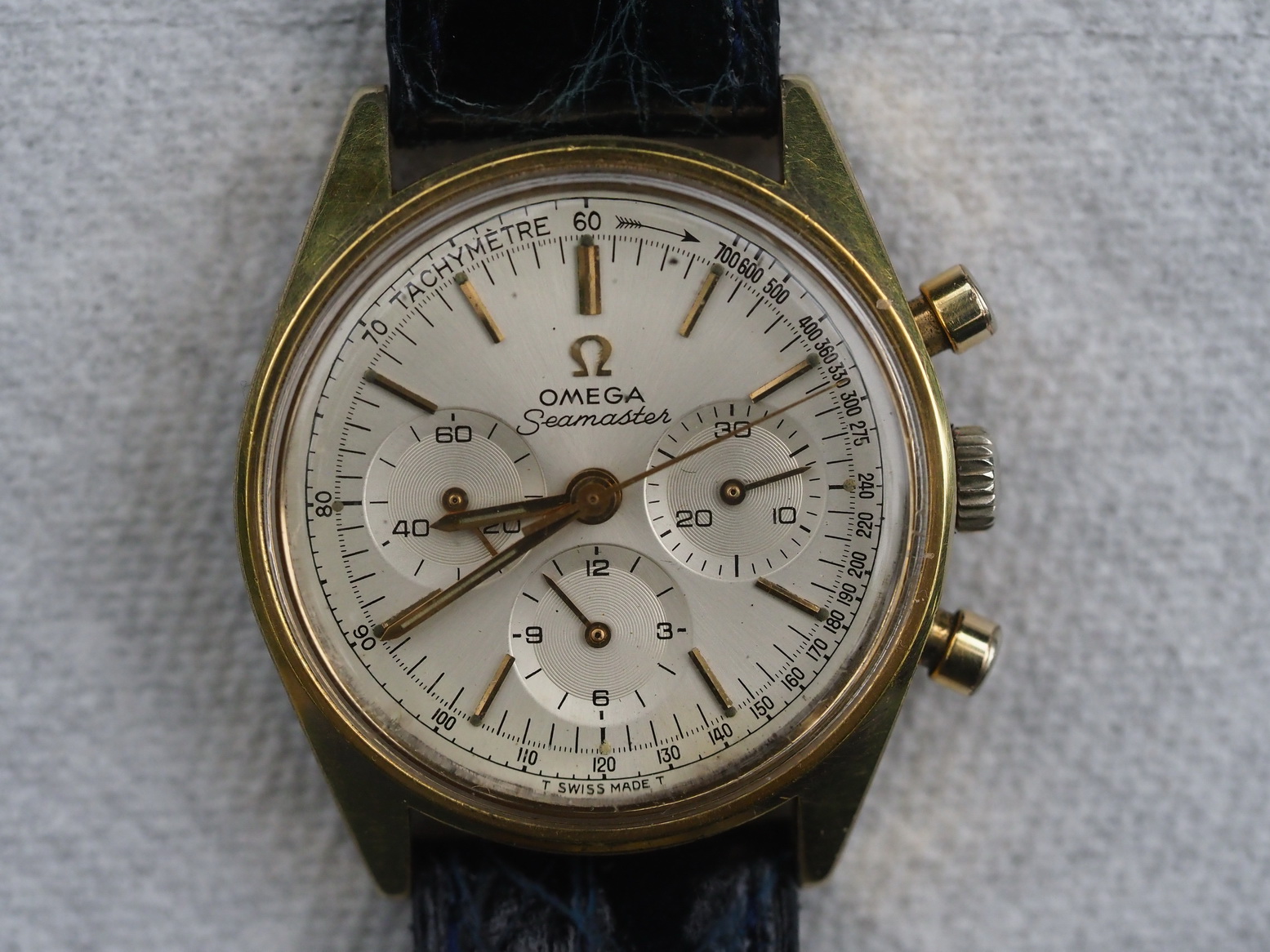

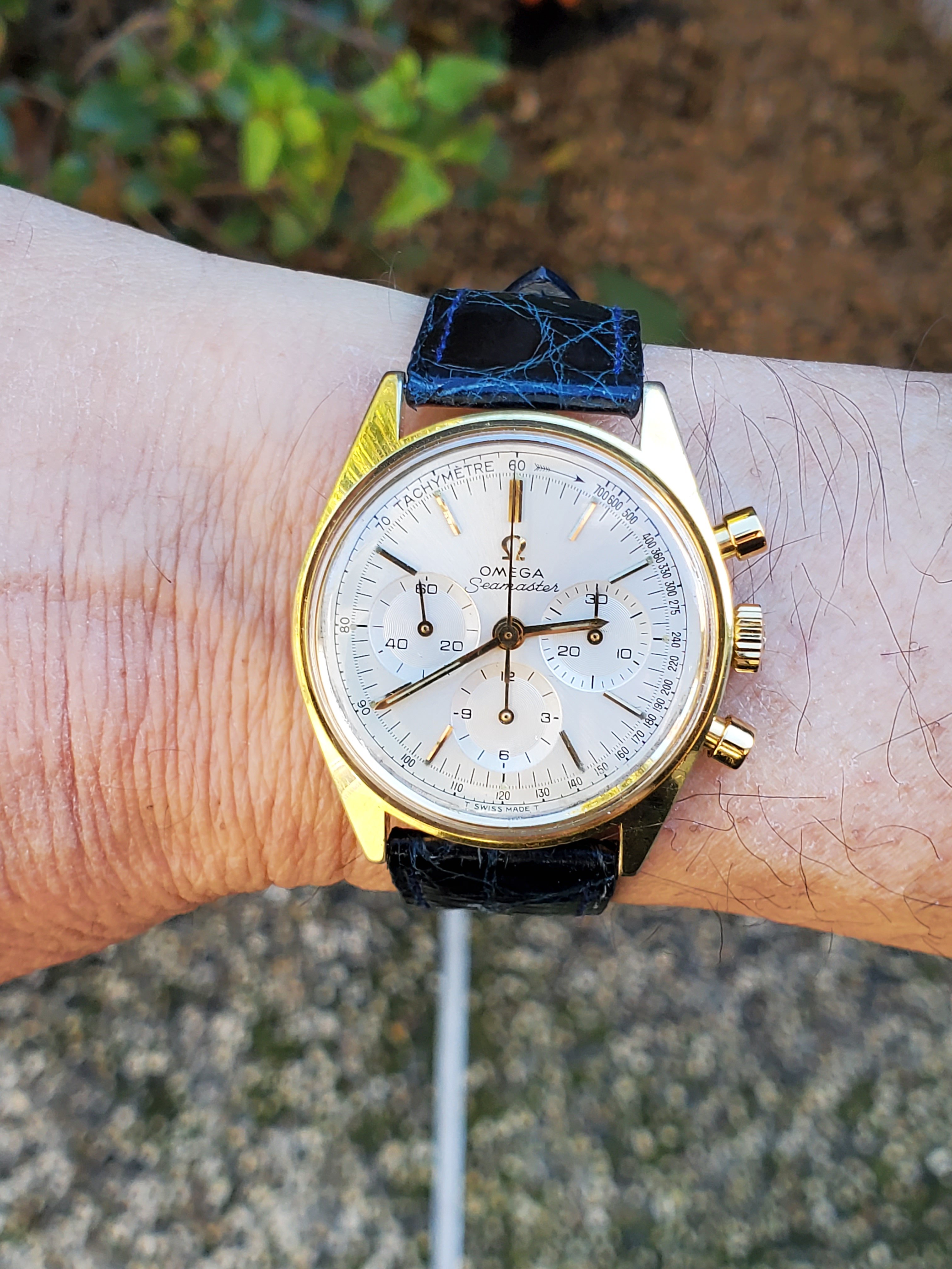

had the watch fully serviced, cleaned, replaced crown and pushers. no polish, original crystal. i think it looks fantastic on my wrist.
following photos:
1)pre service
2) movement
3)post service
4) in vivo!
as an aside, the band, which i do like very much, is showing wear. i am open to suggestions regarding a new band if anyone would like to offer their opinions.

Looks great
a nice, good quality brown leather strap would get my vote
306
1,993
Great looking watch. I second the brown leather strap. Although that would look great on just about anything.

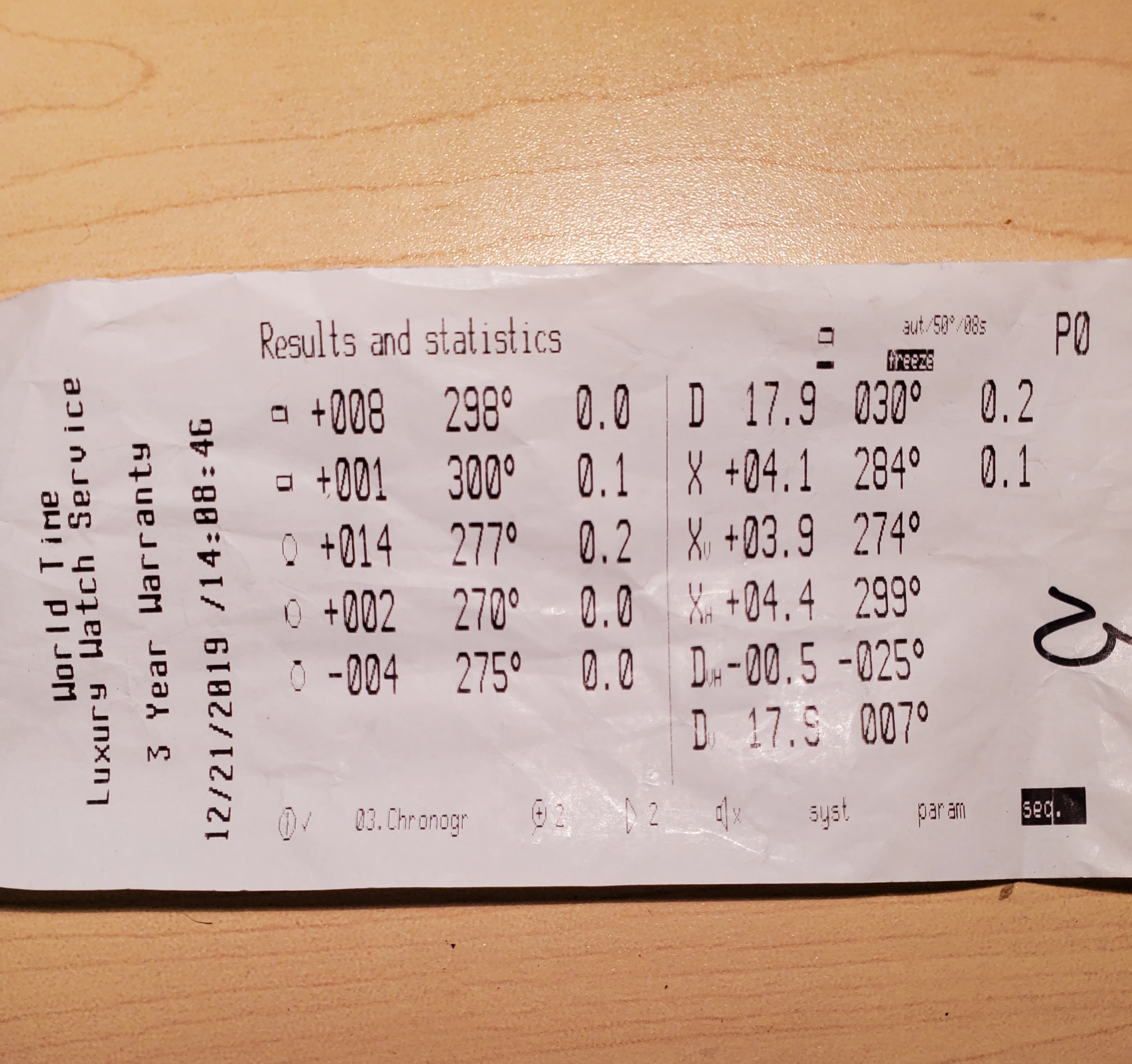

thanks for the feedback. does anyone know if the original band for these watches was metal or leather?

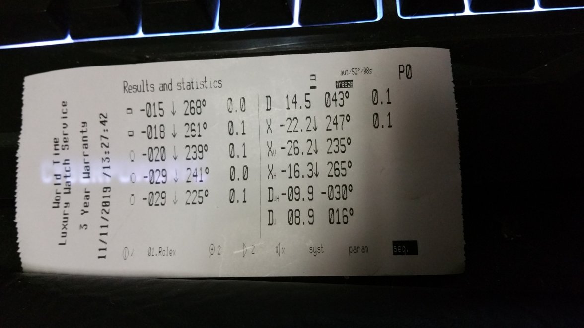

also, for a vintage watch of this type, what is considered to be good +- accuracy? the watch repair printout reads +4 sec/day. i'm thinking this is pretty good. it was - 22 prior the service. thanks in advance

In order to fully evaluate accuracy, you would need to have all the numbers for the various positions the watch was tested under. A single number of +4 doesn't tell you anything really.
Cheers, Al

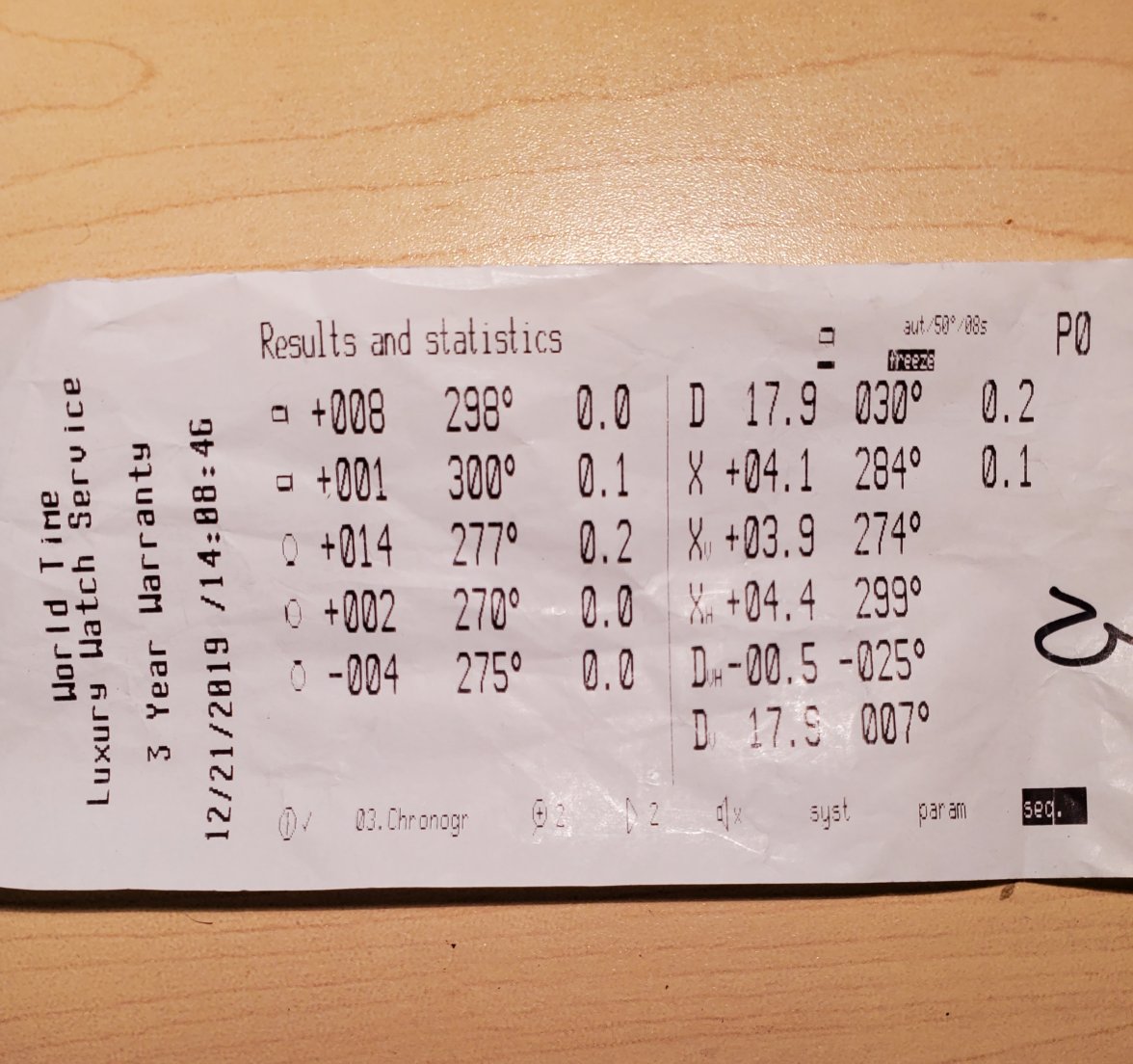

thanks to all who responded.

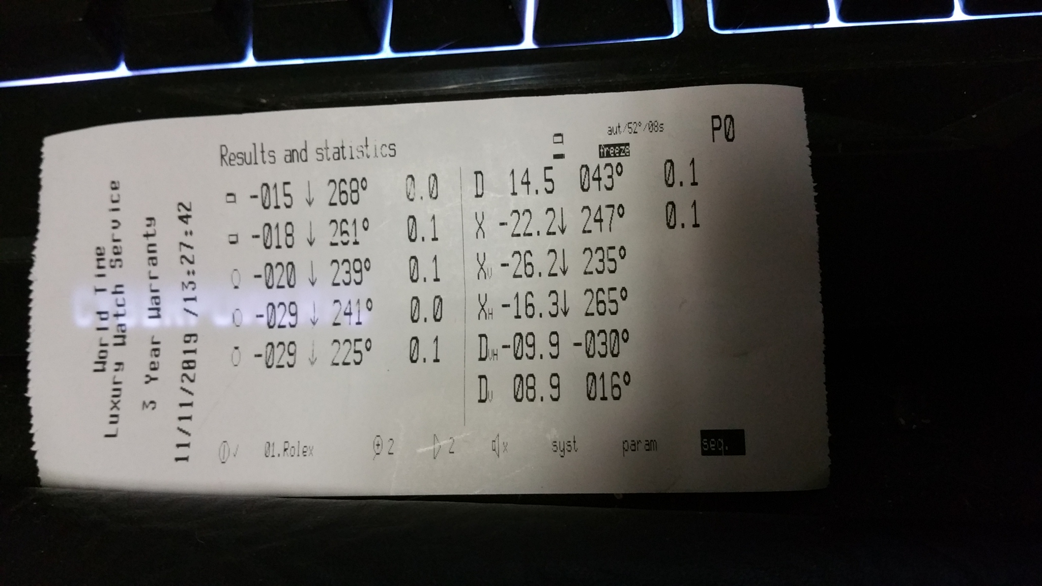

here is a copy of the numbers re timings. 1st photo is pre service, 2nd is post. i dont know what these numbers represent, and if someone can direct me to a site/thread/post that i can learn about it, i would be most appreciative. thanks in advance

The watch is within specs, but the Delta actually went up a bit, which is not something I like to see personally. Not a terrible result by any means, but they can be made better.
For reference the average daily rate for this watch (measured over 3 positions) can be from -1 to +11 seconds per day, so the specs are very loose. Delta at full wind is allowed to be as much as 25 seconds, which is quite loose. For a modern 1861 it's 15 second in contrast.
Cheers, Al
