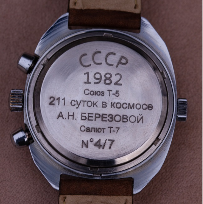

Hi OF,

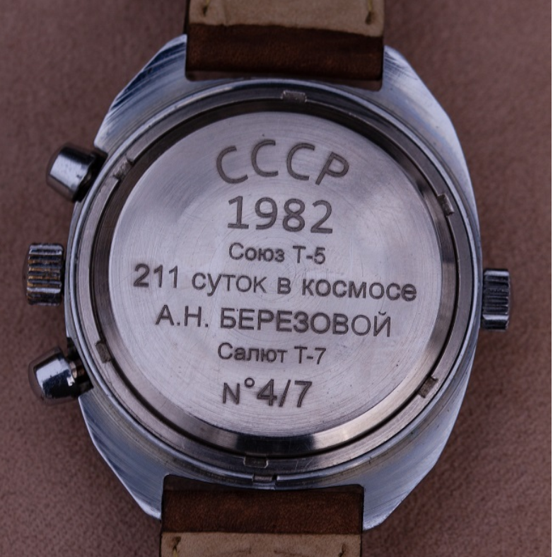

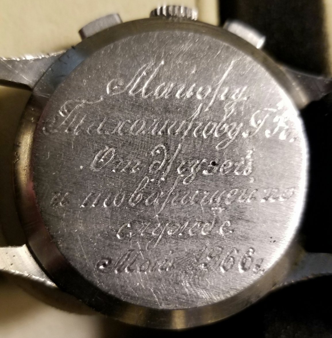

I know there are experts in russian space watches here... maybe they could give their feelings about that back...:
Could it be what it seems to be?... 😲
(For sale on a well known french watch forum right now)
B.
1,615
3,862
Worn crown on a nos modern case? Not smelling that good. (older chromed cases have less pronounced machining marks behind the lugs, 1990s ones look like that). Also the engraving looks a bit like those from a laser. Not stamped like factory backs in the 80s, not hand engraved either.
And from the front, how does it look?

That’s an interesting find. @SpeedyPhill would be the resident cosmonaut expert and I’m sure will chime in soon with a picture or two.
The watch is engraved for Anatoly Berezovoy who commanded Soyuz T-5, the first crew onboard Salyut 7. You see Salyut 7 engraved as well as 211 days is space the number of days spent onboard Salyut 7.
Do you happen to have picture of the watch face? Is it white? If so, maybe the one strapped to his left arm on the white strap.

Since the 211 days wouldn't have been known in advance, my guess is that this might be one of seven watches taken into space (this being number four.) Each were engraved back on Earth and then sold or given to friends.
Having the same dial as the photo would help support the idea, although not be definitive proof.
Usually there is a paper trail for a space watch. Absent that it is risky to assume a watch was in space. Sometimes there is still someone around who was involved with getting them in space or engraving, who can vouch for the project, which helps.
@pdxleaf I think you are correct here.

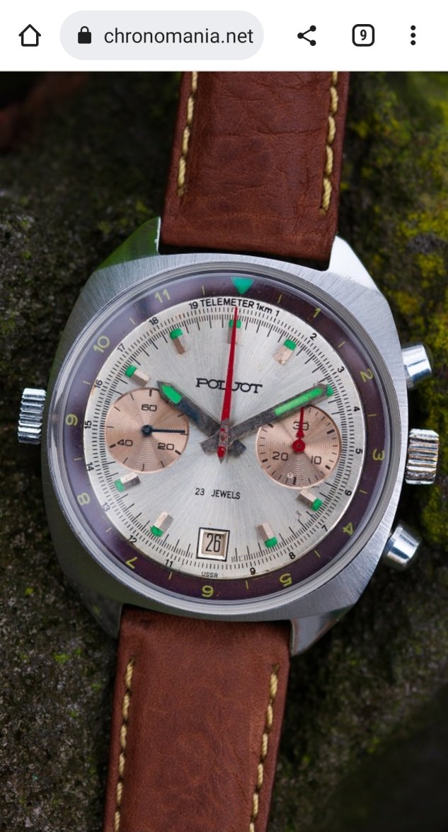

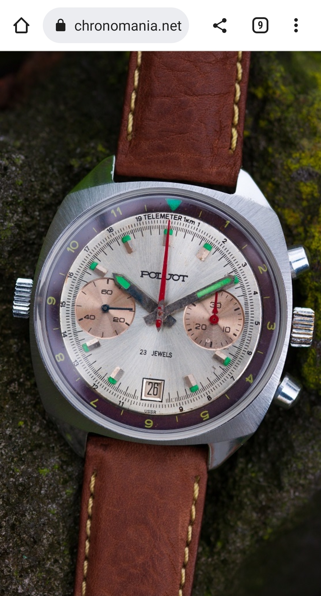

Here you are... A nice 80's looking one...😁
And a clue to get its selling price...
1,615
3,862
Well, the date ring is not from a watch made in the early 1980s... It has the later more common thin font. I bet the movement is from the 1990s.

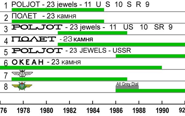

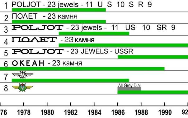

Definitely NOT a 1982 Poljot (see the chart below; the wristwatch on sale would date to 1986 and onward). The one worn by Berezovoi is shown below. Pictures from (WUS) Whatchuseek forum, I believe.

Definitely NOT a 1982 Poljot (see the chart below; the wristwatch on sale would date to 1986 and onward). The one worn by Berezovoi is shown below. Pictures from (WUS) Whatchuseek forum, I believe.dial
beautiful chart that summarize the dial indications. Min should fall in the 3rd line
