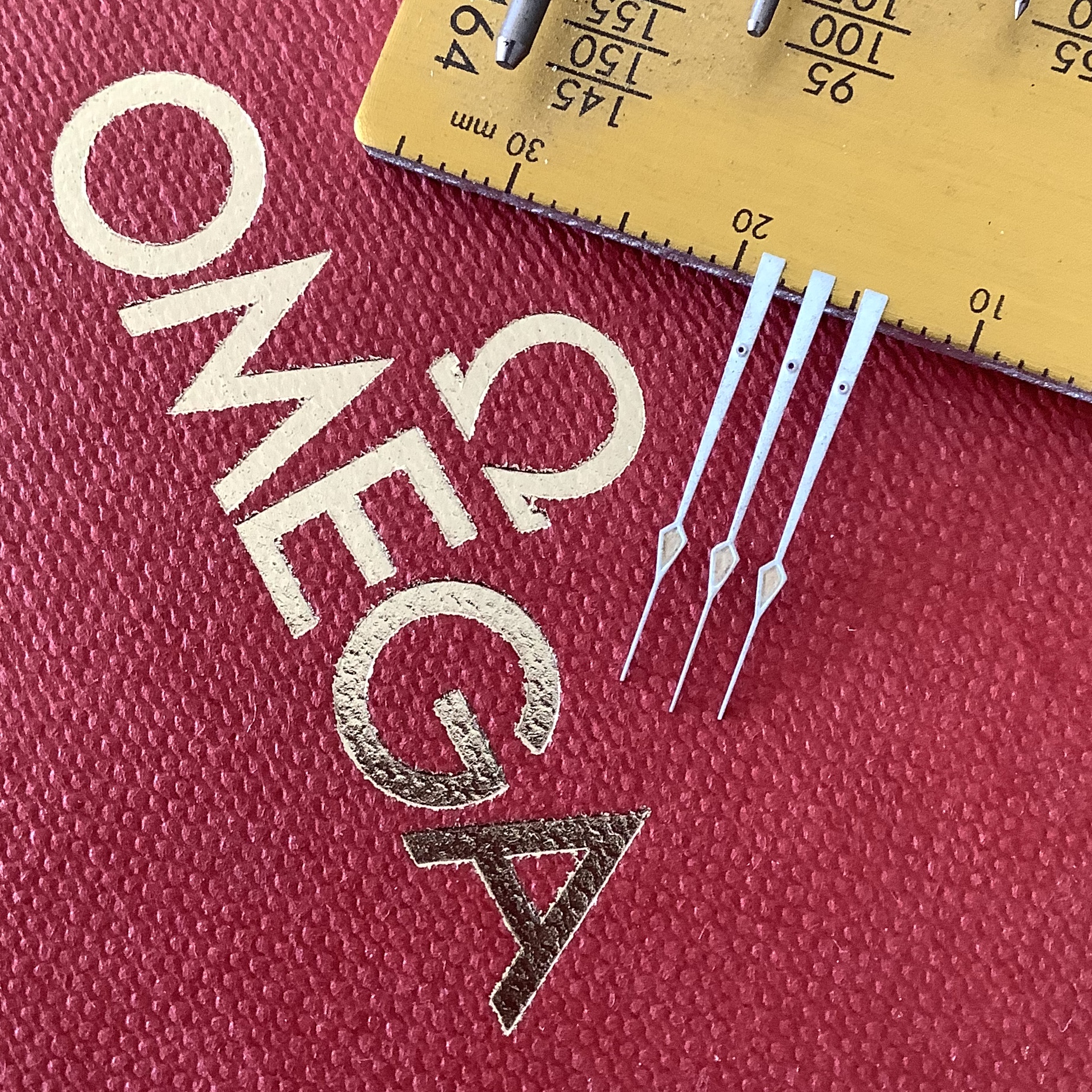

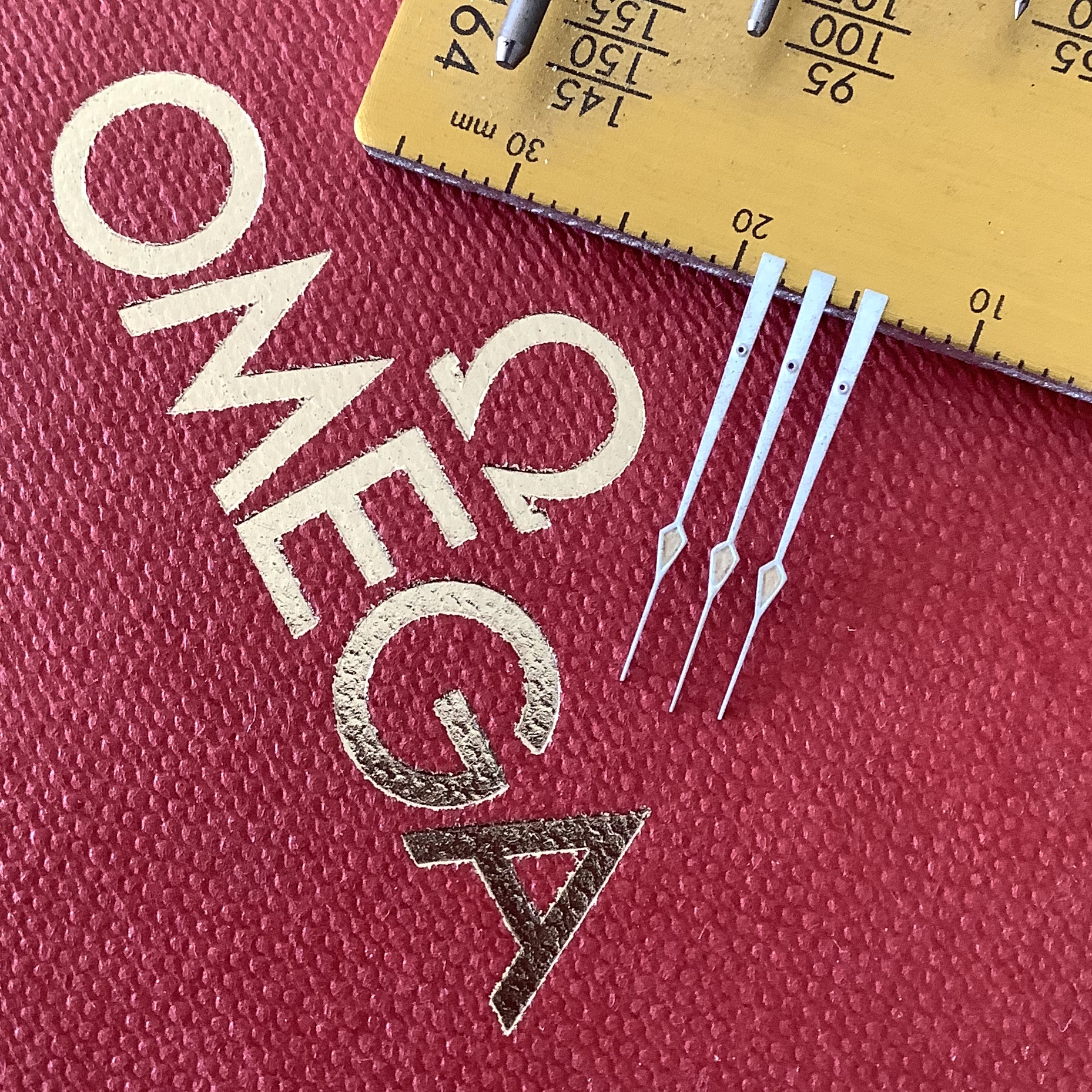

I’ve looked for clear information on flat tail hand dimensions and haven’t really found much. I’ve got three Tritium flat tail hands that initially look to be all the same, but on closer inspection there is one that is fractionally longer than the other two. Measuring as best as I can I get one at 18.80mm and the other pair at 18.30mm. In MWO there is no mention of lengths in the main hands section, but the Ultraman orange hand is described as 18.80mm so I concluded that my 18.80mm hand is probably an original hand. The other two might be Tritium service hands (which I understand can be slightly shorter).
Does anyone know if this is documented anywhere, or am I left to I only speculate...
18.80mm in the middle. 18.30mm either side.

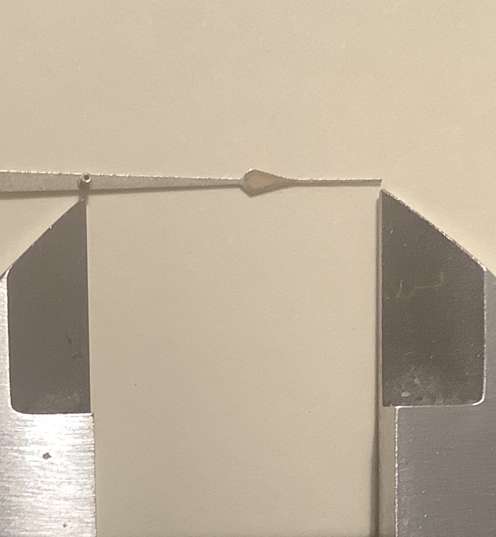

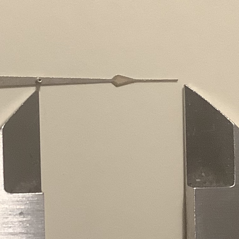

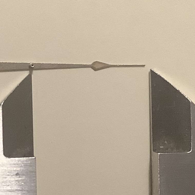

So with my calipers set and locked at 14.75mm, this is the long hand (top) and one of the two short hands (bottom). Obviously the long one appears to be a good match, the short one, well, falls short 😁

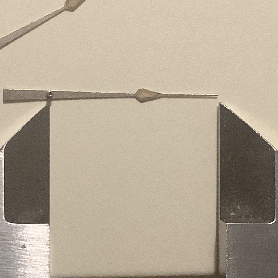

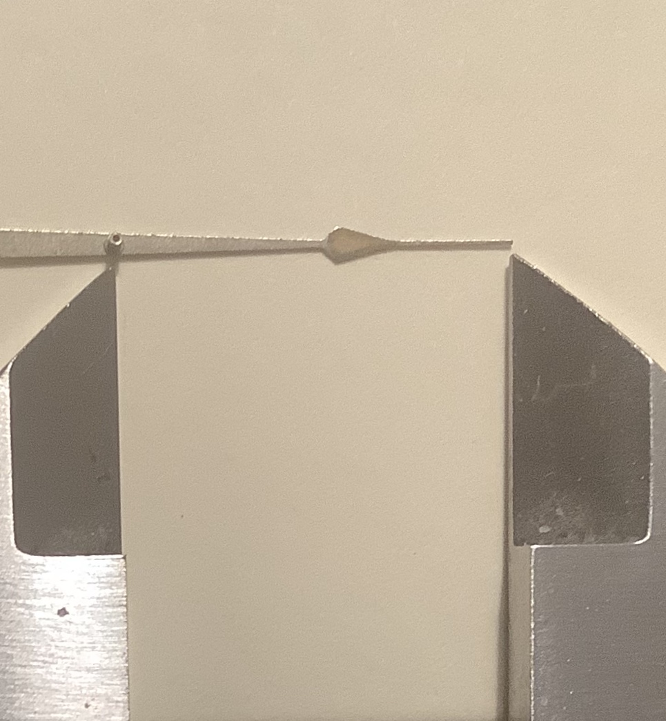

And now with the calipers reset to 14.00mm this is the short hand.
Personally I’d say that’s it’s fractionally too long, but absolutely no doubt it’s much closer to 14.00mm than 14.75mm. So yes probably one Pro hand and two Mk. II hands. How on earth most sellers tell the difference is beyond me.

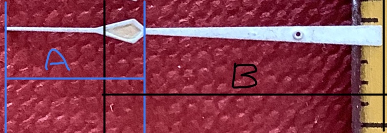

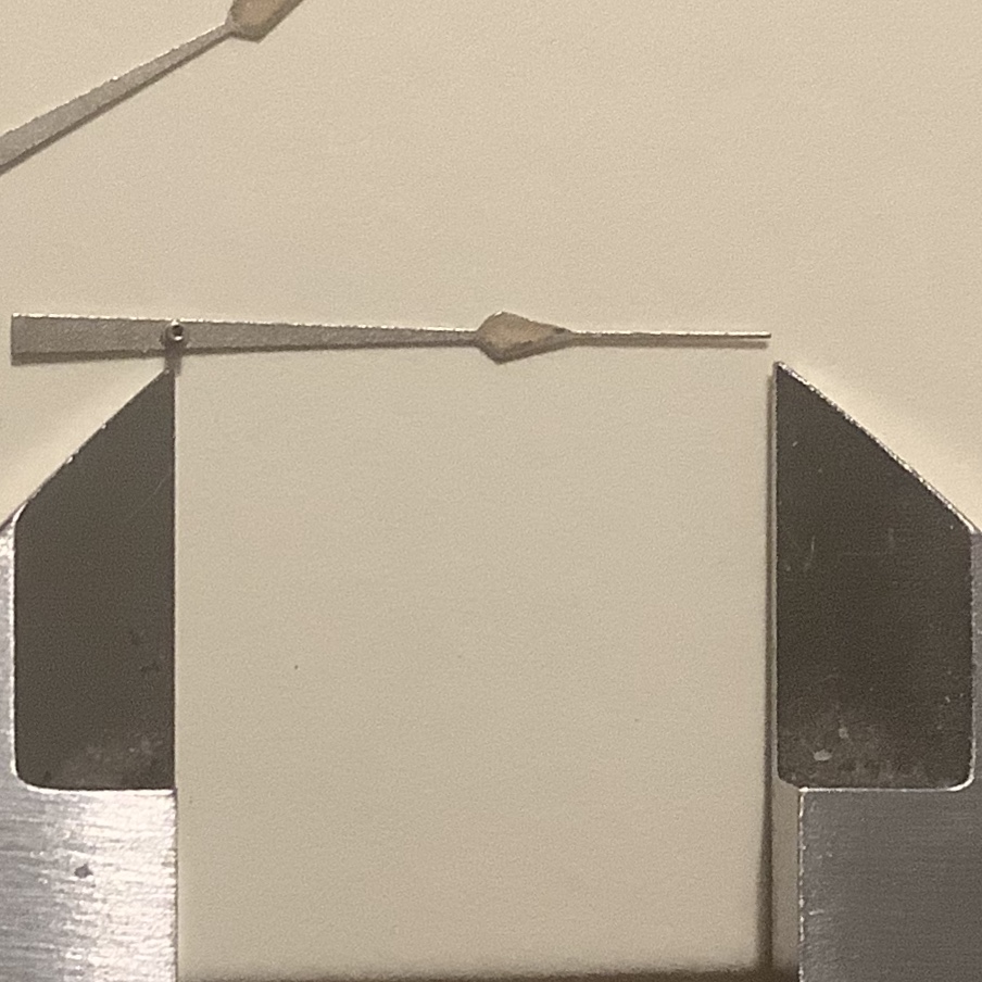

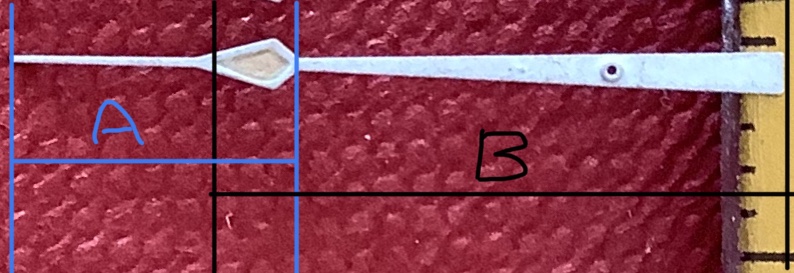

OK I tried to come up with a quick visual test. On my shorter hands distance B is pretty much double distance A. For B use the far tip of the lume and the back of the hand. For A use the tip of the hand and the transition at the back of the arrow head. For my long hand it is clearly less than double. Might be a useful tool if you’ve only got a picture, but of course it needs to be a very good “head on” picture otherwise the perspective will mess it up.
Edit for clarity... This double rule seems to work for the Mk. II hands. A Pro hand should have a longer “A”, so A.2 would be a fair bit longer than B. I’ll run some checks on images in MWO.

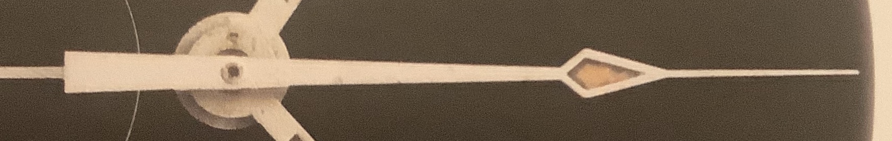

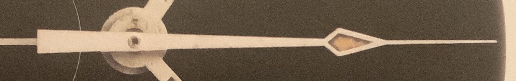

From MWO hand type C.2
On my screen A is 5.4cm and B is 10.4cm, so it kind of works (A is more than half of B).

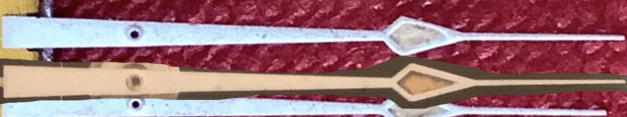

In the end it’s getting confusing 😁

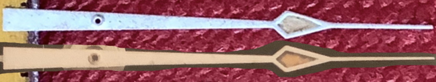

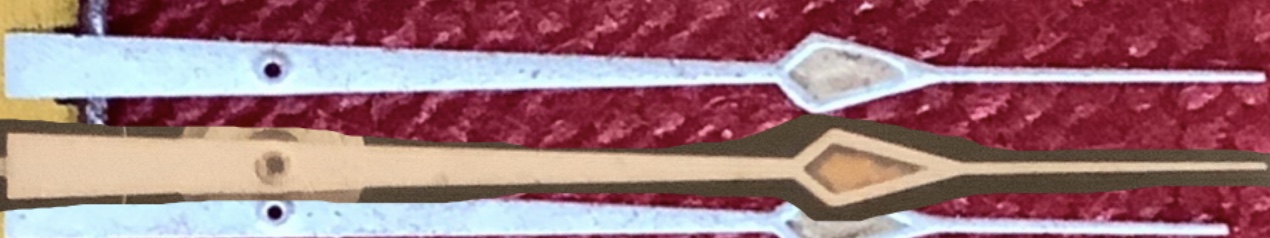

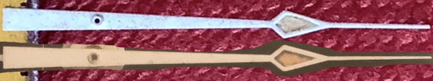

These are my two hand types against the reference from MWO. I’ve scaled as best as I can so that the overall length is the same. I’d say my shorter hand is a much better match in terms of proportions. My long hand obviously has a relatively longer tip as the lume cut outs no longer line up.
Short hand vs. C.2
Long hand vs. C.2

And with these macro pics I’m starting to think my three have been re-lumed. Doesn’t look as neat as the MWO hand...
