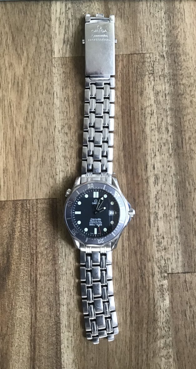

Hi guys,
Have owned a SeaMaster for the last 17 years and loved it. Every 5 years or so I have had the pins in the bracelet (1503/825) fail resulting in the watch falling from my wrist. I have serviced the watch regularly and replaced all the pins every time this happens.
What I am looking to do is to replace the bracelet with the new version (1515/816) PN: 020st1515816. I prefer this style of bracelet and enjoy the feel when worn. The newer bracelet also uses screws to retain the pins.
Of course the local AD will sell me the parts, but will not advise whether the newer bracelet will fit. Before I commit to a new (and expensive) bracelet I am hoping to find some experience on here as to whether this is a successful match.
My watch below:
I have also added a link to a website that suggests it fits
https://www.swisswatchspares.com/pr...20mm-steel-bracelet-fits-full-size-bond-watch
Your advice would be greatly appreciated.
Simon
72
96
I’ve tried this before when I briefly had an SMPc and my 2220.80 at the same time. The end links won’t fit that well because of a height difference, but if you were to keep the original end links and put the new bracelet on there then it should be fine. Only thing to note is that the 1515 bracelet has slightly thicker links overall, so I found that it didn’t match the aesthetic of the case.
alternatively, you could also look at swapping the adjustable clasp onto the 1503 bracelet so that you don’t put as much stress on it? I’ve had my 2220.80 for 10 years but never had any problems with the pins, and it was my daily for most of the decade.
Hope that helps!
3
Much appreciated keisuke.
I might have to look at other bracelet or band options.
Simon

Are you sure this bracelet is original? Sorry for the “negative” remark. I have exactly the same watch and the bracelet is much tighter.
3
Aps, I am sure this is the original bracelet. I could re-pin it again but was concerned that the pin holes had worn also. Hence if I needed a new bracelet then the investigation as to my options.
