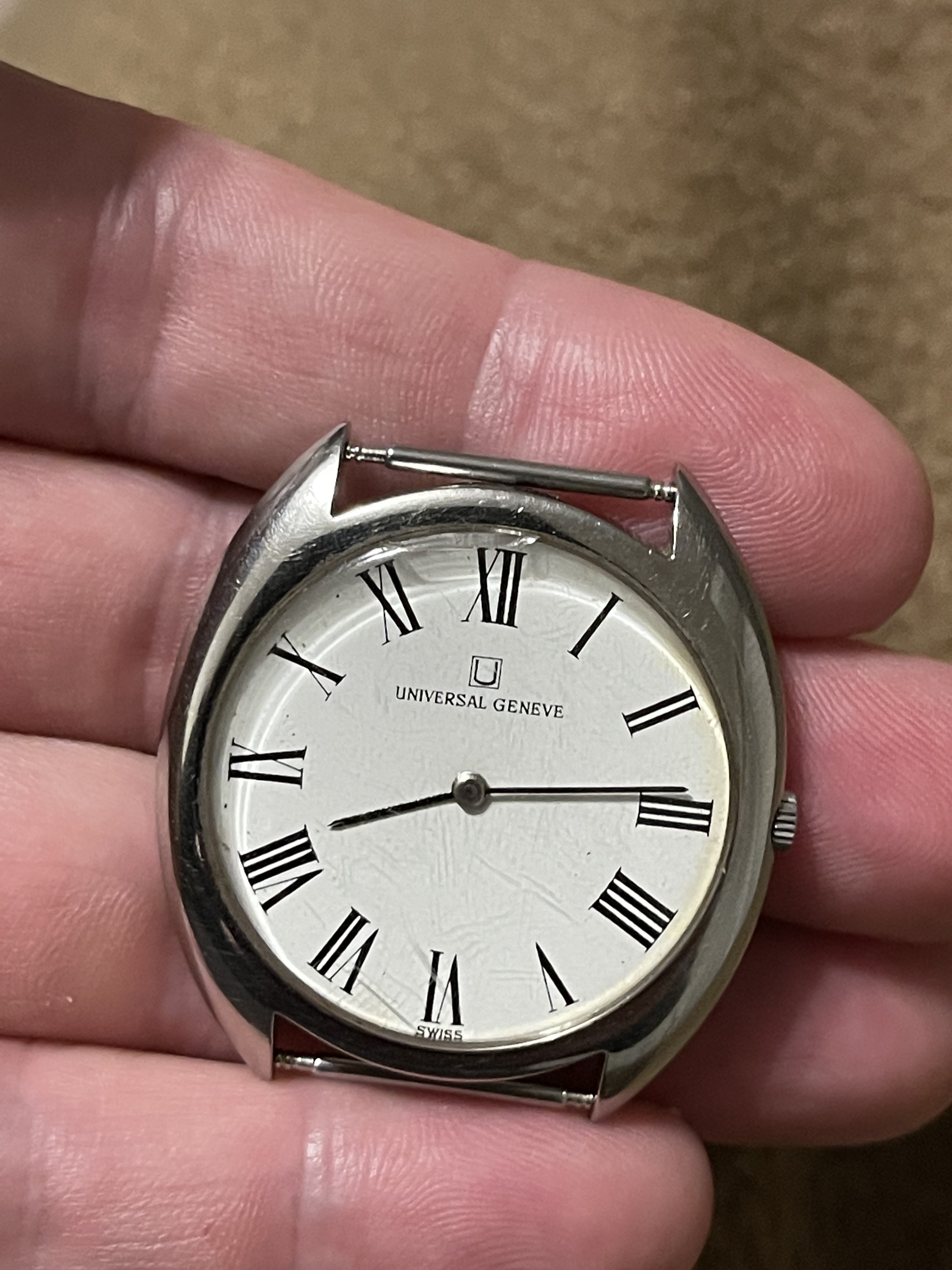

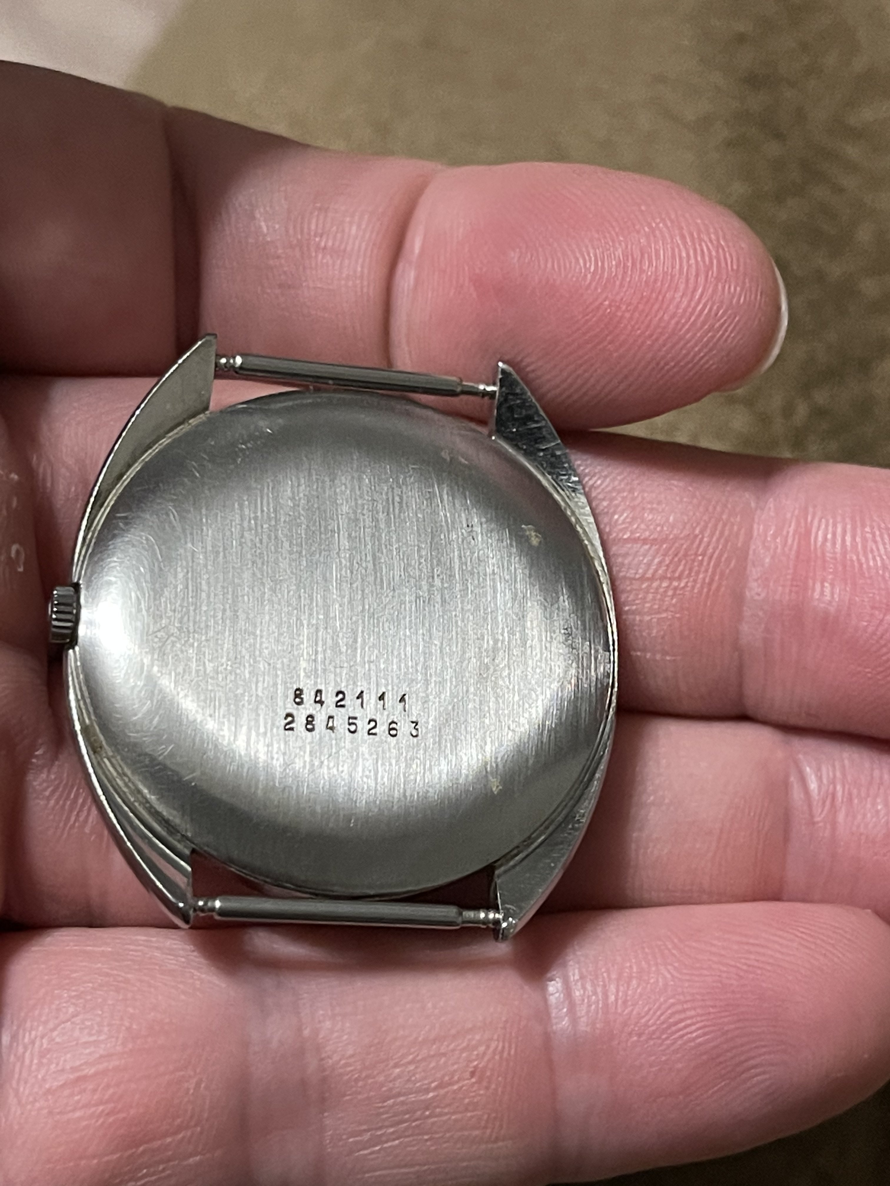

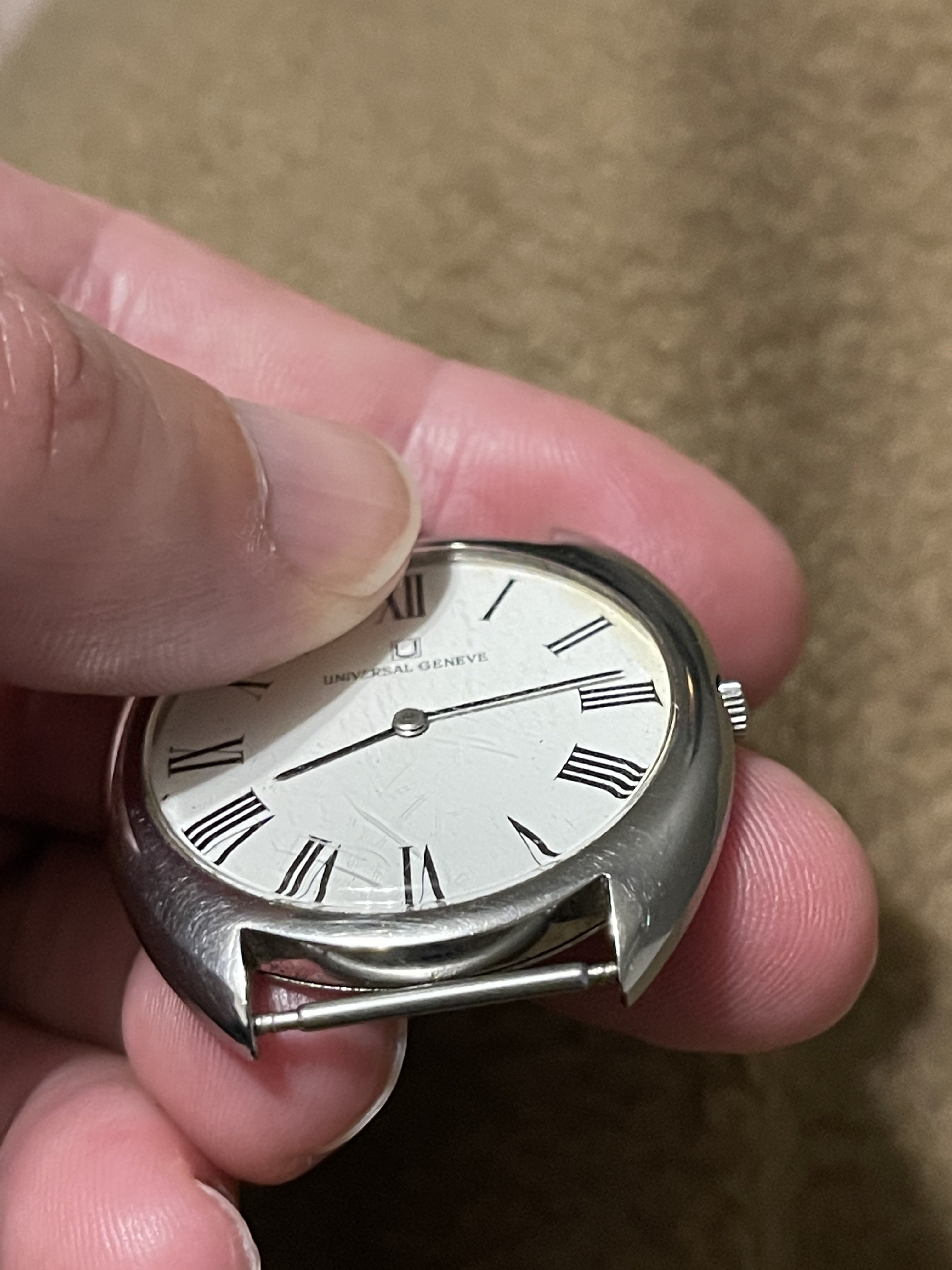

First venture away from vintage Omega and Seiko, picked up what I thought would be a fairly straightforward manual piece, but have run into an unforeseen snag...

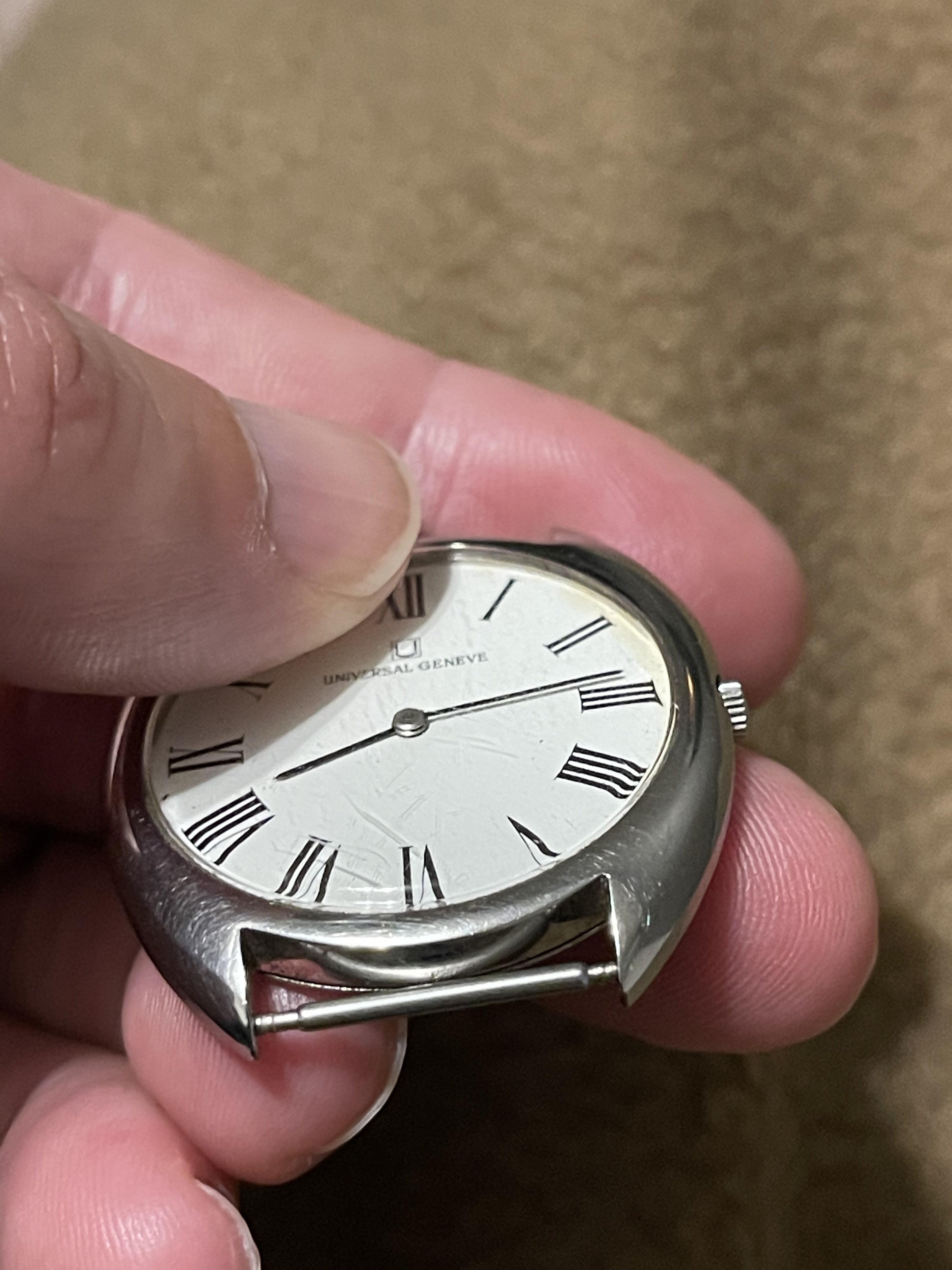

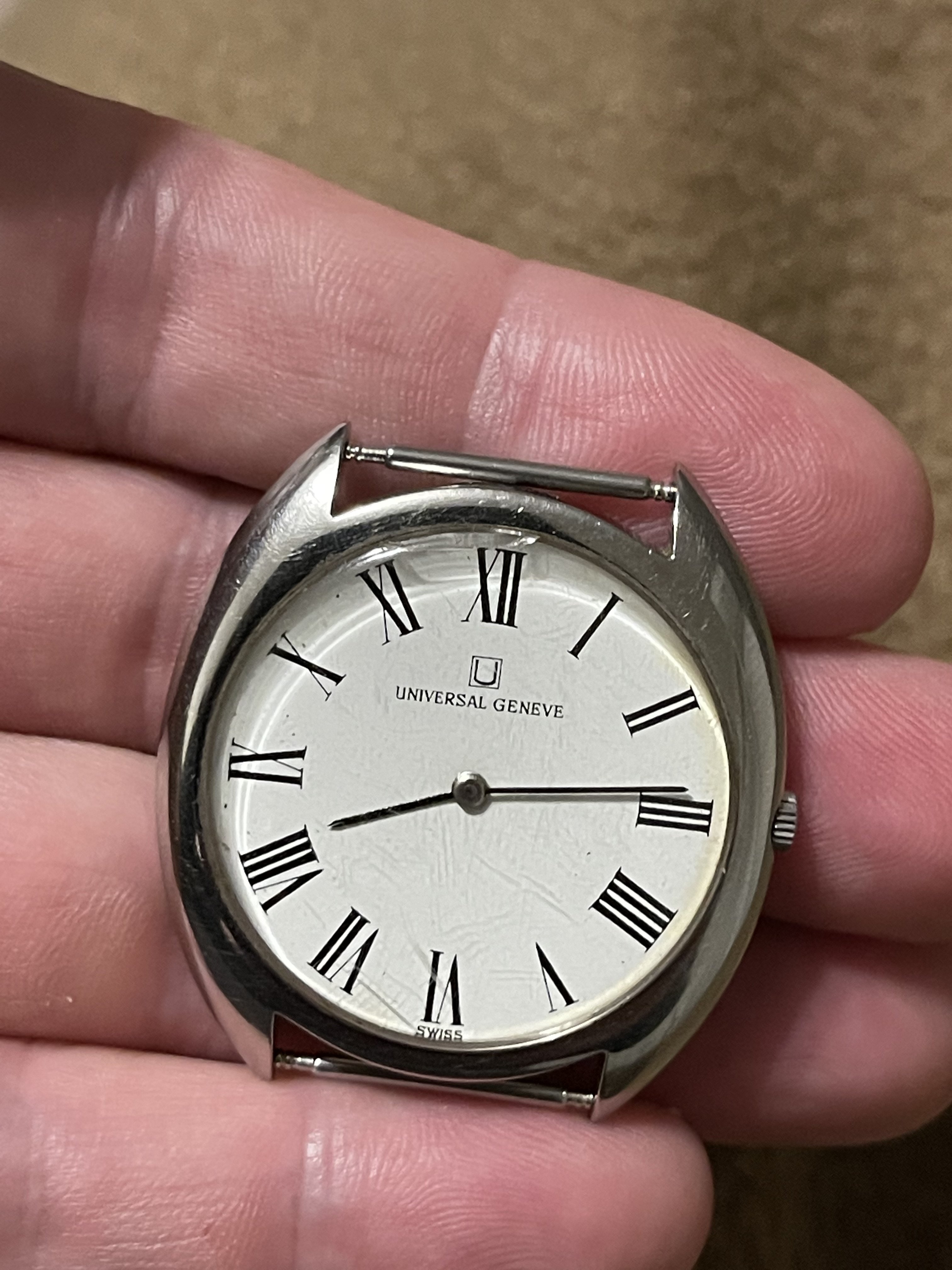

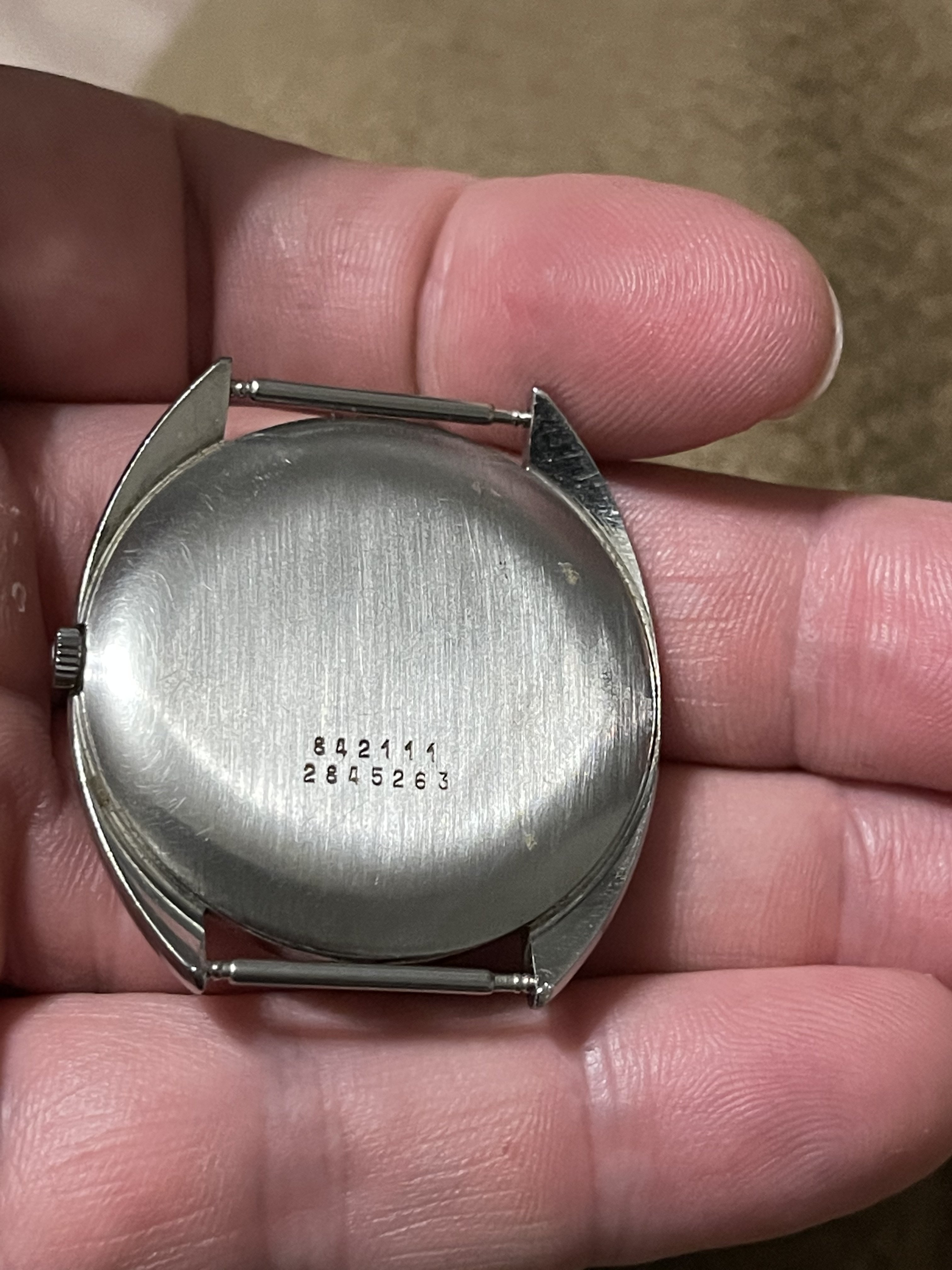

Now I have some small/tight lug vintage watches but never something like this with almost zero clearance for a strap and spring bars. As you can hopefully see from the attached pictures, there is barely a hairs width between the (not overly thick?) spring bars I have put in to illustrate and all efforts to put even the thinnest strap on have failed (yes, I also managed to bust the crystal trying too hard).
What would be the best solution here to get a strap on? Curved end strap and curved spring bars? Any other suggestions?

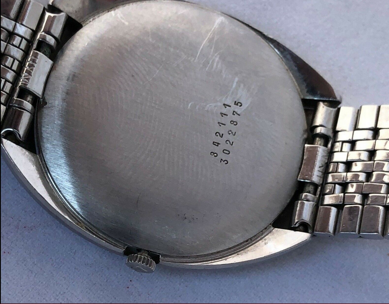

Also, does anyone know what on earth would this have come on originally?
Runs lovely though!

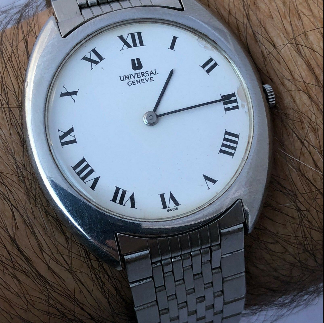

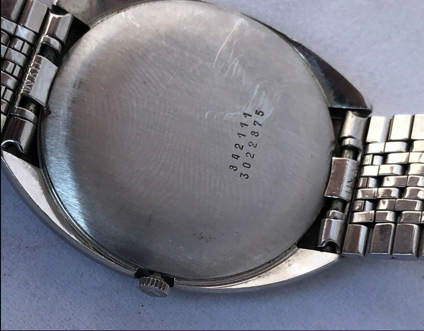

I suspect it came on a bracelet or mesh bracelet with curved end links.
You can find some examples if you search online for the case reference 'Universal Geneve 842111'.
You could probably fit a leather strap using some curved spring bars. You may not need the strap itself to have curved ends depending on the material/construction.

You just need to get some curved spring bars - you should be able to fit them to a strap with straight ends and the leather will adapt somewhat. I have at least one watch where I've done this. The one thing I'd caution is to store the watch either flat or on a watch roll - storing with the strap folded under the watch case will result in excessive rubbing which will show.
I'll see if I can find some pictures.

Thanks for the reply! I will give the curved spring bars a try and see what that does for the situation.
Understood on storage with the curved spring bars, definitely seems likely to be awkward.

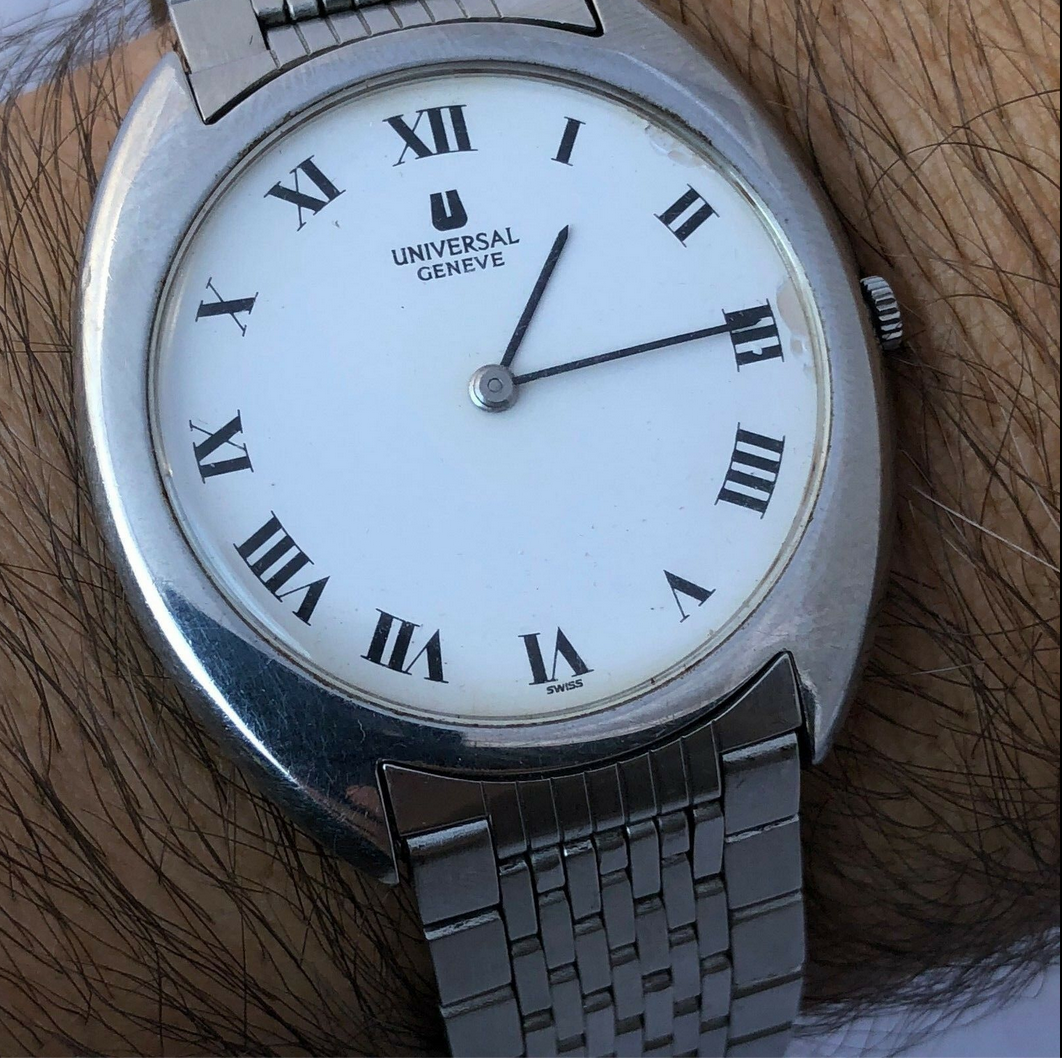

Digging around it seems like it came on a bracelet, looks tight on the ebay pics and that would explain the marks on my one between the lugs too:

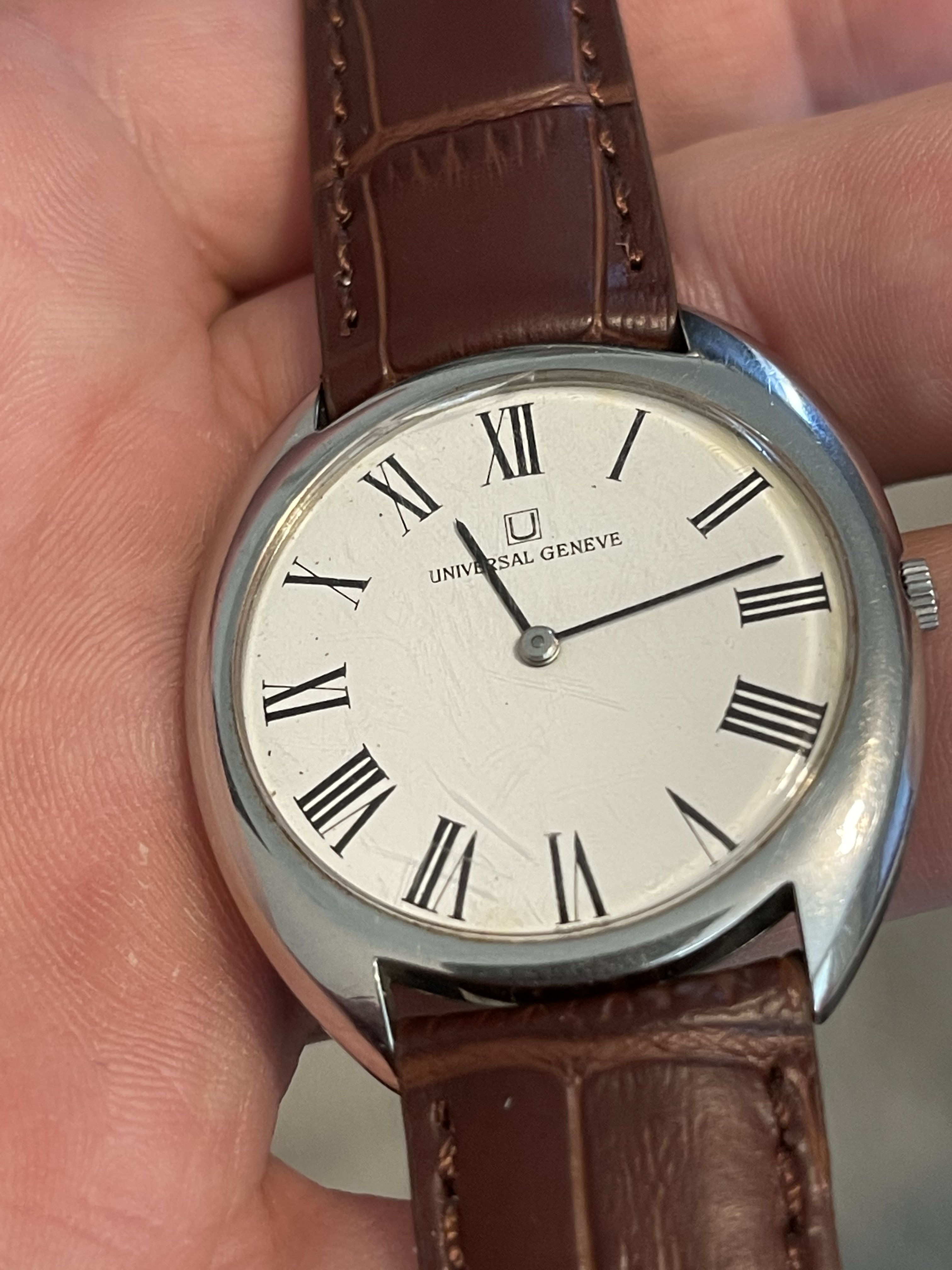

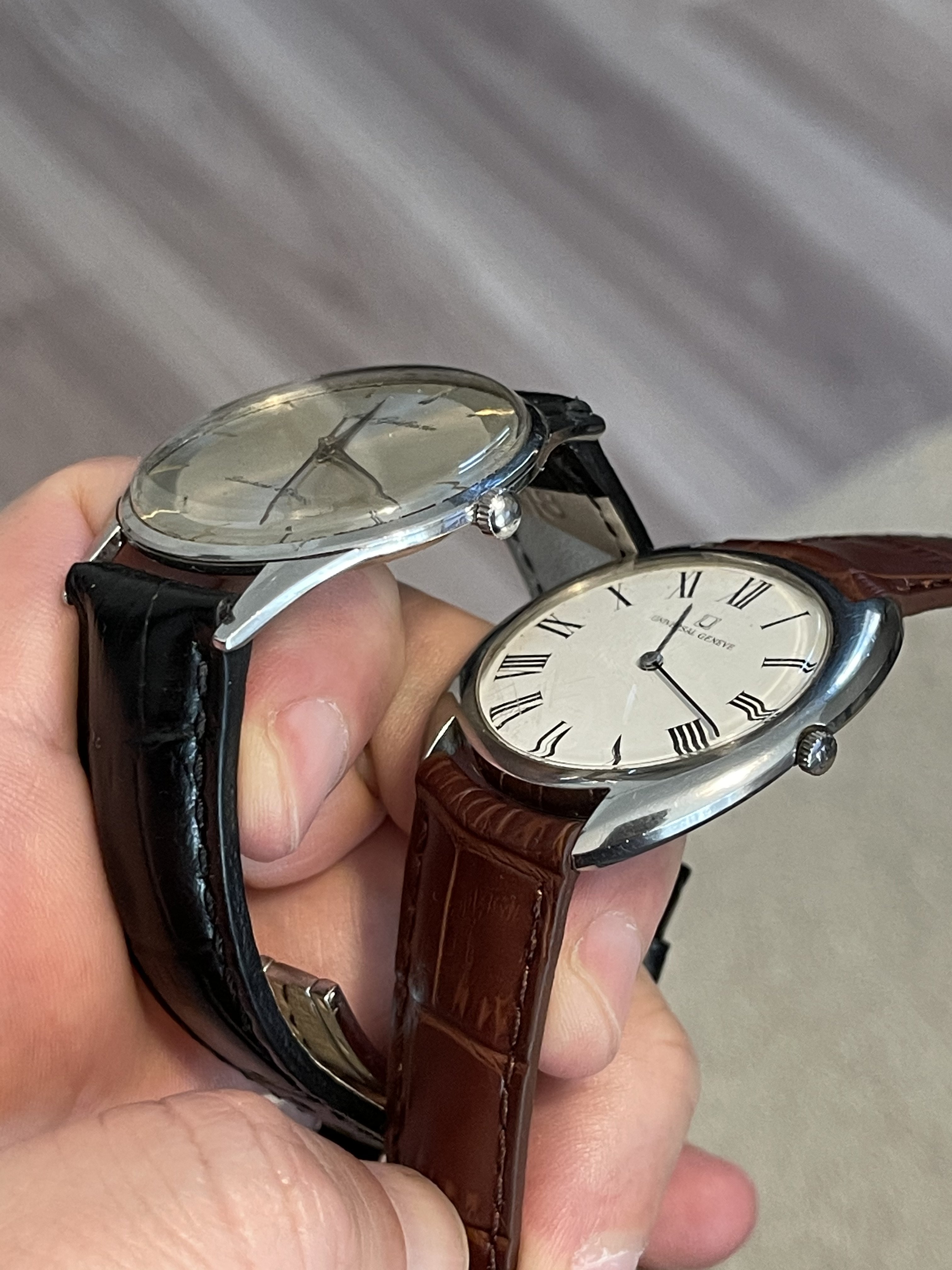

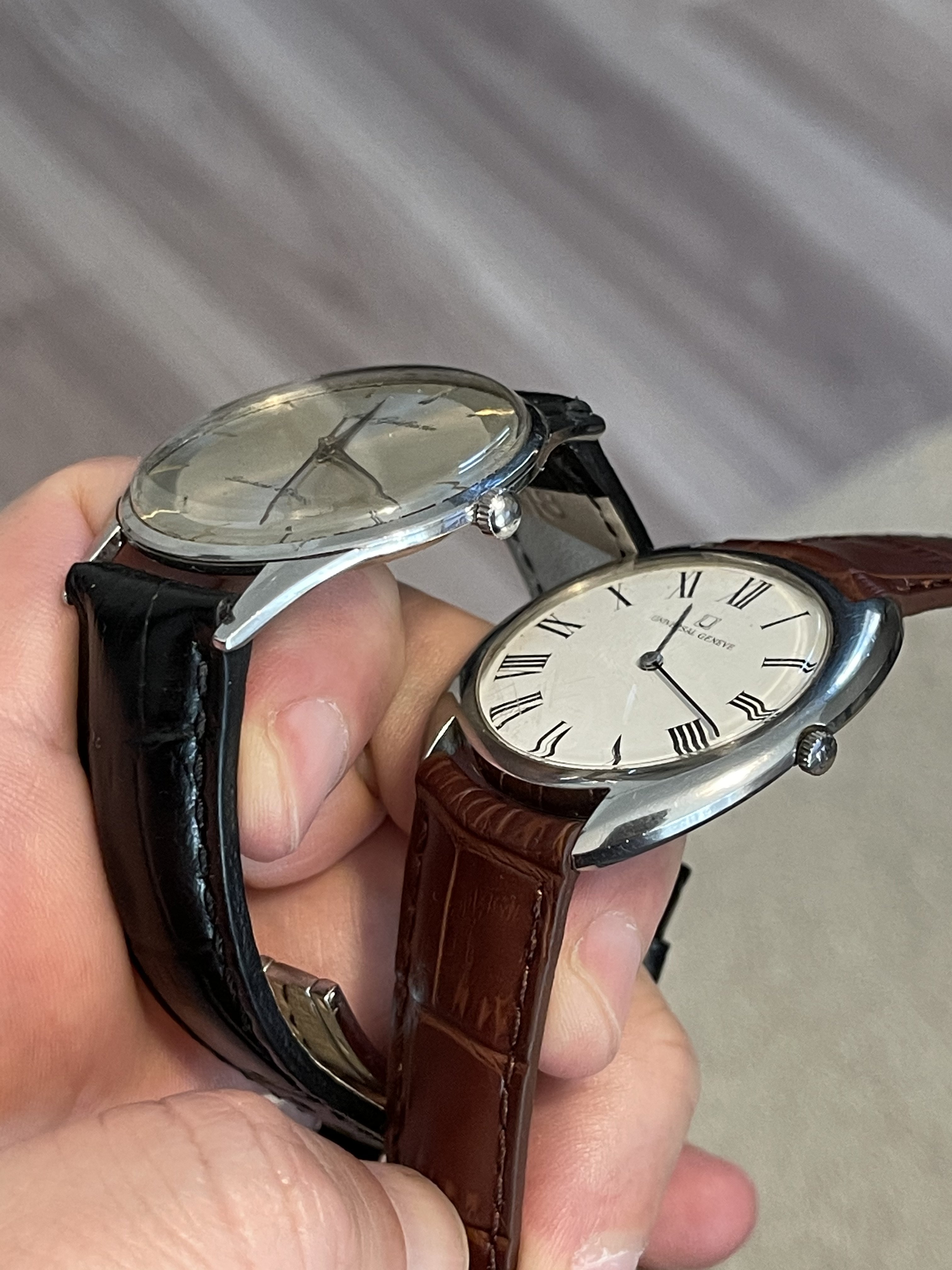

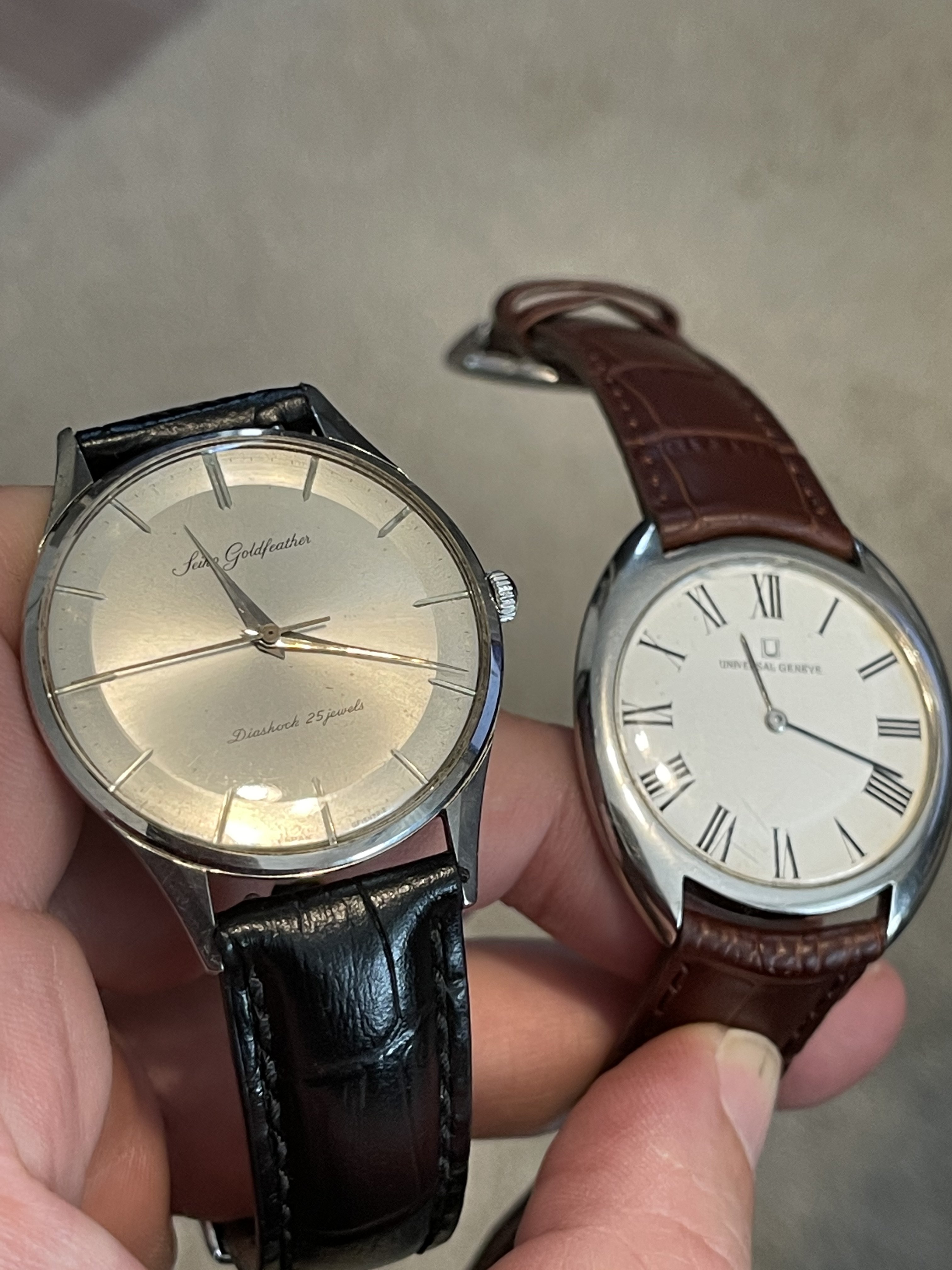

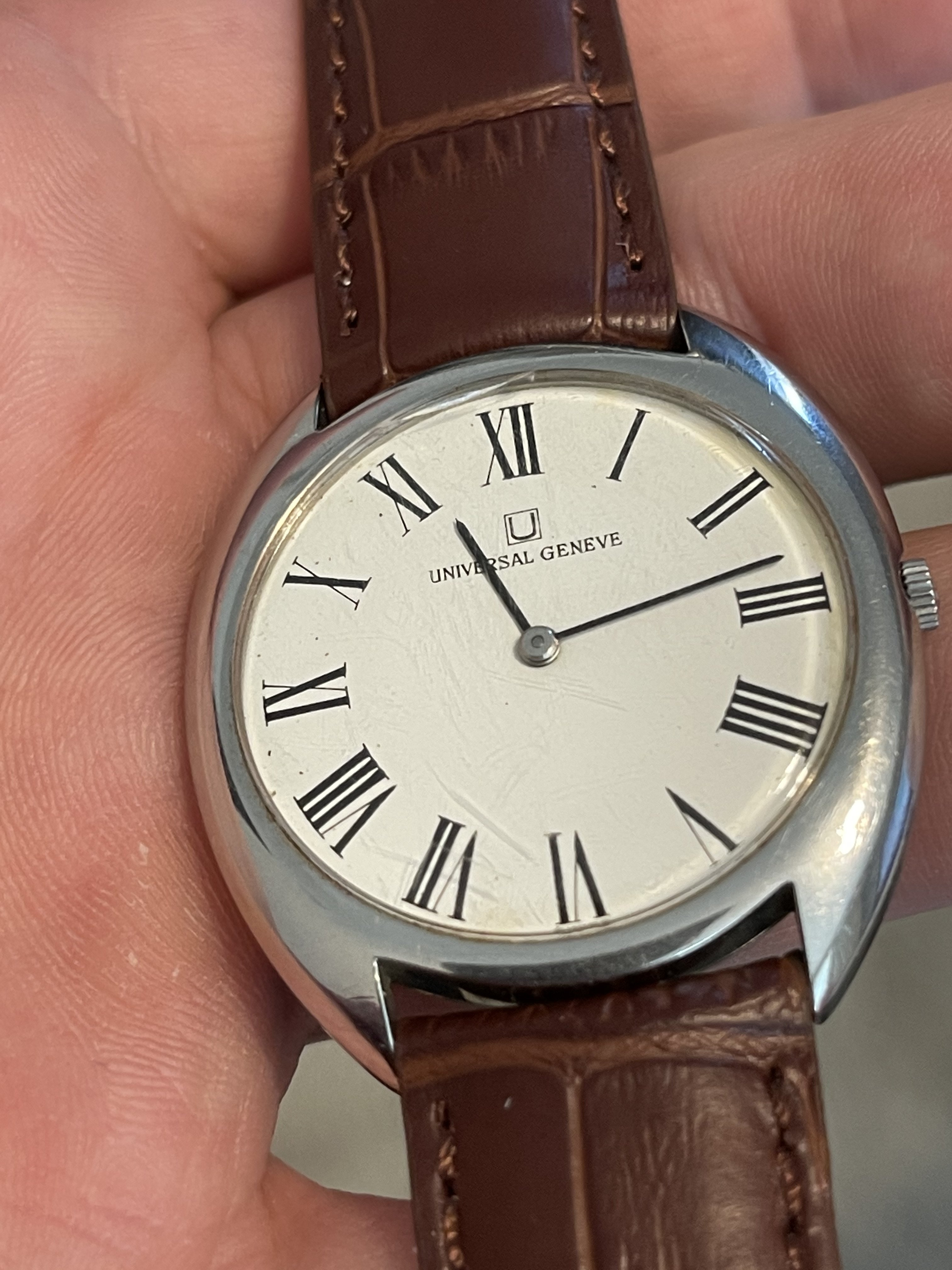

Update - curved bars and a curved strap (in for a penny) did the job. Now to find a crystal to replace the one I bust that keeps the same or similar low profile... expect that will be a harder job!

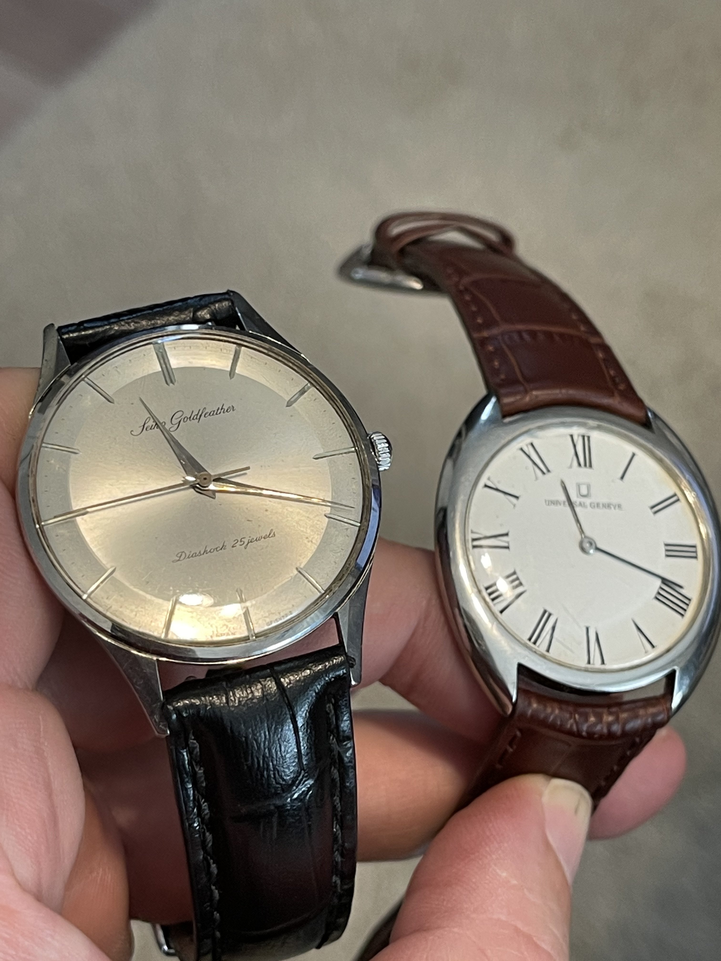

Also seen here with another manual ultra slim, Seiko Goldfeather.

Looks great, Love the UG white shadow, looks good with the strap, so often just see it on a bracelet
