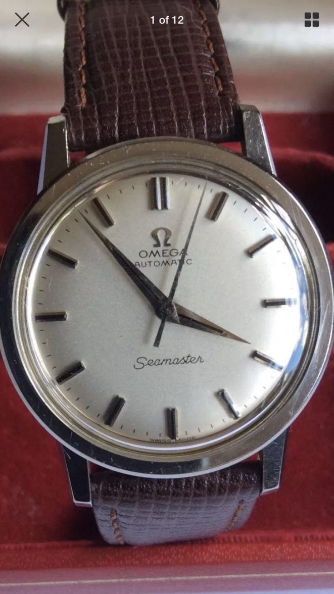

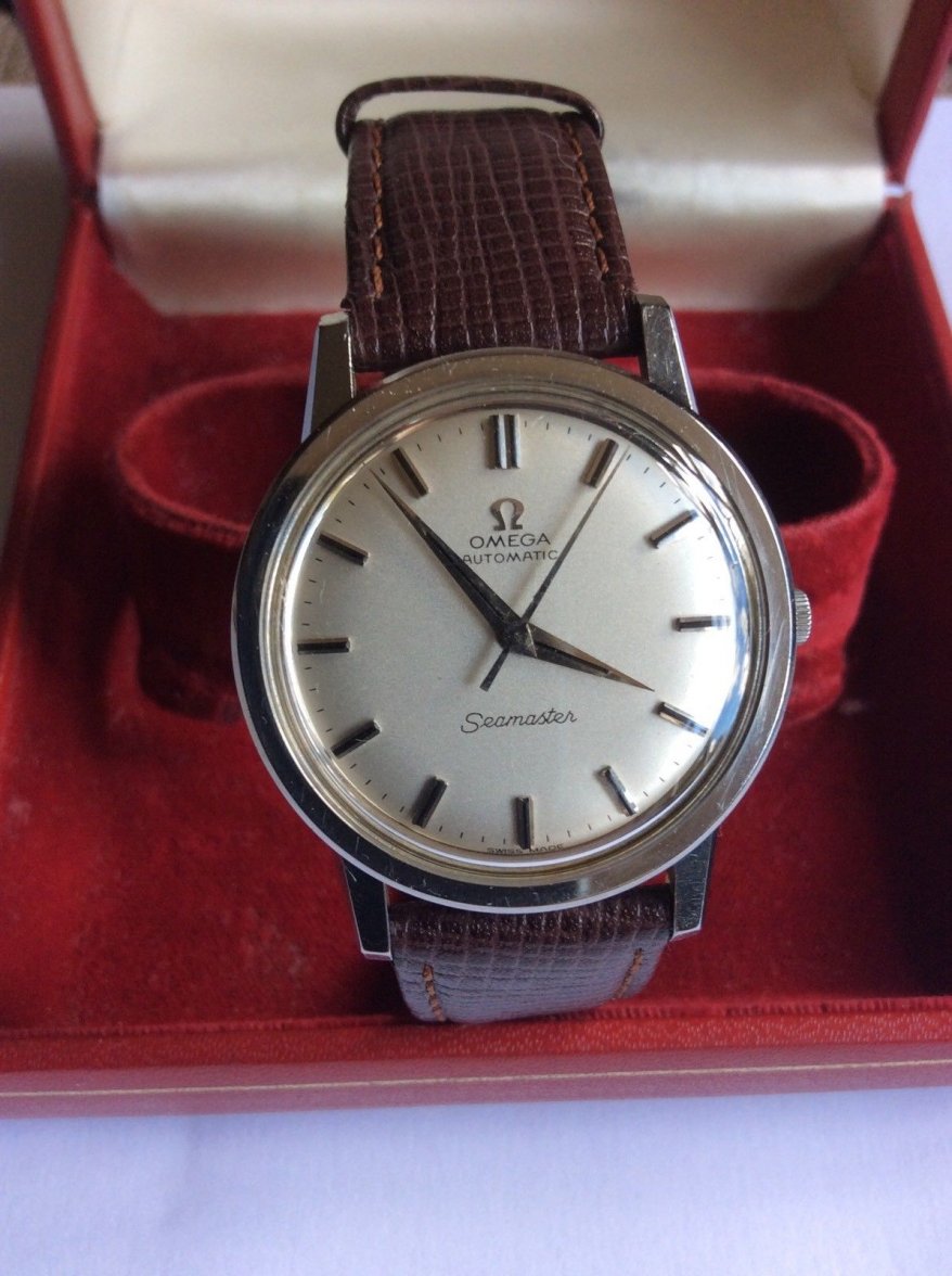

    @NickyMabbs IMO you could do worse than this one. I can't see anything wrong with it (I will be called out if I've missed anything) beyond the £495 price tag which is a bit steep as there is no bracelet with it, but it's been listed for about a month and maybe the seller would knock a bit off, it's worth trying. These 60s Seamaster workshorses are getting quite uncommon in good condition. There will be a 552 movement in this one which looks to me like a 165.003, made 1965-1969. Pricey or not, it looks 100% to me. I doubt the lack of a movement photo is hiding anything worse than the seller's fear of removing case backs, and anyway this isn't a model that gets faked. And it's still at least couple of hundred less than a professional dealer would be asking.

    Band and buckle are fakes.
  14. Edward53 Oct 17, 2017
    3,127
    5,384
    I didn't even look at those. The watch looks fine to me and I disregarded the rest.

    That is a lovely looking timepiece. I had a closer look at the photos & the dial looks to be in remarkable condition compared to similar Seamasters I’ve seen, any chance this could’ve been potentially restored.
    It does look to be very clean & I’d be willing to take a punt on it & swap the strap & buckle out for an authentic Omega if they’re sourcable. My only reluctance is not being able to see the movement but as the rest of the watch looks so clean I would assume the movement would half decent at least, unless there’s a Timex hidden away in there! Haha!

    90%+ of Omega bands and buckles on eBay are fak...er, replicas.
    Beware.

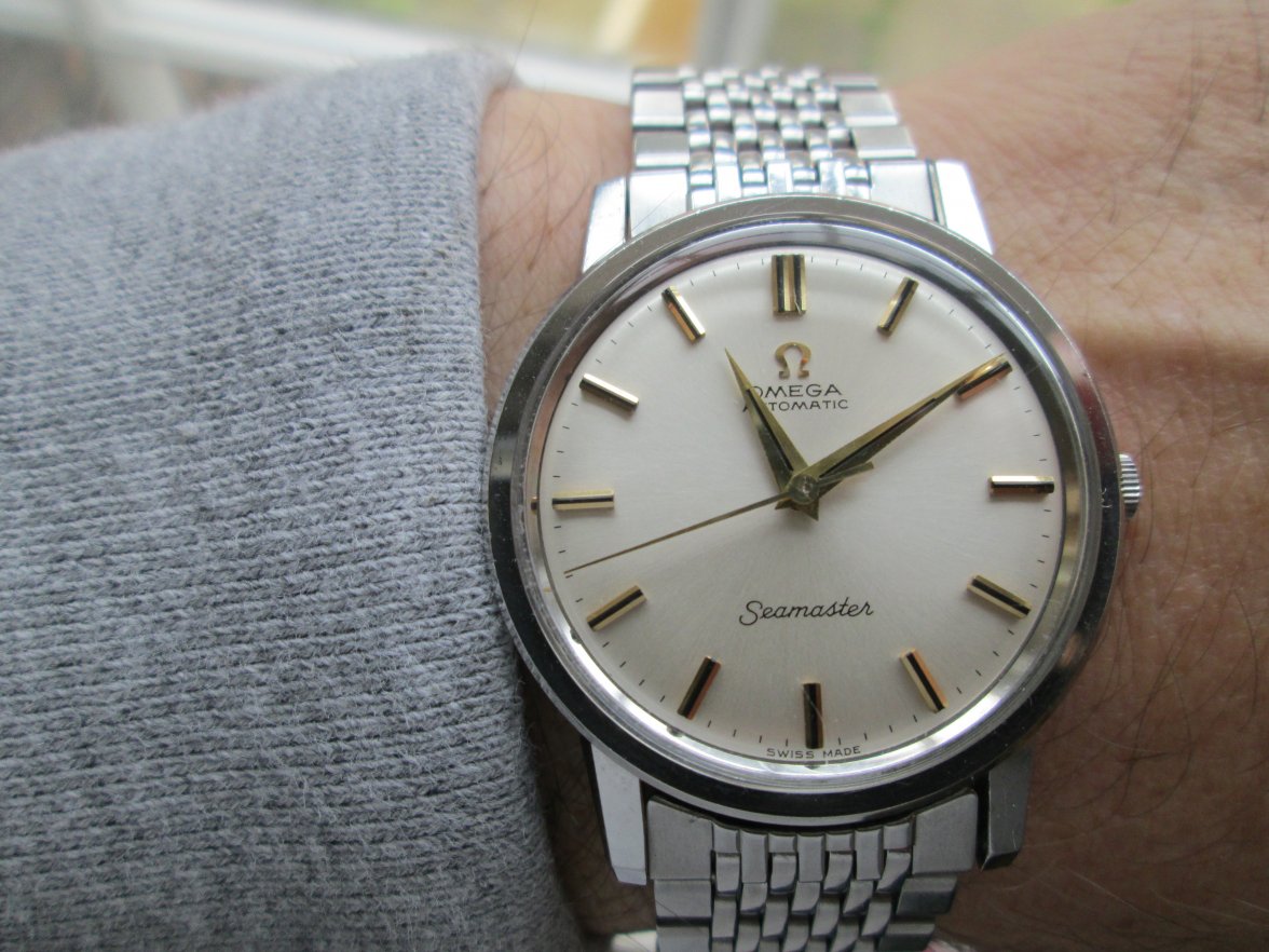

    I've looked at that seller's other items including a few watches and he doesn't seem to take the backs off any of them, so I doubt anything bad is being hidden. The dial and case are in very good condition which implies that the movement is probably ok. I'm sure that dial is untouched, and although the hands are a fraction longer than the minute markers, they are the correct type and I'd be happy with them. The hands and markers appear to have black onyx inlay. It's quite uncommon for this model to turn up with steel hands and markers; usually they are gold. I have this model with gold furniture in similar condition, pic below. Buying absolutely anything on ebay is always a gamble; I can only say this is a gamble I would be willing to take but in the end the choice is yours. As for buying a strap, one could happily live with hte one already it and get something "right" at leisure. Yes most Omega buckles on ebay are fakes but a few are correct, plus there is always the bracelet option. Mine came with this on and I think it's always been on.That's me done here, over to you!

    That’s an amazingly gorgeous watch! Out of interest, did they change the fonts quite often on these dials? Reason I ask is that the font on you’re example looks very crisp & neat with ‘Roman’ corners to the font if that makes sense? The eBay example is very straight, looks like a completely different font, especially the detail within the ‘Seamaster’, ‘e’s in particular are quite different not to mention that the ‘Swiss made’ at the bottom looks quite squashed. Not precise & even as yours is.
  19. No Mercy Oct 18, 2017
    1,090
    2,134
    This one is purely a redialed.
  20. Edward53 Oct 18, 2017
    3,127
    5,384
    The fonts do vary a bit on these but the way to be really sure is to download the picture and blow it up as far as possible, which I do if I'm considering buying something and which following @No Mercy's comment I've now done here. Should have done that first off but the dial looked right to me and I didn't...::facepalm2:: Yes, when you see it enlarged the a's in Seamaster are not quite the same and the G in Omega looks odd. Oops, seem to have dropped a bollock there....probably a very good redial but not quite what you're looking for!
