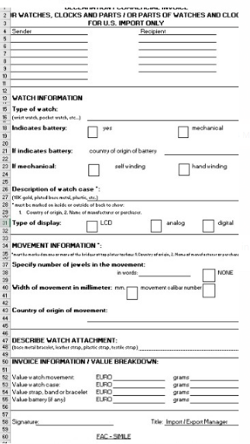

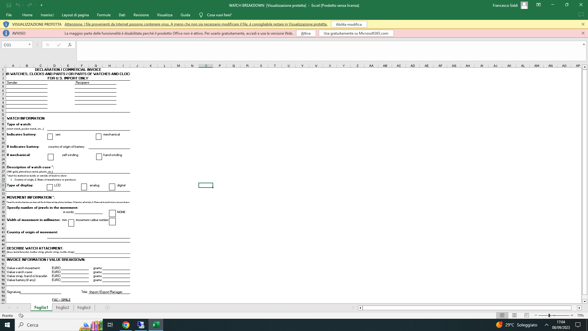

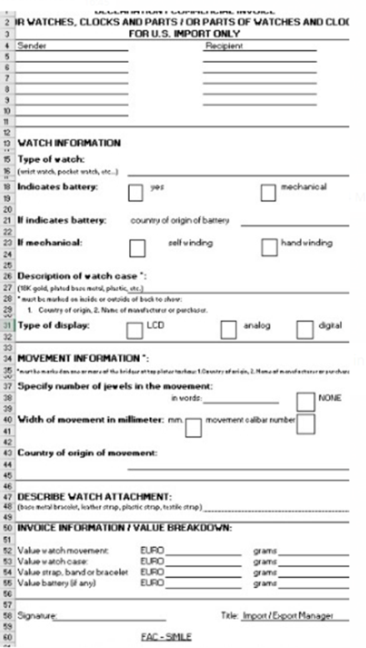

Type of movement: Analog vs. Electronic. Confused me at first.
And if it were an auto-winding mechanical movement, how would you divide the value between Movement and Power? 🤦
I have seen some other versions of this form that are less confusing, e.g. this FedEx form.
I have used this hundreds of times, shipping watches to the US. Never had an issue with this form, so IMO this is all you need.

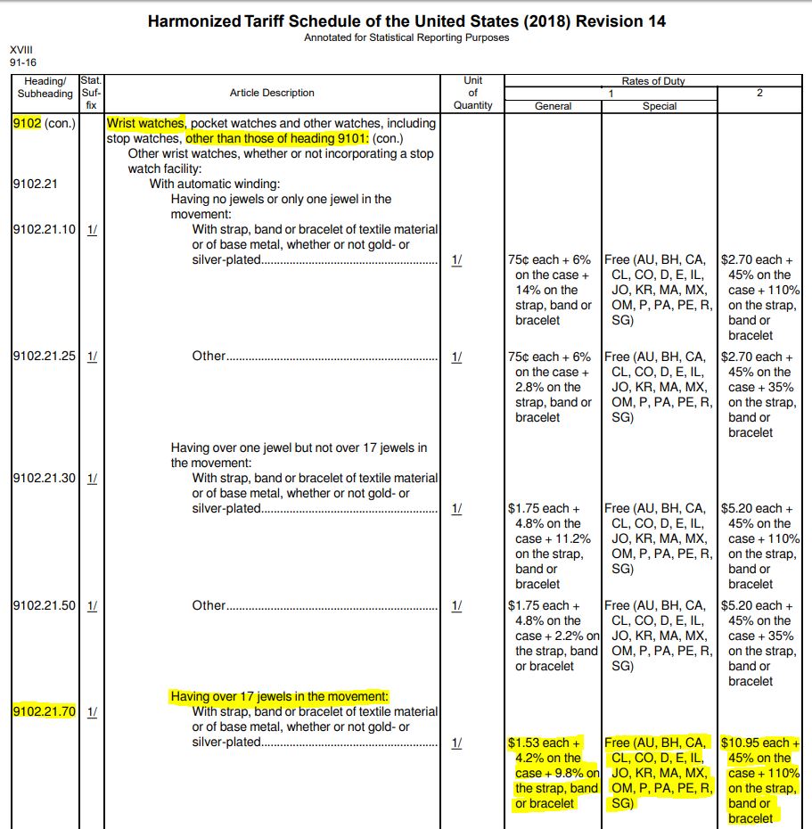

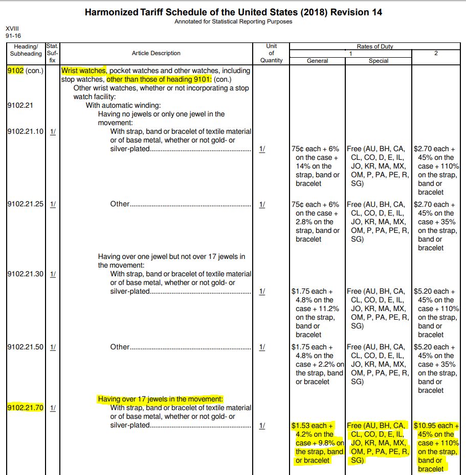

For anyone curious as to 'why' some (most?) shipping companies require this type of form, it has to do with determining the appropriate Harmonized Tariff Schedule code (HTS code). Based on the type of watch, movement, country of origin, different duty rates will apply. For watches, different rates are also applied on the value of the case and strap.
Below is the page showing the related HTS code for a typical Speedy. Note there is $1.53 fixed amount of duty, then 4.2% on the case and 9.8% on the strap/band/bracelet. If most of the value is assigned to the movement, small amount on the case and very low amount on the strap/band/bracelet, it will result in the lowest duty owed.

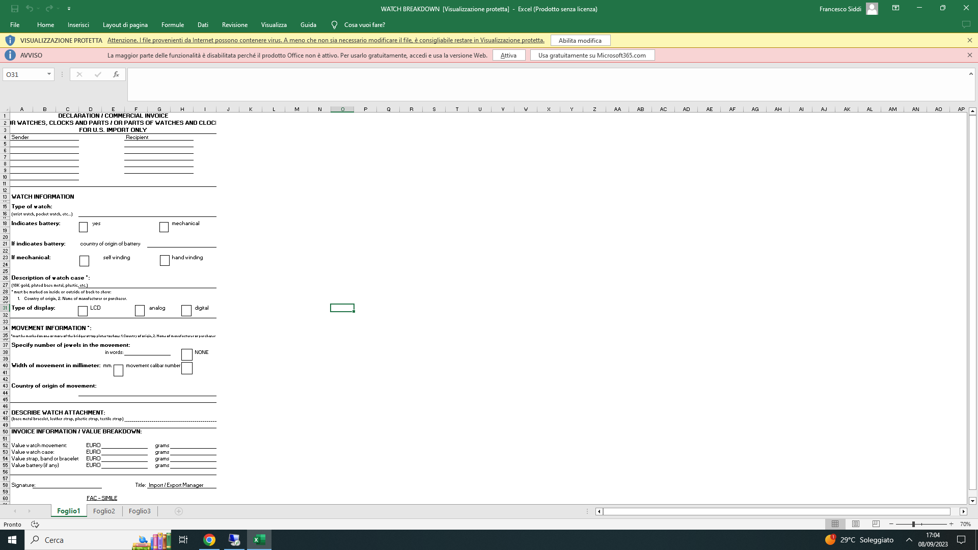

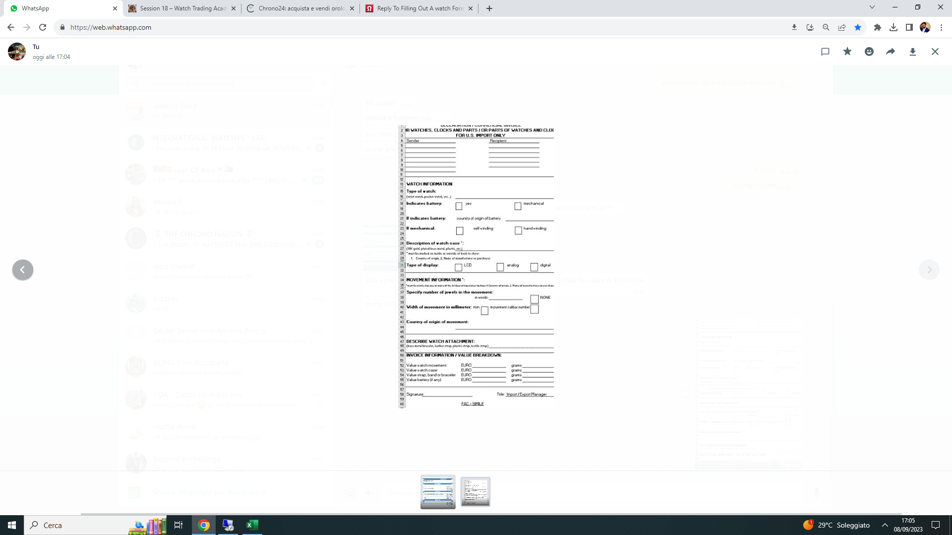

Hi guys, i'm following the topic because i like also to know more about it. would love to buy an omega from US but i don't know how much to pay in import taxes. I'm a private, not a reseller. Based on what i understand, declaring a value of the watch (for ex. 10.000€) and breaking it down in different components, gives you an estimate of the total fees you are willing to pay. For es. 7000 movement, 2000 case, 1000 bracelet. Does anyone have any experience with that? also resellers answers are more than welcome. thanks. Francesco

The rule of thumb is to always allocate most of the value to the movement as that is taxed at the lowest rate. Avoid high value precious metal cases. Platinum = bad. Compared to virtually all of Europe, importing a luxury watch into the U.S. is a breeze. As long as you’re honest, U.S. Customs is generally very reasonable in their assessment of duty.

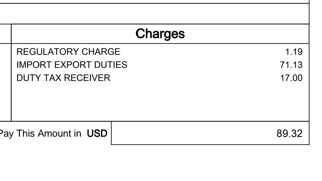

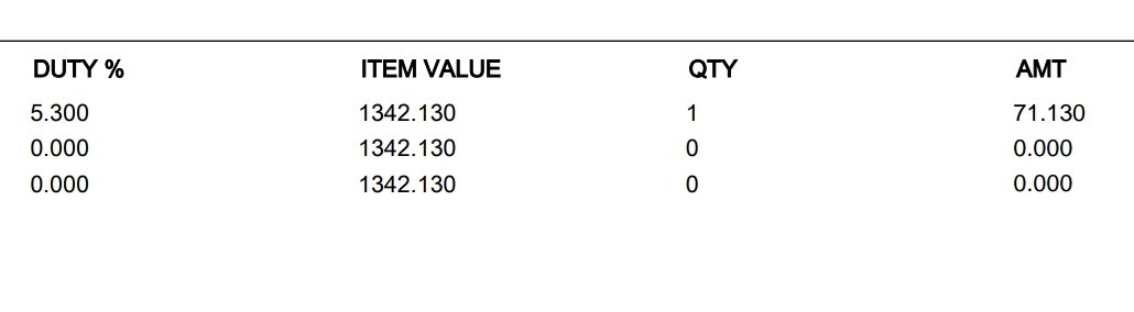

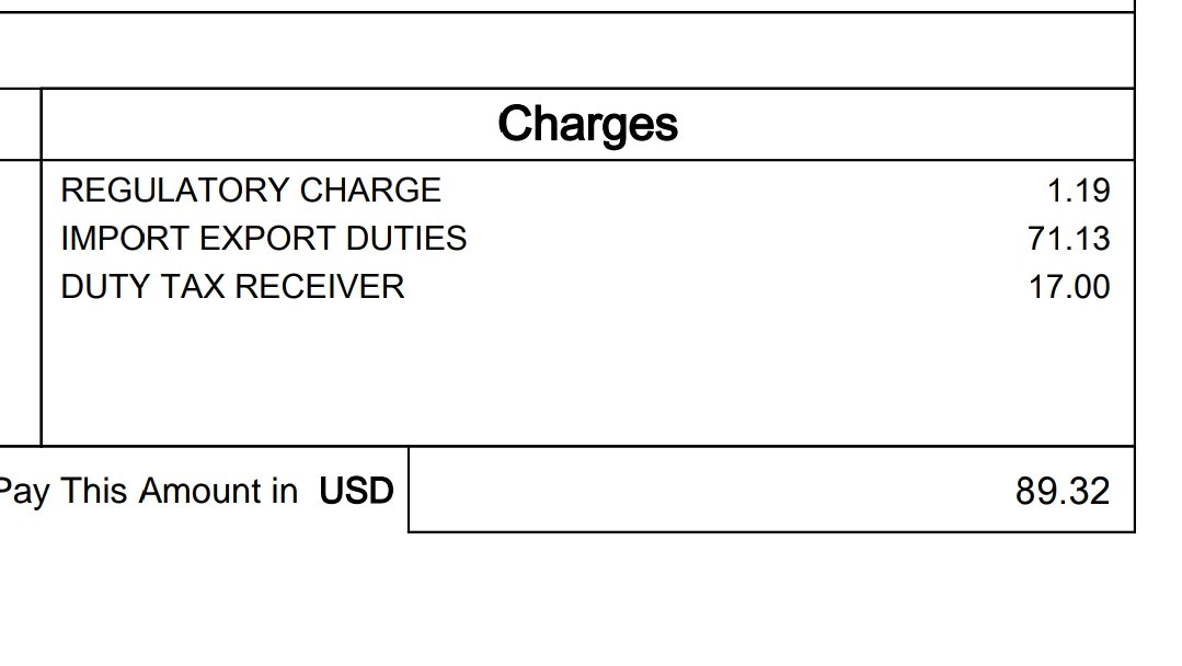

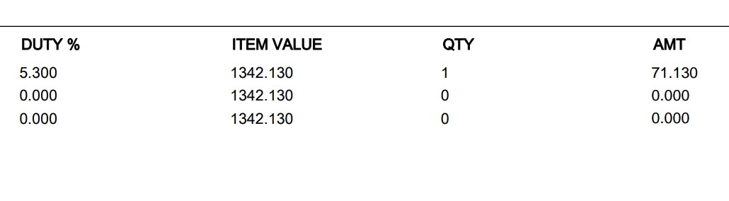

Just to add another data point to this thread. I just bought a watch from the Netherlands shipping to the US. It's shipped via DHL. Value of the watch was $1,342 (in USD). Duty was 5.30% plus receiver fee. Total tax/fee was an extra $89.
I paid the $89 on DHL's website before they would deliver it.

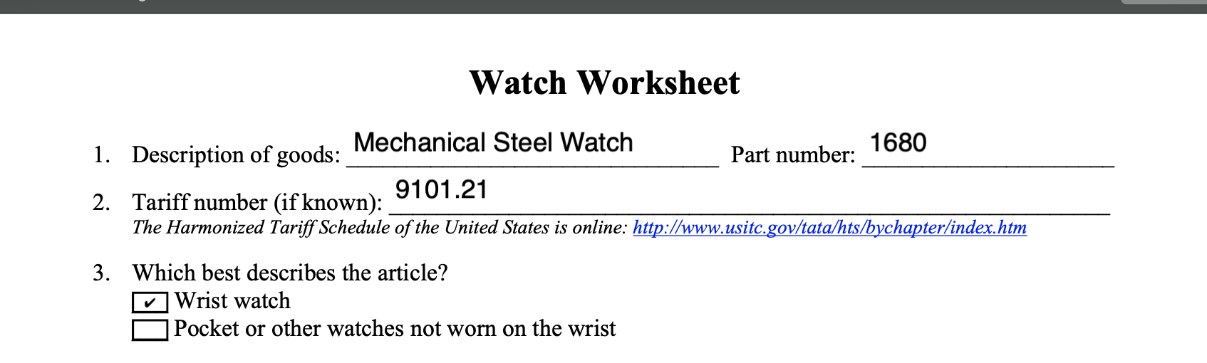

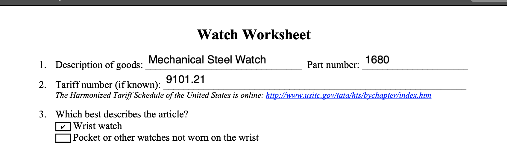

Sorry for bumping such an old thread but, for a Rolex 1680 Submariner what is the most appropriate description and model number here?
Should I just say Description: Rolex Submariner Steel Watch Model: 1680
Or should I. say something more generic like Description: "Steel mechanical watch" Model: 1680
Or something else?

Personally, I would use the serial number there. That way you won't attract any attention from someone who knows what a 1680 is.

I would probably include the manufacturer and reference number. Otherwise, it looks like you’re trying to hide something and that never goes over well with customs. Make sure that you note that it’s used (not “preowned” which sounds like it’s a Mercedes) and allocate as much value to the movement as you reasonably can (I usually allocate the movement as 60-75% of total value).
Ahk, it’s still going to be pretty obvious though isn’t it given in the price breakdown I make it clear that it’s over $10k? Does this form get attached to the box where it can be seen or do you give it to FedEx and they fold it up in one of those plastic sleeves or something?

Give all the paperwork to the courier and take it to them with the box open as they will inspect it. They’ll seal the box and attach the paperwork in the appropriate way.
I give one copy to the FedEx agent when it's dropped off, and another copy goes into the pouch. They will scan it into the system, unless they lose the sheet (which used to happen a lot, but hasn't happened to me in many years now). I always provide a second copy just in case they do lose it, and I would have an electronic version available.
There's absolutely zero reason to put the brand name on any paperwork, unless it's on a bill of sale.
BTW I think the tariff code you want is this one...
WRIST WATCHES, AUTOMATIC - 9102210000
