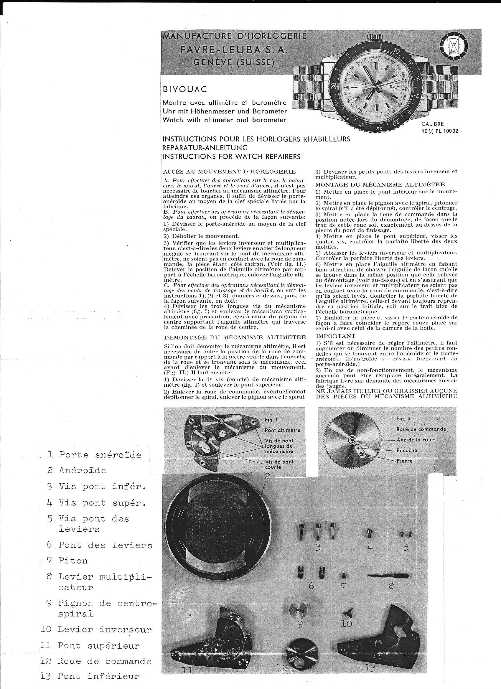

You need to manually set the altimeter hand to the point you want, which means you have to free the movement from the case.

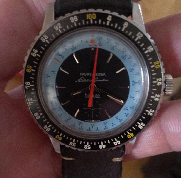

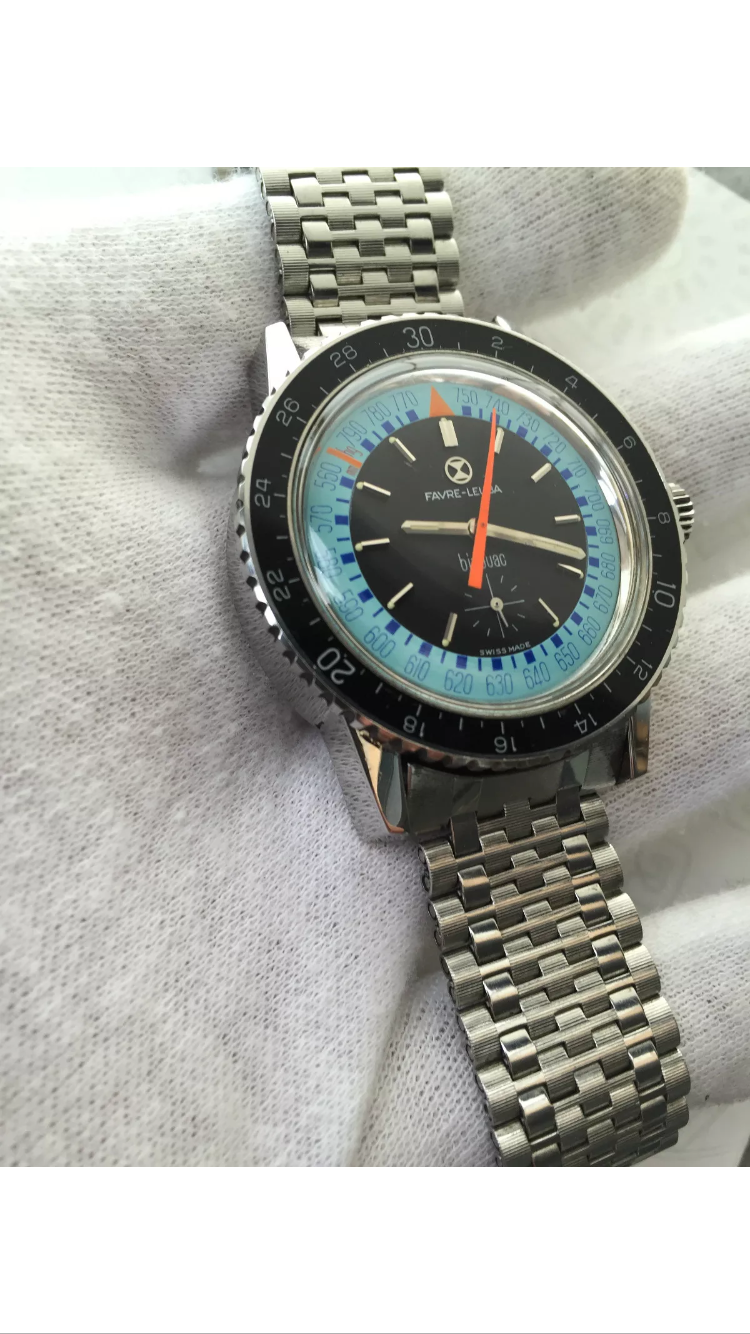

I have the same gadget, however my capsule has issues.
I know FL is now in Titan's portfolio, but it seems impossible to contact them to inquire about the part.
I have tried with a lot of specialized companies out there but it seems nobody can manufacture such a tiny capsule.
If anyone has any knowledge about a company making them or even repair and could point a direction i would highly appreciate the effort.
