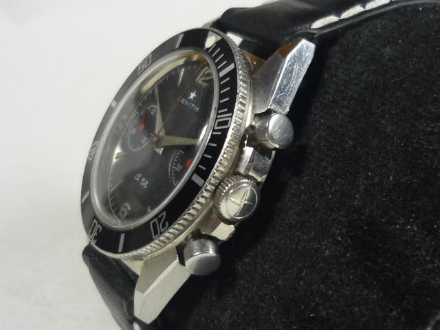

    It did make me spit up in my mouth a bit, but here's one of the most interesting fakes to come along in a while
    http://www.ebay.com/itm/vintage-ZEN...212507730?pt=Wristwatches&hash=item258903a652Purchases made through these links may earn this site a commission from the eBay Partner Network

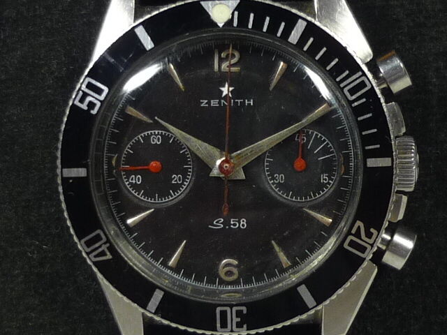

    A ghastly S.58 chronograph
    It's in one of those bogus Space Compax cases

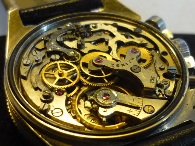

    Somehow, they have managed to jam a cal 156 in this case (which we know can take a Valjoux 72). Dial probably came with the movement.

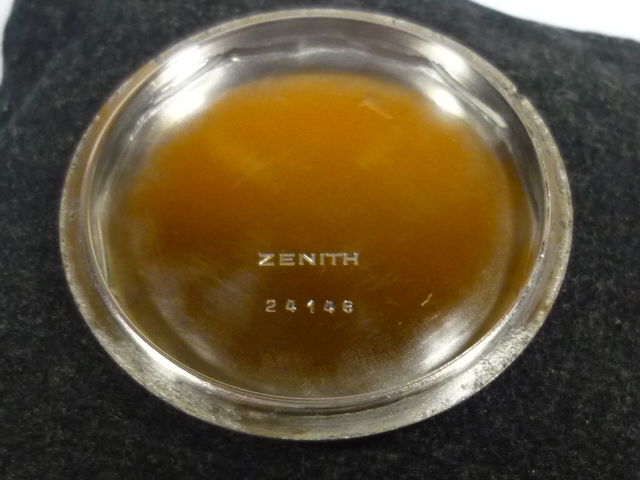

    Inside caseback looks like nothing Zenith made

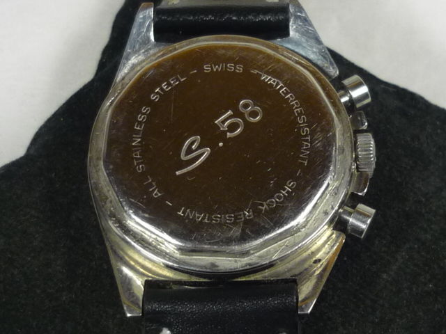

    the most disturbing aspect is that someone clearly has the font for "S.58" for both dial and engraving
    there are small differences, but it's close. I used to trust this engraving when I saw it - I will certianly look carefully when I see it again.

    So it's a real Zenith movement, with a redial that was never Zenith, and the rest is completely fake?
