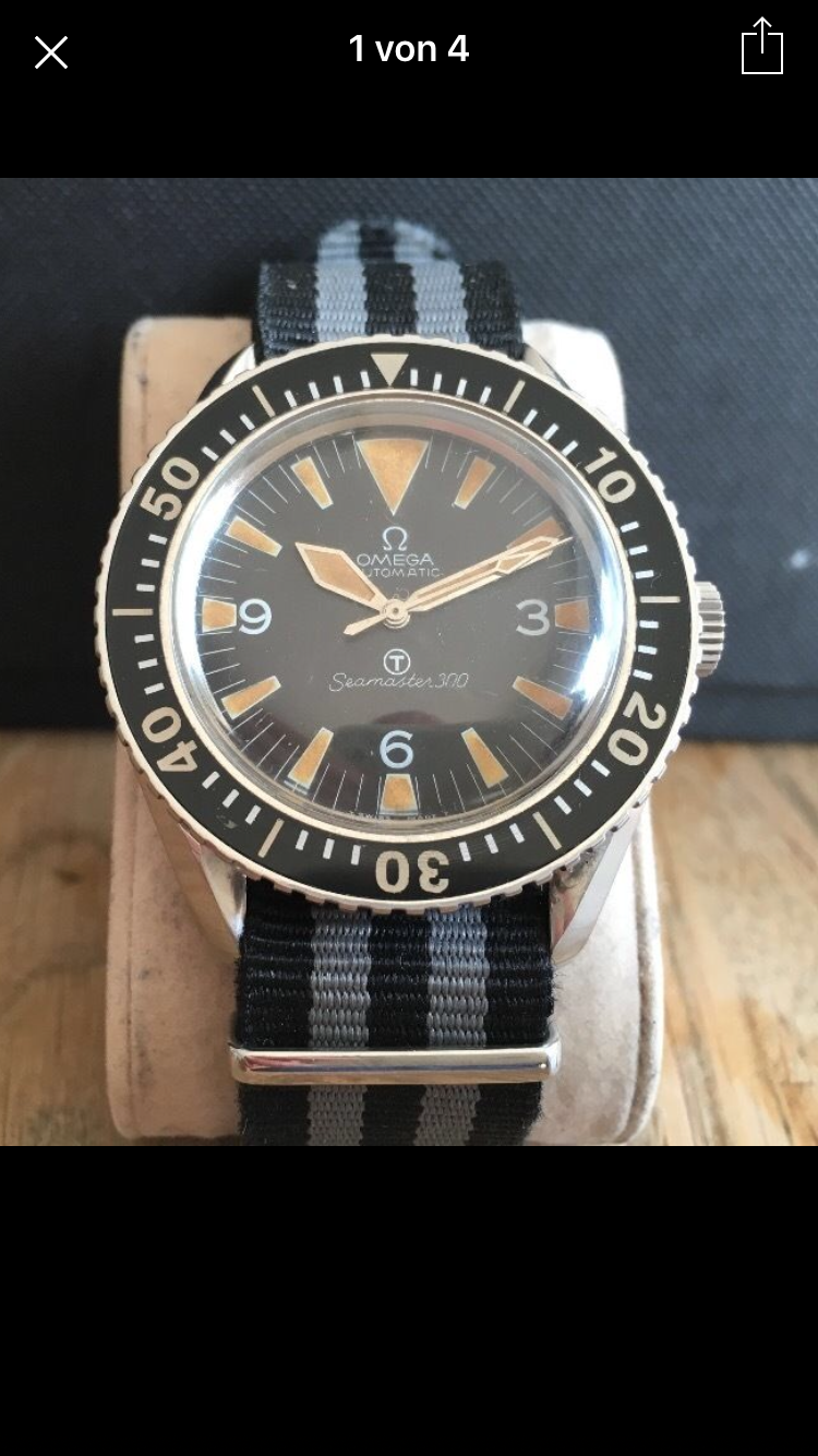

    C'mon Fake busters, anything I missed?

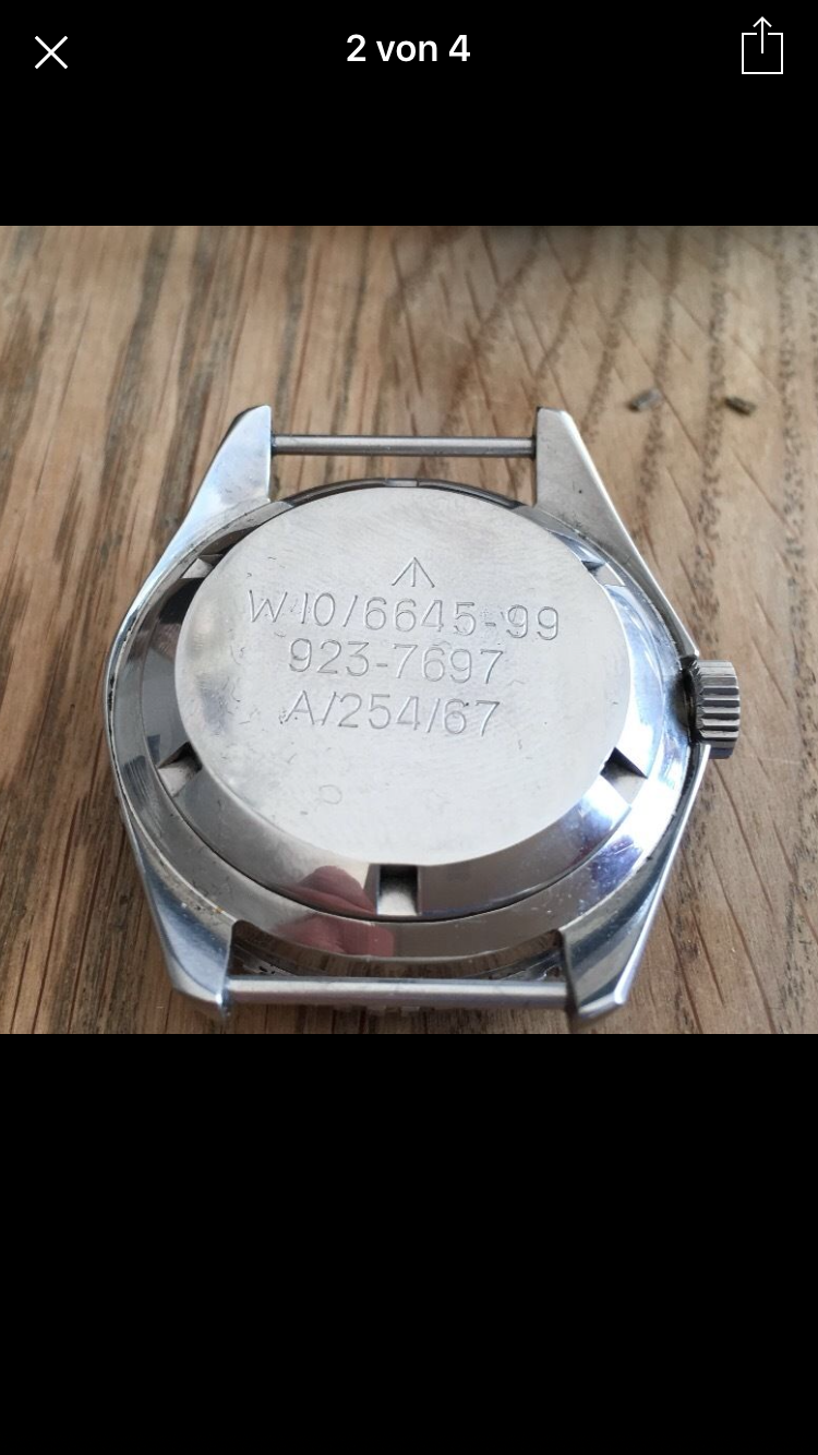

    Dial fake, closed 6 and 9, references number on the caseback complete bogus, no expert on the Military Inscription but I guess total fakery too? Bazel looks Strange to me and the lumen..just matches to perfectly...
    Seller asking 2,9k€ which Is way into "too good to be true" territory for a Military issued 300 SM I would think.
    Anything more? Seeking to learn more on those...

    Fake bezel. That font wasnt used on these watches. And if bezel is fake, so is the case, cause from what I was told fake bezels did not fit original case. Horrible Seamaster 300 font on the dial.

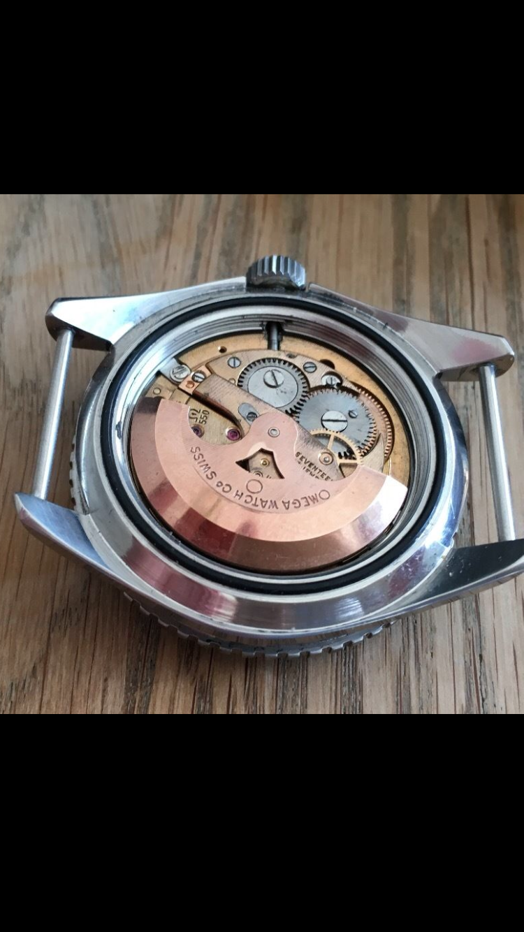

    550 movement extremely unlikely for British military; would have been a 552.
    It will catch somebody.

    The dreaded stubbies

    Ah yes, that "unique" A/254/67 serial number.
    And I think the last real one I saw sold at Bonhams for over AUD$100K.

    Omega logo on the crystal though))))
    Shame on those fake makers...

    Yes, but that's the new "Omega Scamaster".
    How ironic.

    could the case back be proper military? vinn

    132
    rule of thumb which i adhere to...
    Stubbies = fake for SM 300

    Oh and case is a Vietnam special. the 'ref' tells the story.

    the broad arrow gives it away. if it were a US case, it would have a F.S.N. number (maybe). there were a lot of empty cases floating around at one time. vinn
