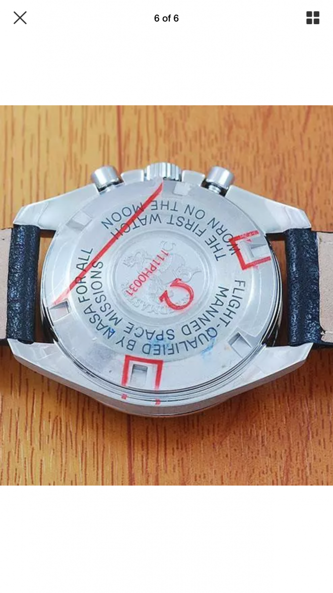

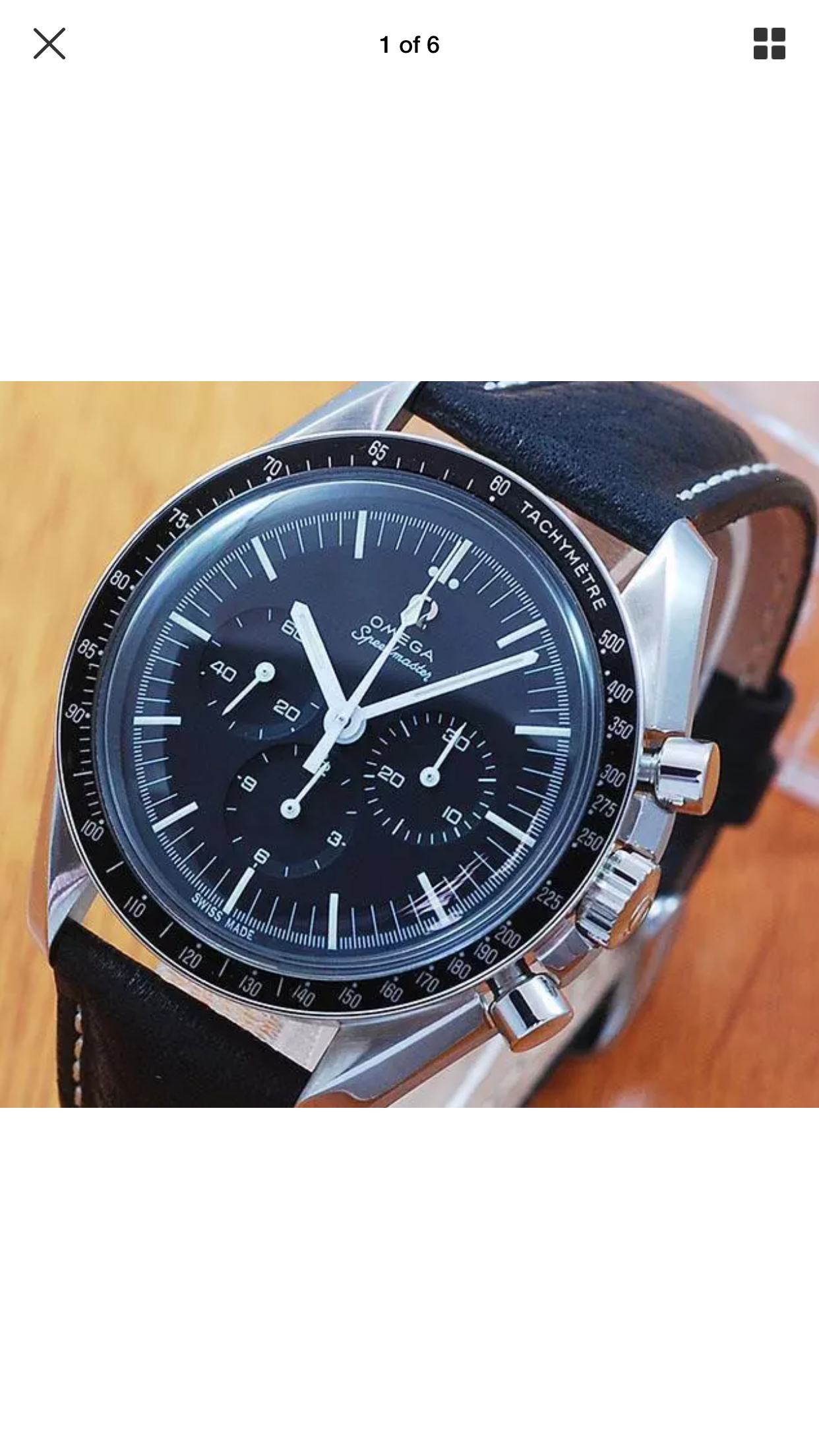

I was up late scrolling through Ebay and not entirely sure what I stumbled upon. Watch is from Singapore and looks new - I am guessing a fake, but have only seen a few of them, and none like this.
The watch is supposedly a 145.022 but has an applied dial and no T. Thought it could be a service pre-professional dial? But the S and p are connected, so it looks more like the “replica” dial. Of course it has the wrong hands and I don’t know if this would work with the 861.

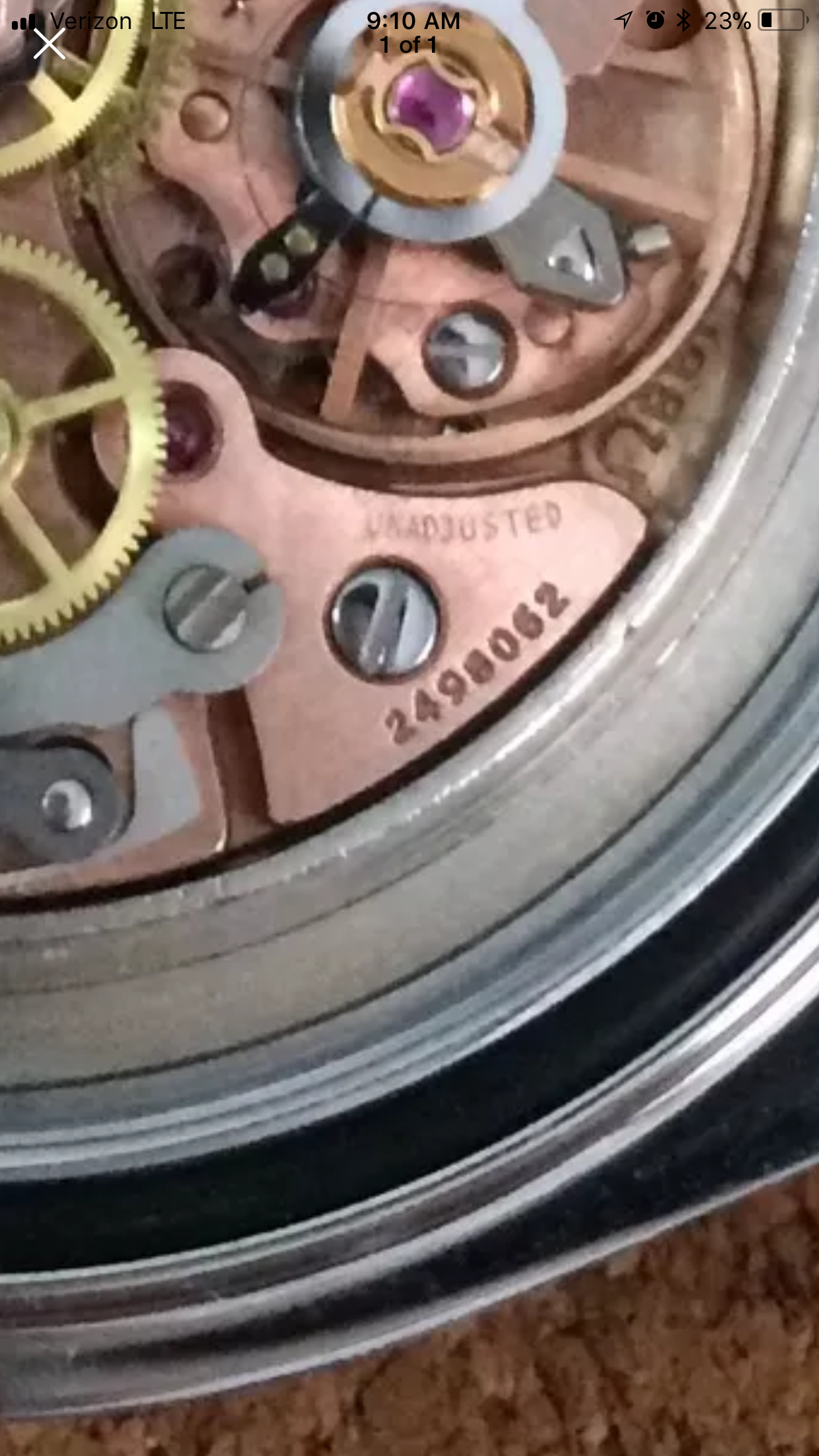

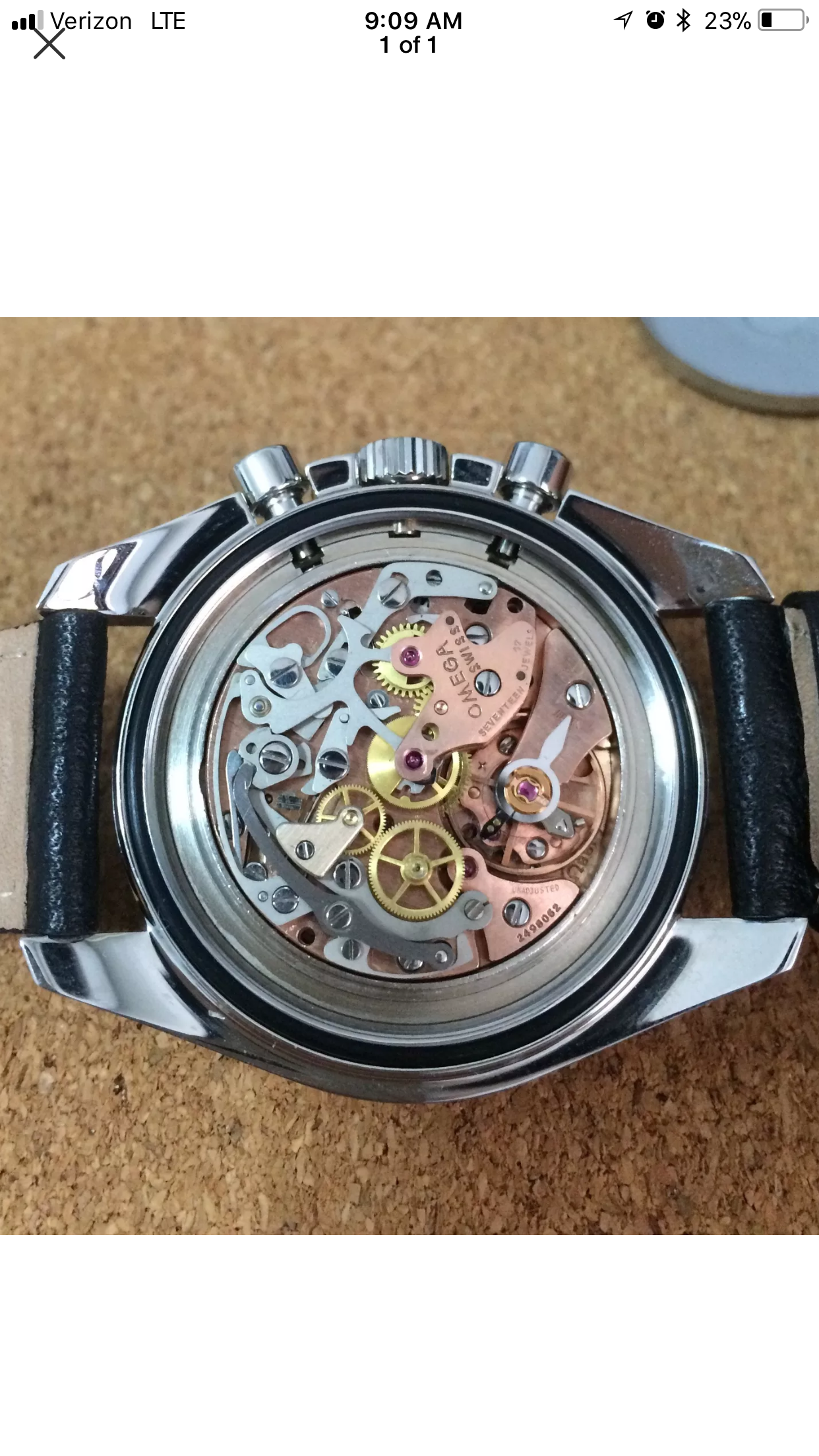

I asked the seller for a movement shot and was sent a photo with a movement that doesn’t have a full serial number...
Dead Link/rover/0/0/0?mpre=https://www.ebay.com/ulk/itm/232556613672
Here are screenshots of the dial, back and movement. I would love to hear your thoughts. I am always itching for an applied logo, but will not be satisfying the itch on this one.

I saw that one too, and it raised plenty of red flags.
Didn't spend a ton of time debating, but my immediate response was fake. Nearly reported it, but then thought about something else and moved on.

It’s crazy that they even fake the movement. Part of me wonders if it has some real parts cobbled in? Anyway, you can get a real Speedy and a nice one at that for the money he is asking. Hope no one gets played.

While I don't like the watch, I wouldn't call it fake, but franken. Case, dial, and hands looks omega parts. Not correct, but not fake. The movement is another history. Could be a mix of some lemania based movements with some ugly and dishonest hand engraved parts.

Metal brake? 17jewel movement... 861 on baseplate. 24m Serial....

Frankin movement and hodgepodge of parts. I think it’s a cut down 321 service dial.

That piece of jiggery-pokery is going to catch someone less observant out, and that will be a travesty. These frankens/fakes are beginning to get worryingly good, but the really obvious tell with this one is that you’re kind of unlikely to find a brand spanking new 145.022 without a mark on it. I’m with Yossarian in my opinion of the lowlifes who perpetrate these horrors...

Can somebody confirm if I am correct on this? I forget the source of this information, but I read a while back that you can tell if the hands are real or not by the length. The minute hand does appear to be a tad too short whereas on a real one, the minute hand extends to the smallest markers.

A 145.022 , caliber 861 with a 24xx serial..

They are Omega hands, but only correct for Mk 2's.

I would say those are teutonic hands because of they are all white and fit an 861 mvmt, but the minute hand lume is like a pro moon. MK2 hands have black paint at the bottom and the minute hand has lume isn't right.
my guess would be fake hands.

Yes that looks like teutonic hands

Those look a lot like Mark IV hands, which you can still order from Ofrei. I know because I bought a Speedy once which had this type of shorty hands installed, presumably in some long ago service.

To me this looks franken not fake. I have see. Mark IV hands on a couple of speedmasters. Dial looks like a A8 Replica in MWO.
