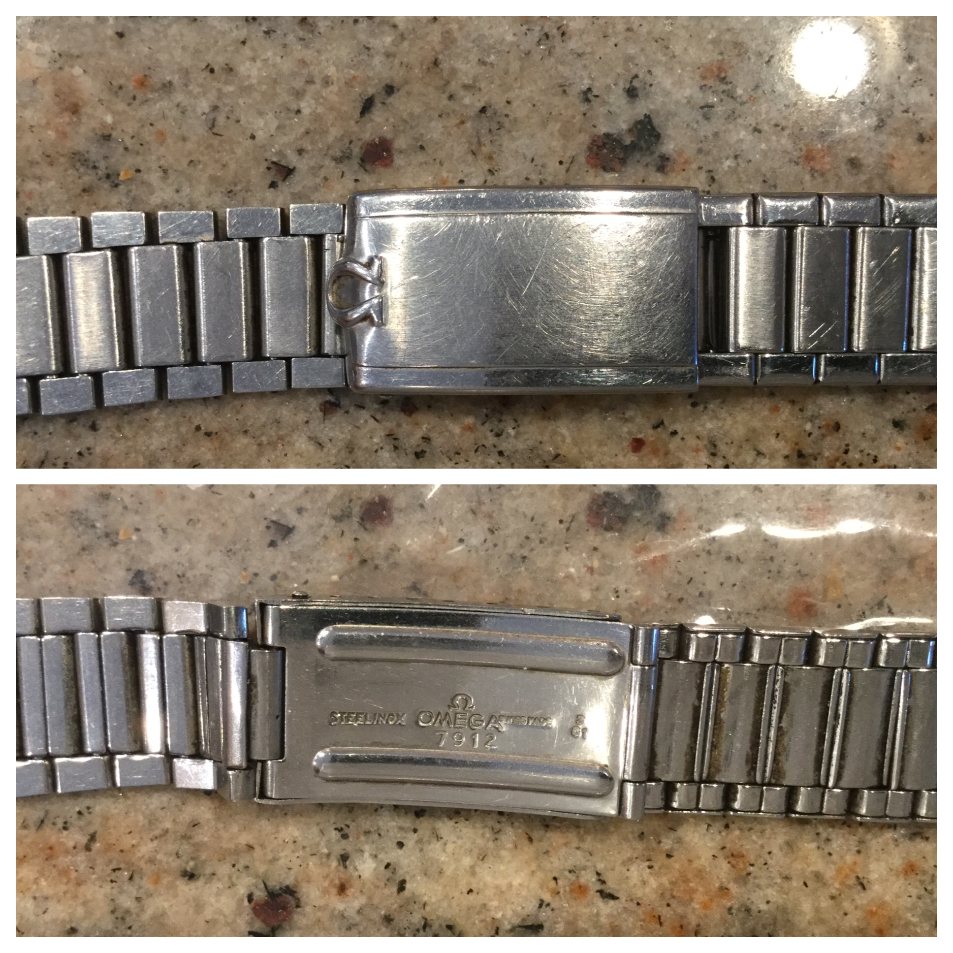

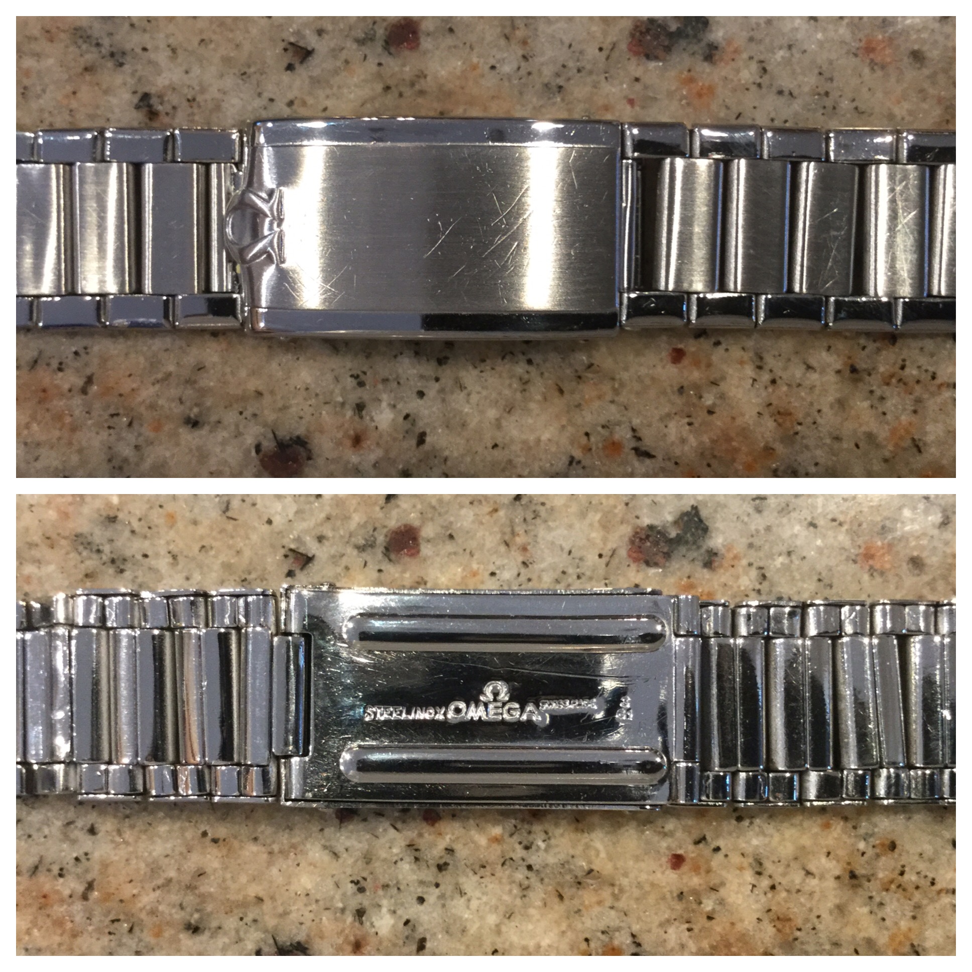

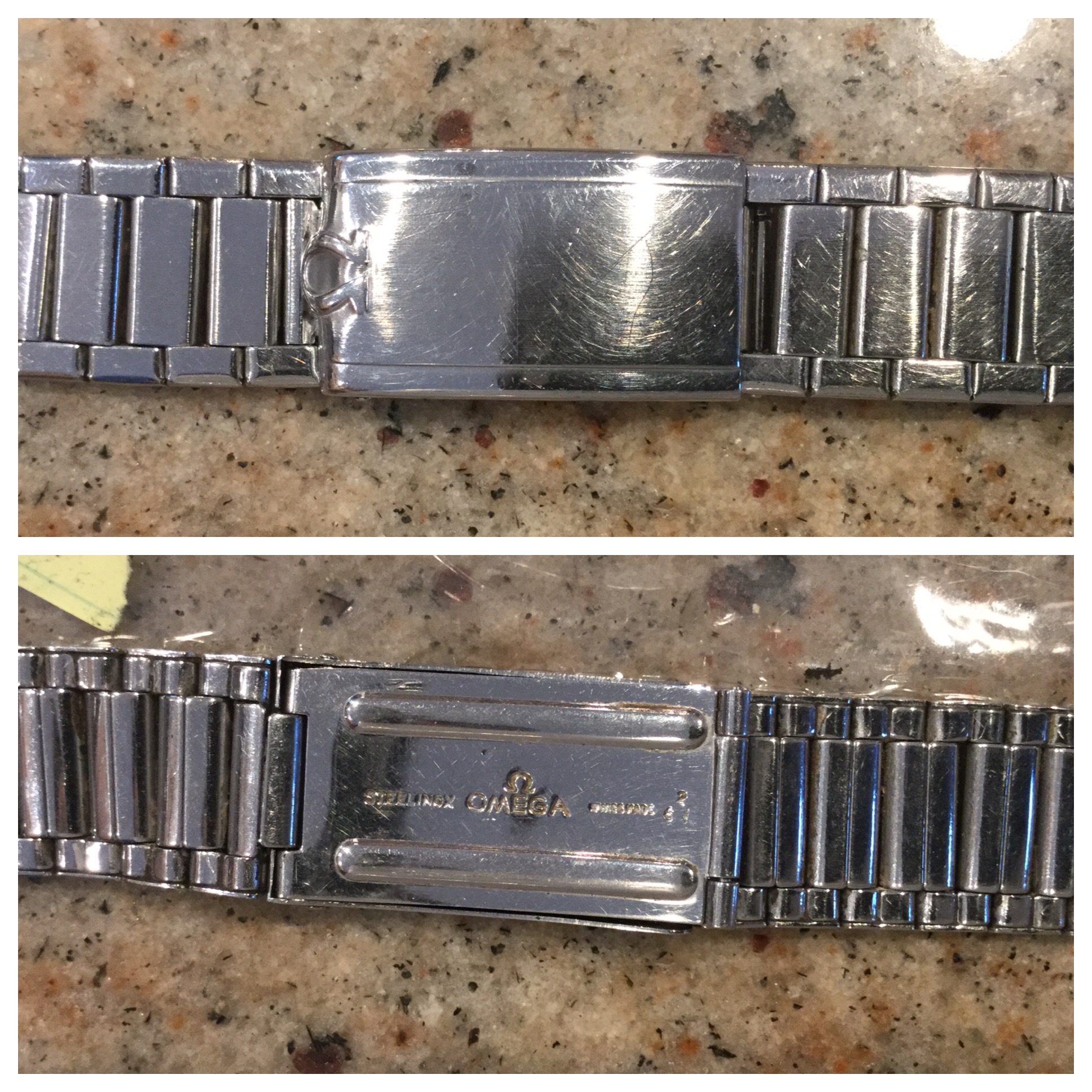

No expert on these but I think bracelet is legit. Buckle lengths, expansion links and references were all transitioning around this time.
See below pics
4/60 7077 transitional with short buckle, fixed expansion links
2/61 transitional no reference 7912 with large buckle, fixed expansion links
3/61 transitional no reference 7912 with large buckle, fixed expansion links
3/61 Reference 7912 with removable expansion links

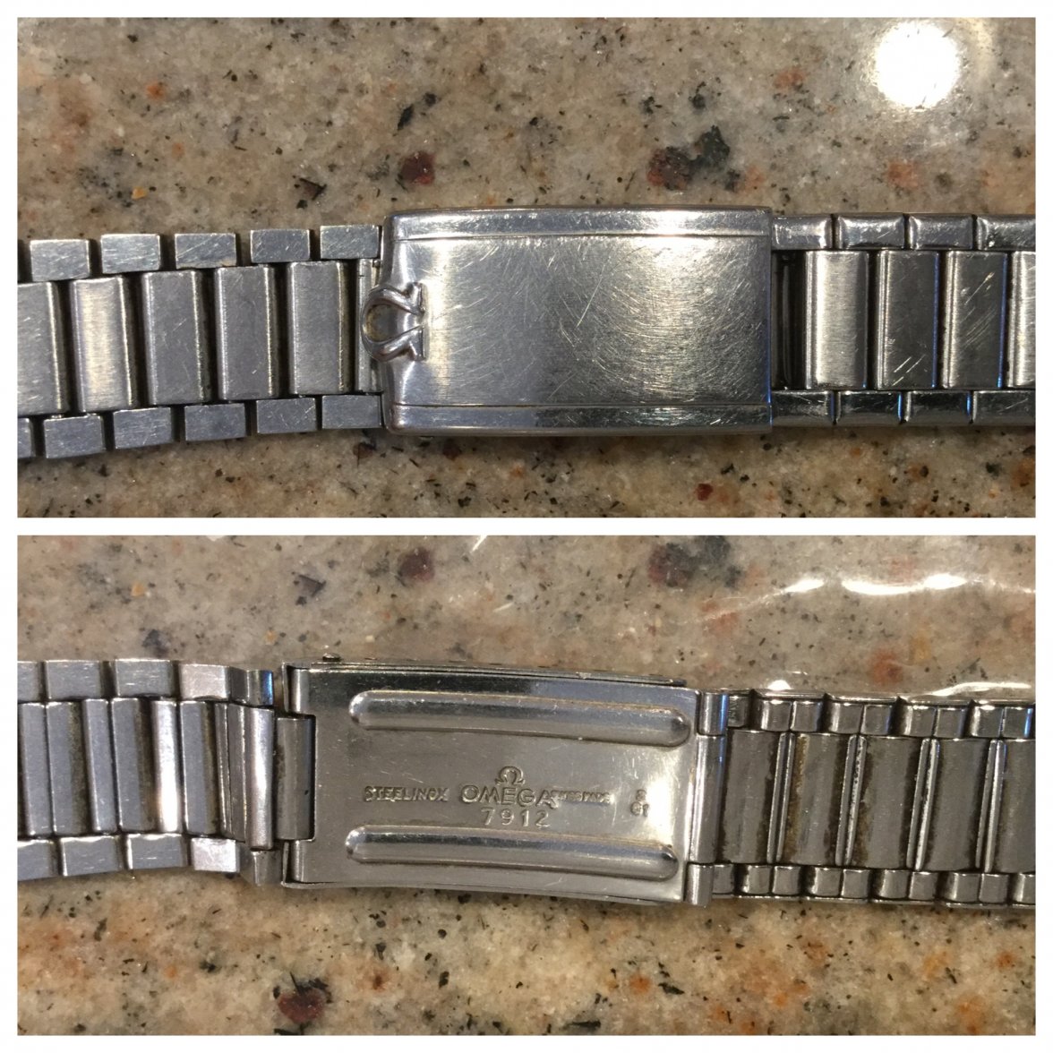

See below pics
Lol!! I love how you preface it with “I’m no expert” then pull 4 examples out of the air. 👍

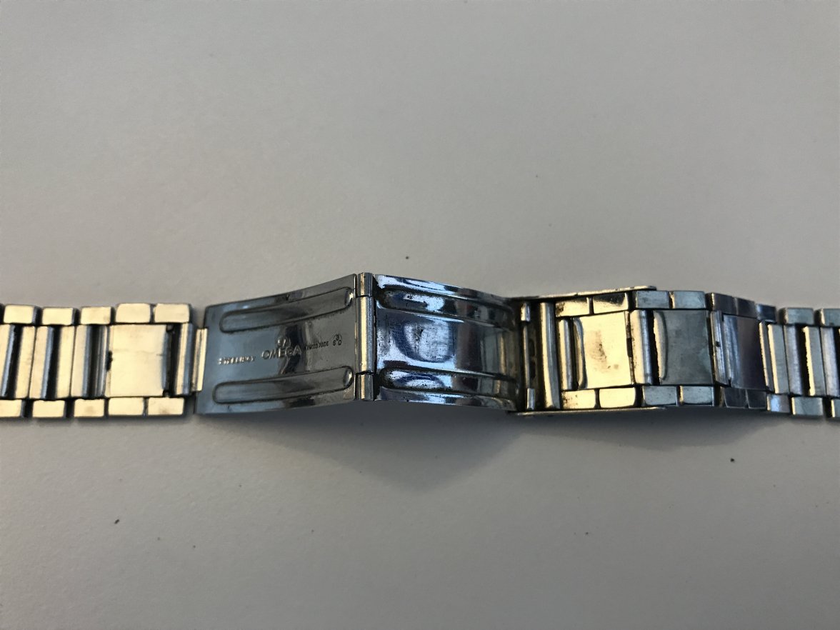

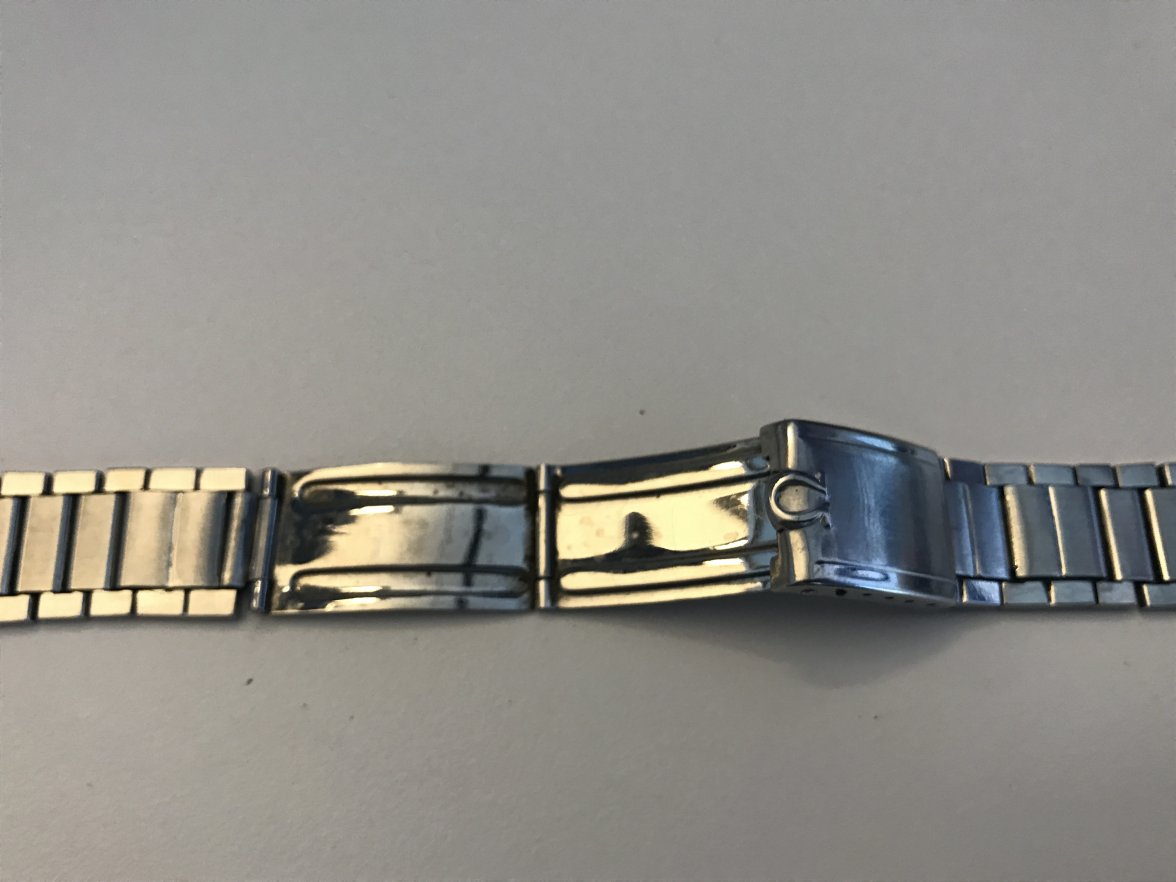

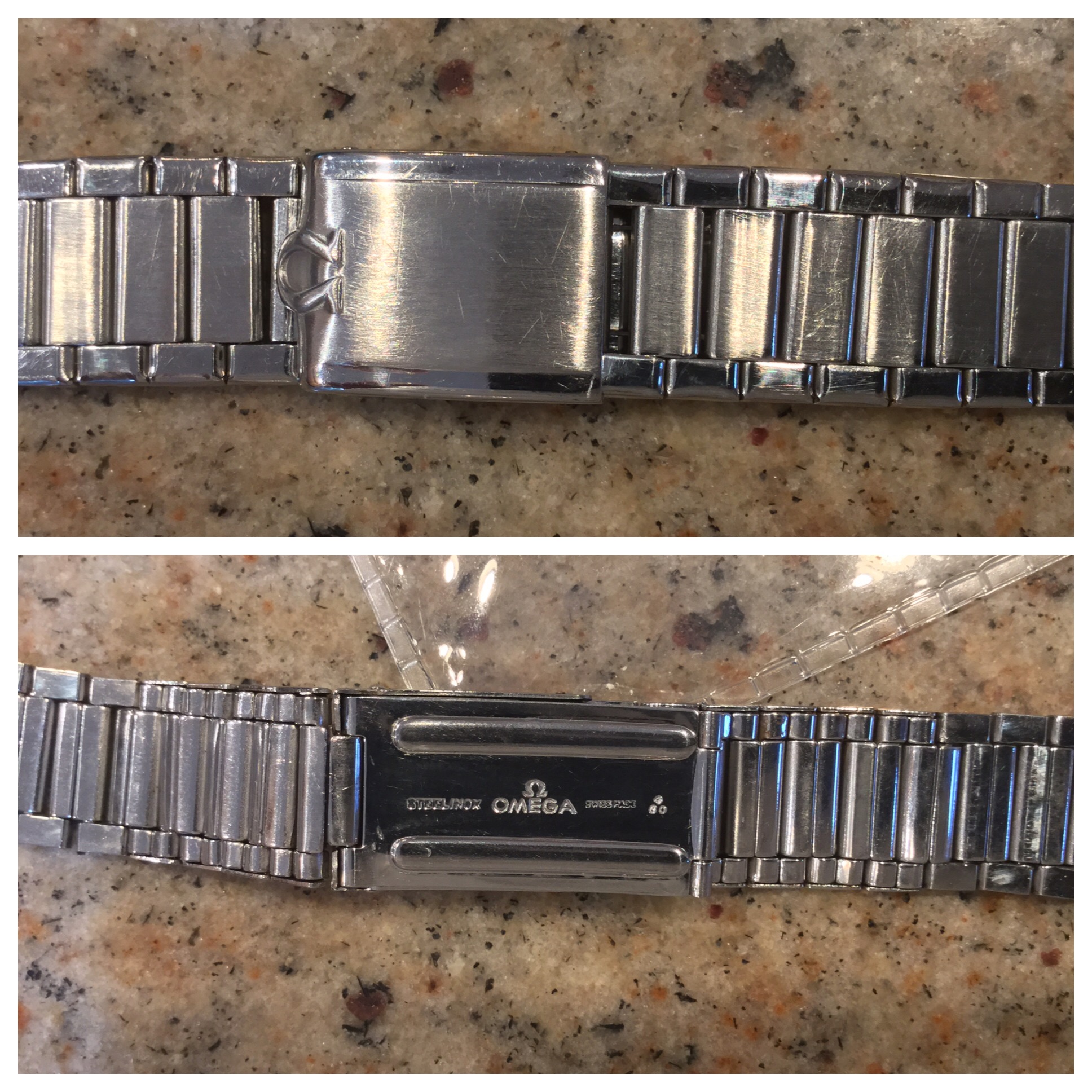

Here is a 7077 short buckle, circa 3/60, with the first generation double expansion links. Bought from a member (his pics) two years ago. Combined with the above examples, we can see the one year transition from the 3/60 Reference 7077 to the 3/61 Reference 7912.
