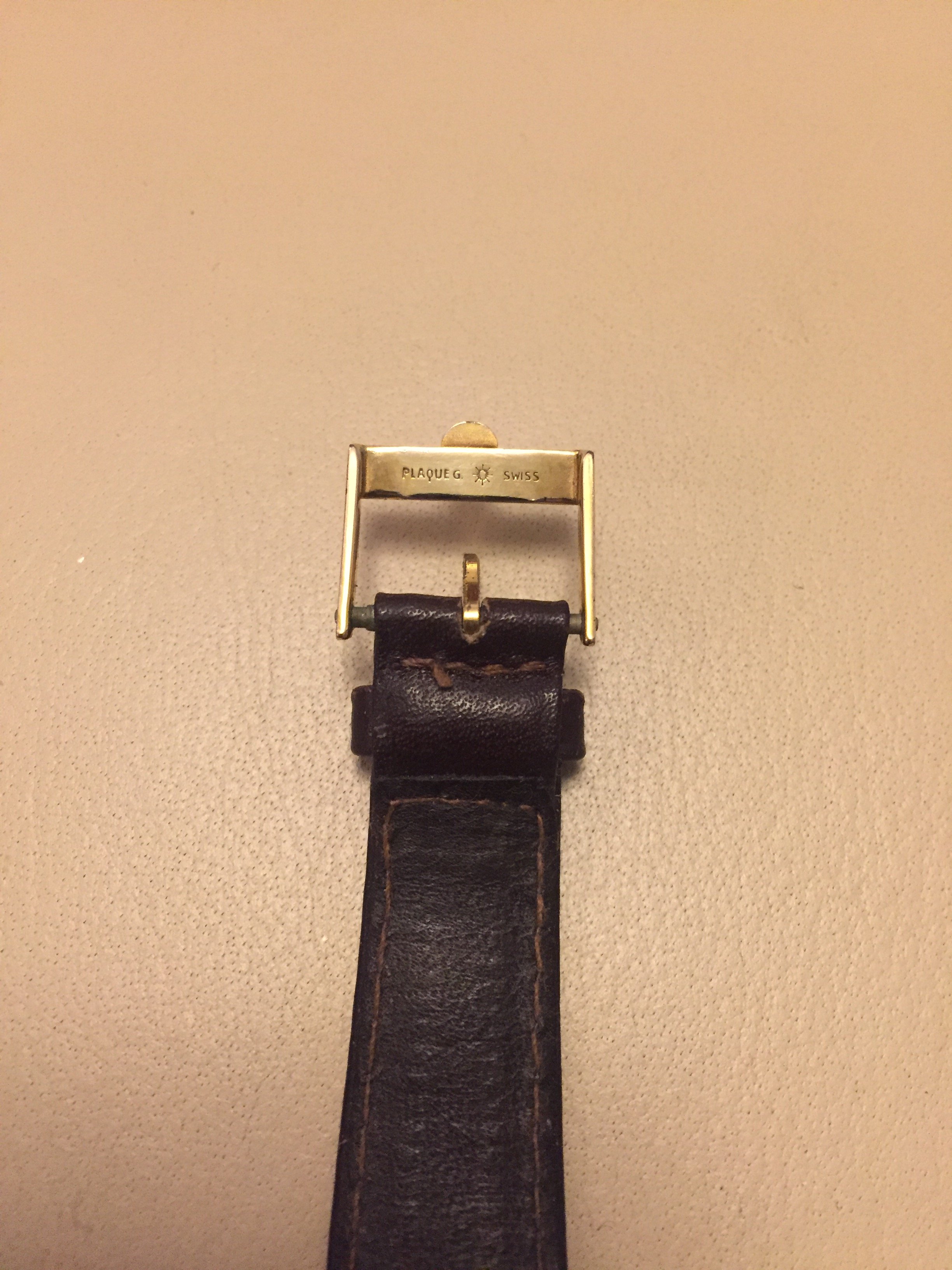

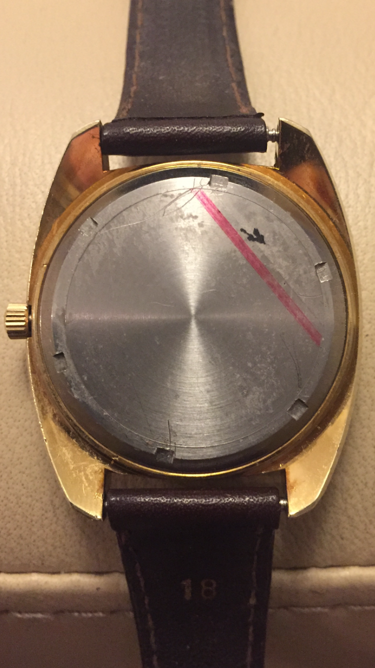

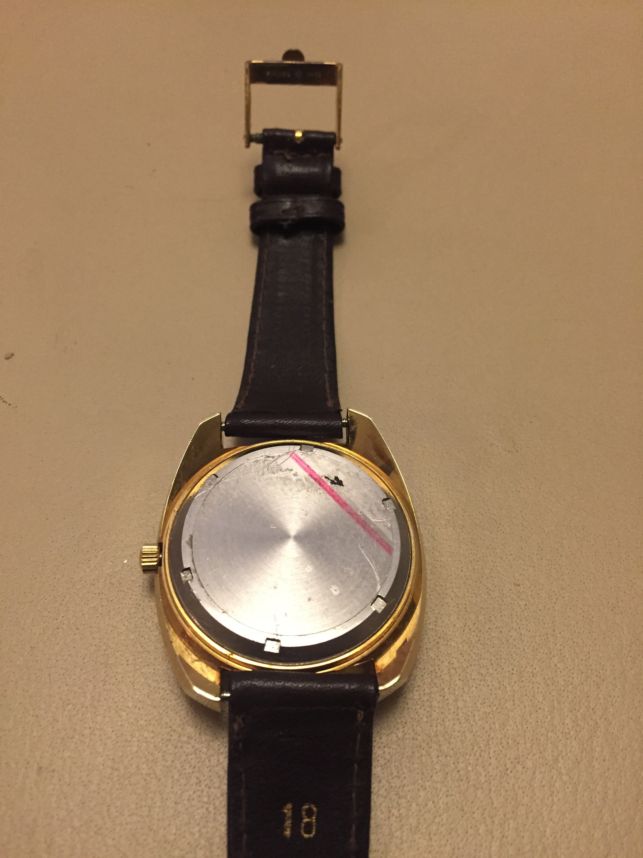

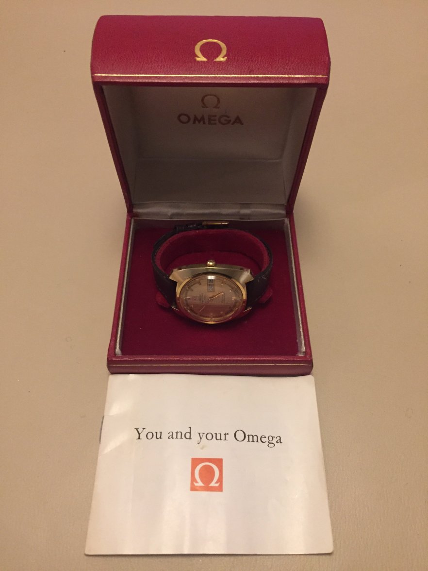

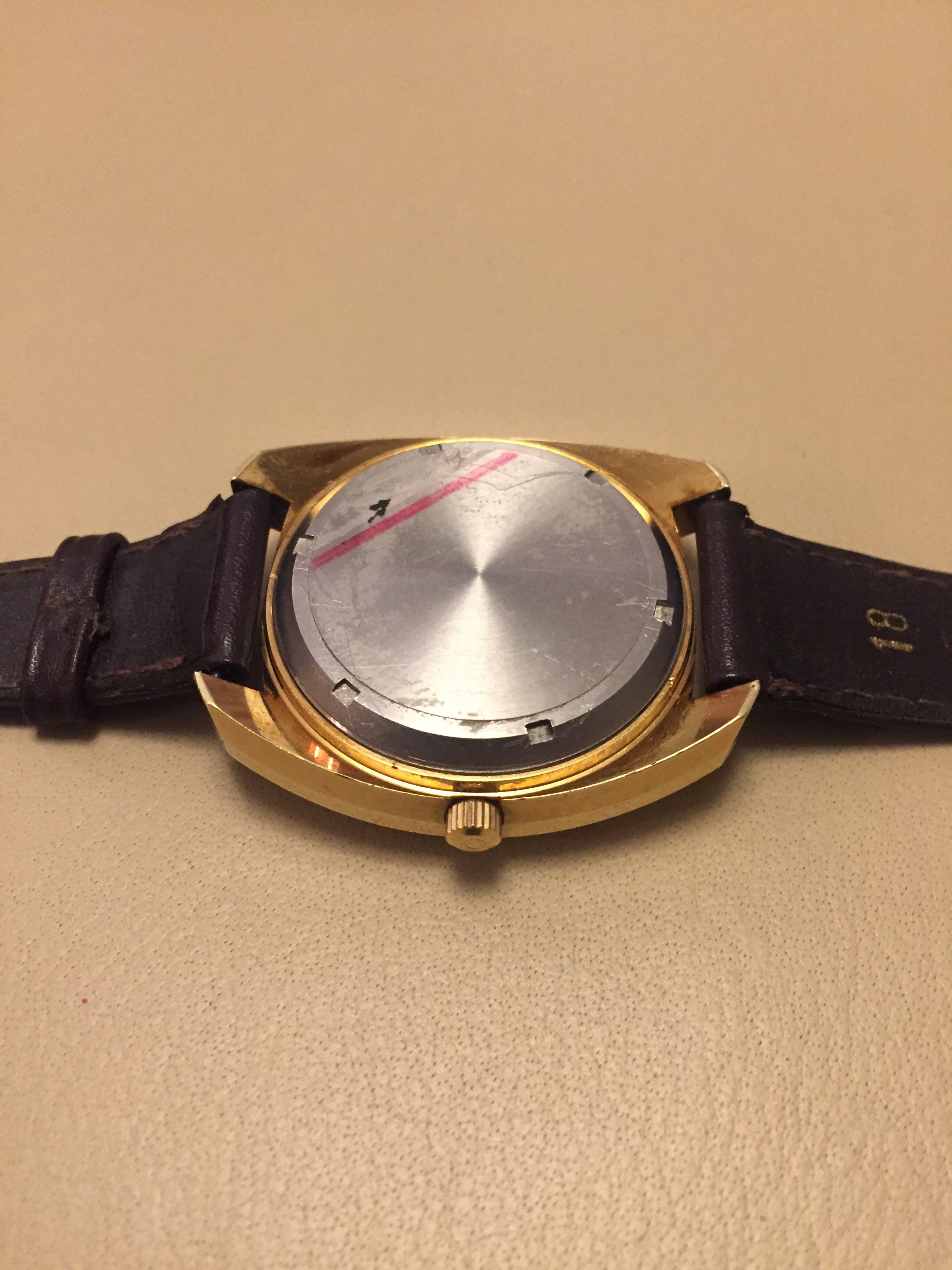

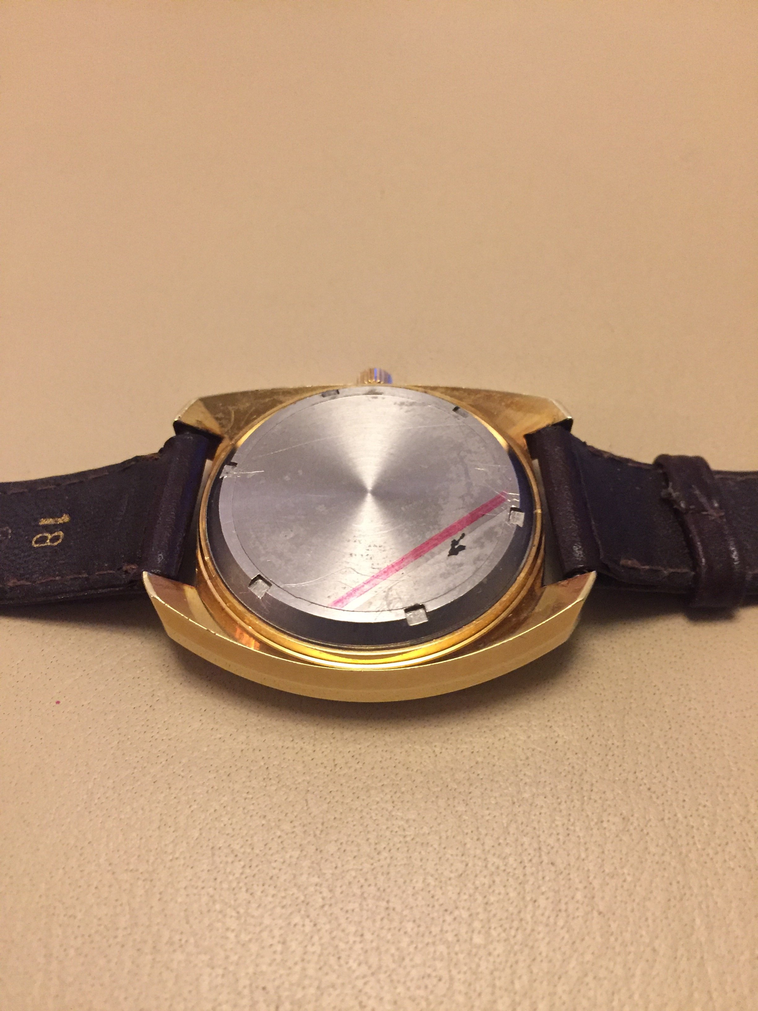

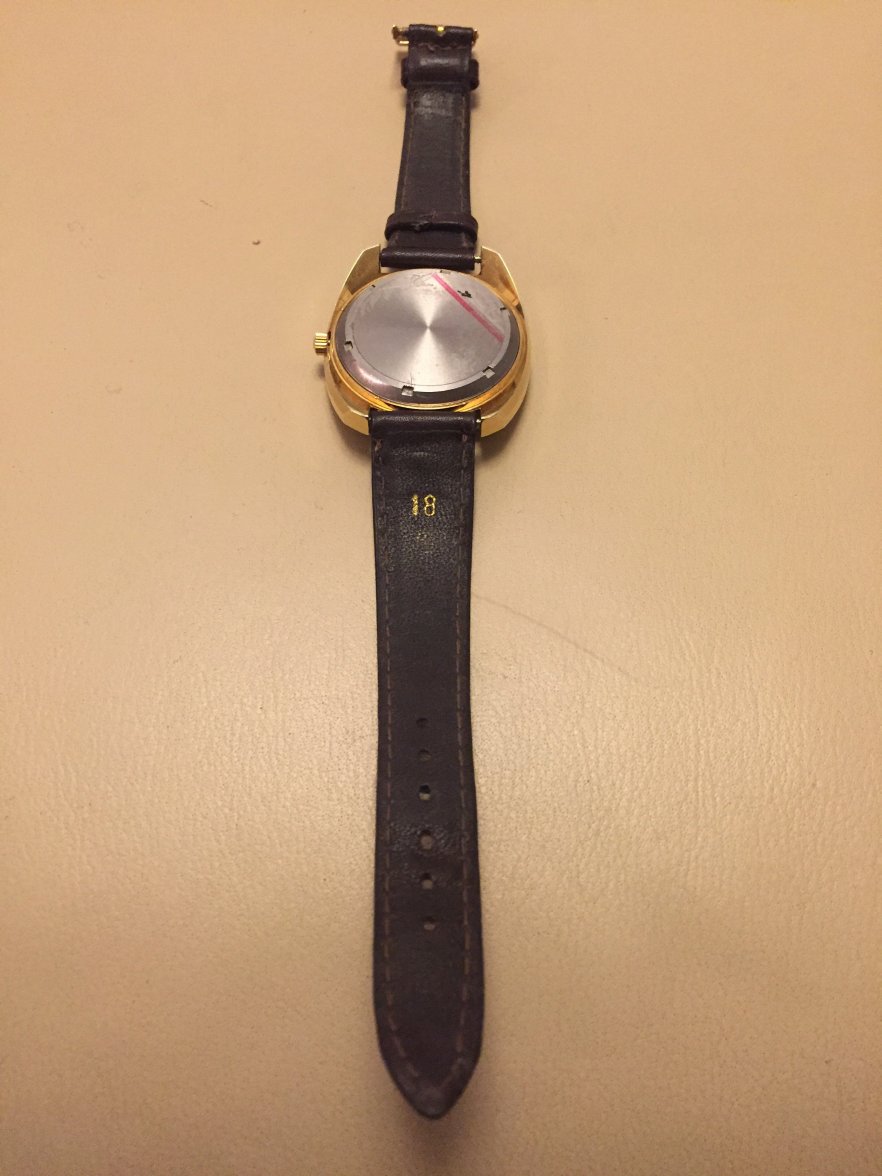

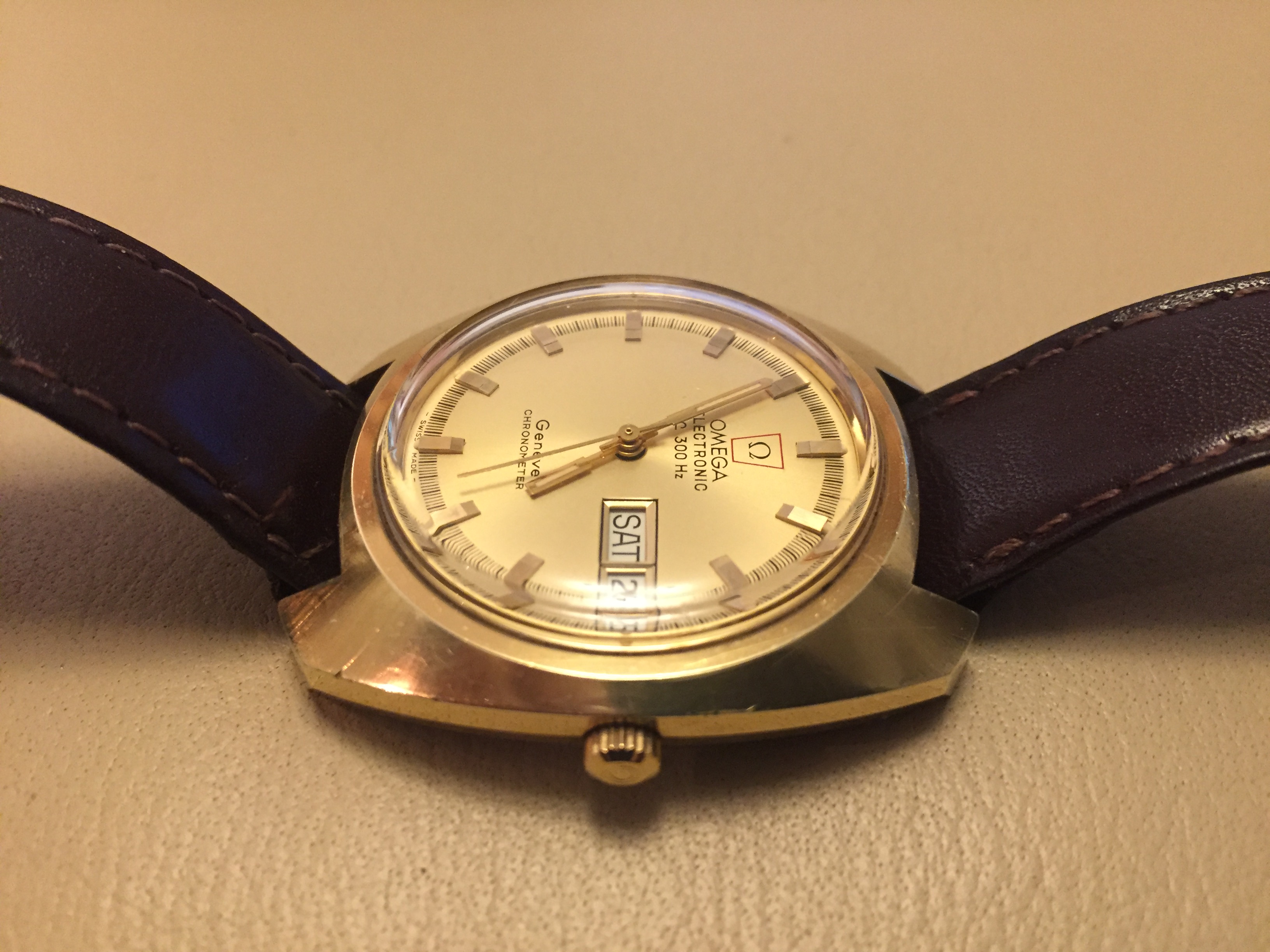

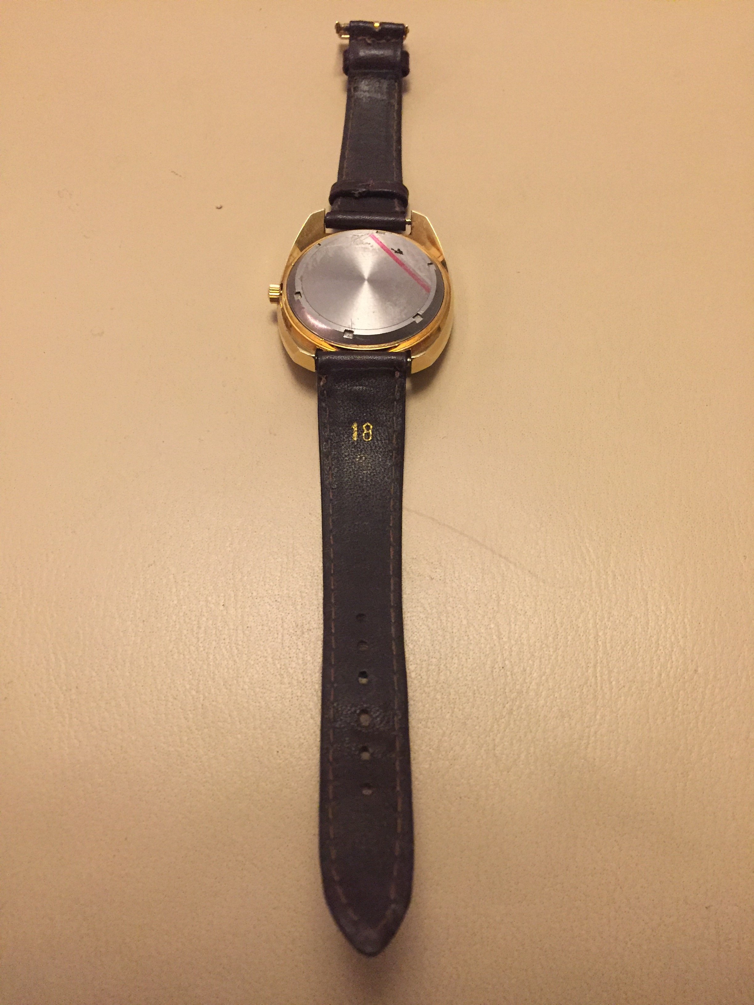

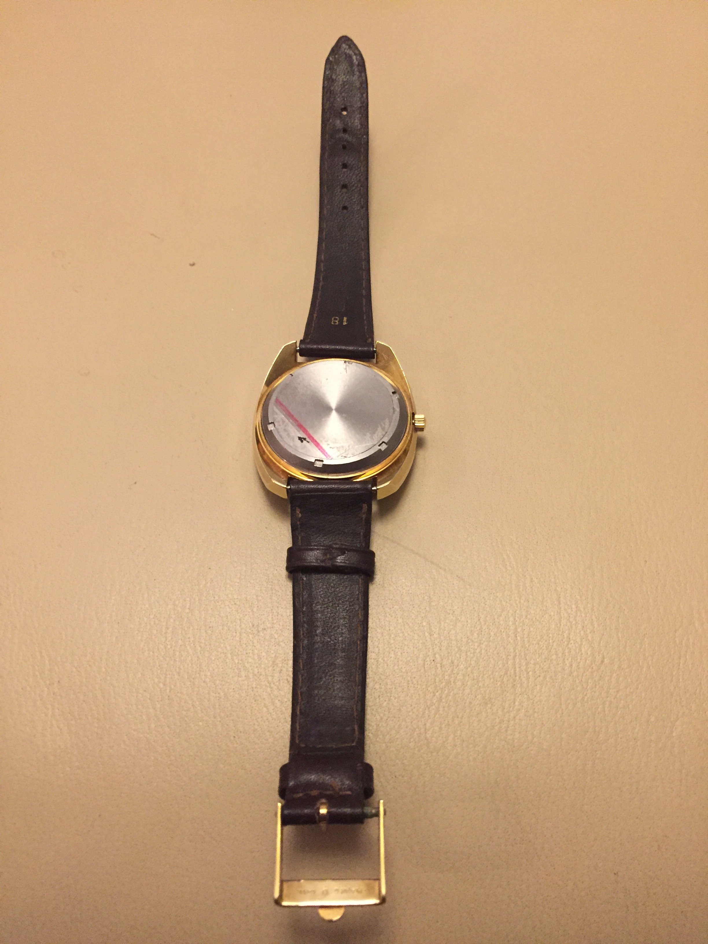

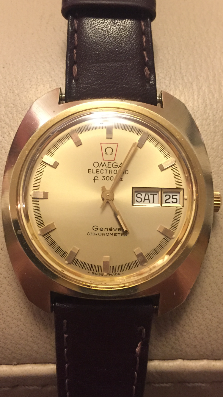

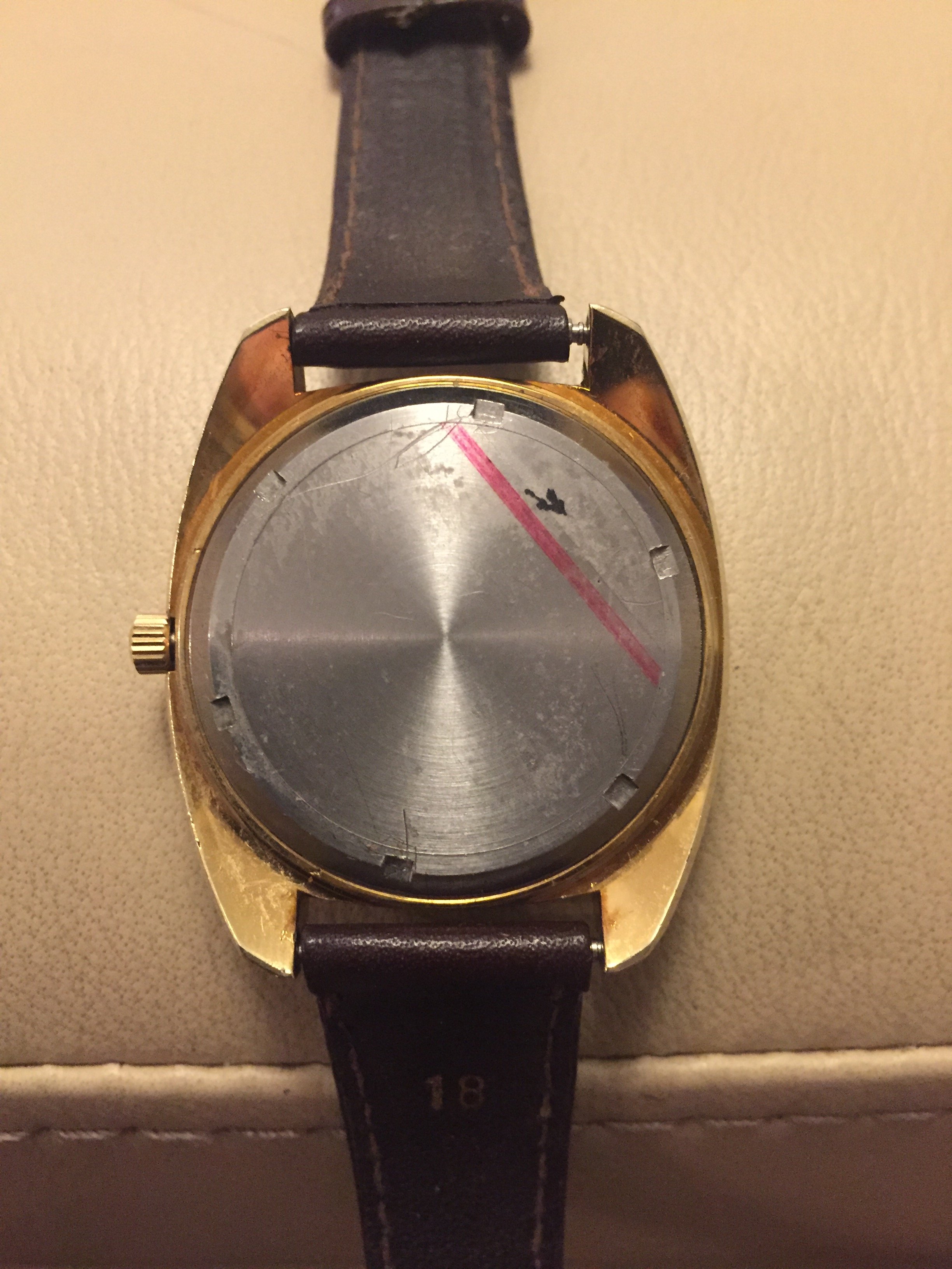

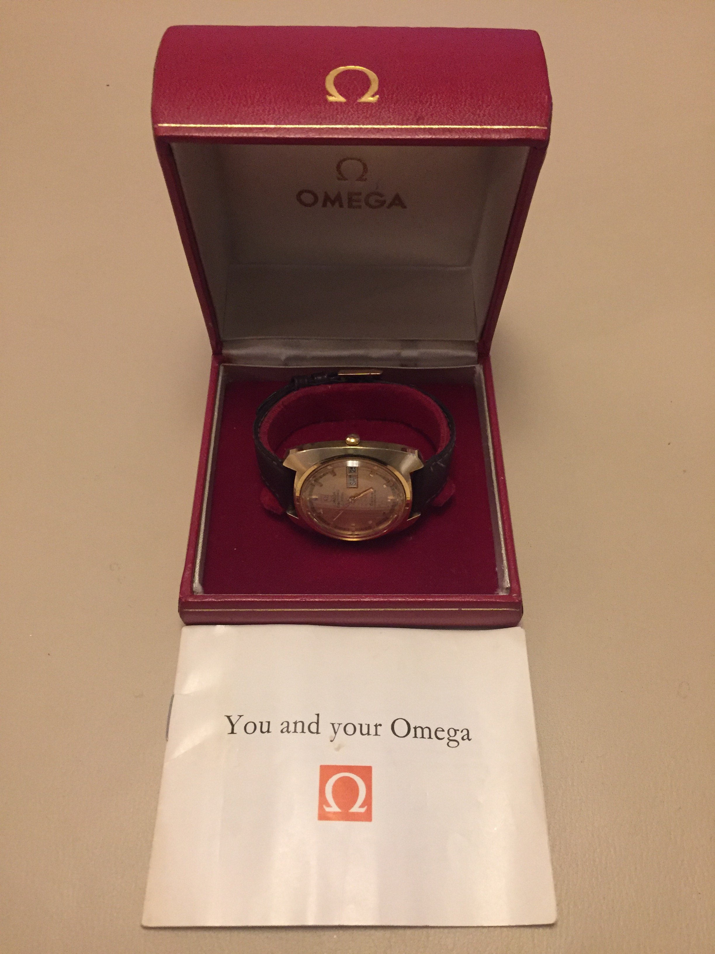

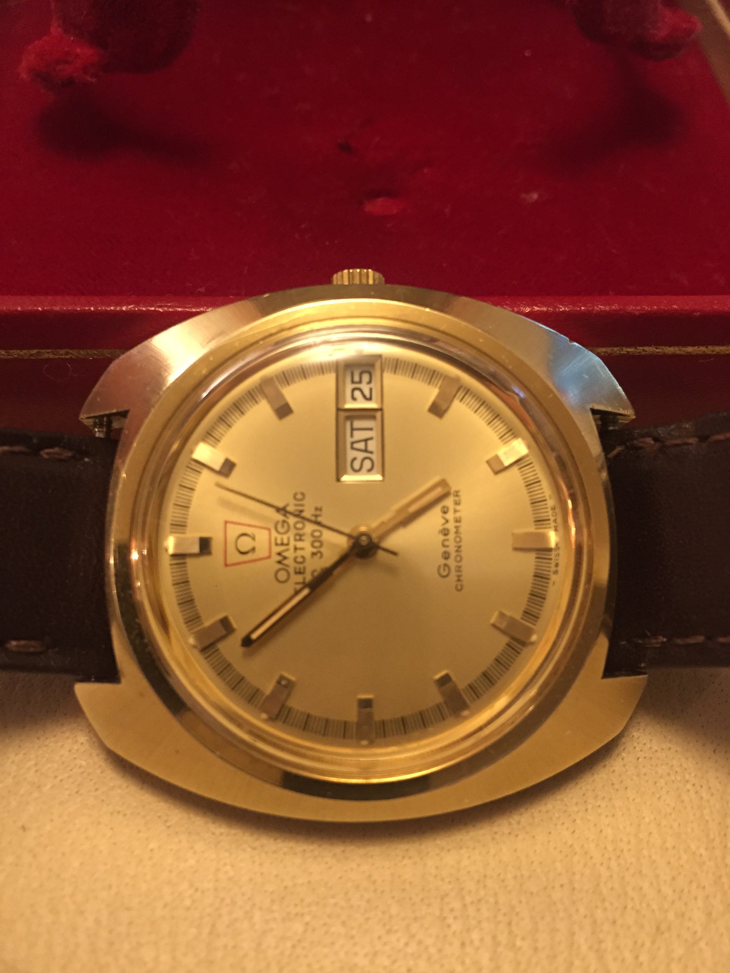

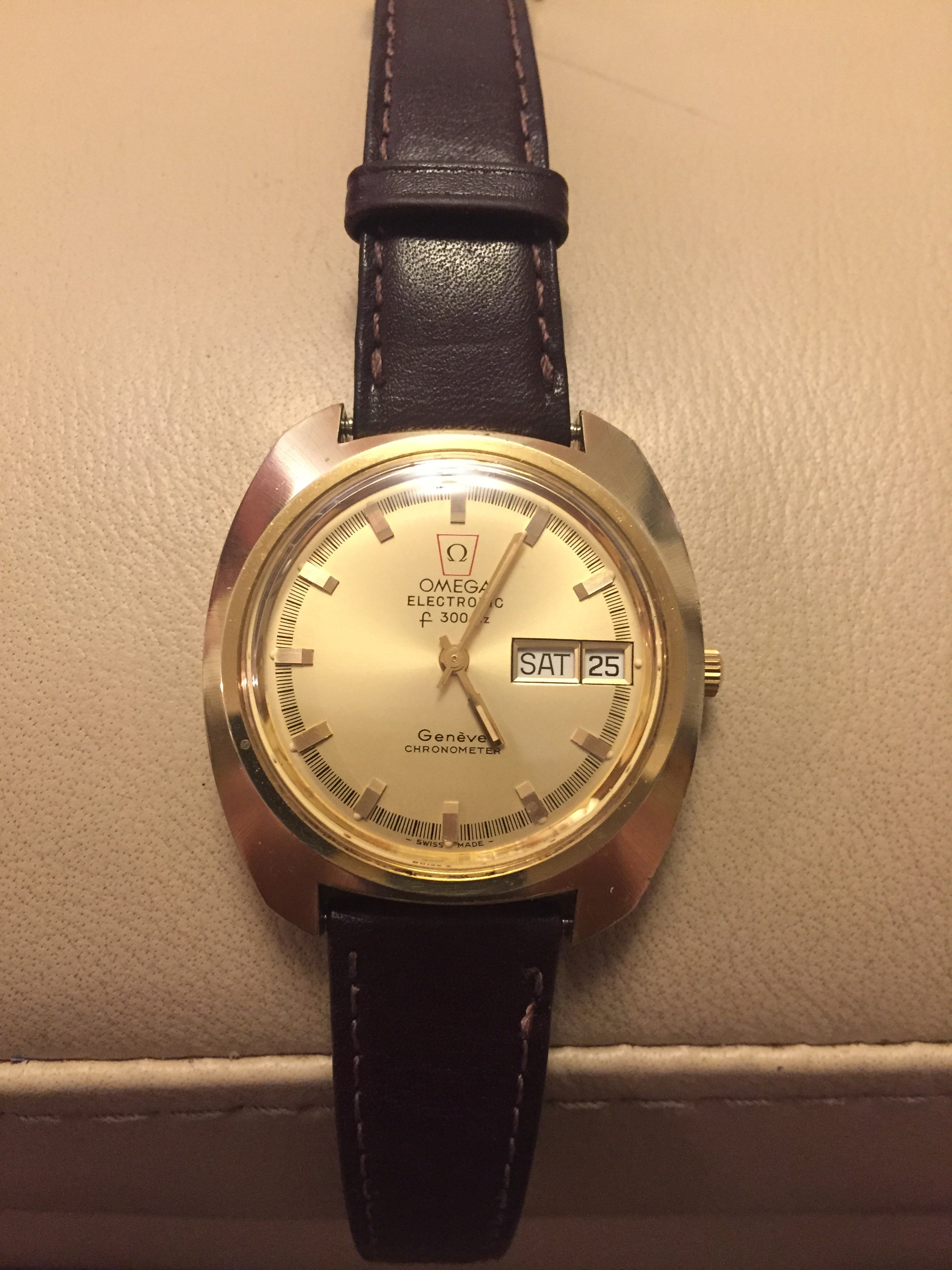

I recently inherited this f300 Geneve. Lacking in any kind of knowledge about it I found your forum. I've posted as many pics as I can and would appreciate some general information about it. It'd be great if forum members could confirm it's in it's original box. I don't think it's been altered in any way and the manual is still with it. General info such as Year of Manufacture, is it original, where to get it serviced, how often, service costs, and a rough value would all be very much appreciated.

The Omega caliber 1260 is actually an ESA 9164 movement. The reference of your watch is 198.031 and it was made in 1973 or 74. The movement itself is very reliable, but prone to damage due to wrong handling during battery replacement. They do not need a service until something is wrong. When the second hand tuns while you set the time (only test this clockwise if service history is unknown) service is overdue.
People who actually service them are getting rare. Parts are still available used and new.
10,804
16,814
Circa 1970-75 model 198.031. Box could be original, it is of the period but they were more often seen in f300 branded boxes. Value is not massive, if working correctly maybe £300/$400. If not then as little as £100/$150. Servicing options will depend on where in the world you are but your choices are limited due to the specialist nature of the f300 hummer movement.
The box actually looks more like the 1501 box usually seen with 60s Speedmasters but could be a different later one.
1,561
3,672
Hi there and welcome.
I am no great expert but can tell you a little to get you started
You have a gold plated C case (cushion case) watch. The movement is f300 electric movement sometimes called a tuning fork movement or a "hummer". Thus called because when it's running you can hold it to your ear and hear it humming.
This model is typically from the early 70's but a closer date can only be given by seeing the numbers inside the watch case.
In terms of servicing it may just need a battery change which would be very cheap but if the movement itself is not working then this would be more expensive and need someone with the skills in this type of watch.
Others on here will be able to suggest someone near to you if that's required.
Search "Omega c case f300 geneve" in Google and you will find more info

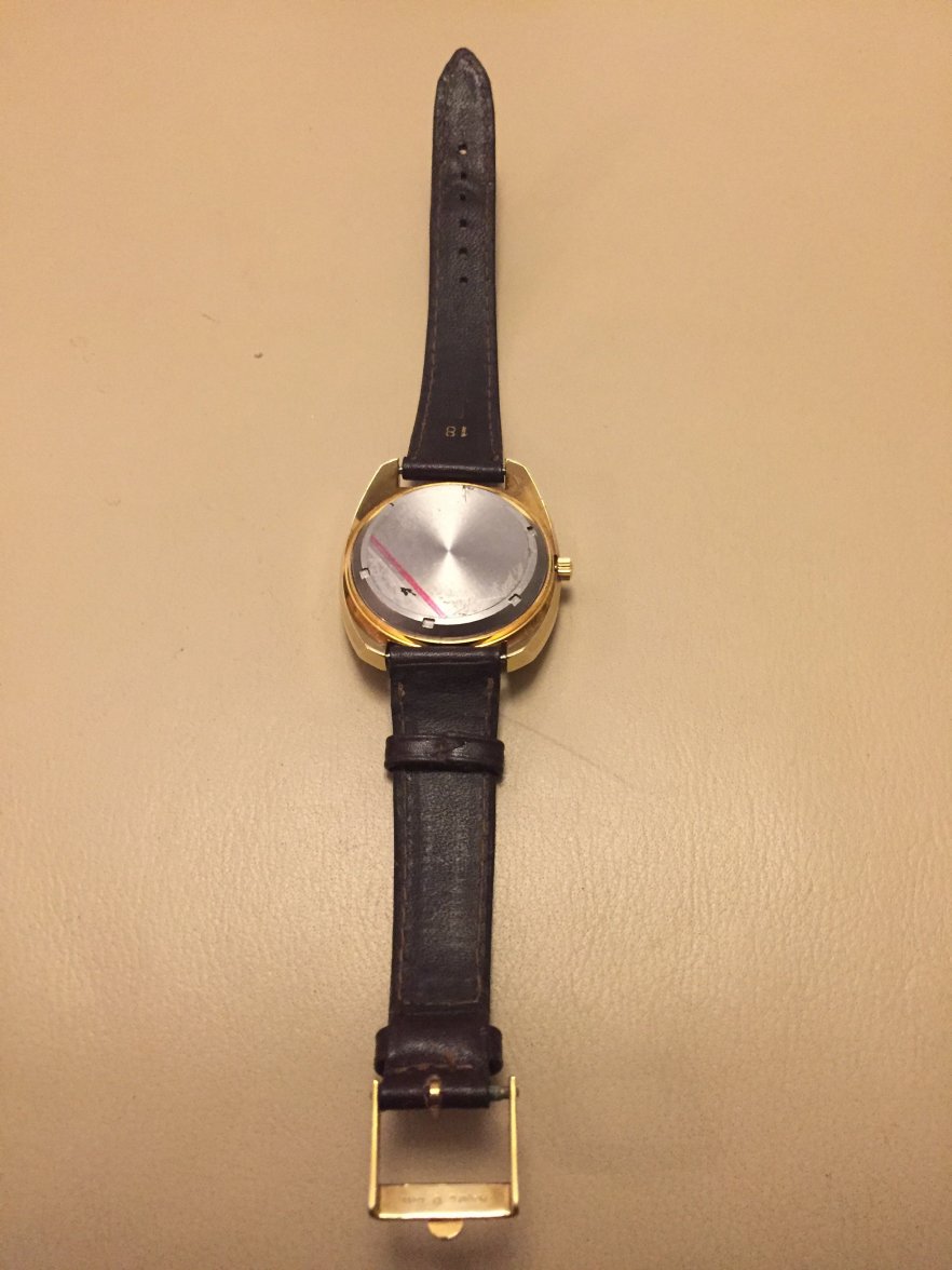

That strap is horrendous but the watch is nice. 😀
People who have experience with tuning fork watches would be a good bet. This one might be worth sending in for factory service just because of parts availability.

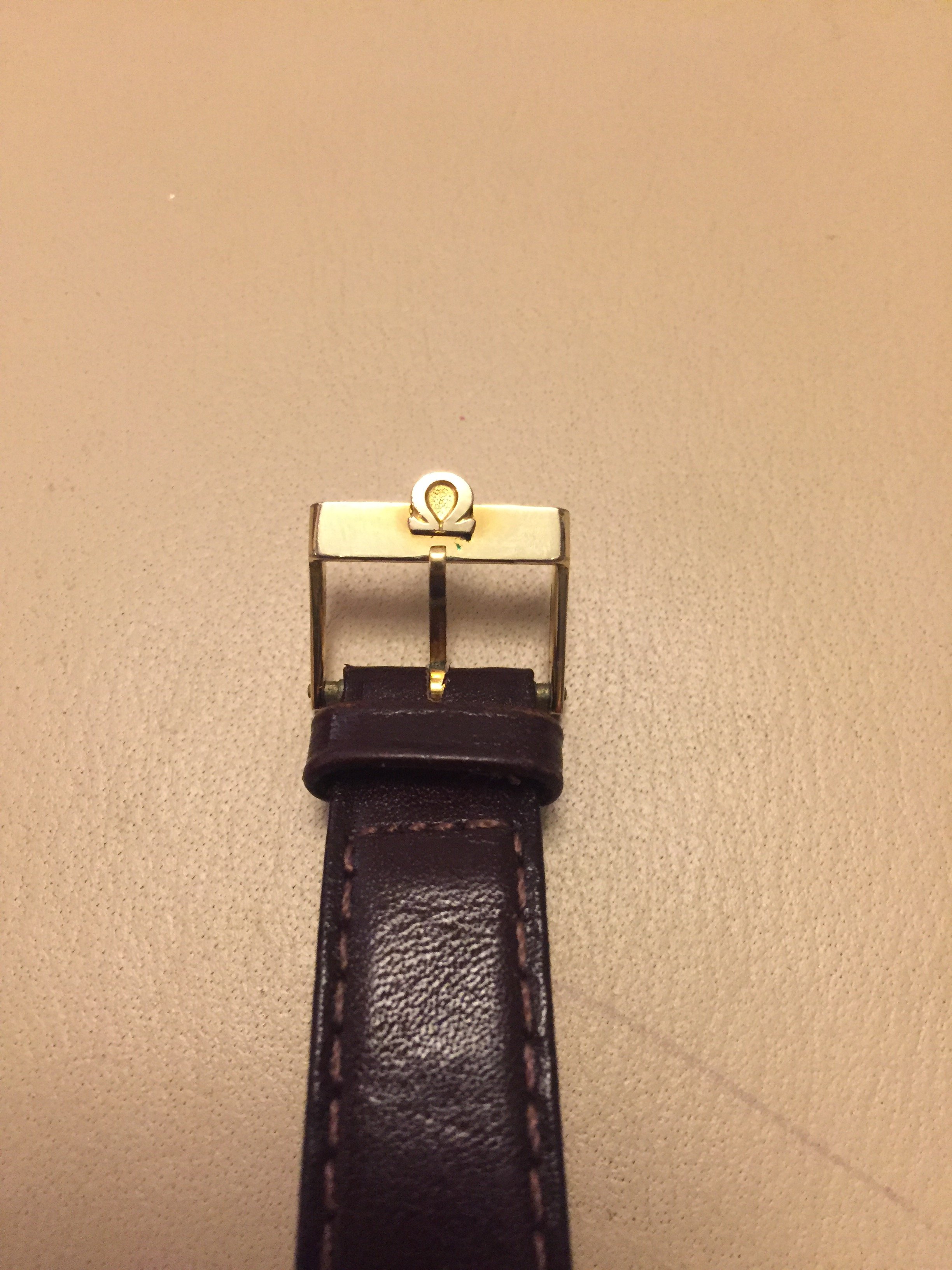

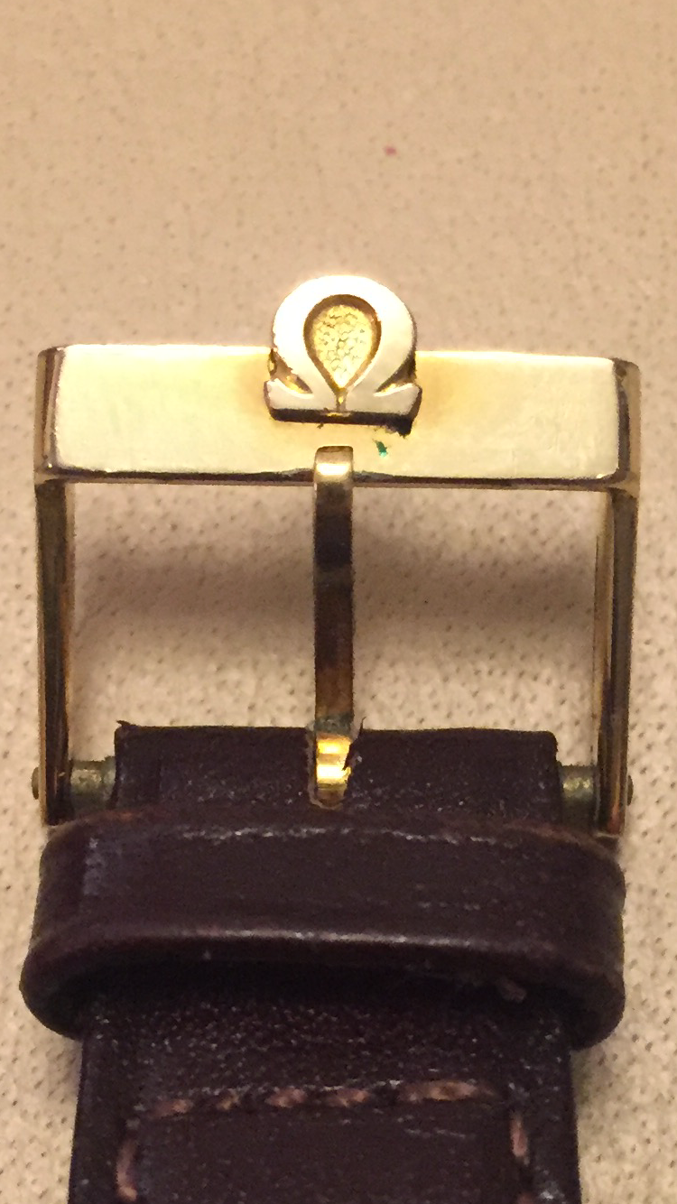

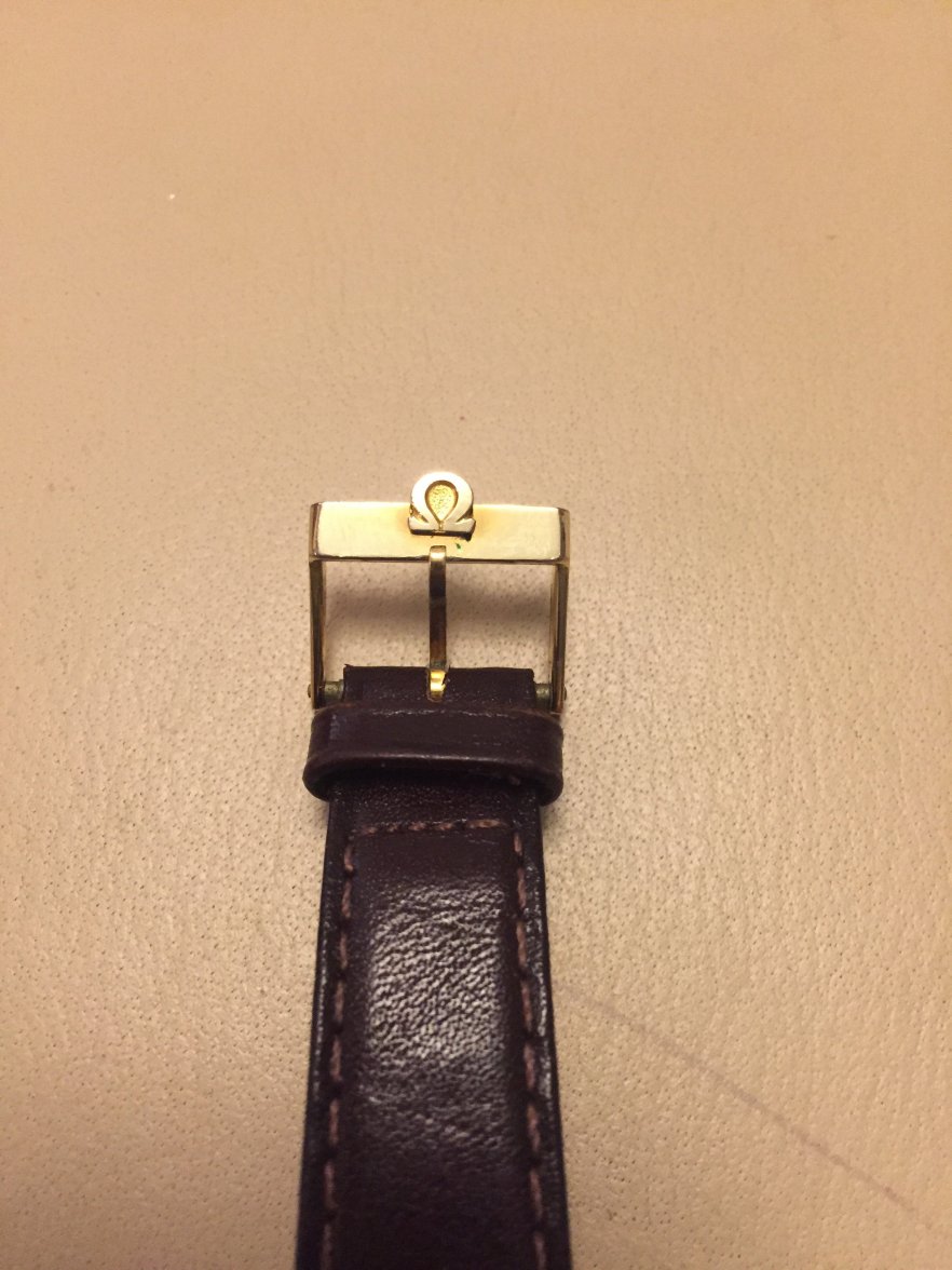

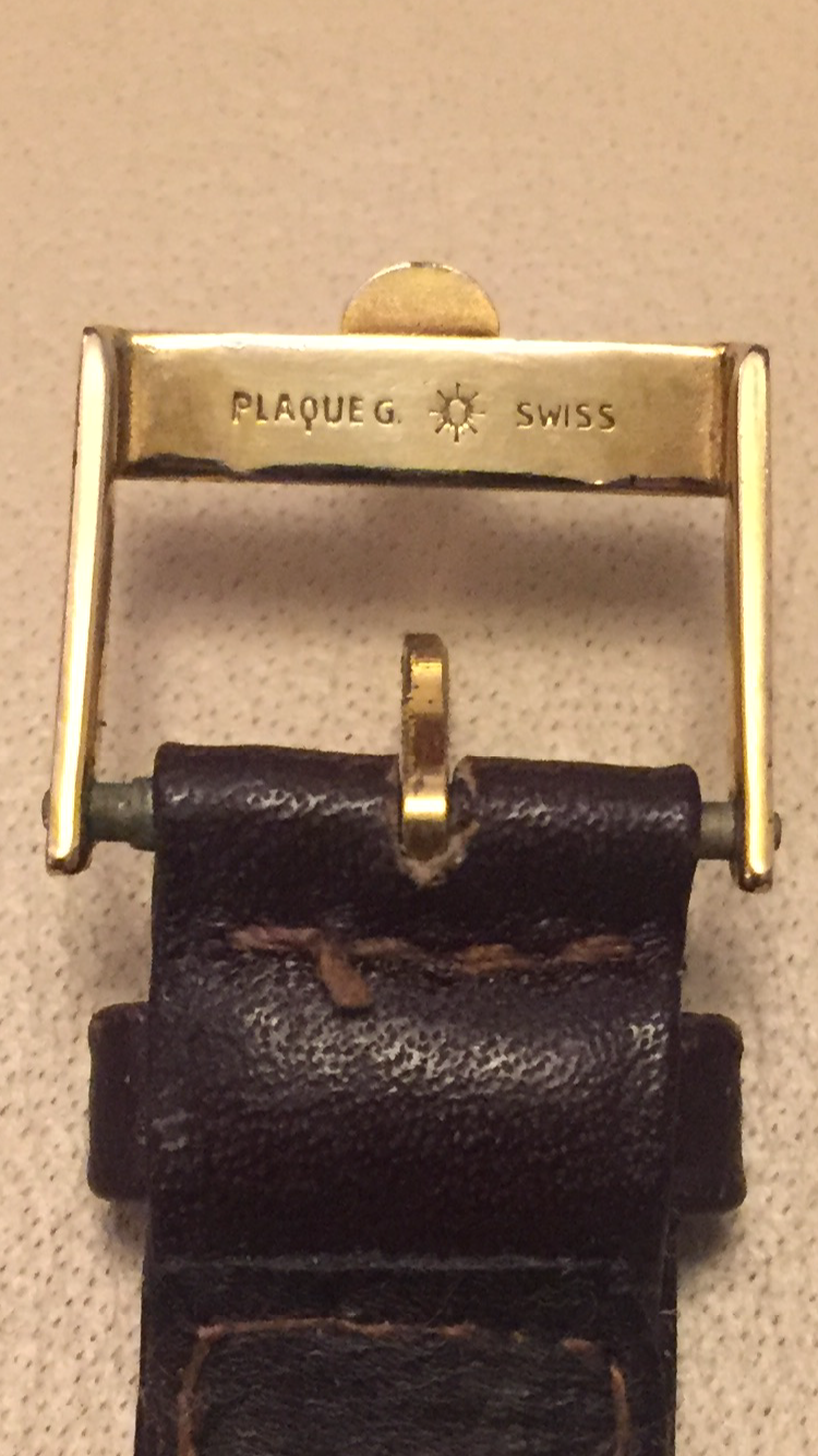

The gold plated buckle is in good condition and looks original so it's worth something.

Thanks for all your replies and advice. I appreciate each and every one. I agree with VetPsychWars comment that the strap leaves a lot to be desired. Was wondering if anyone had ever seen / appreciated / disliked one of these with a gold bracelet. Or would that just spoil the thing ? The buckle seems to be authentic so sticking with a better leather strap might be the way to go ? All comments appreciated. Thanks again.
2,326
1,887
The bracelet is 1068/654. Your jeweler can call Omega to see whether it is still available.
