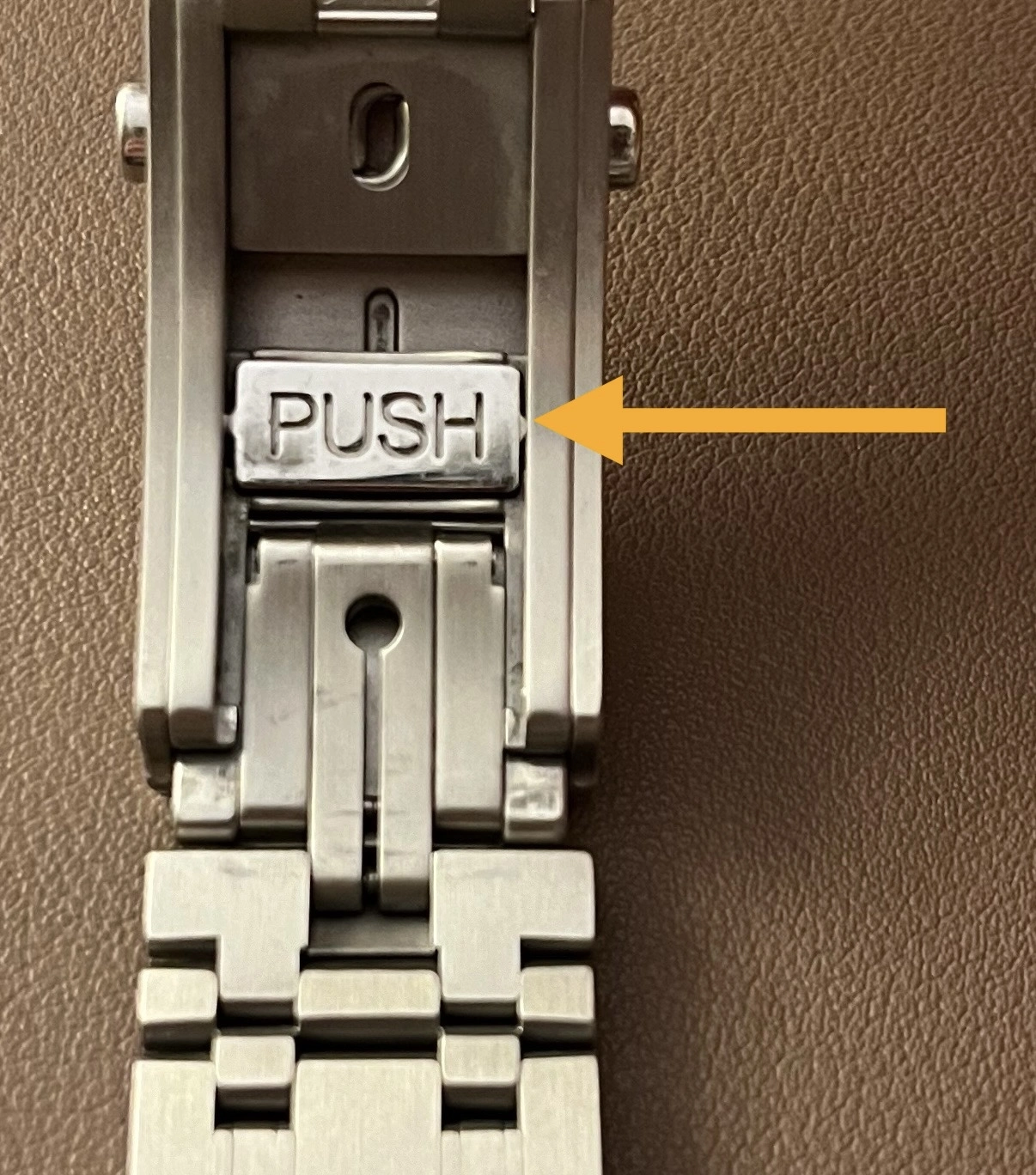

The “PUSH” button on my ref. 210.30.42.20.03.001 bracelet worked great for 2 years. A month ago, it became extremely stiff to operate, but was usable with a little extra effort. Now, it is completely frozen - the button is completely locked and doesn’t push down at all except for a small wiggle on the right side. I can’t find anyone else on the web with this particular clasp issue.

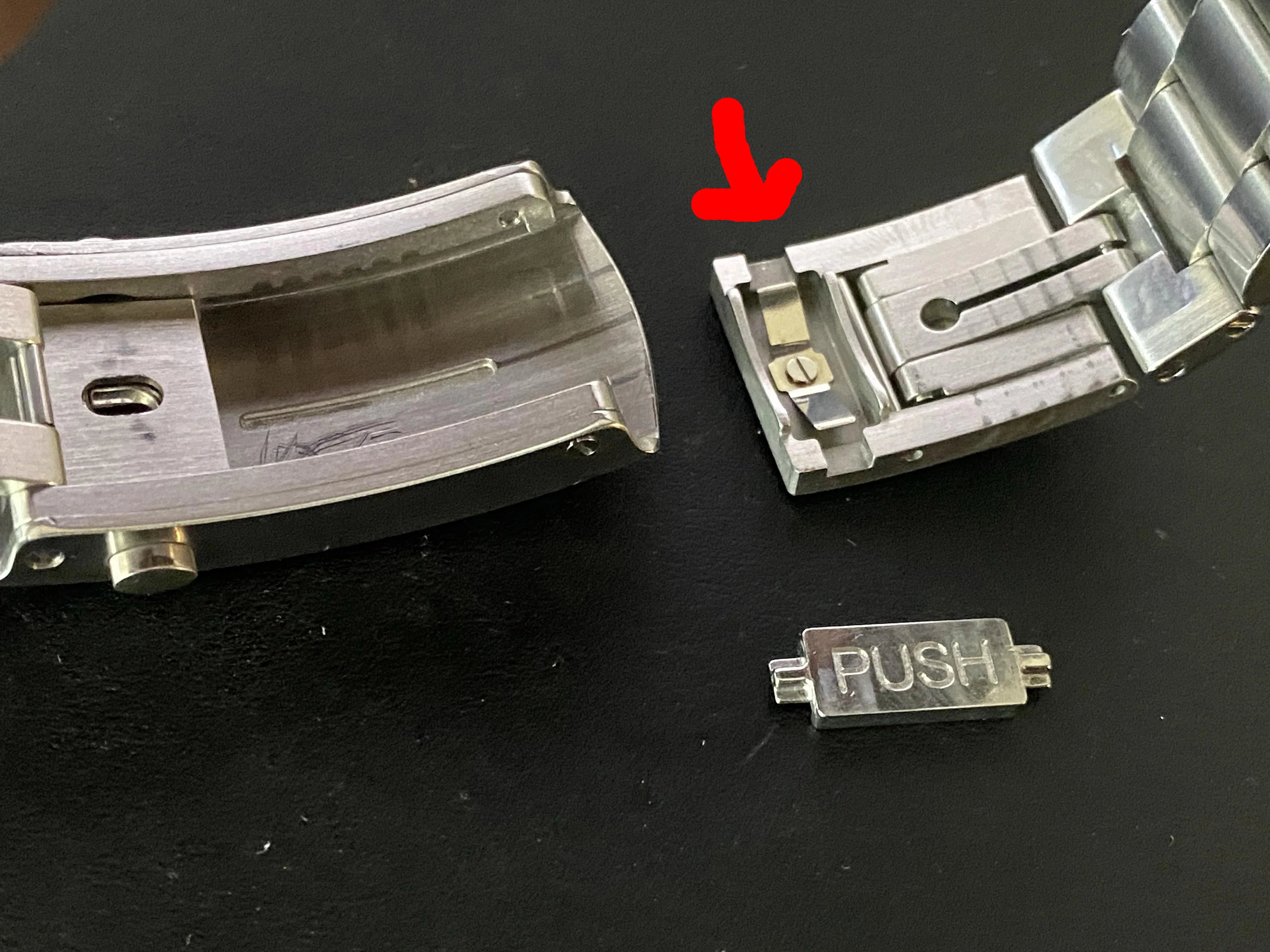

Though I haven't heard of this specific failure, it's a relatively simple design and there's this prong underneath the PUSH button held on by a rivet that acts as a spring which pushes the PUSH button up and keeps the two teeth locked to the side of the clasp. The prong is the only logical reason why your PUSH isn't working anymore and it's either bent, damaged, or jammed on something.
If you haven't worked on this clasp before and/or aren't good at putting things back together, I wouldn't recommend taking this clasp apart if you're considering it. This clasp, once you remove the 4 screws keeping it together, has the comedic effect of completely falling apart. 15 parts will fall out all at once. Putting it back together is also a delicate sport too.

Not my photo, but here's a pic of the prong I'm talking about:
Thank you so much for this photo, as well as the information re: the clasp being a pain to reassemble! I probably would've tried to take it apart if you had not cautioned me about reassembly.
Looking at this picture, it feels as if the left prong is completely locked in place. Per @Scarecrow Boat's suggestion, warm water and detergent seemed to loosen it temporarily and allow me to make adjustments when I pulled the "push" button to the side and then pushed the button, but it felt solid as a rock again after cooling off...

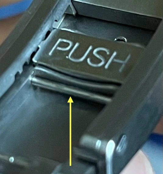

An update: lifting up on this bar allows me to manipulate the push button for a few clicks. Thought I’d share in case someone else with this problem stumbles into the thread and needs to adjust the clasp in a pinch. It is still a mini ordeal to adjust it, but at least it’s not stuck in one position any longer.

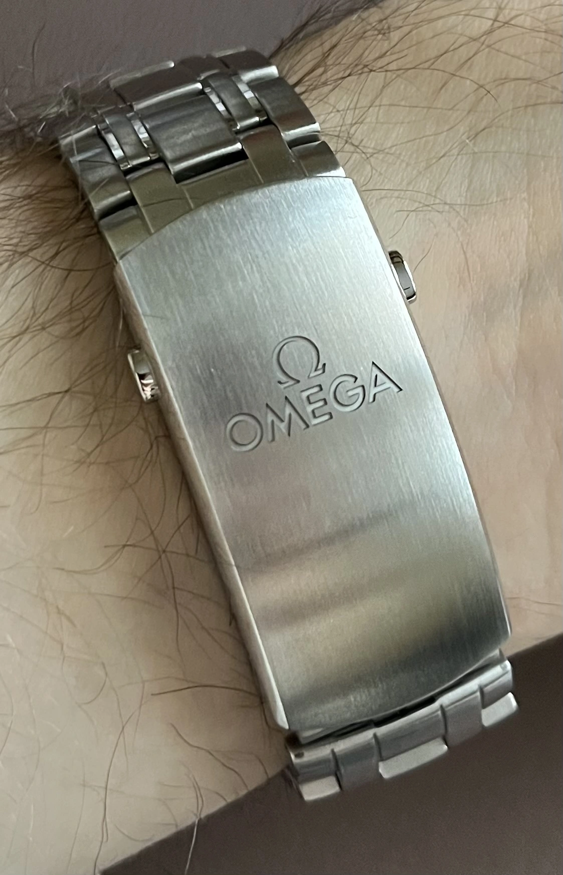

Here’s the new clasp. Thanks again to everyone who offered their thoughts and insights.
