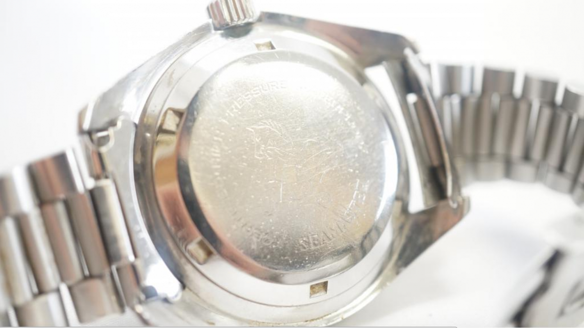

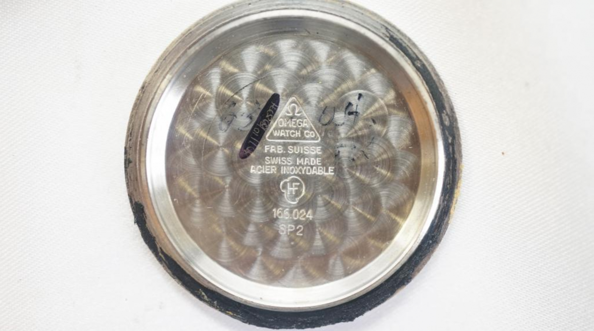

    I'm looking at this SM300 166.024 "Big Triangle" and everything (to me) checks out as appropriate – the aging of the dial, case, and hands; the color and consistency of the lume; all the fonts on the dial and bezel. However, the inside of the caseback has a layout of text unlike any other legitimate example I have seen (and it doesn't list the correct model reference number). Also, my eyes may be playing a trick on me, but the sea monster's proportions on the back look a little bit off. I used Arne's vintage SM300 guide as a reference for the fake-busting along with my own knowledge.

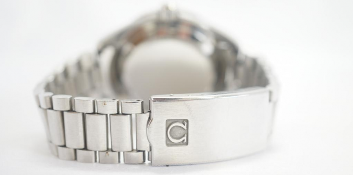

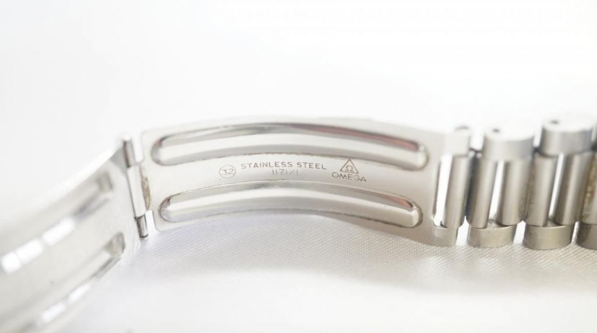

    Isnt the 1171/1 a modern bracelet?
    airansun, OMGRLX, ffej4 and 1 other person like this.

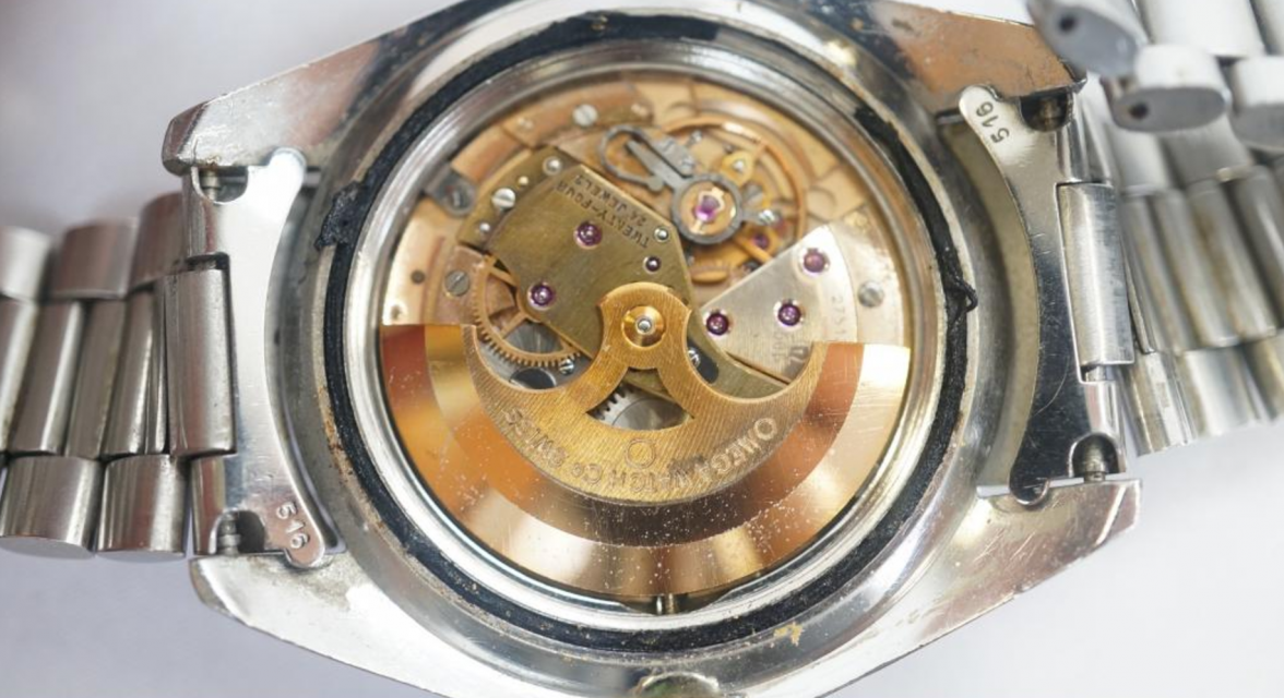

    I would note that the movement is very tired looking, with multiple hues and a regulator cranked to one side as well as a rotor which has seen the inside of the case back.

    I would ask the seller for clean full frontal of the dial and back. They're angled in such a way that nothing on the back can be read and can't check for stubbies on the dial. Index ends near crown are hidden and left side a little out of focus.
    Just the way you want it to hide things you don't want seen

    Yes, it is. The combo with 516 endlinks is a little weird though. My guess is that this watch was serviced (maybe by Omega, maybe by an independent) sometime in the 70-90s, and they chose to swap out the old 1039 bracelet for a fresher and sturdier 1171/1. They also probably swapped the movement for another one during service as well (a '68 cal. 565 doesn't quite add up with baton hands from the '62-'64 era and the early beveled caseback). Looking at the dial, I'm guessing it experienced some pretty bad water damage back in the day, hence a movement swap and new date wheel.
    My conclusion is that this is likely a frankenwatch that was serviced some 20-30 years ago due to water damage (just look at that dial) and during so it experienced a movement and bracelet swap.
    The 165.024 caseback I still cannot explain.

    The case back is 166.024 which is correct for the date model.

    That's a 6? It looks like a 5 to me, but it could just be the reflection drowning out the lower left-hand portion of the 6. Looking at it closer I can see how it is indeed a 6. That's a good catch. Thank you!
    Edit: I an definitely see that it's a 6 now that you mention it. The curvature at the top is identical to the 6 next to it, and a 5 wouldn't have a top curve anyway. Thank you again for pointing that out!

    6. You mention that the caseback is beveled. It is not! And that's correct for a 166.024 caseback.
    So, yes the hands are not original to the watch, but the rest is legit IMO, i.e. correct parts for a 166.024 (besides the 1171 bracelet)...but the condition...:thumbsdown:
