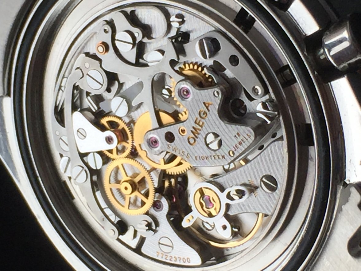

    The 861 stamp on the main plate doesn't look right:
    [​IMG]
    Here's what it should look like:
    [​IMG]
