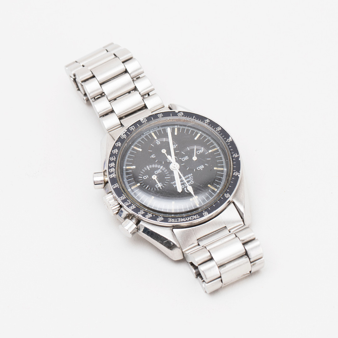

Hi all!
My first entry here, I've tried the search function but hope that your combined knowledge can help me better.

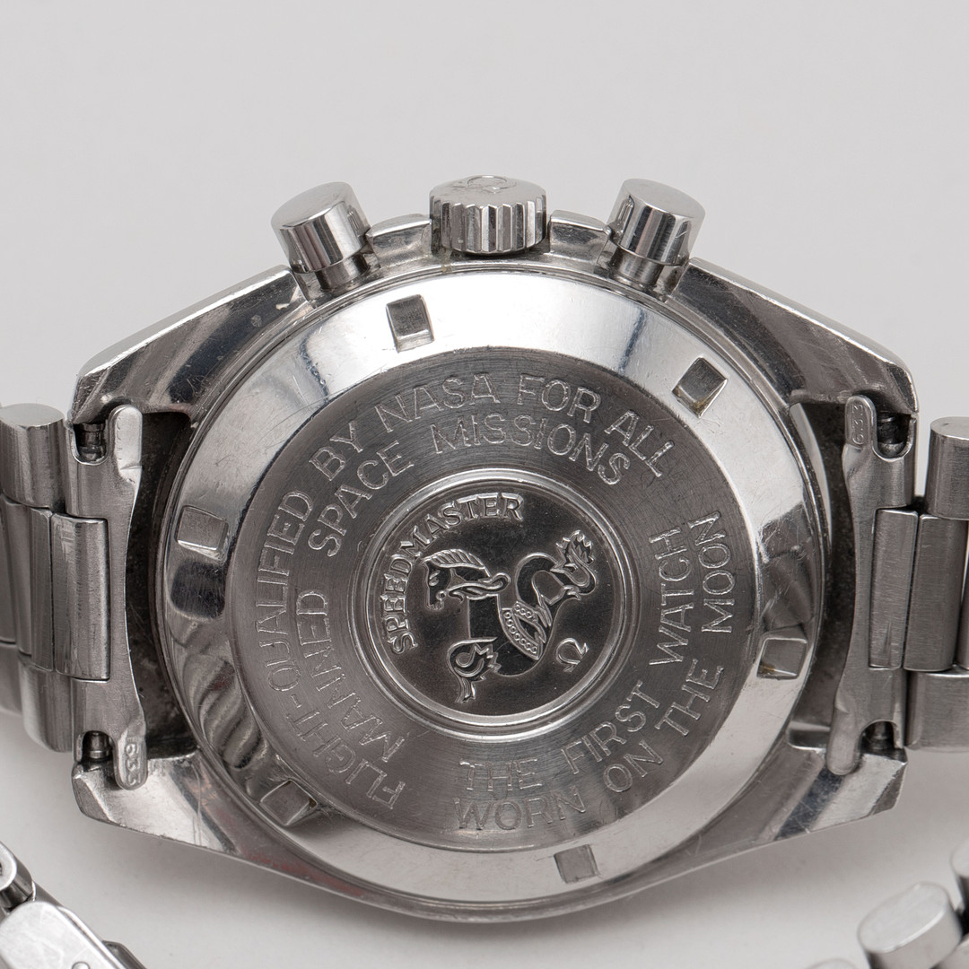

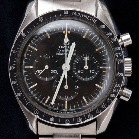

I'm looking at a Omega Speedmaster Professional 145 022-76 ST, with serial number 31318674 (picture below) and trying to find out the production year. Depending on chart and ideas I've got the suggestions: 1969, 1971 and 1979.
Perhaps anyone here can be more precise?

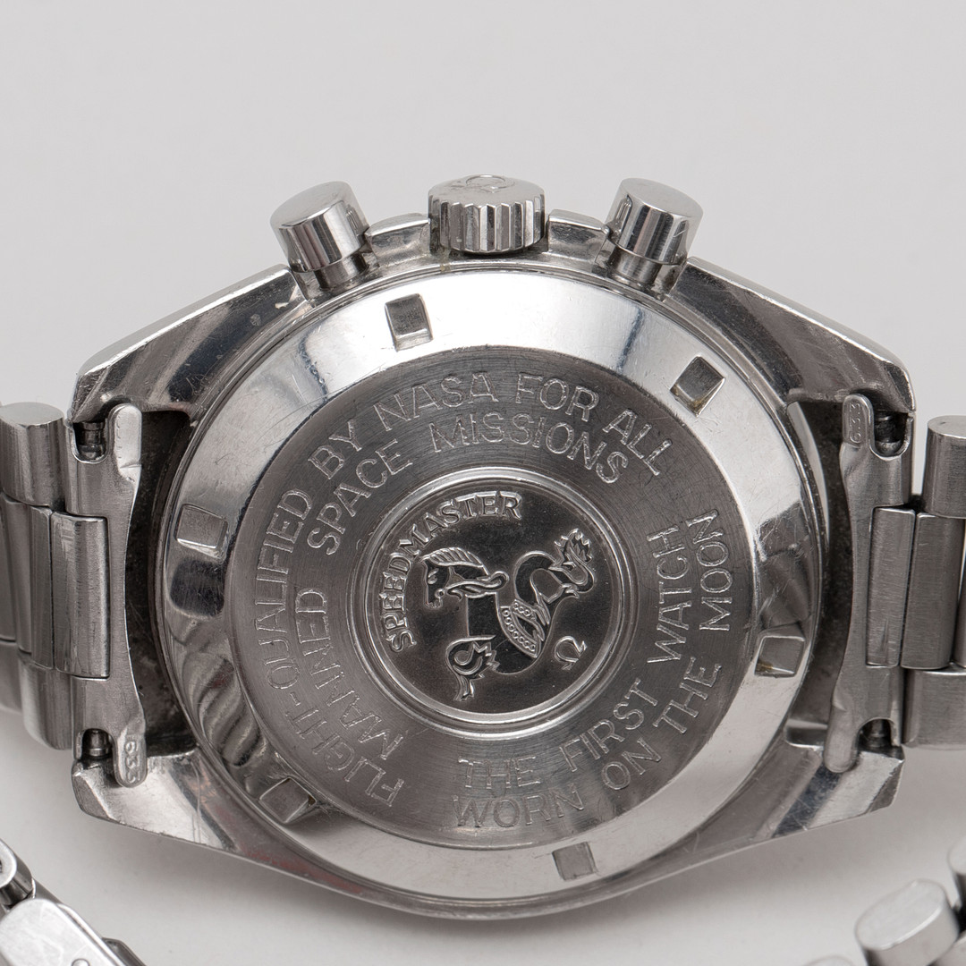

The 31xxx serial can by all means not belong to a 76-iteration. The Watch in question has a Stepdial, so latest a '74 but that won't either match a 31xx. Did you see the caseback inside? does it say 145022-76? This one is more likely a 71, maybe with wrong caseback but for sure with a wrong hour/minute-handset (MK-Series Hands) and a (not a showstopper) Drop End Chrono-hand used on earlier versions, up to 145012-68.

Thanks a mill for your reply!
The watch is up for auction at a respected auction house in Sweden, but not at all specialized in watches. More antique furniture, art etc.
I don't know how they figured the reference 145 022-76 ST. I also found that strange with the serial number.
Given all the details about the stepdial, handset etc. what would your best guess be on the correct reference?
Thanks again!
@mr_yossarian @Servius

As mr_yossarian said, most likely a -71…

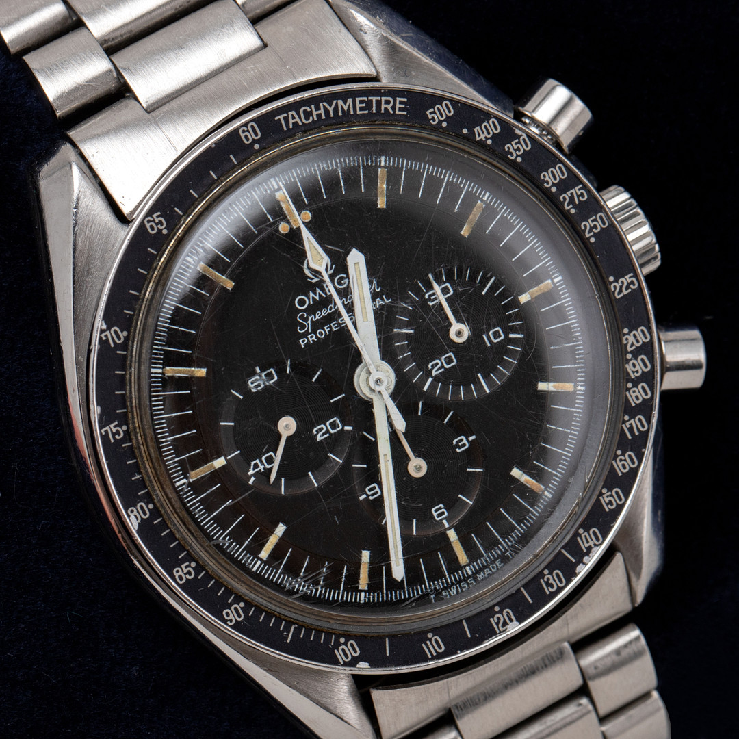

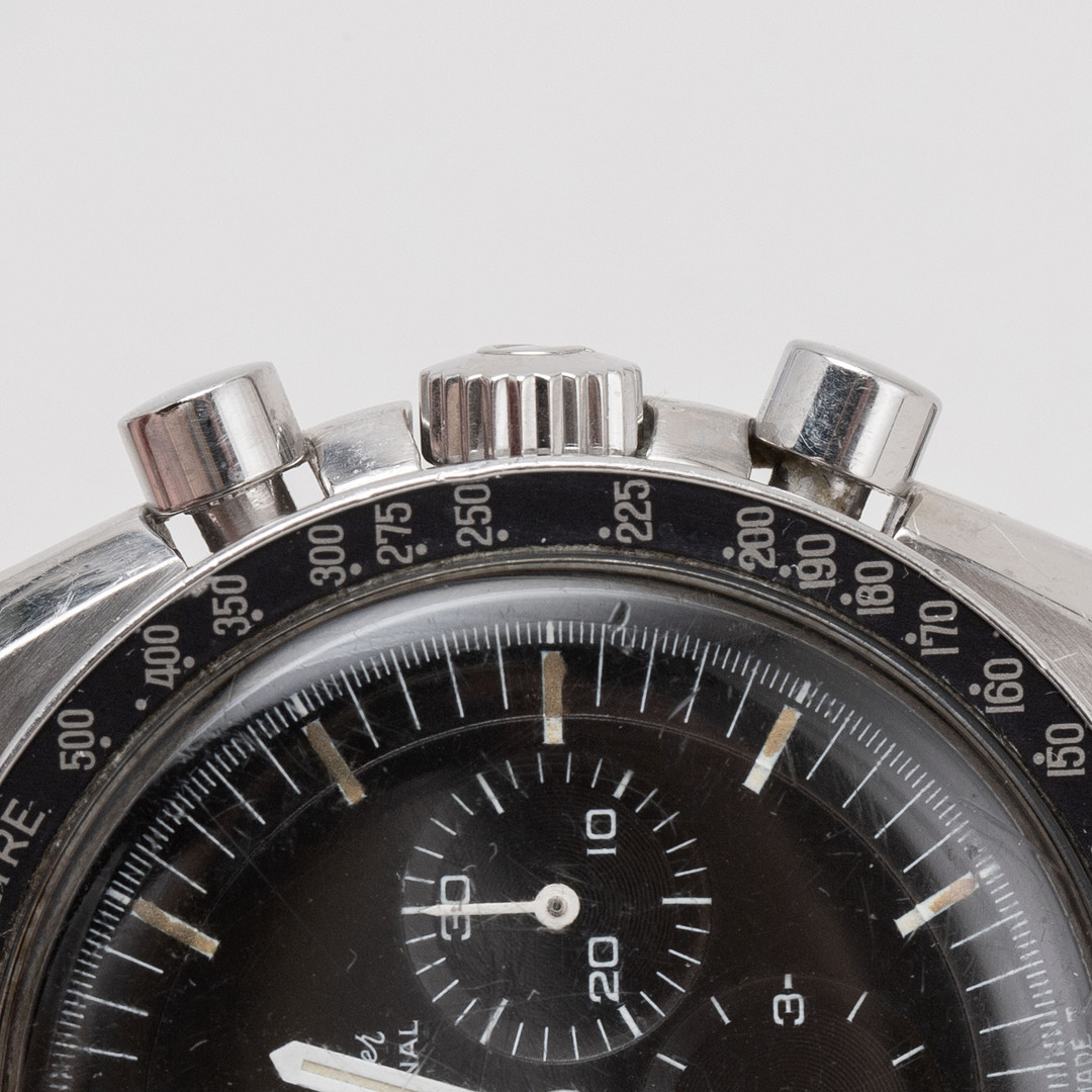

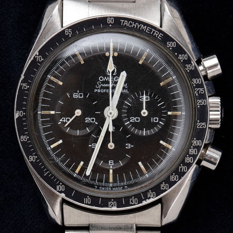

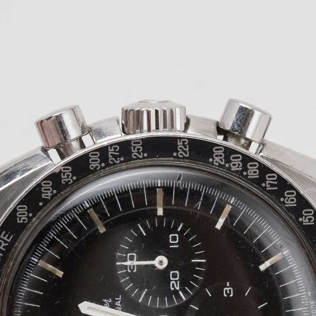

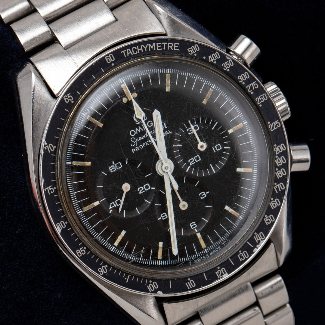

Do you have any other pics? Does this dial looks brownish or I have to worry about my screen rendering / eyesight ?

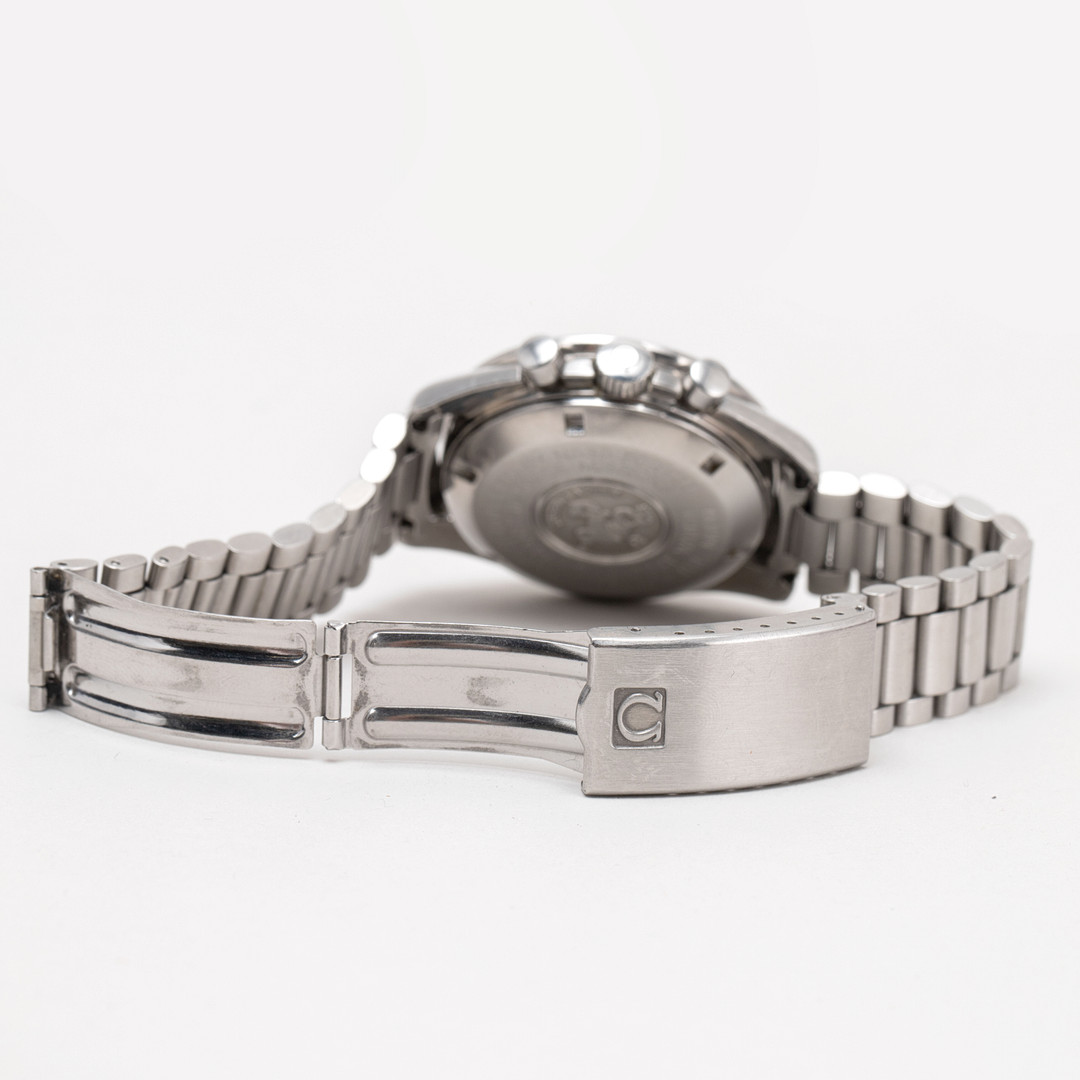

Sure, here we go!

I was thinking of bidding, now the price is right on the line what could be fair. And given all the uncertainty around reference and parts, I am hesitating.

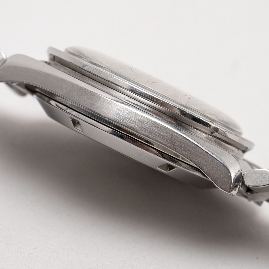

Obviously the dial lume is in quite bad condition also
Case is quite soft and especially the lower right lug has lost its definition due to polishing IMO
