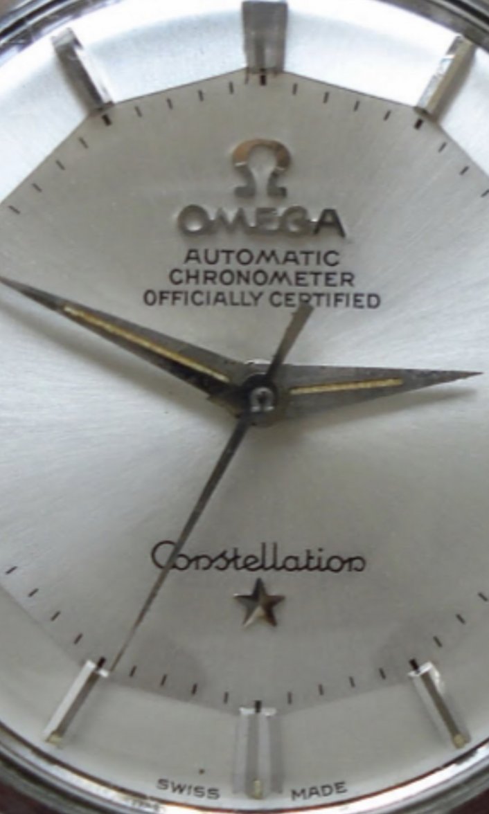

  13. JwRosenthal Apr 19, 2019
    14,860
    40,074
    Lettering and Star should look like this.
    trotters likes this.
  14. JwRosenthal Apr 19, 2019
    14,860
    40,074
    The “MOY” means you could draw a line down the middle and it would cut through the automatic, chronometer, and officially in the same place
