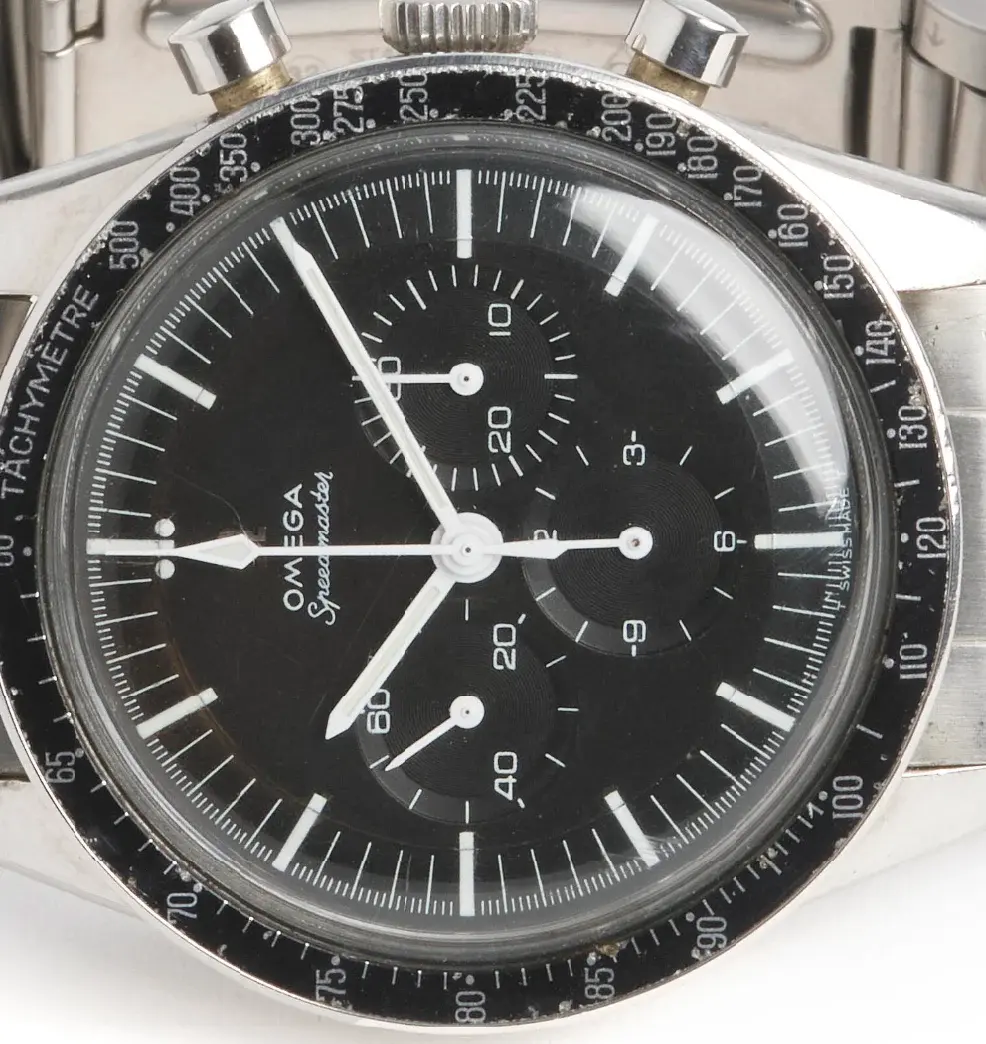

Dear experts,
I've stumpled upon this Ed White ref. 105.003-65, but the dial and hands looks way to clean to be original from '65.
The add says nothing about service dial or hands.
Wouldnt you agree something is up ?
Thank you as always for the valuable inputs.
All the best
- Martin
10,796
16,807
Yep. Lume removed and hands replaced. Buy accordingly ie about £/$1-2k lower than a nice one. The serial suggests it actually dates to 67-69. Hands can be changed and dial lume can be redone.
10,796
16,807
Oh I just noticed, the crown looks a bit skinny to be right. Maybe.
2,628
5,894
And not the period correct bracelet/endlinks...
I would skip on this one!
Even with a very low price.....but thats me!

I'd suggest asking for a better photo of the dial before buying. It's difficult to see flaws in a photo that is so oversaturated, and this is a common dealer trick.
1,206
3,646
This. That auction site always do crappy pics.
Ask for images in natural light.....

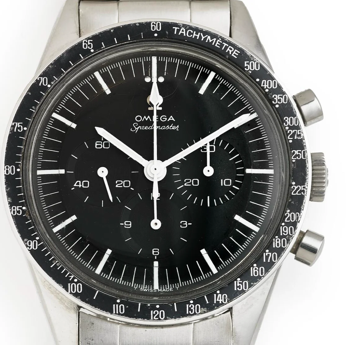

Case looks nice from these pics.
Dial may not be worth reluming.

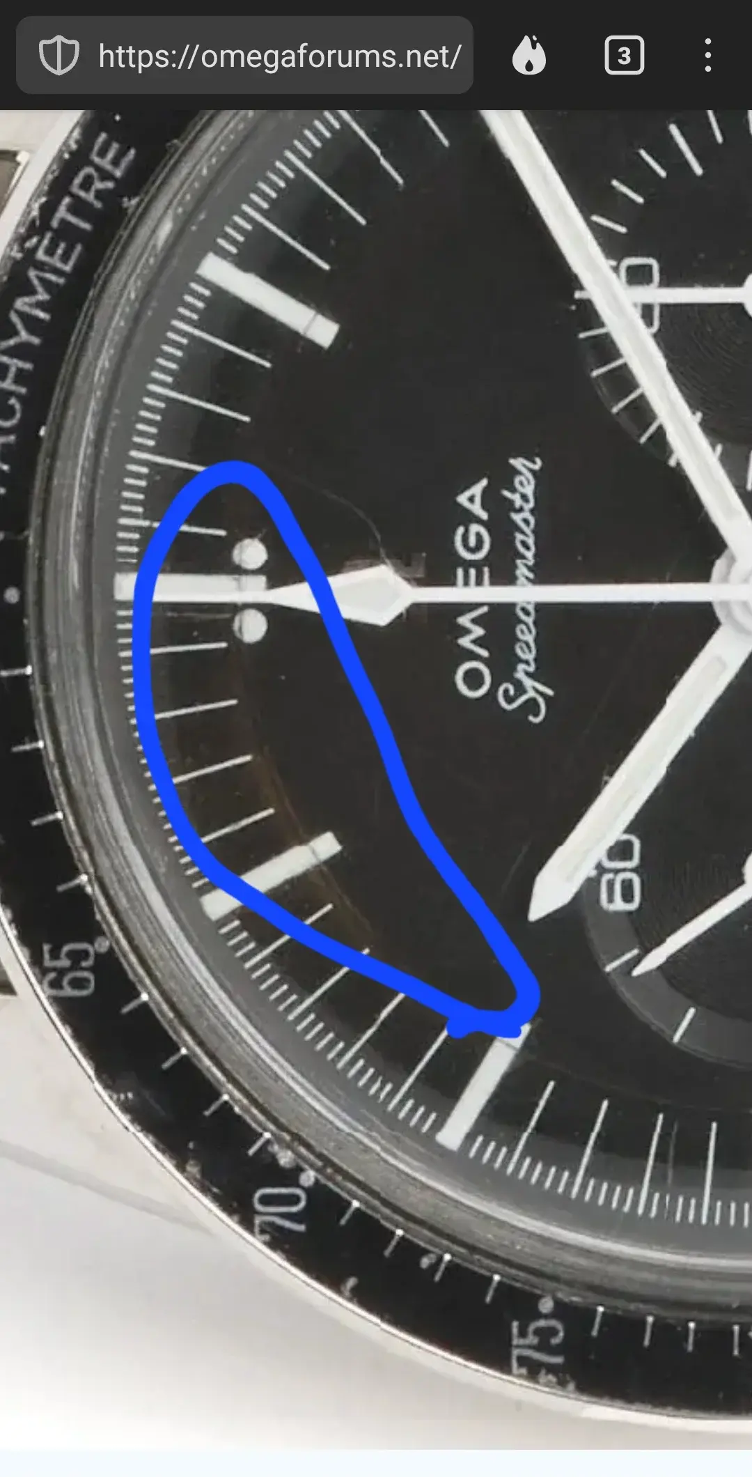

Thanks for the input, however not really sure what you are trying to highlight ?
5,537
9,475
If you look closely, you'll see some dial deterioration along the step.

The auction site says the hands are later, so I'd read the listing first. They also point out the dial discoloration.
