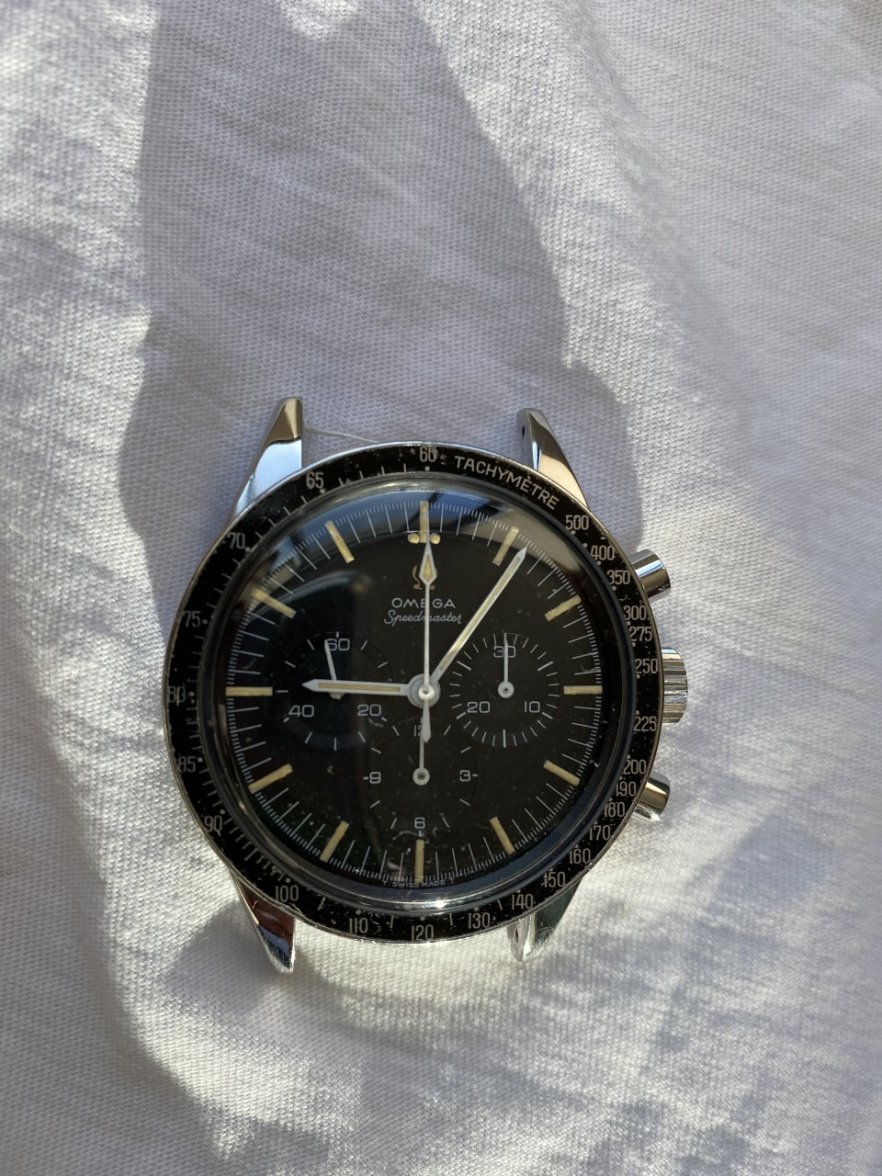

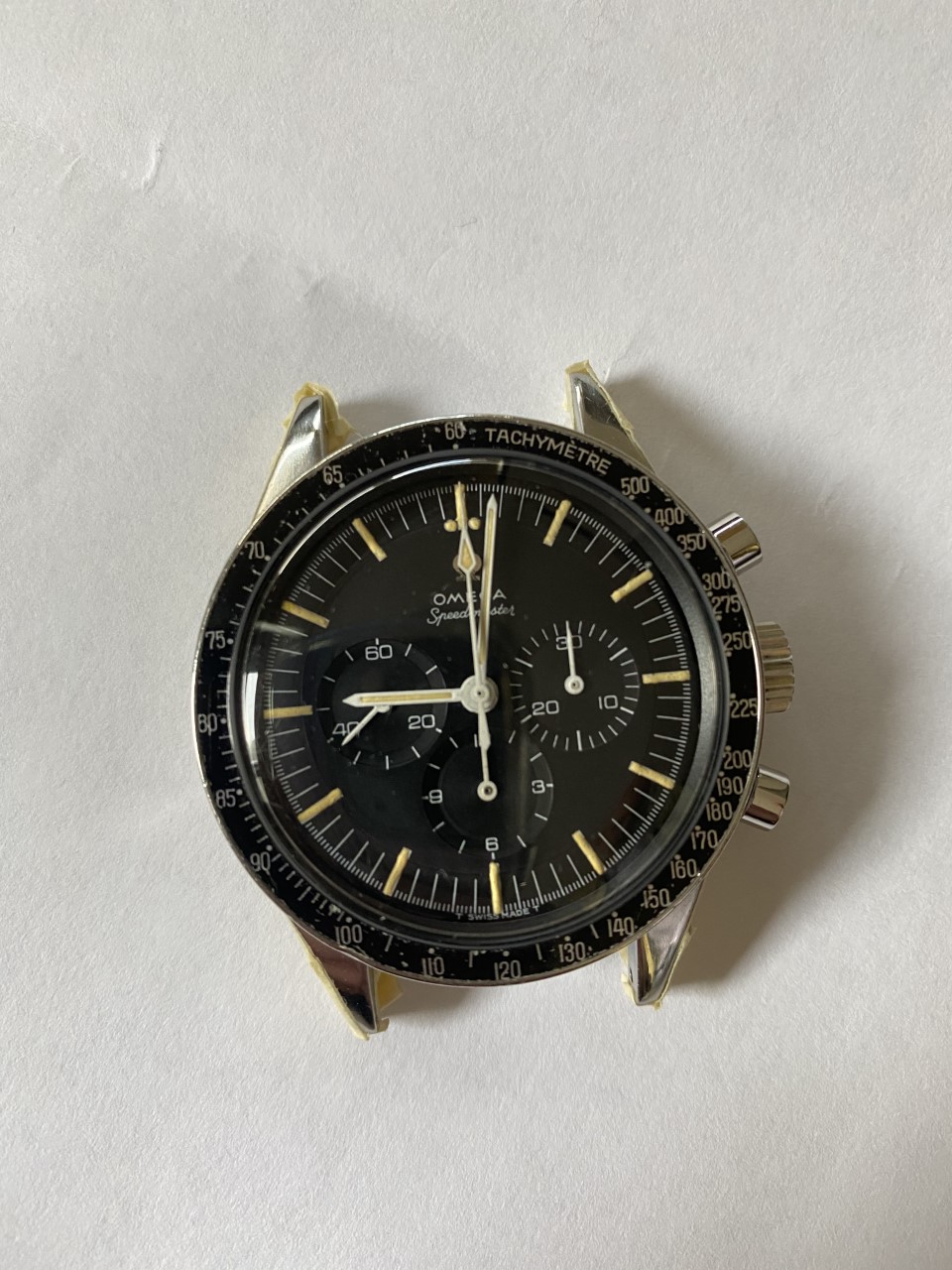

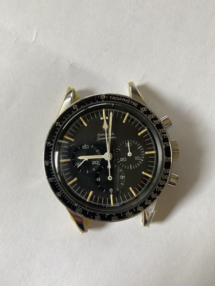

COVID-19 has put me on an extended vacation, and this has forced me to confront those watch projects that have been constantly bumped to the back burner...

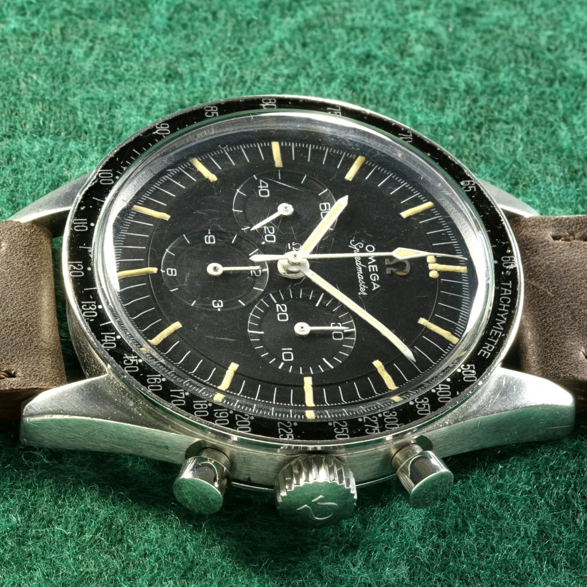

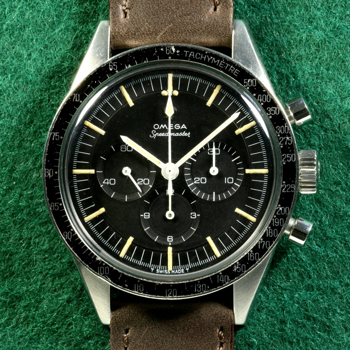

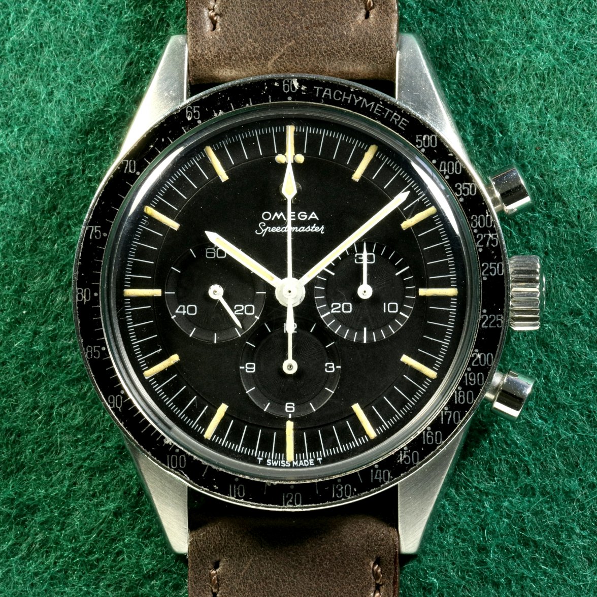

To wit: note the brushed, angled, Rolex-type finish that the top of these lugs have. I've seen this on many serviced Speedmasters, and of course, they never left the factory looking like this. The tops were a high-polish, and the sides were brushed, evidenced beautifully by MSN's pristine CK-2998, that we have all seen.

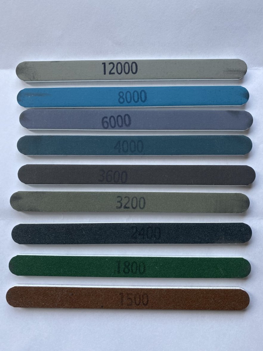

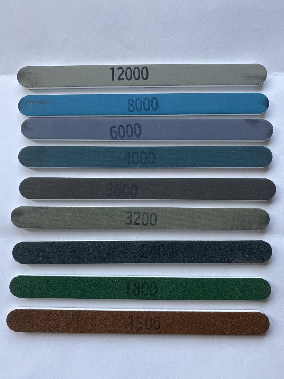

So, I took out my sanding/buffing sticks, and got to work. They ranged from 1500 to 12,000 grit.The goal was to take off the least amount of material to achieve the desired result, and this was not going to be accomplished using any type of machine.
I obviously wanted to use the least aggressive number that would do the job. So I tried 3200, it didn't work, and I progressively went all the way down to the 1500, doing about 50-100 strokes in a lengthwise pattern, until the angle finish was removed. Once that happened, I went back up in increments, from 1800, 2000, 2400, 3200, 3600, 4000, 6000, 8000 and finally 12000, checking with a loupe at each step of the way, insuring that the previous finish was removed. this took between 50 and 100 strokes per grit. About two hours per lug. Yup, I'm bored..

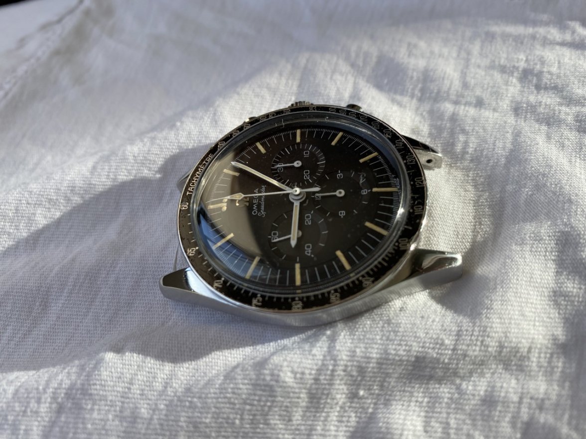

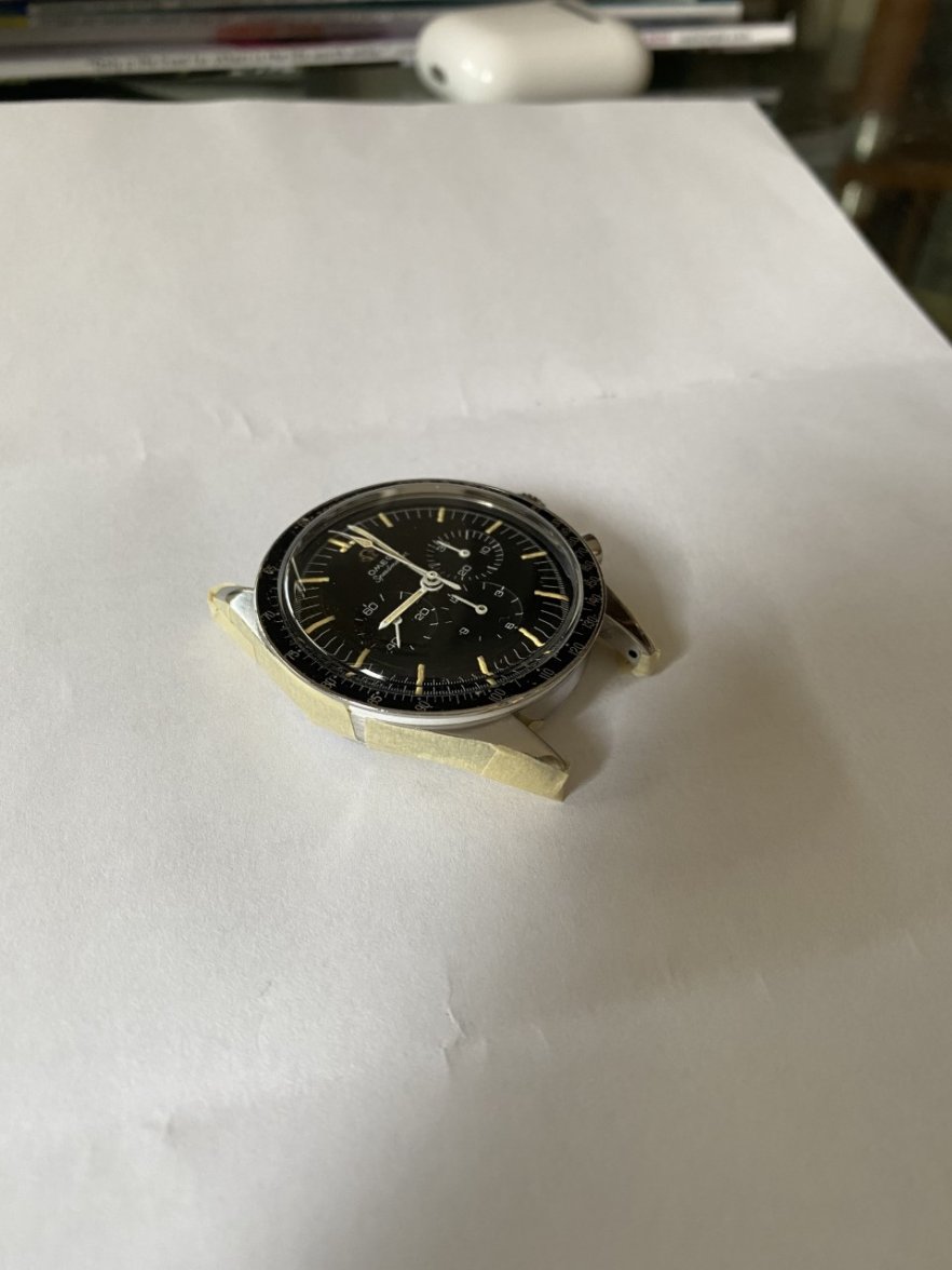

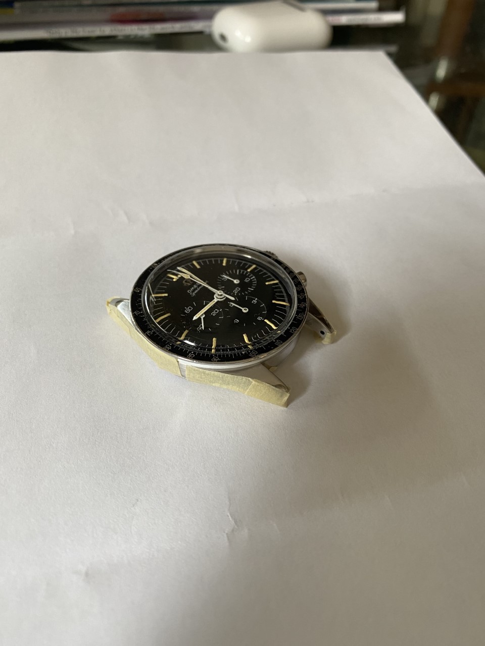

Anyway, here's where we're at: there are very fine, hair-like scratches left that will hopefully be removed with a cream polish. The lugs have been masked awaiting this, which I hope to finish shortly.
Will re-post after the final step. Thanks for looking.

First, there's the question of whether it's been polished, or worn down. If worn, and particularly if the wear is commensurate with the patina on the rest of the watch, the current trend, as you are already well aware, is to leave it. 30 years ago, that would be spiffed up without a hesitation, but apparently, those days are now gone.
So, if it's been polished, which would be incorrect for this reference, then I believe getting it closer to original spec is fair game.
Those that know much more about these things than I tell me that the original finish was applying with some sort of "lapping" machine. I don't know if this is accurate, or if you can find somebody who is skilled at applying that finish, but if you can, that would be my first choice, and I would not personally think twice about it. Particularly if the rest of the watch is in great shape, and the polished sides stick out like a fart in church.

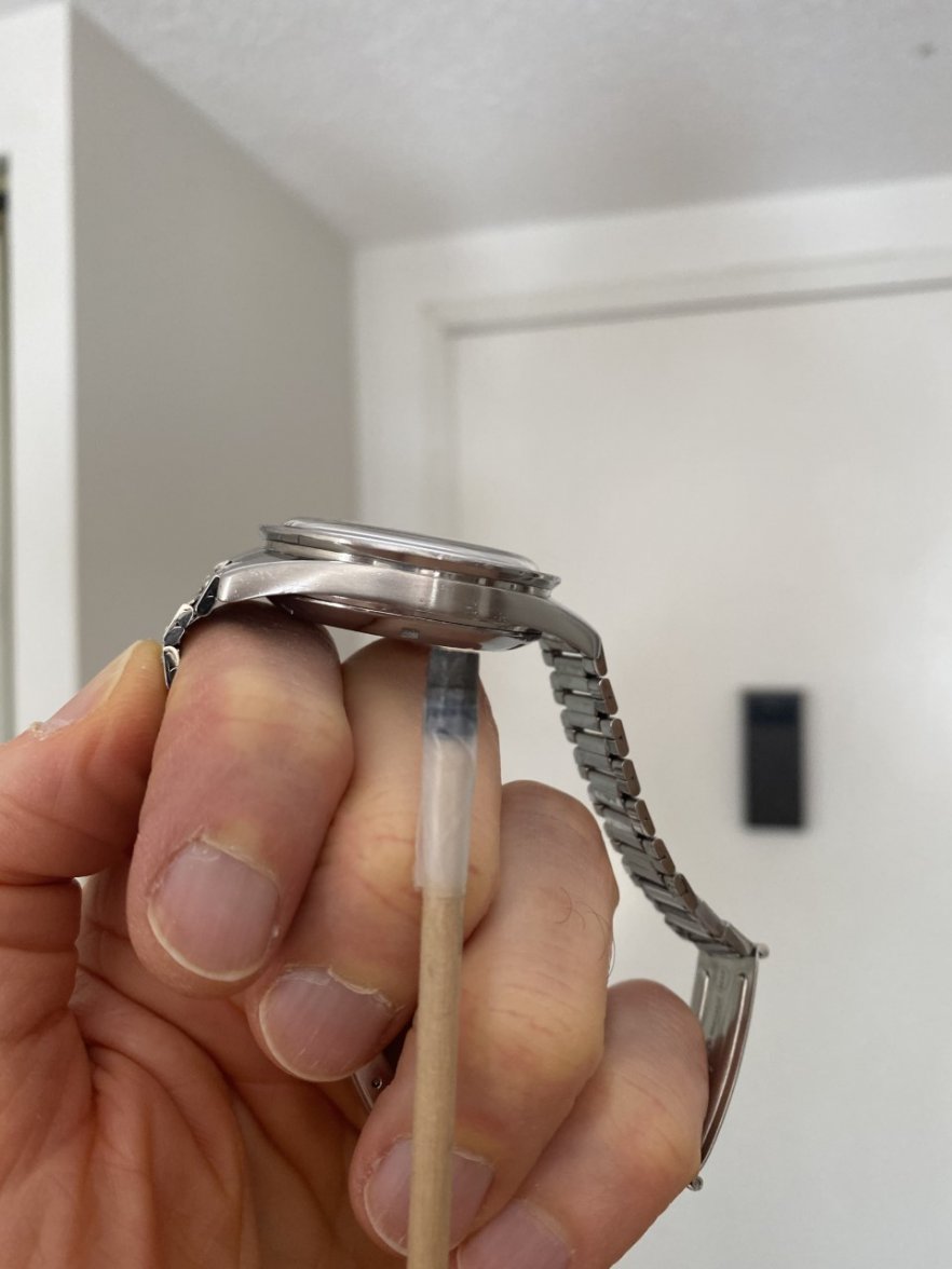

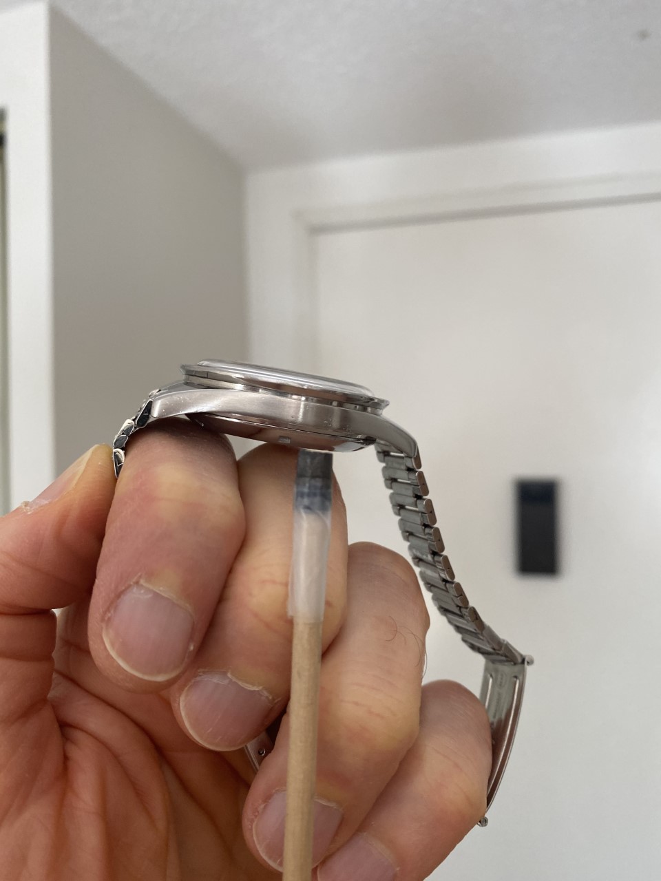

Anyway, how to do the sides...here's what I do: I buy automotive wet/dry sanding paper, 400, 600, and 800 grit. This seems to be the range closest to the original finish, you have to experiment as to which grit most closely matches the original finish, if there's any left as a reference.
Next, I cut about a 4mm strip, and carefully wrap it around, and affix it to the end of a chop stick. Then, with short, horizontal strokes, slowly re-apply the finish. You have to remember that, viewed from the side, the lugs dip down, so the tendency is to follow that curve. Don't do it. The original finish is completely horizontal, so you have to keep the strokes in that plane even as the lug dips.
I know many use Scotch-Bright pads with success, but for me, it's harder with them to navigate and control in tiny areas. Don't forget to mask all areas that can get scratched. Hope this helps.

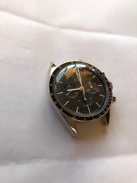

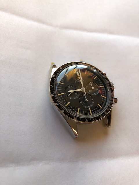

For reference, here is a Ed '64 case whose sides I re-finished years ago; my trusty chop-stick tool below:

I like your sticks 😀 Where did you buy them?
Amazon. Not expensive. Don't still have the original packaging, but I think they're called "Micro-Mesh."

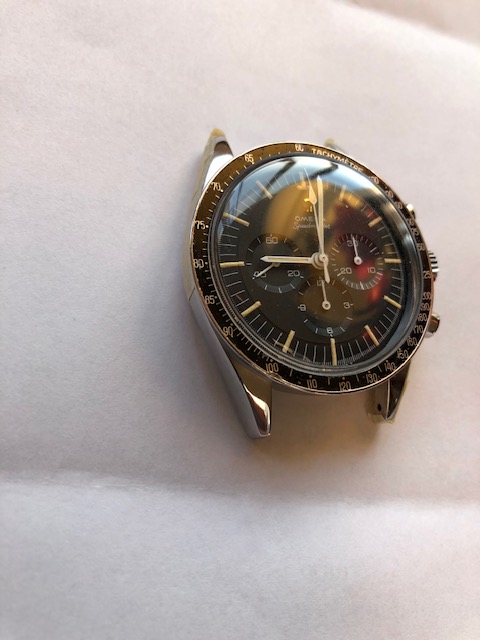

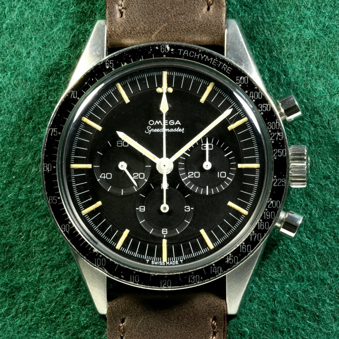

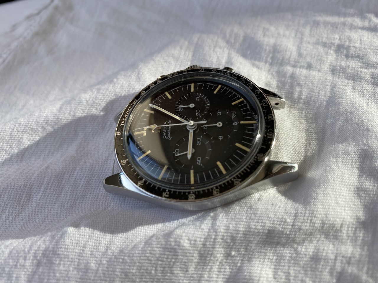

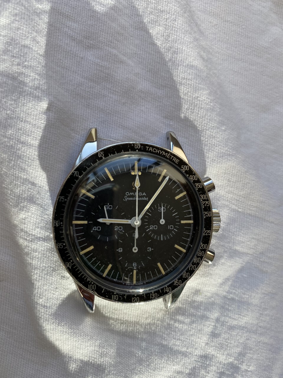

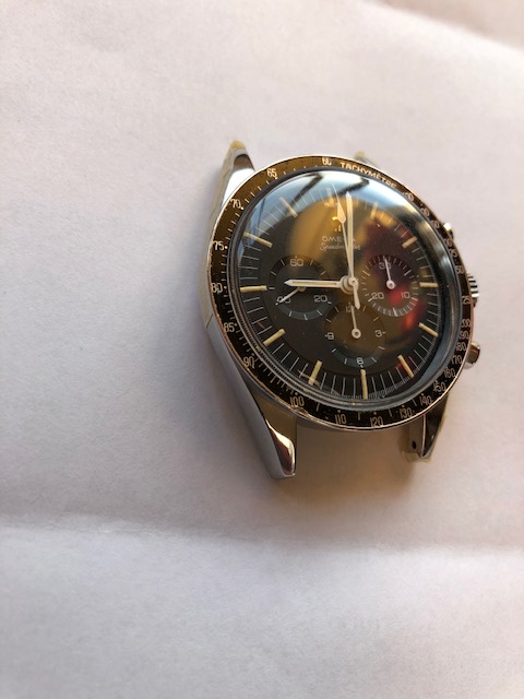

Okay, getting close to where I want it:
Before, for reference:
