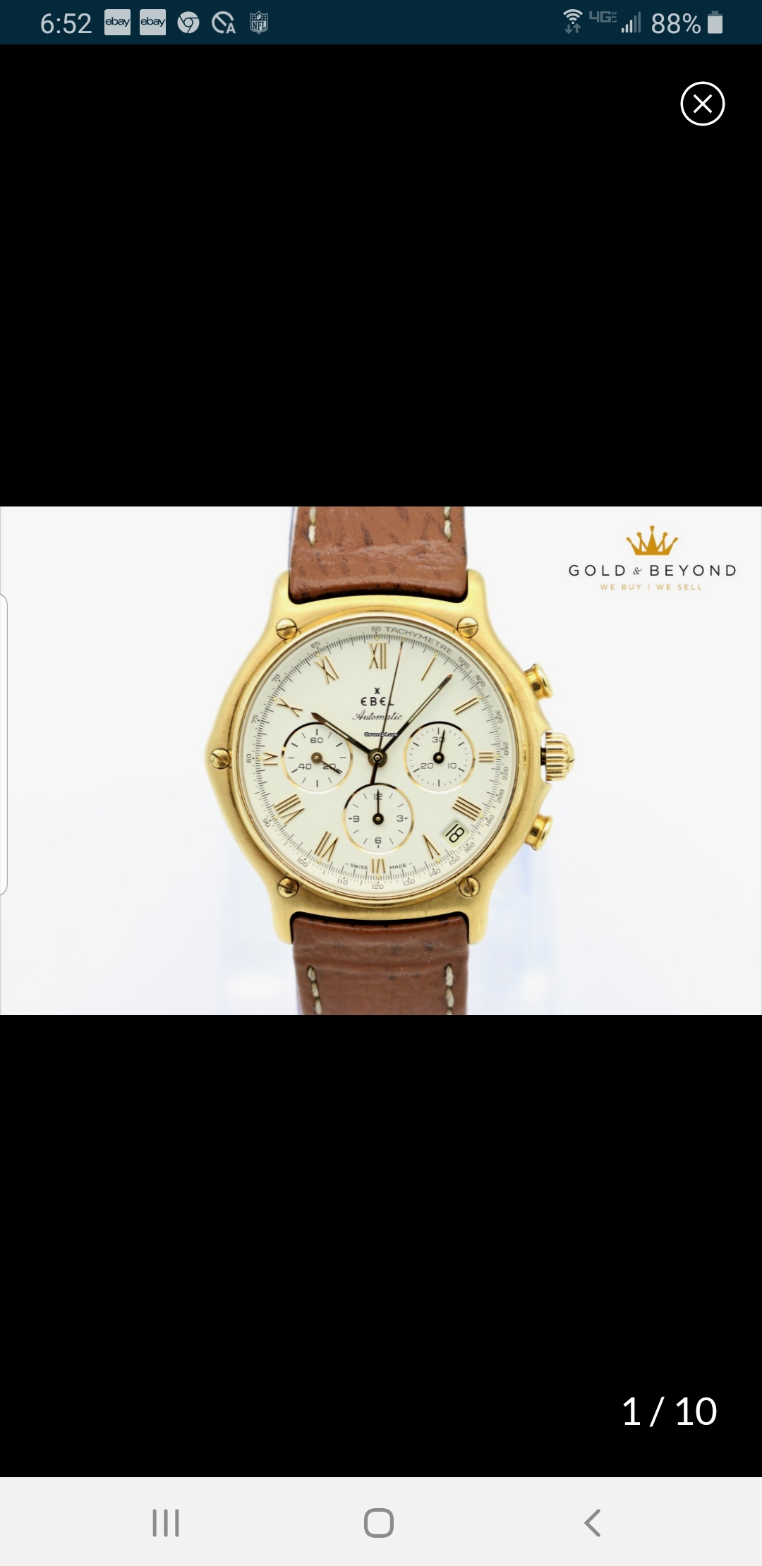

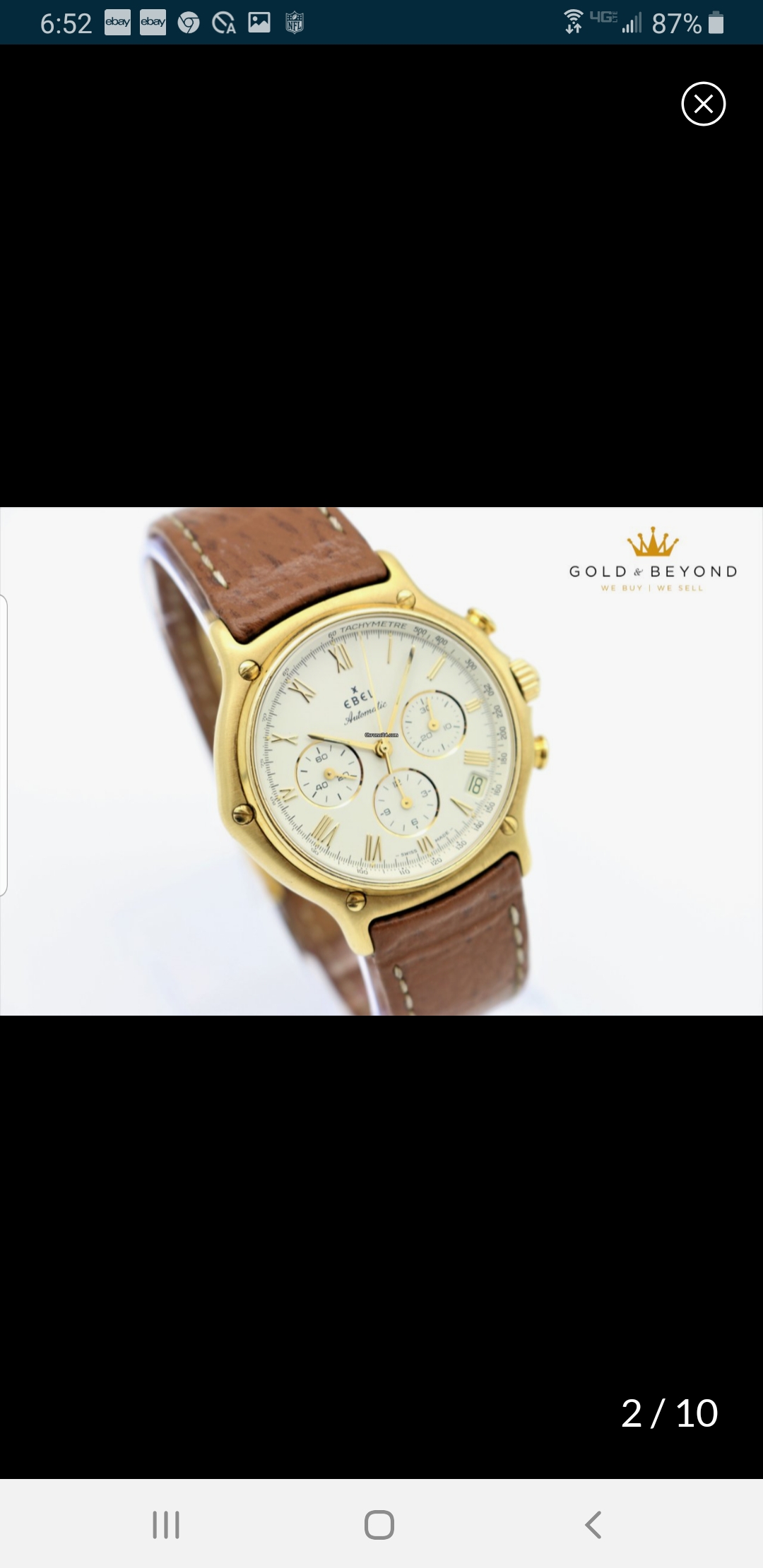

Im seriously considering buying this watch, been one of my grail pieces for quite some time, anybody like miami vice?? Anyways, zenith el premiro encased in a chunk of 18k gold.. I love me some ebel....

If it is solid 18k gold, this is a nice piece. If it is serviced, it is a good deal.

It is indeed solid 18k and has not been serviced but running good..

Unfortunately, running well means nothing with El Primeros, so you will want to factor in the cost of a service, if you plan to use it. That will likely set you back $500-700 with parts extra.
I sent one in for service last year that kept perfect time and had very good amplitude on a time grapher. It had been services 6 years earlier by Zenith and I had owned it for a year. According to my experienced watchmaker, there were a number of lubrication points that were bone dry and incurring wear. One of these was a post on the main plate that cannot be repaired without changing the entire main plate. I was lucky in that it was still usable.
