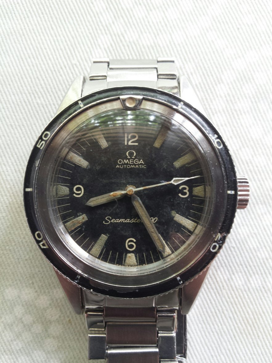

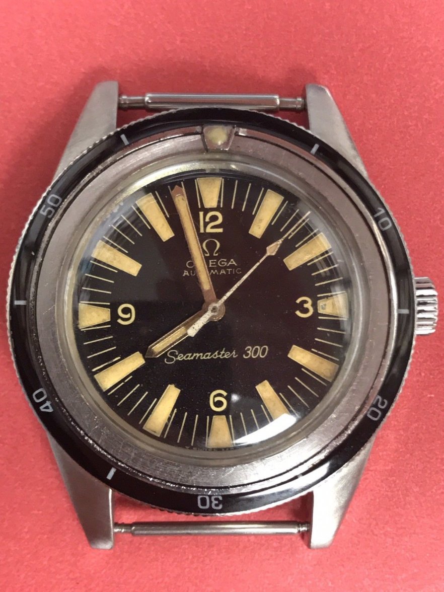

    Two days left. Already bid over $3,000. Seller claims it from a "watchmakers estate". Dial, bezel and hands are advertised as "original" but are all wrong but seller doesn't care. I sent seller pic of a correct 165014, see below, and he replied they look the same.::screwloose::
    Edit: notice gaps between eBay bezel and case. Case is probably aftermarket as well.

    Yep. Exactly the same.
    Now....where did I put my blasted glasses.....::confused2::

    Hands are wrong - easy to see from the lume grooves.

    Everything except the movement, and maybe case back, looks fake.
