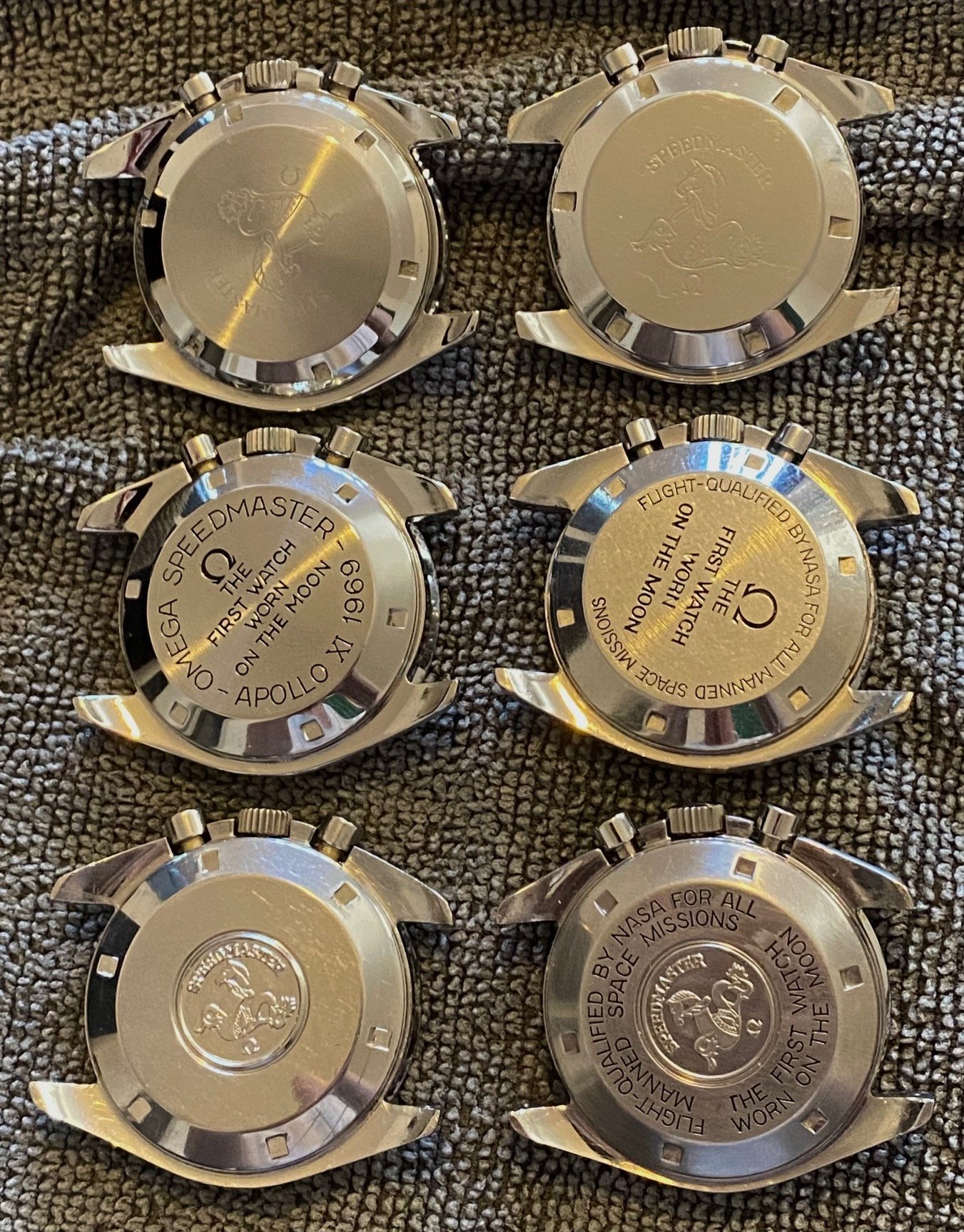

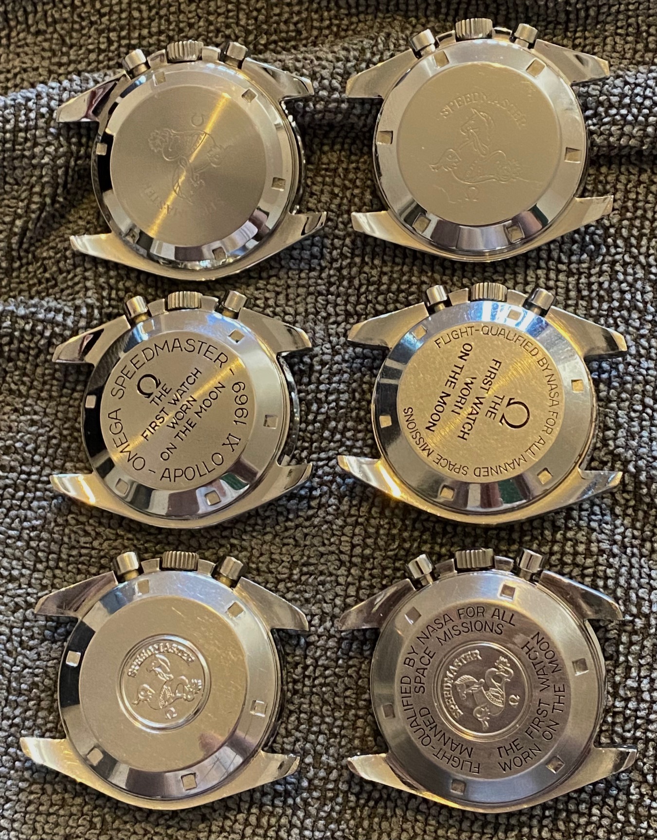

I would like to propose to your attention a rundown of the different case backs
fitted to early Speedmaster Professional series:

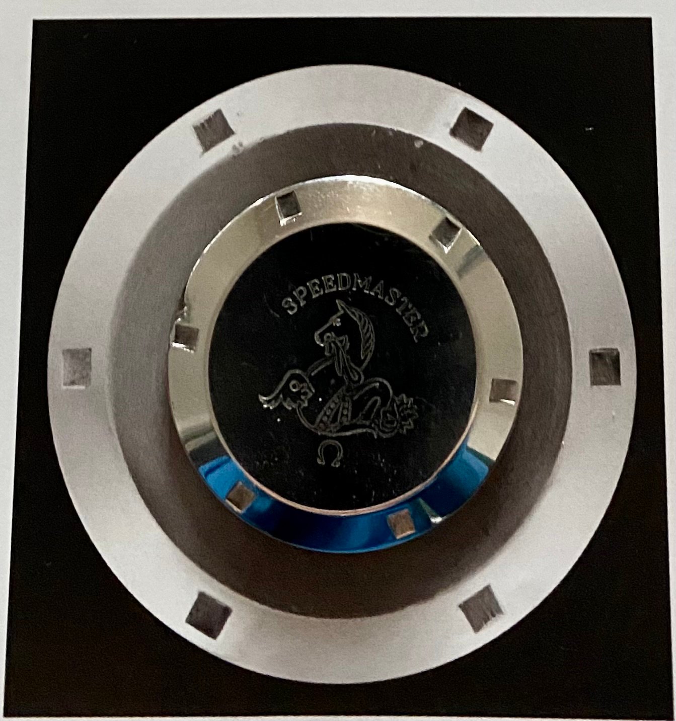

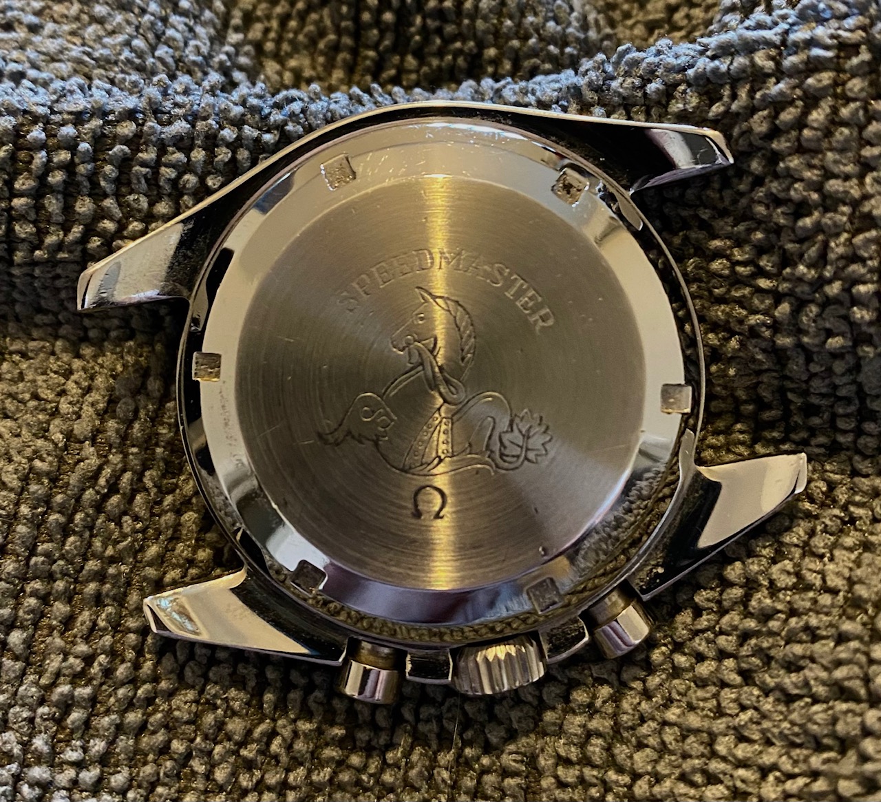

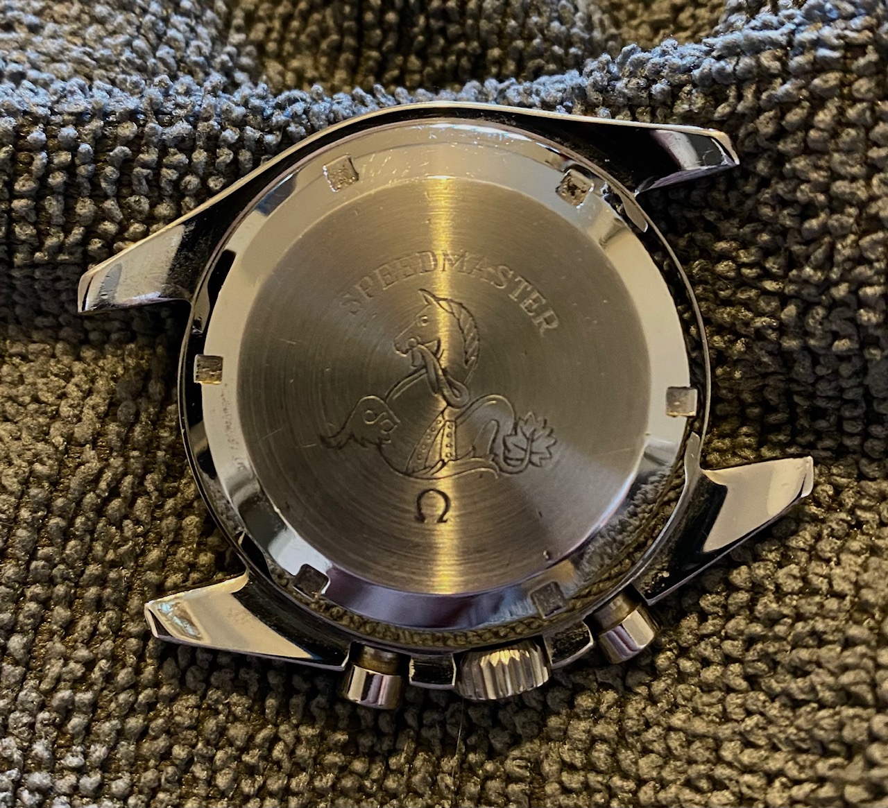

The first Speedmaster Professionals case backs with the large Hippocampus are distinguished by the fact
that they were equipped with a step, like the previous Speedmaster "Non Professional" references:
This type of case back was used on the ref. 105.012s from 1963 to 1965
From the ref. 105.012-66 on this step was removed.
This type was mounted since on the ref. 105.012 HF-66 and CB-66 and later on the ref. 145.012-67, 145.012-68,
145.022-68 transitional and 145.022-69 Pre Moon

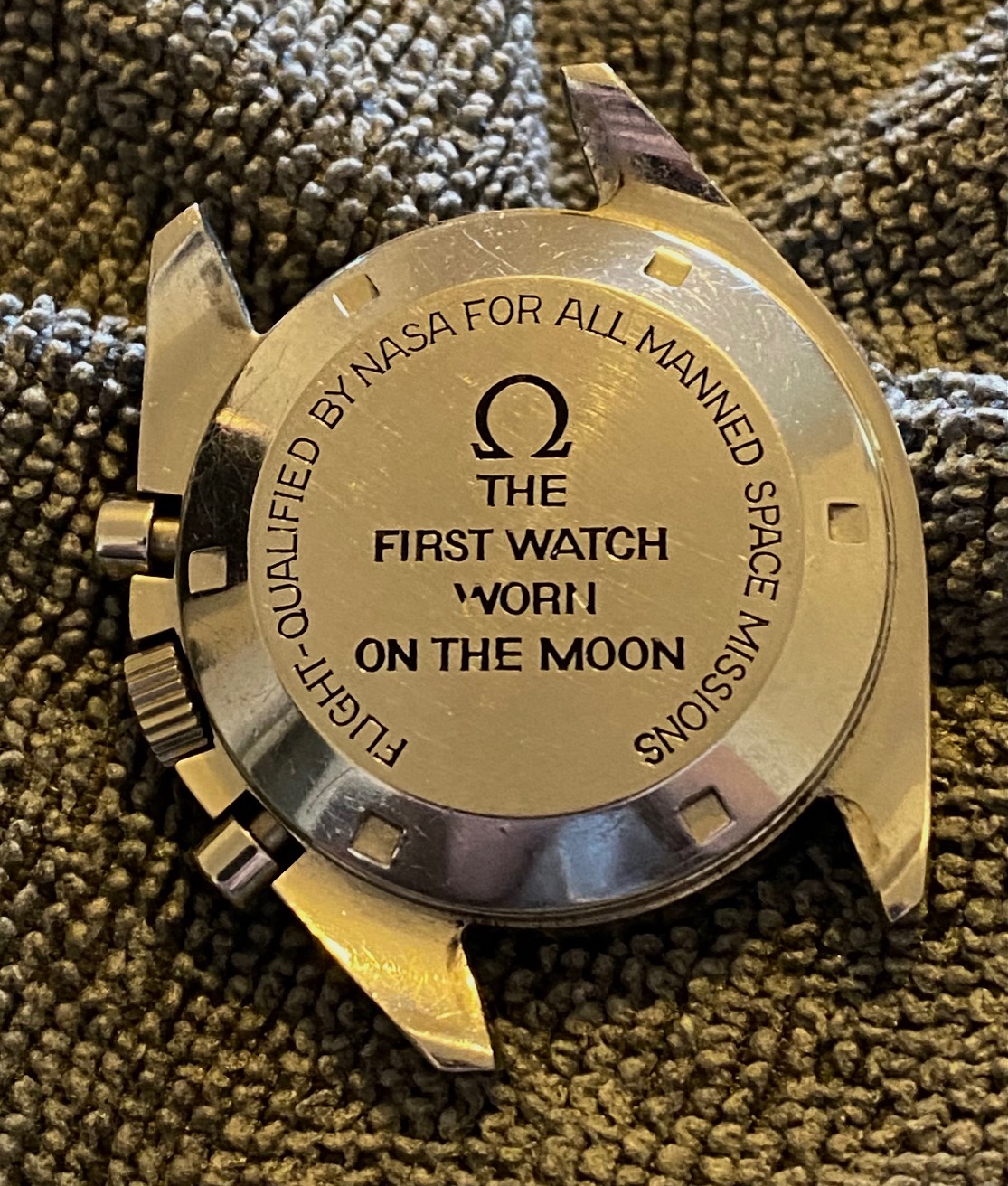

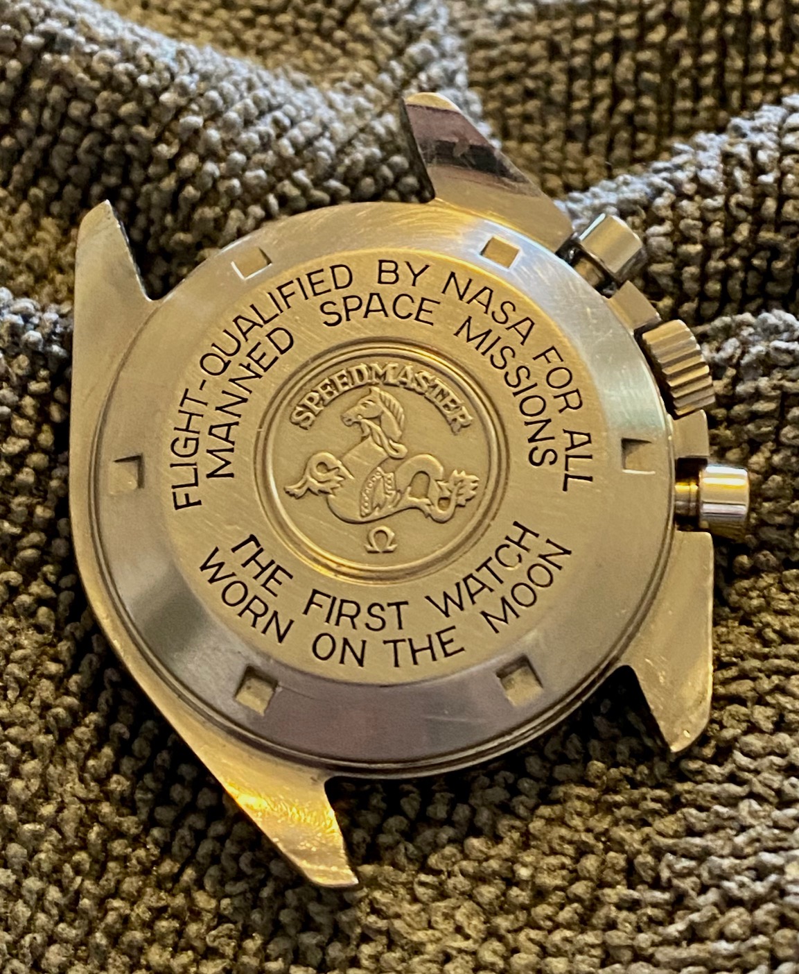

Immediately after the moon landing, the following case backs were used:

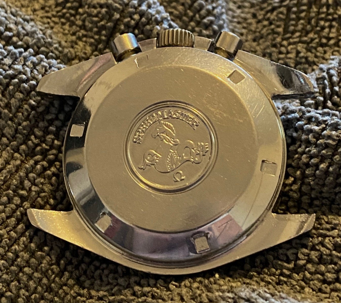

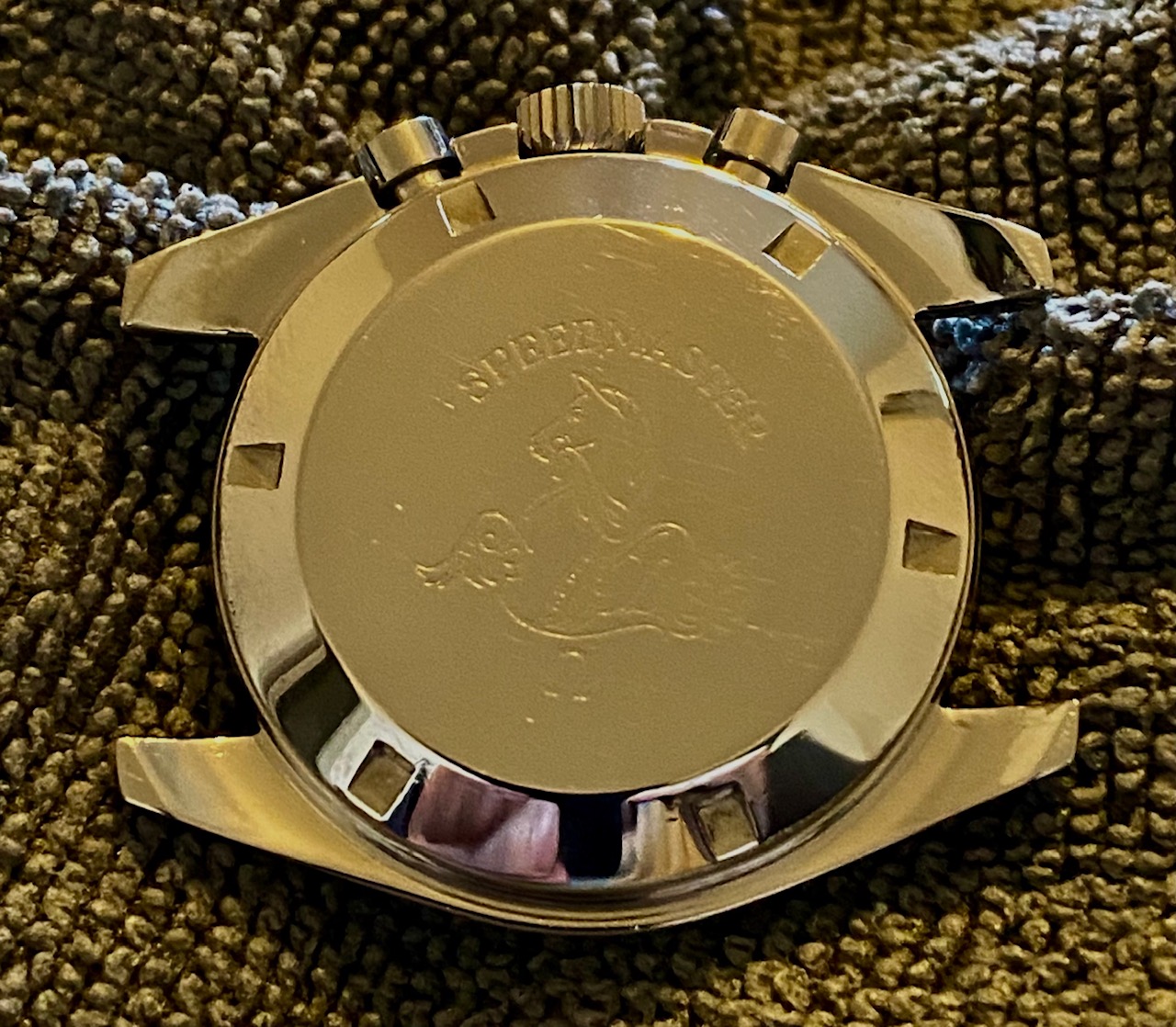

This is the case back of a ref. 145022-69 called "Straight Writing".

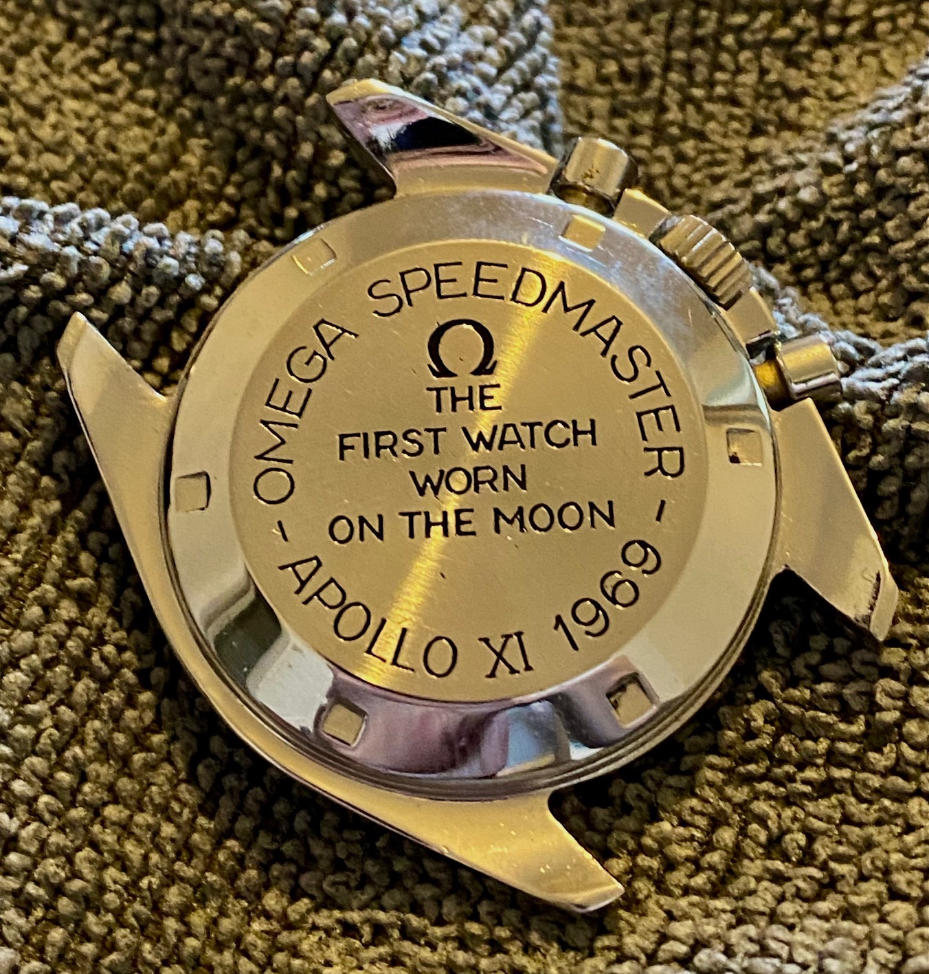

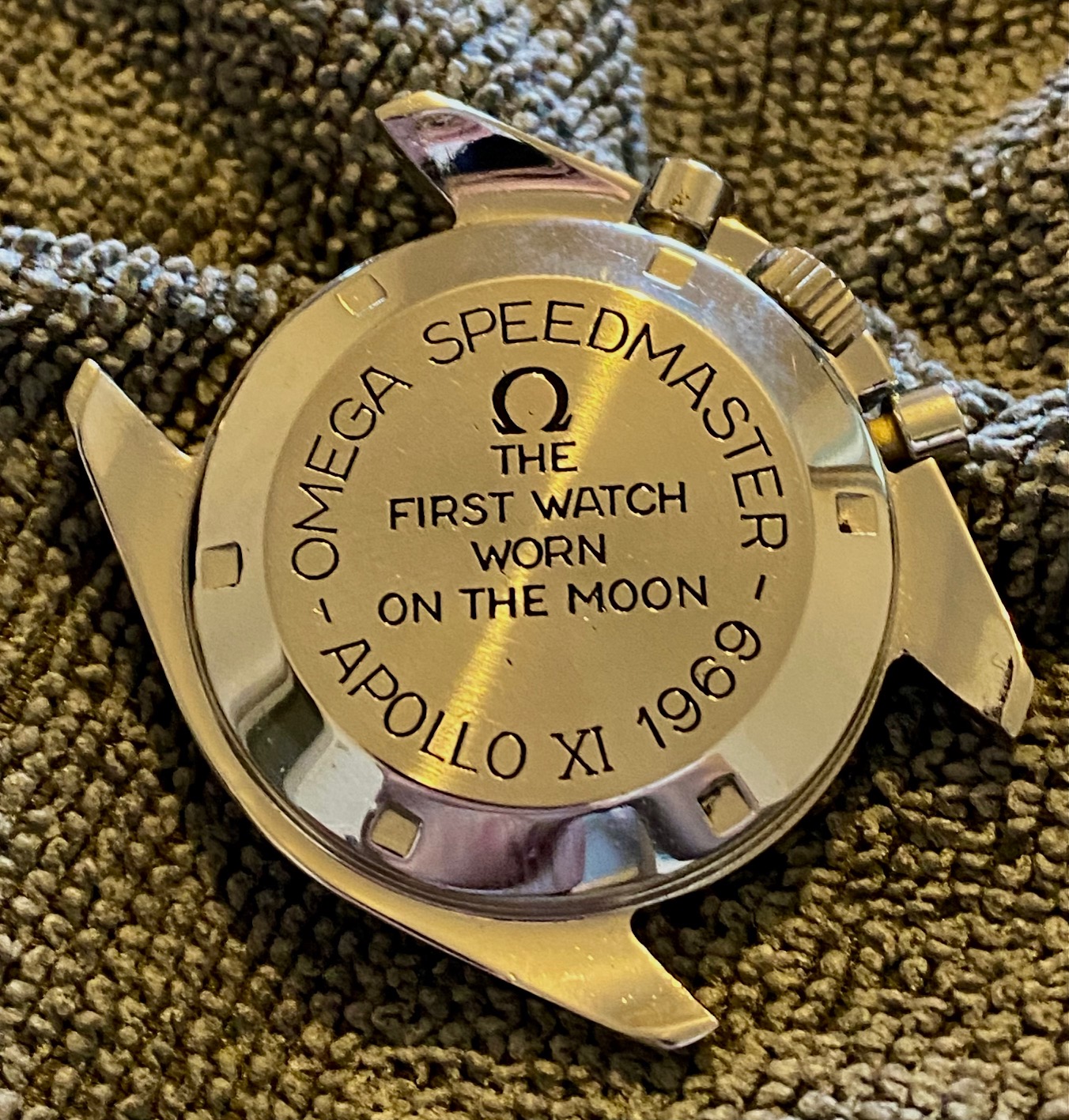

This is a picture of a rare "ApolloXI" variant of the "Straight Writing"case back always being used
on the ref. 145.022-69 and apparently sold only on the Japanese market.

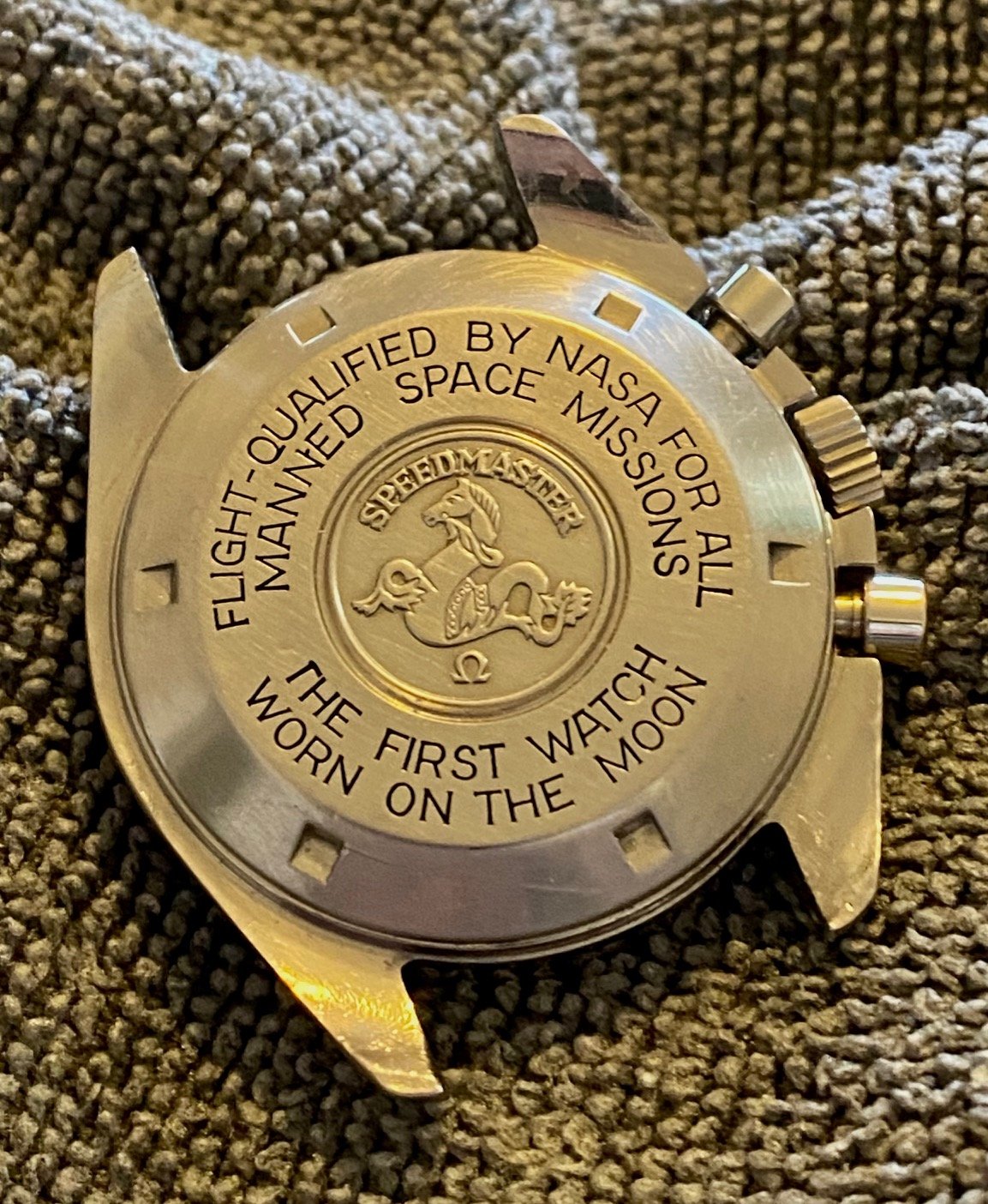

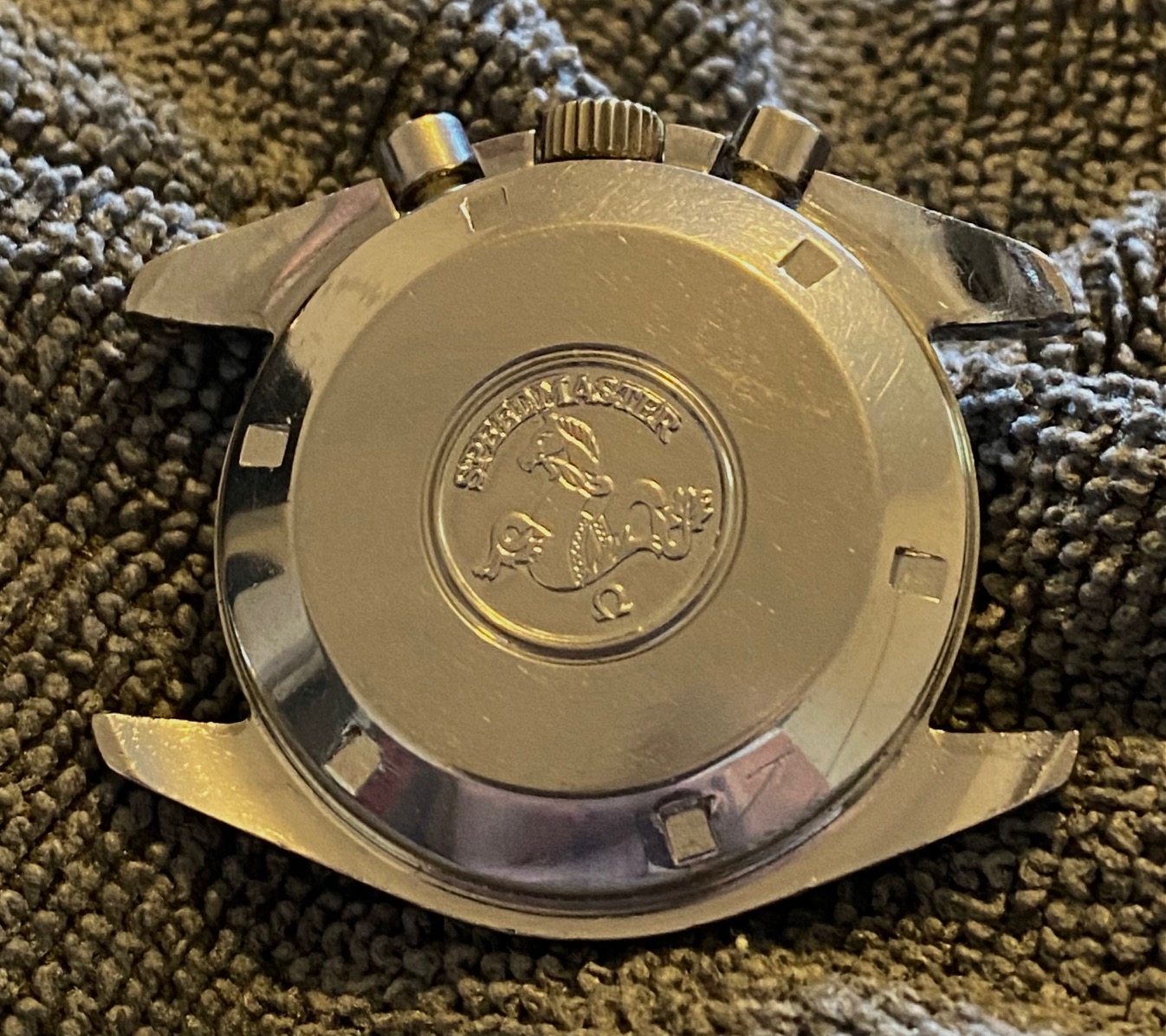

Subsequently Omega installed case back with the characteristic central medallion:
This is a rare "Non Nasa" case back used for a short period on the ref. 145.022-71
To finish with the most common model mounted, with some small variations though, for a relatively long period from the ref. 145.022-71 onwards.
I would have a favorite ...
Which is yours?

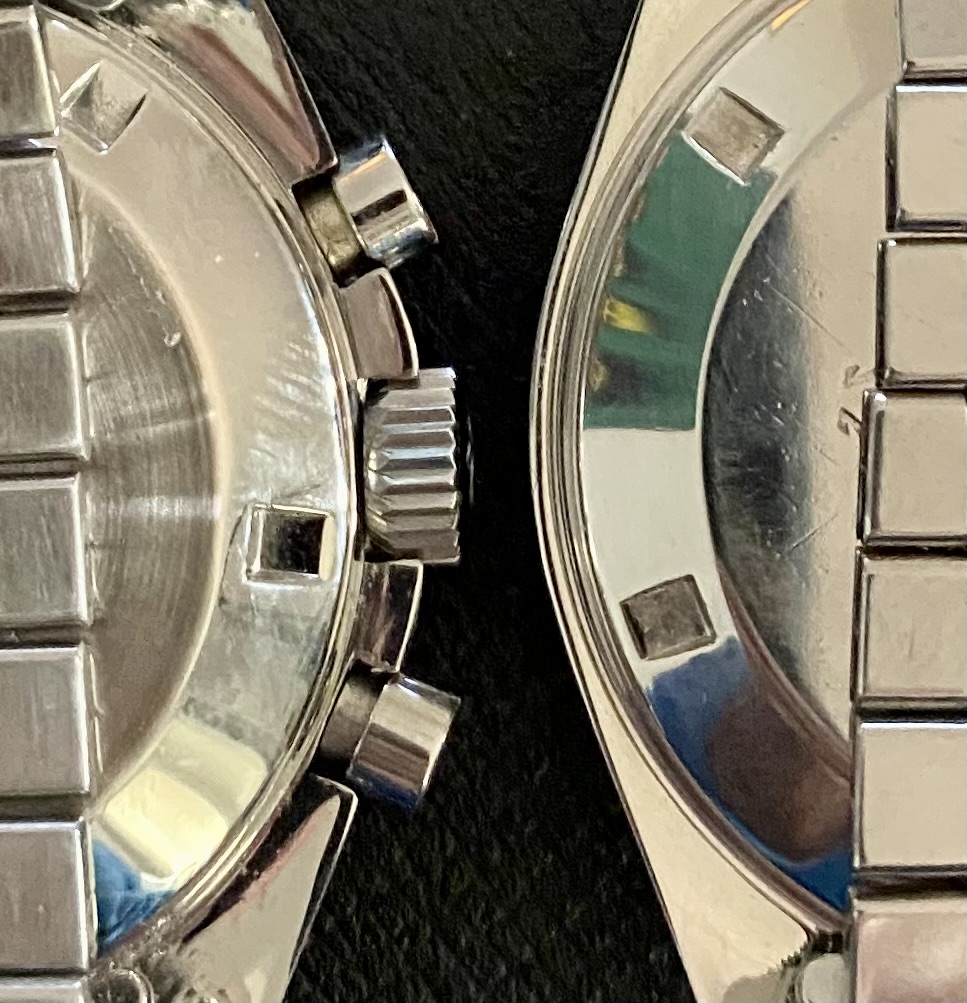

The slots look bigger/longer than usual, no? Reminds me of a service backcase.
Thanks for the nice summary!

I was referring to your third photo (also quoted with link to your photo in my reply). I am far from an expert, but I was curious as to why the six slots have the same size as on modern casebacks and service casebacks.
362
597

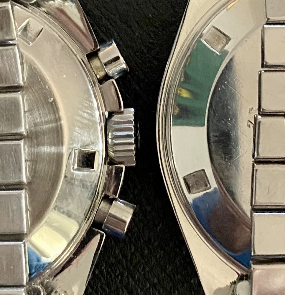

Here we go with a comparison of another 105.012-66 CB that I own.
The slots are identical and both are original to the watches IMHO.
Have a nice day.

Thanks for sharing! 👍
And congrats on a lovely collection!

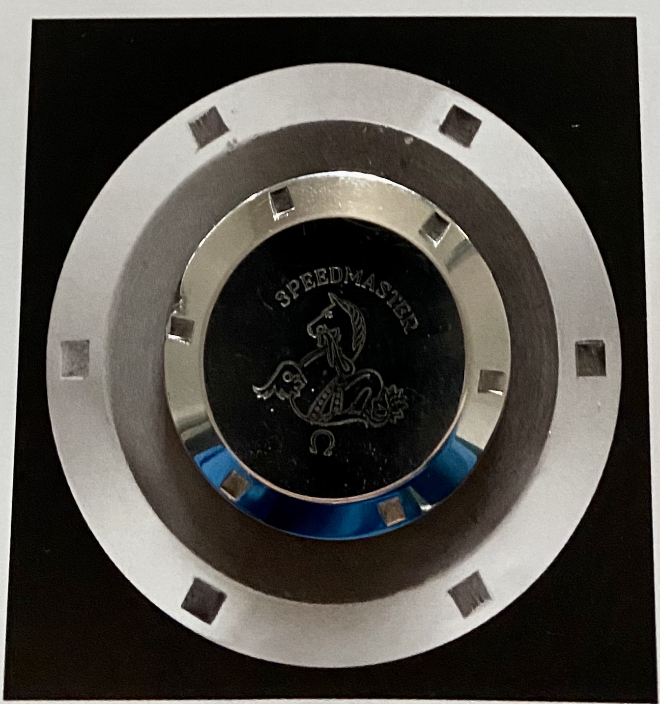

I checked my watches closely and I have noted that the CB Case back in fact have some longer slots
in comparison to my ref. 145.012-67, 68 and also 145.022-68 transitional, but for these watches the case
and case backs were produced by HF.

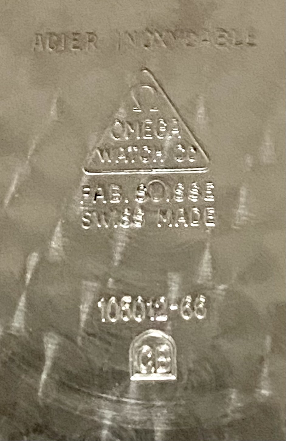

Attached you will find a picture of my CB case back taken above the picture of the Single Bevel
shown in the MWO book.
This is a picture of the inside of the CB case back.
Note: Gino Balbi told me that, as far as he knows, there have never been CB service case backs.
In conclusion you are right¨
There is a difference in the slot length in between the CB and HF case backs, but you have to consider that the case off
a CB is totally different to a case made by HF.
Cheers

Thanks - mystery solved! Interesting to see that not only the cases differed between HF and CB (which I was aware of), but also the case backs…
Cheers!
