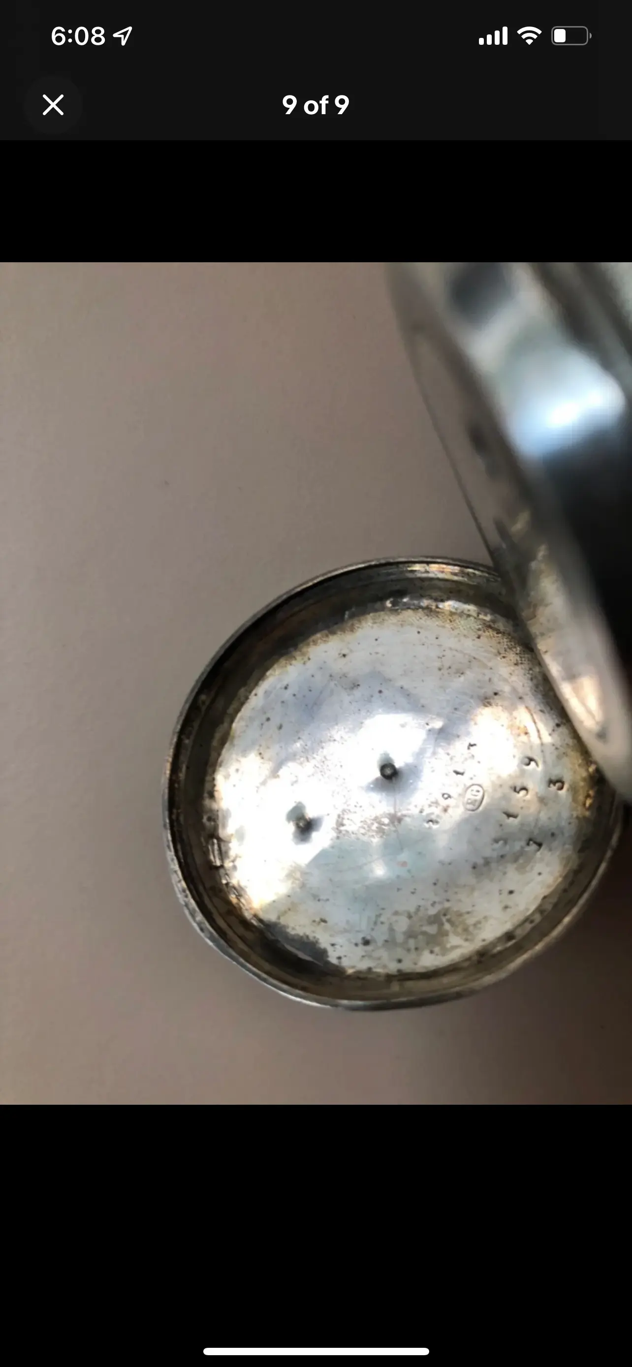

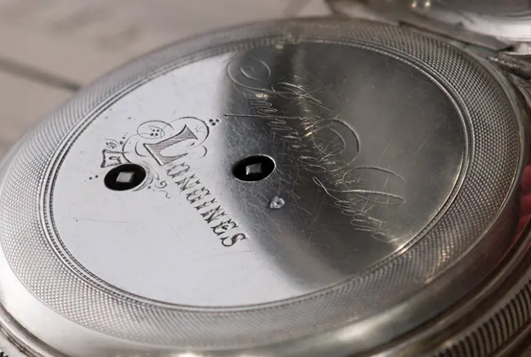

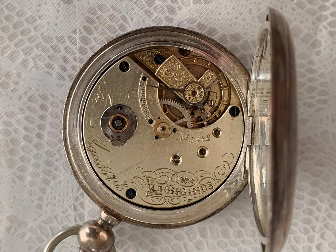

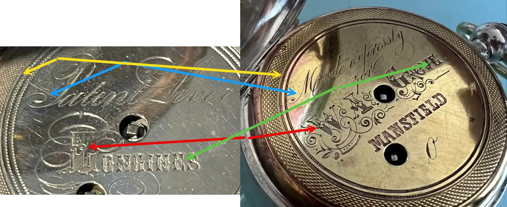

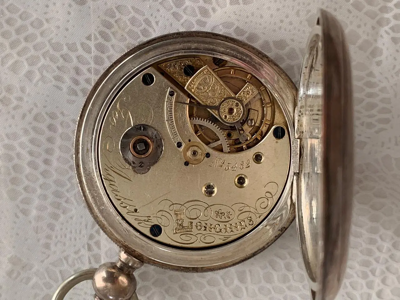

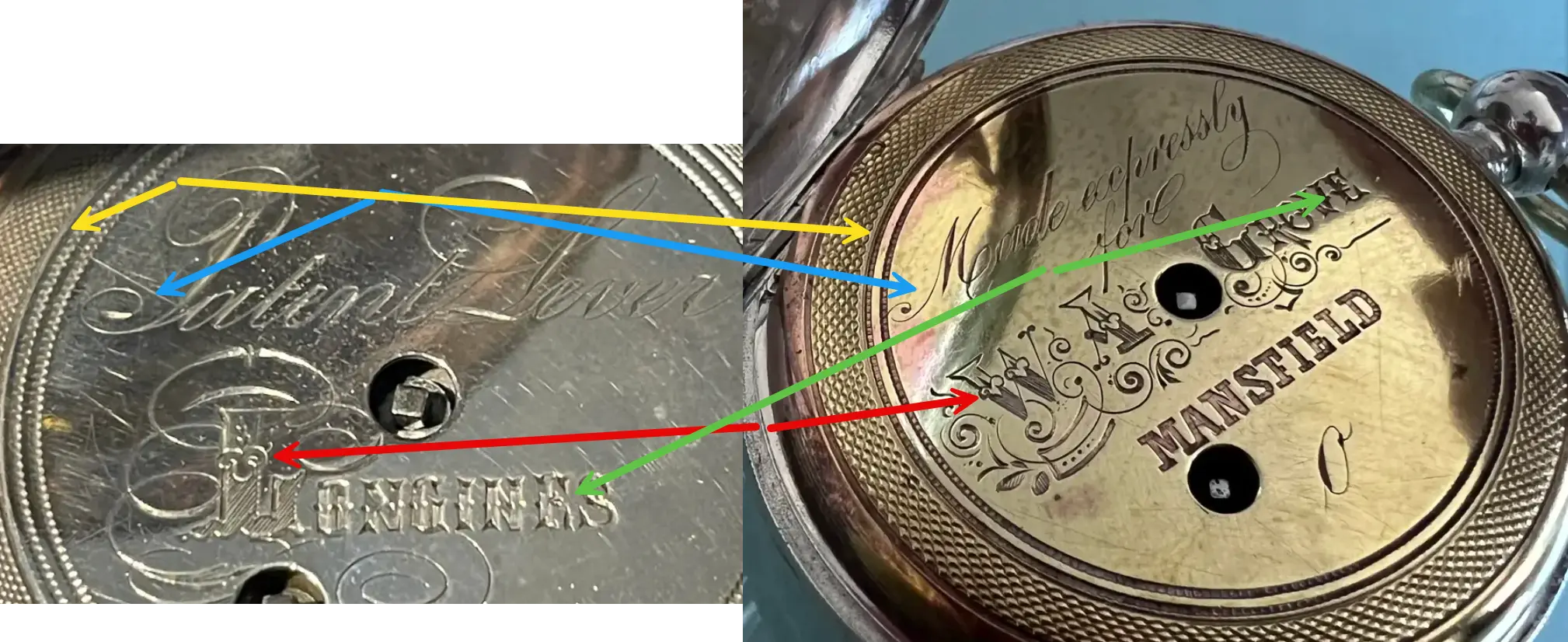

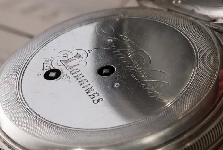

Here is in more detail what I mean when I say that this looks like the work of the same engraver. This similarity of the style of engraving and matching serial numbers to me suggests this case was matched at the Longines factory to your movement and made to order for the retailer.
40
109
Wow, Seiji - you're the research expert!
Just looked at fonts, position and alignment of the serial in the case - all very much Longines-style. Guess you are perfectly right.
Thanks!
Gerd

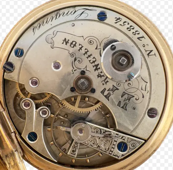

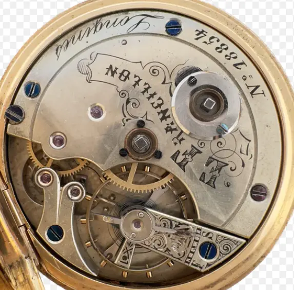

And this is interesting too. Borrowed picture for discussion purpose.

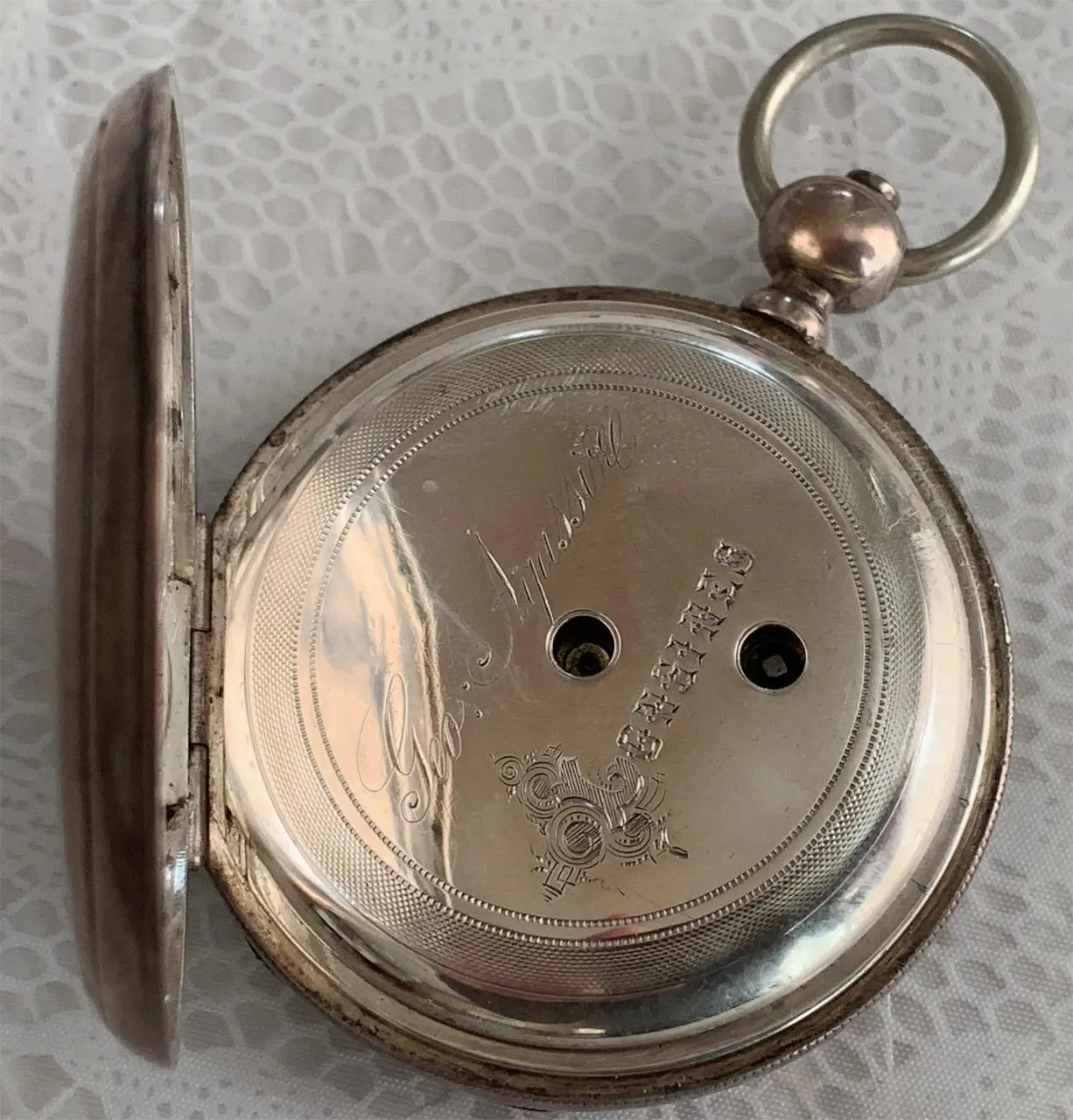

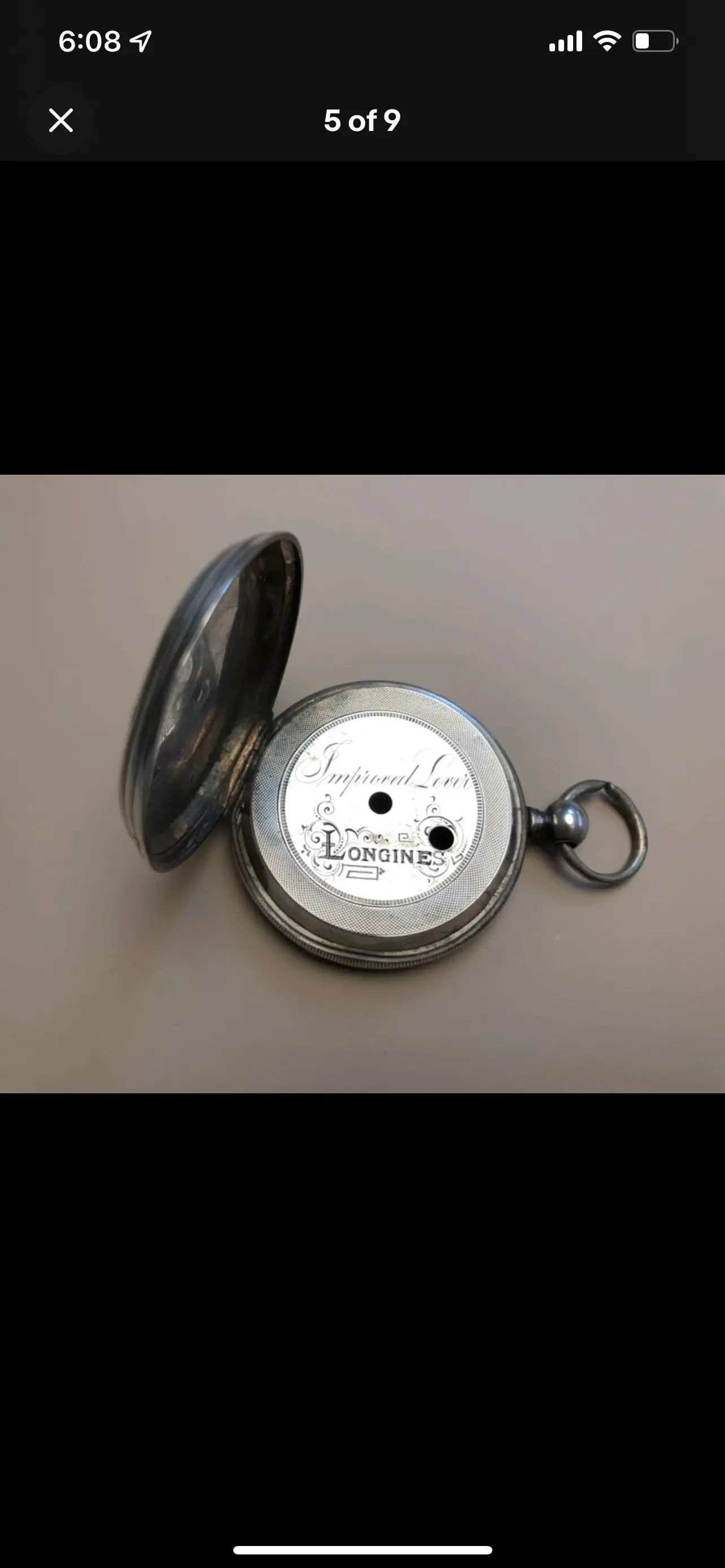

Yes the style of the engraving is so bold and distinctive, plus the skills needed to make the engraving by hand! Not easy to copy and why bother to copy? So I would feel confident in saying this is a Longines factory engraved case made for your movement. Engraved by the same artisan that did one of my watches.

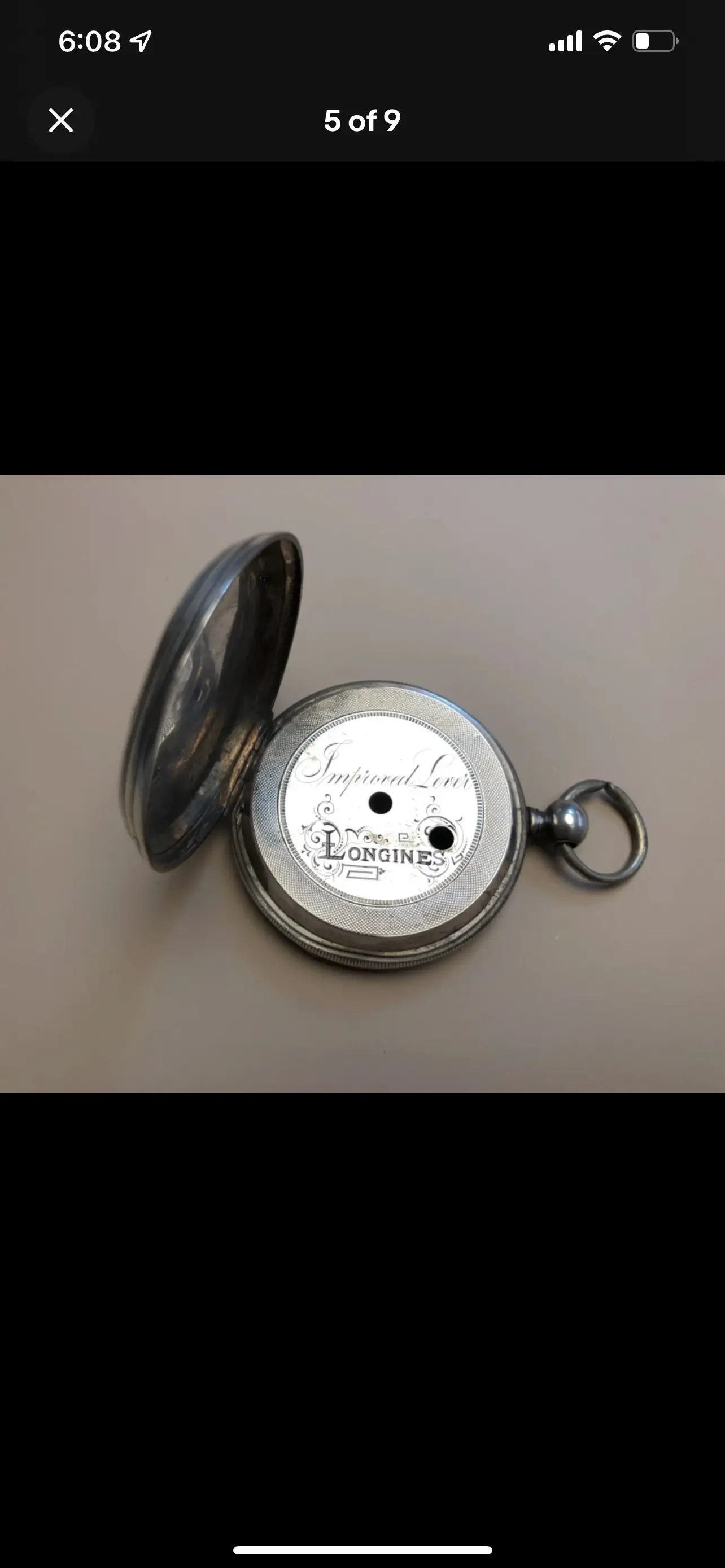

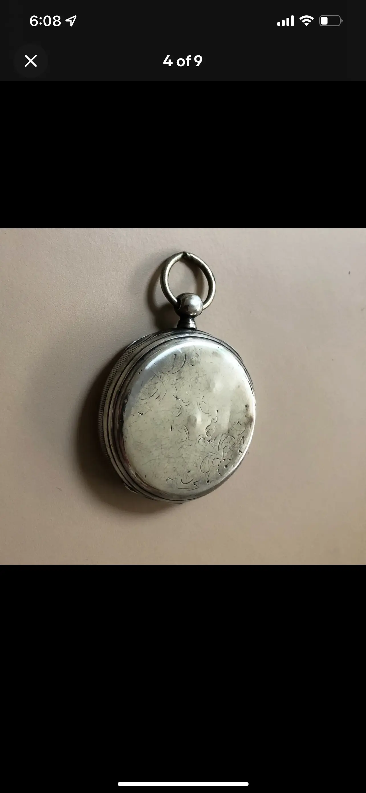

Let me guess: Case not made by Longines, but by a fountain pen manufacturer in the US?
Mine was born just a couple of days (hours?) before yours, but somebody slaughtered it for gold 😕

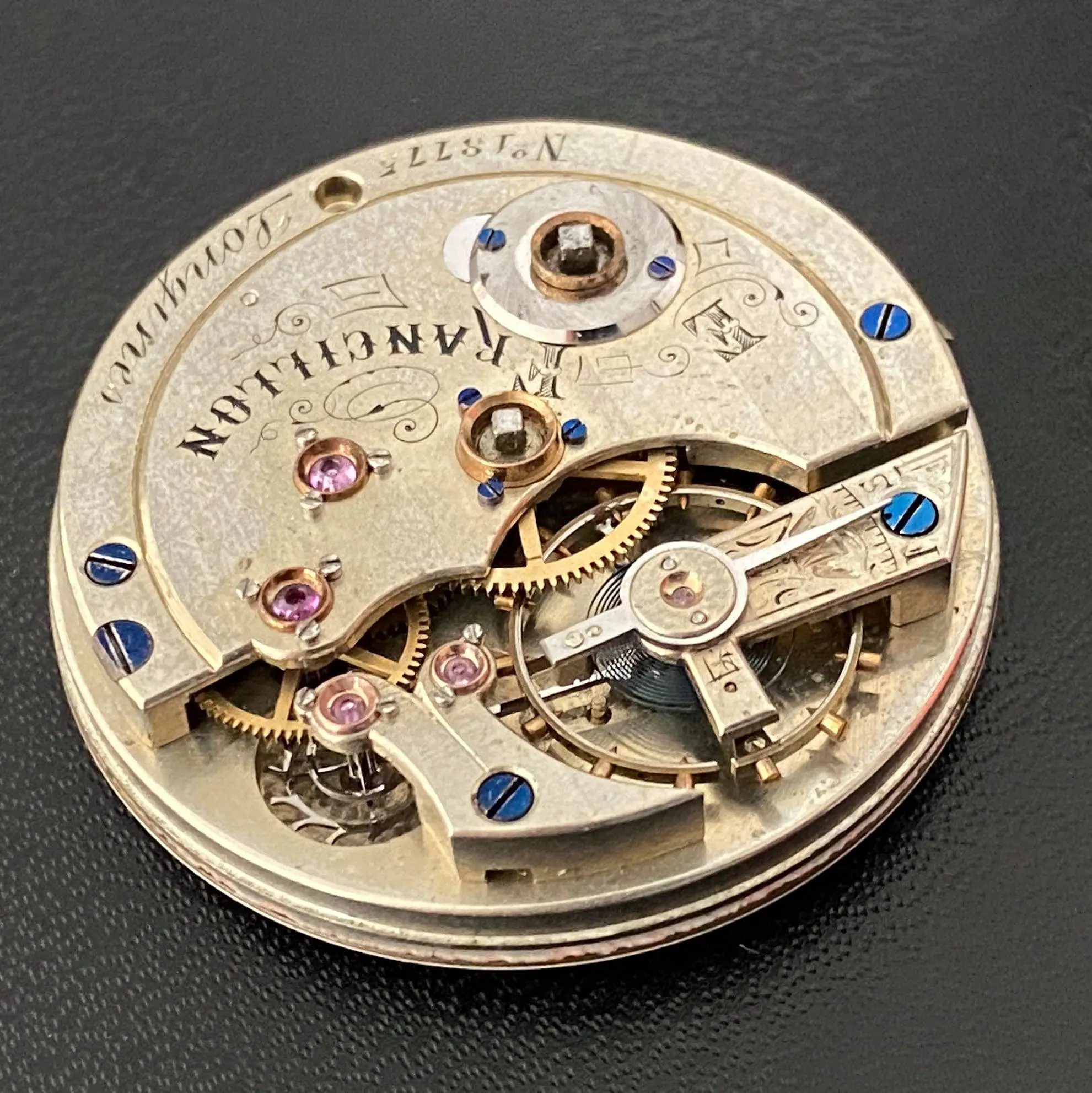

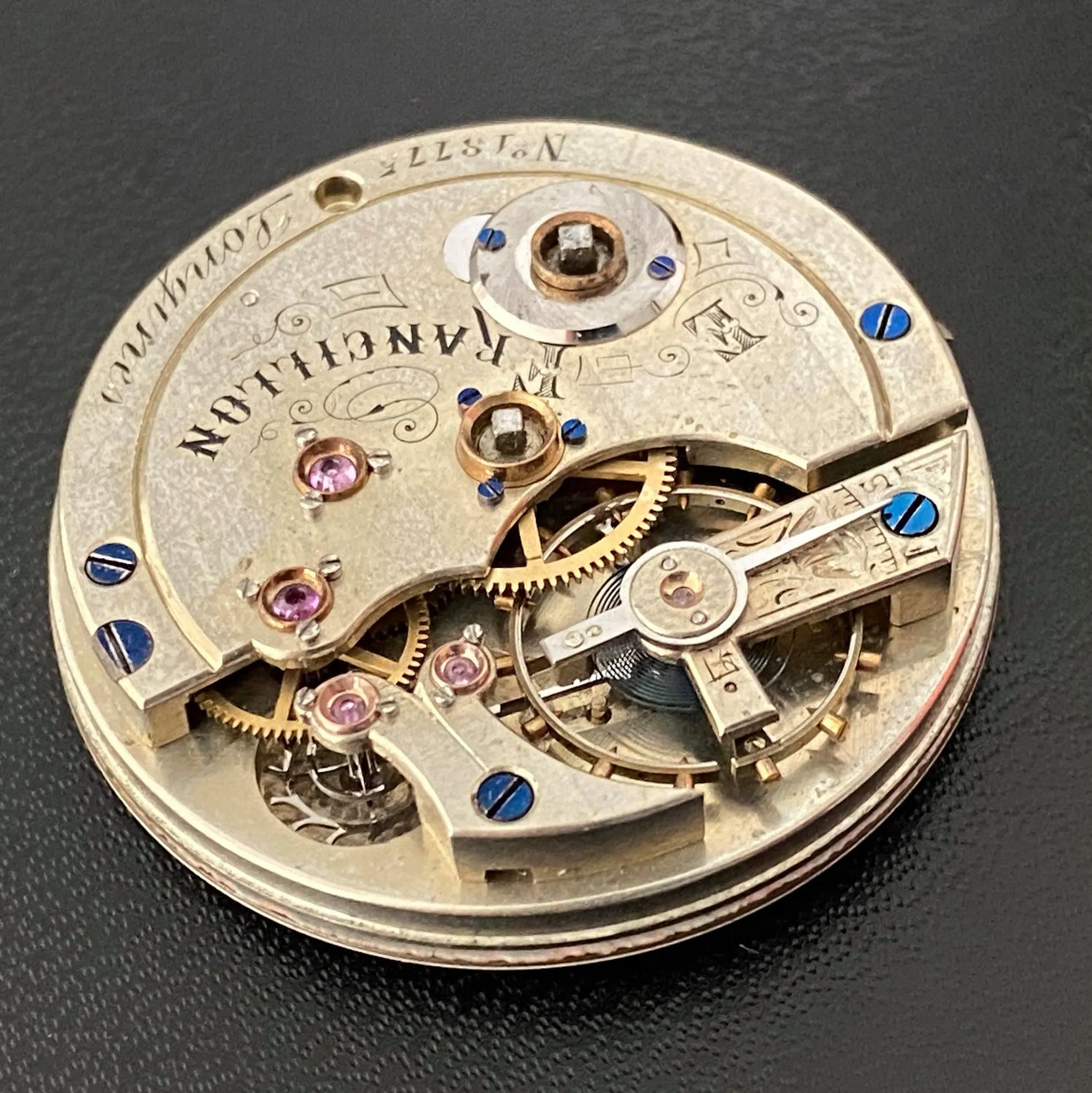

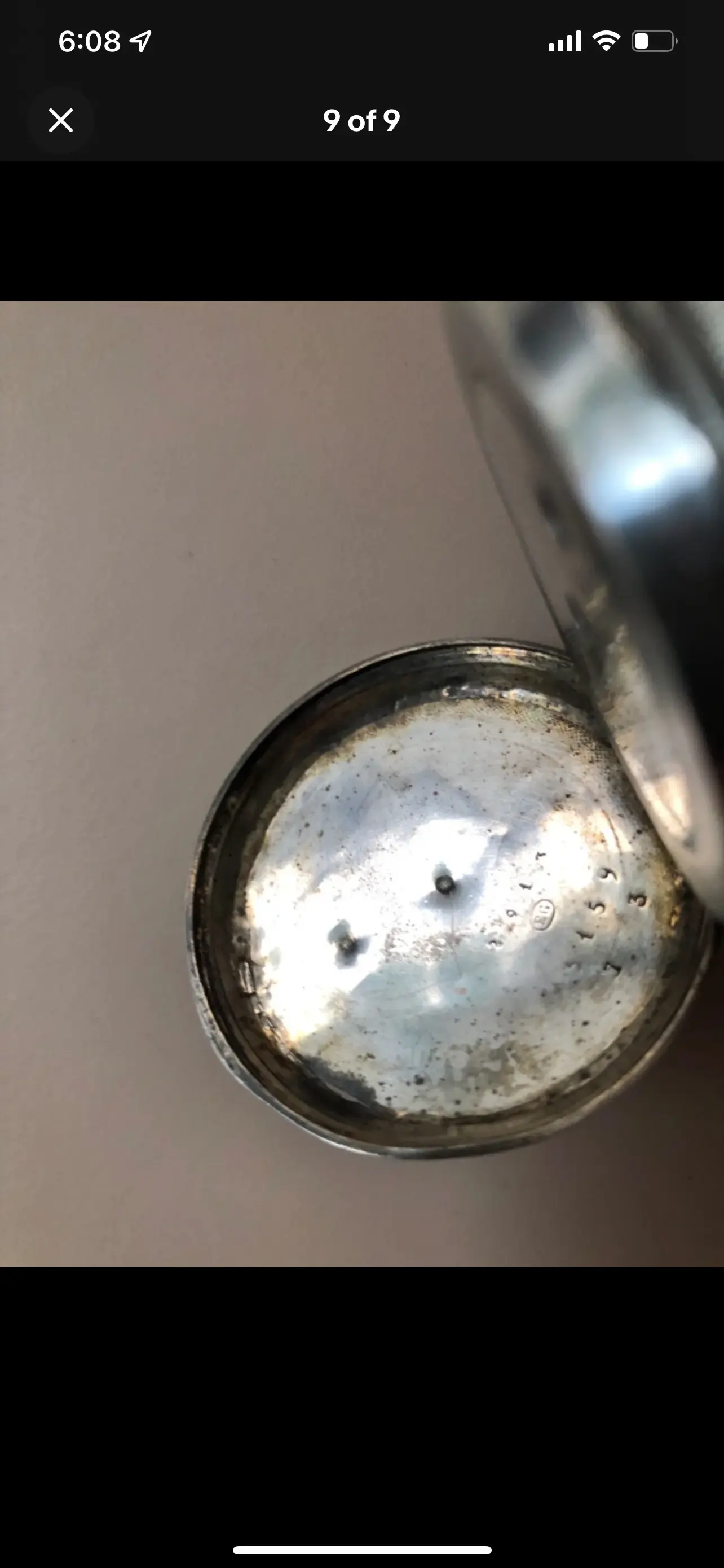

I don't have one of these with a case. There is one on eBay or at least there was one recently. Really hard to find one of these Geo Aggassi or EF Francillion versions with the case. Don't know the story behind why almost none have a case.

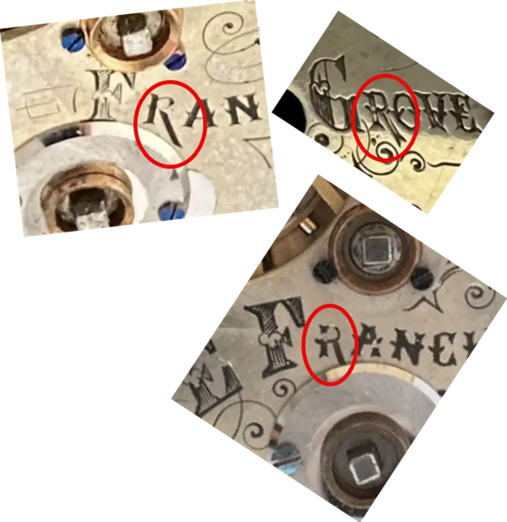

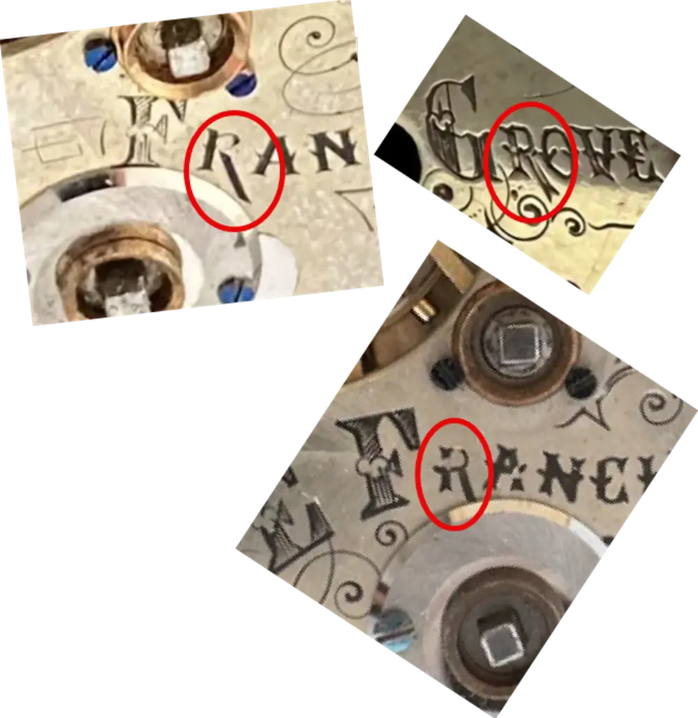

Anyways, the point is that the engraver is the same person again. Note the long "R". The engraver is leaving his/her DNA all over these movements and your watch case. Look at the R in Francillion on the movements and the R in your Grove
40
109

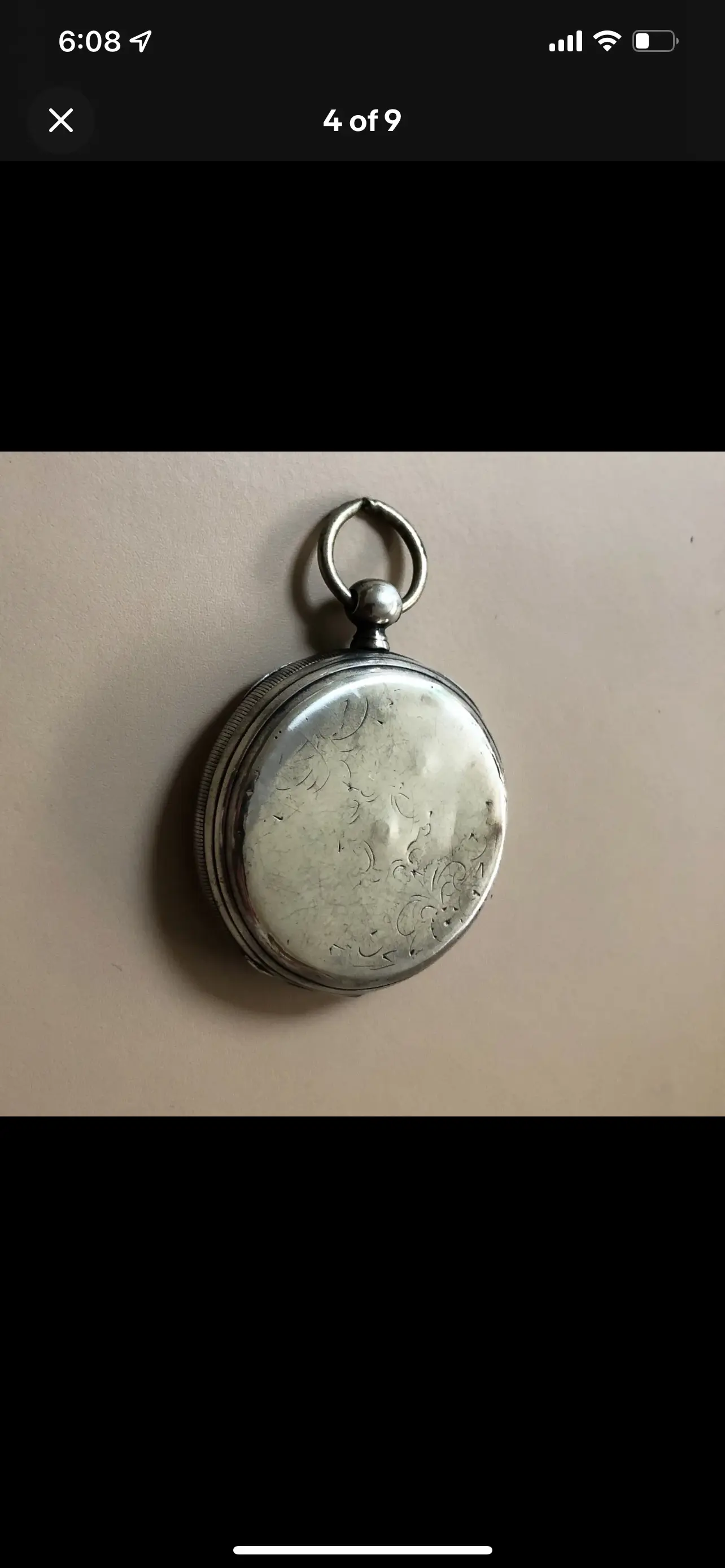

Yes! A post in NAWCC suggests that the 16Bs were shipped to Aikin, Lambert & Co. in New York, a fountain pen manufacturer that made 18k cases for them. Very few of those watches survived as they were scrapped for the gold. Wish I could find a complete one. Never recognized the details in the engravings!

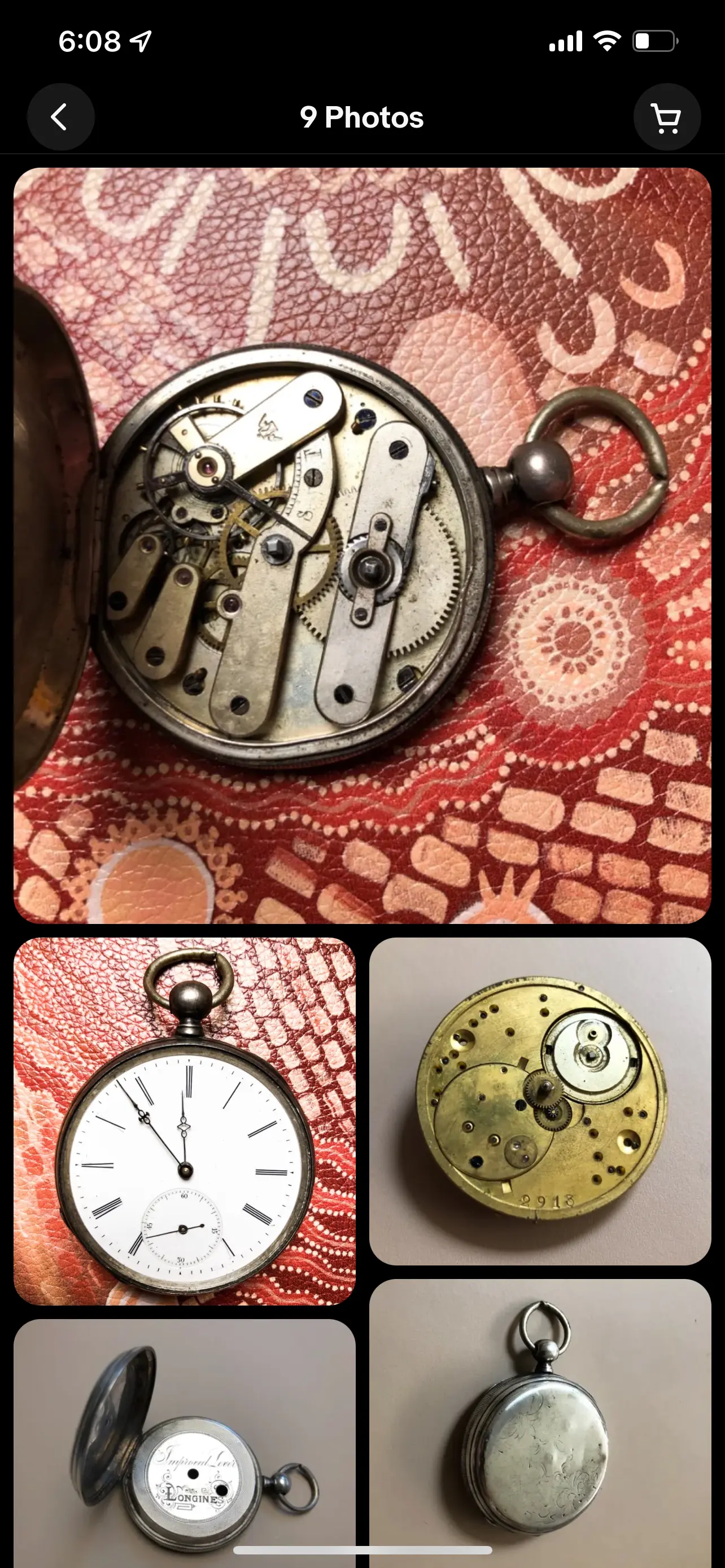

I like the fact that it's 150 years old and the key wind is awesome to me. Ill probably be spending 5-700 to have it repaired and the crystal and bezel replaced. I know I'm "throwing money away" but I've always wanted a cool old pocket watch. Thankfully I only paid $20 for it
1,532
4,443
Oh it's not throwing money away. You will have something special when it's done. My watch of your period is actually an amalgamation of the original watch and a donor watch. I just thought it was worth my time to restore it the best I could. I spent $500 on a watch that probably will be hard to sell for $300. I paid about $150 on a black pile of parts. Polished the case, got the glass, go the gears, go a dial of the exact type. It's a once a week watch I know I can fix if it stops working. This movement is so simple and has a huge error tolerance that it makes for a great watch to tear down and put back together. It always runs after reassembly like Lego blocks

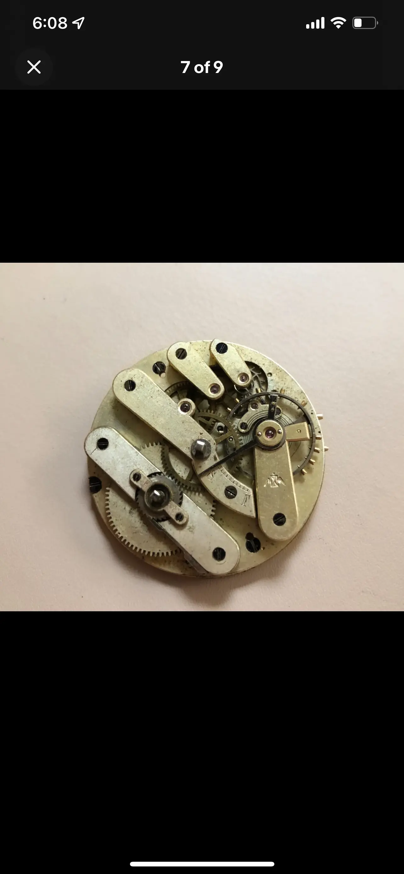

A different engraver
Key winders are not easy to find unless they are Turkish. An AA4 is a grail watch, about as easy to find as a diamond on a beach.
