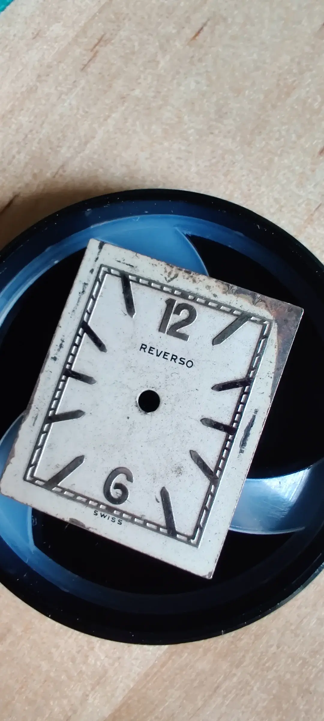

Hi everyone,
Would someone who knows early Reversos be able to tell me if this dial is correct for an early reverso? This would be a Reverso with a Lisica movement.
Thanks in advance,
AJ

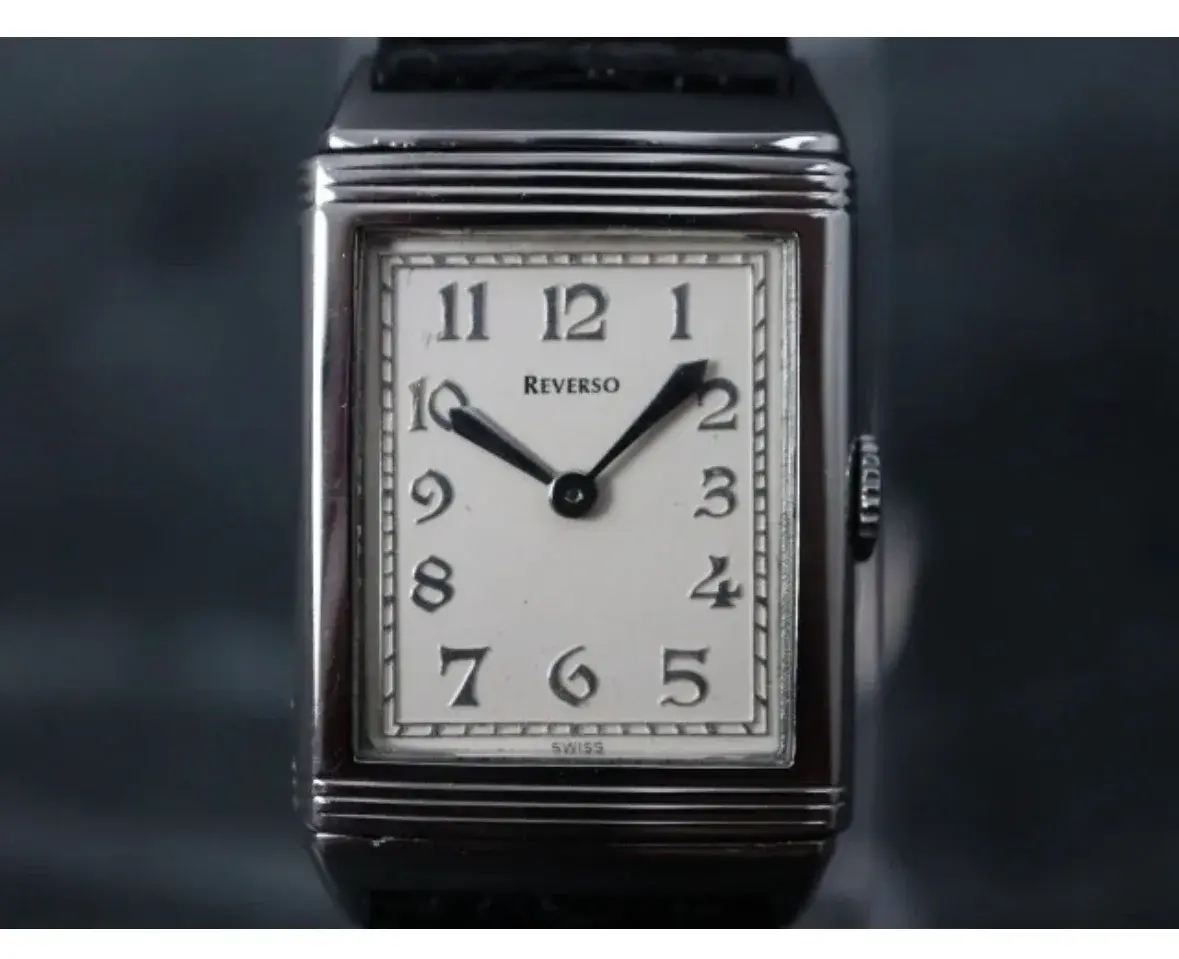

Looks refinished, fonts appear to be in a more modern style. Usually these dials are not in great condition.
4,405
13,130
I'm going to say that the one featured in that article, if you can call that an article, is also a redial. Anytime I see a watch from the 40s with that white of a dial and no marks of any kind, I am going to say it is a redial. I also don't like the print on it. The case also looks heavily polished as the steps have lost their definition along the the corner edges.

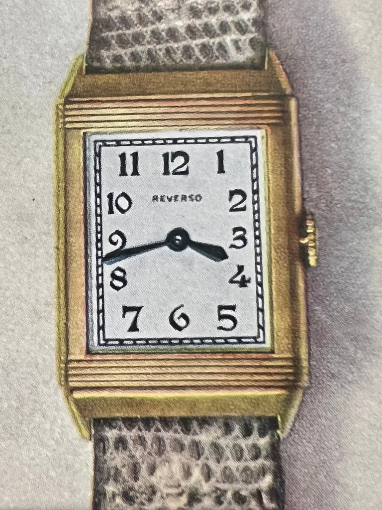

I agree about the refinished dial, because of the font. Otherwise, such low serial is OK for early Reverso powered by the Lisica movement. The crown seems also correct.
Here is a scan of an original catalog from the early 1930s.
It is the same configuration for dial and hands (but the case is in gold)
