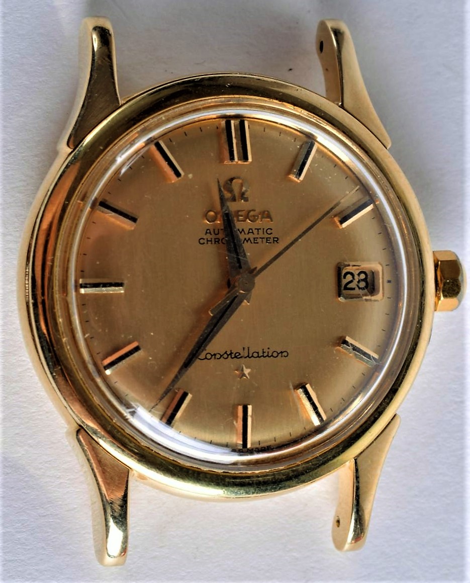

  1. ewand Mar 5, 2019
    1,287
    5,845
    I know very little about Constellations and even after sniffing around online (and on Desmond's blog) I'm not quite sure what I'm looking at here - I saw it on an auction site (with slightly different photos - we don't want to make it too easy) though bidding is already more than I would be prepared to pay, so I offer it here. It's described as 18ct solid gold (and a solid gold dial as well, unless the lighting is dodgy),

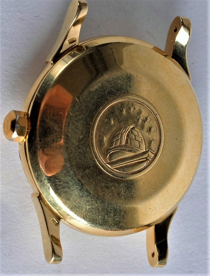

    I imagine the caseback is worn [edit - or heavily polished ;)] (should it say CONSTELLATION and WATERPROOF)? And I'm a little thrown by the combo of that dial, that case and that crown. What is it, and do you like it?
    Currently bidding at £700 + hefty fees and I'd expect it'll top £1000, but that's probably not far off the scrap value of the gold...

  2. hoipolloi Vintage Omega Connoisseur Mar 5, 2019
    3,516
    5,792
    I would bet nothing on it until I see the inside of that case back.

  3. Edward53 Mar 5, 2019
    3,127
    5,384
    I would like it a lot more if it wasn't so heavily polished. Looks good otherwise.

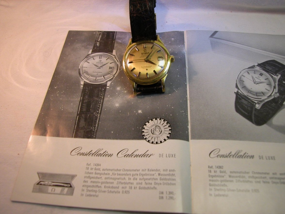

  4. aprax Mar 5, 2019
    315
    938
    I noticed that one too and I discounted it because of the overpolished caseback. It should be a de luxe 14394 with a 561 inside, like the one pictured in the german brochure from 1960 below. (The photo comes from the seller of the real watch in the picture which I bought on ebay, that one is a 2954 with a cal. 504).

  5. Peemacgee Purrrr-veyor of luxury cat box loungers Mar 5, 2019
    5,127
    7,835
    Mine is on the opposite page. :)

  7. Noddyman Mar 6, 2019
    1,116
    1,771
    14394 doesn’t have a press fit case back.

  8. ewand Mar 6, 2019
    1,287
    5,845
    Thanks guys - It looks like a 14382 except it has a calendar... as per the catalog photo above and from @cristos71's info on
    https://omegaforums.net/threads/vintage-omega-constellation.65394/
    and Desmond's article on https://www.mediafire.com/?rdw8okwuax0d9l7.
    And since it has a push on case back and no "OFFICIALLY CERTIFIED" on the dial, it seems unusual...
    If it was cheap, I would snap it up because I really like the dial - but as mentioned above, the case has seen better days. Then again, who looks at the back of a watch case while you're wearing it...
    If anyone wants to keep check on how it's doing, it's on Invaluable (sitting at £500 at time of writing) and if you want to pay another 5.6% in fees, you could try getting it via The Saleroom (currently bidding at £700)
    Edited Mar 6, 2019

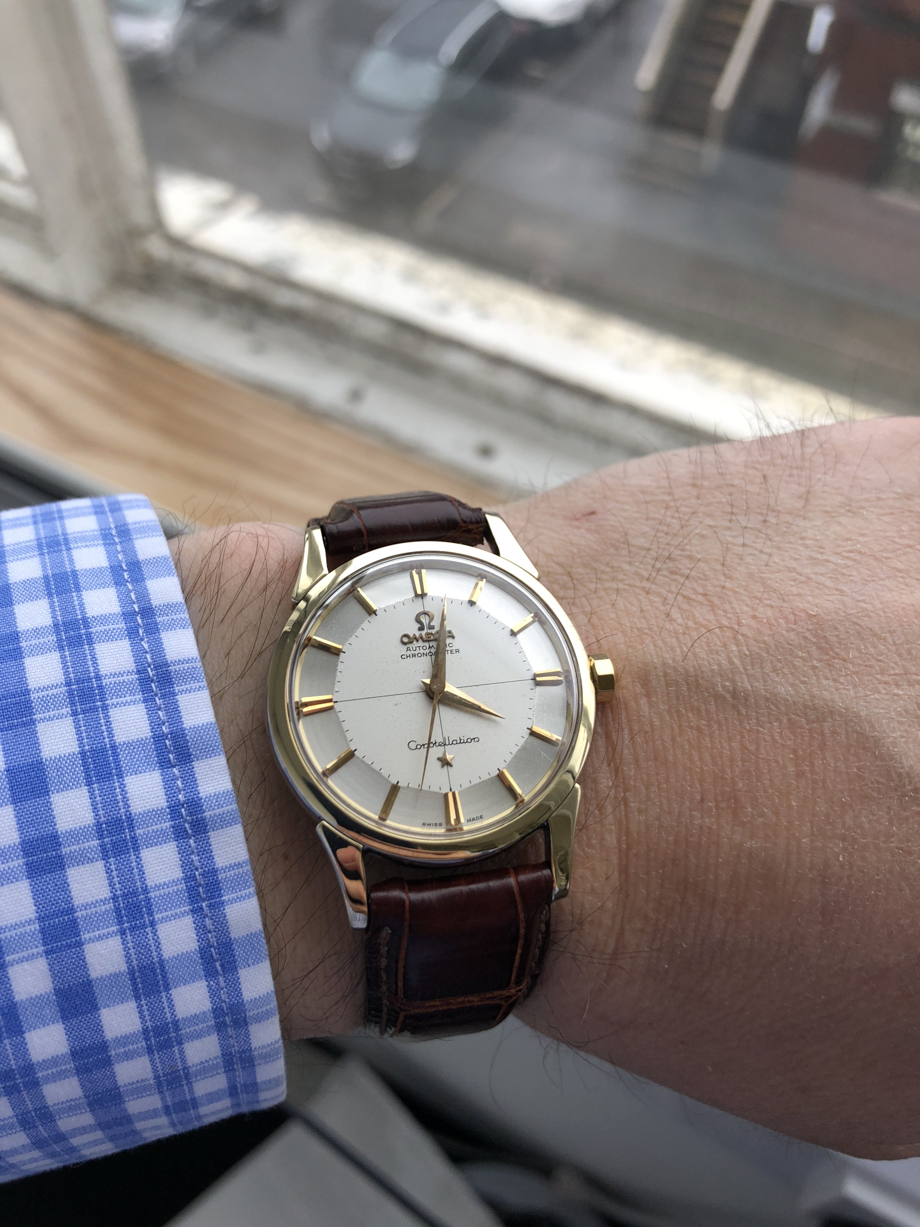

  12. padders Oooo subtitles! Mar 6, 2019
    8,931
    13,873
    Here’s my 14381-9 gold cap. It has some style similarities with the original but as noted this is a screw on back and of course has a pp dial. I would guess the original watch is of this 59-61 era too though so not as early as all that.
    8A61D265-B167-4710-9C62-30FF52D981ED.jpeg A059927F-395B-4305-95E3-C0266F78D125.jpeg
