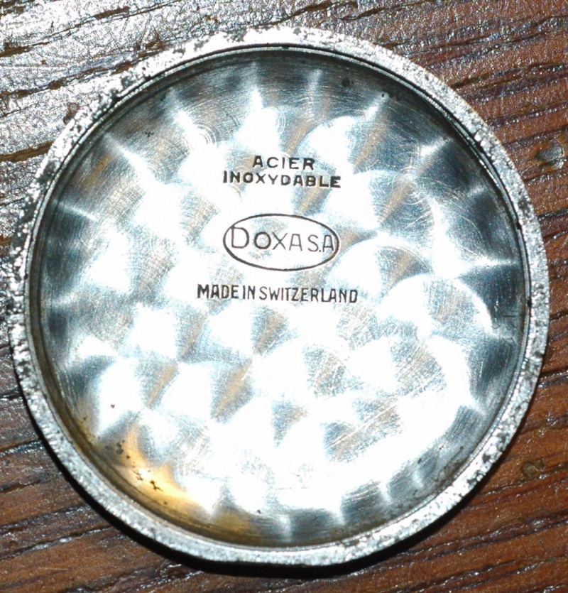

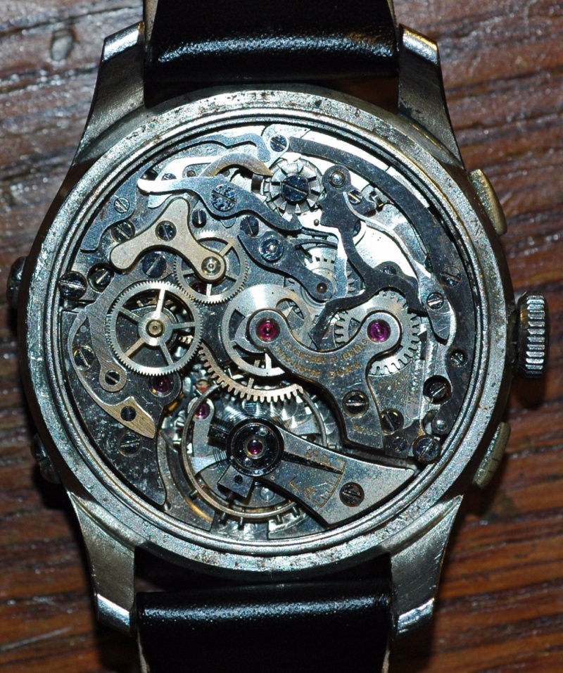

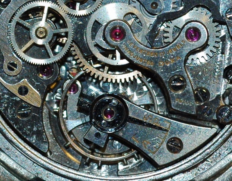

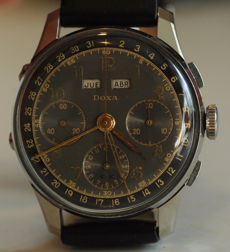

    On the local market, I see such a watch:
    Does anybody met with this? What is there movement?
    Thank you for your Help & Feedback :)
    SeanO likes this.
  2. LarryG not KennyG, not OG, just LarryG May 3, 2015
    992
    3,836
    Valjoux 72c, perhaps.
    Nice.
  3. primabaleron May 4, 2015
    430
    5,463
    Is it possible that Doxa branded this VJ72c movement as a 222?
  4. gatorcpa ΩF InvestiGator Staff Member May 4, 2015
    12,198
    15,703
    Yes. A lot of companies did minor (sometimes not so minor) modifications and gave them caliber numbers unique to that brand.
