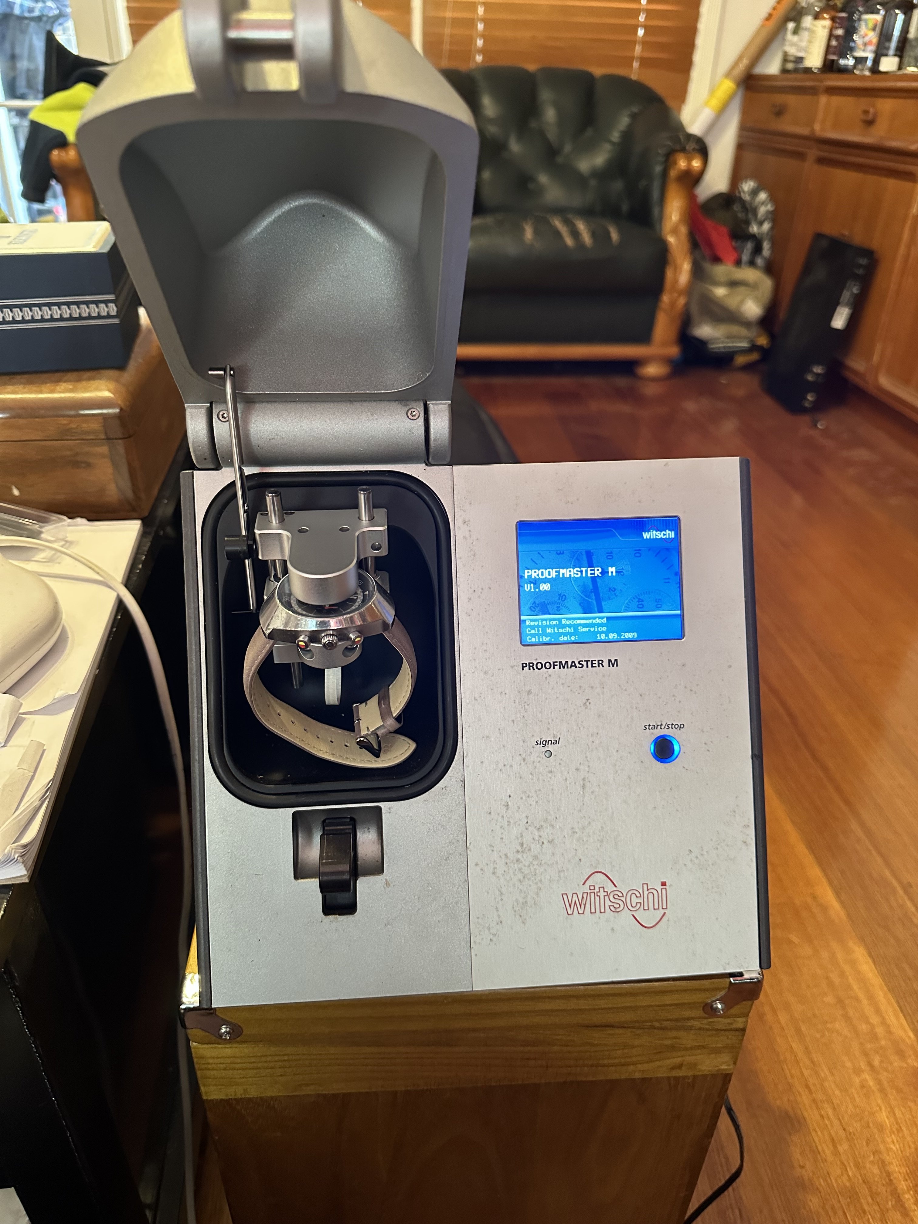

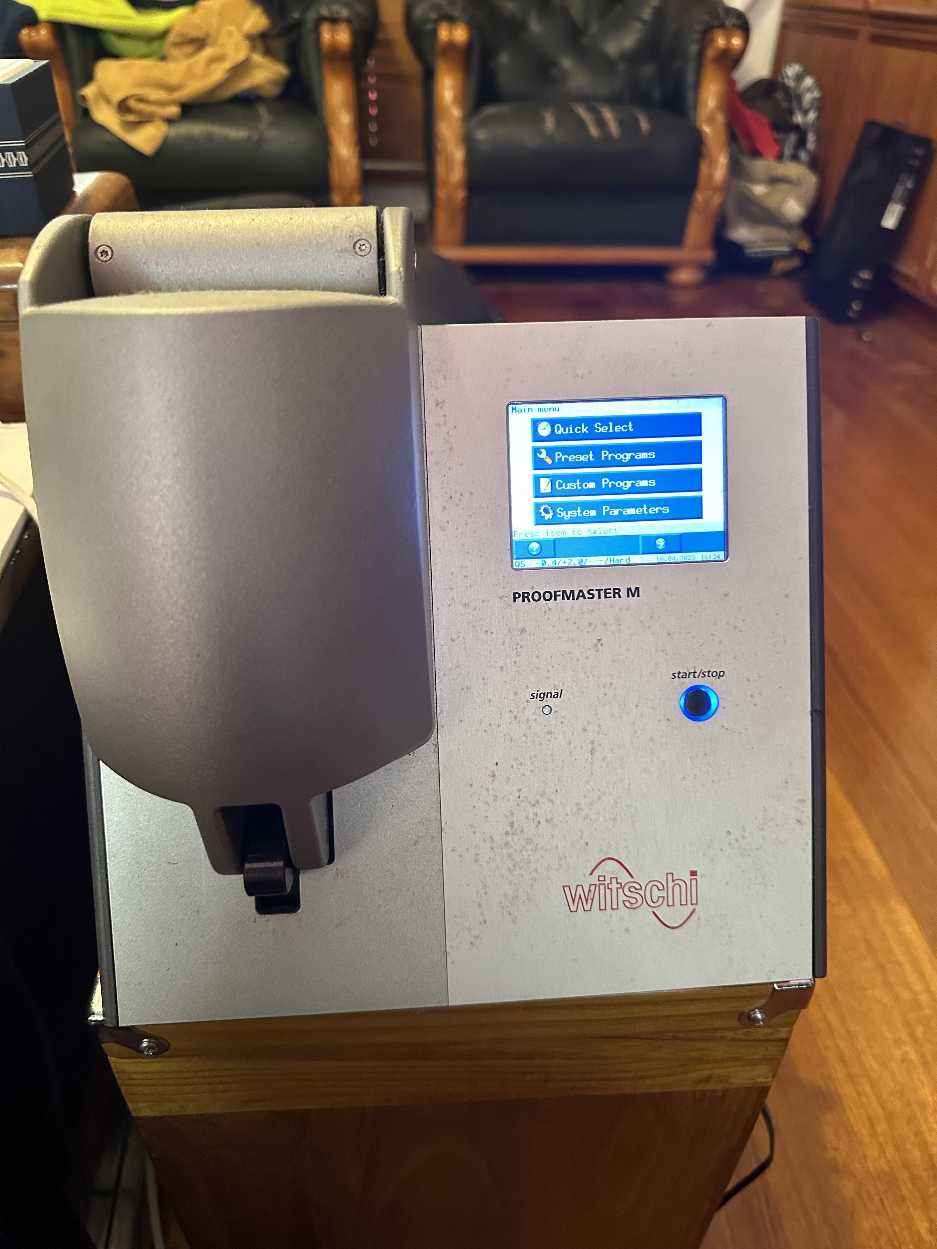

Bugger going to get my watches pressure tested, I do them at home, I was lucky enough to score a Witschi Proofmaster M pressure test rig for free!
A case of being in the right place at the right time.
Here’s my Flighty going through the routine
Doesn't appear to be doing a test in those photos, so do you have it actually running? What compressor are using for the air supply?
You will need at least 11 bar on the compressor to make this work, and I'll warn you now the air will need to be very clean and dry, or the machine won't last long - they are very sensitive to contamination in the air, so extra filtering ahead of the machine is needed.
Keeping it in good shape is important - this is a pressure vessel...
2,781
4,707
No that was before I’d actually started the test, I hadn’t run the air hose in from outside yet.
I use my shop air compressor which runs at about 150 psi, I run such high pressures to fed monstrous things like 1” sq dr rattle guns. I regulate it back for most other things.
The compressor is brand new it’s a Chicago Air Hush 150, a 4 motor direct drive 8 cyl configuration with a 150 litre receiver and another 50 litre receiver plumbed into the system. Although I run this unit directly from the integrated receiver.
I have a dedicated hose and regulator/filter for this purpose which is never used for anything else, to be sure it’s always clean..
The kind of filtration you use for air driven tools like an impact will not be sufficient for this, just so you know. It's not contamination from using it from other tools, but from the compressor that is the issue. These are typically used with specific compressors that run very dry and clean, along with extra (finer) filtration.
Sounds good.
So I Imagine it is at least running an auto drain with a refrigerated drier in unison with the appropriate particulate filter afterward?
