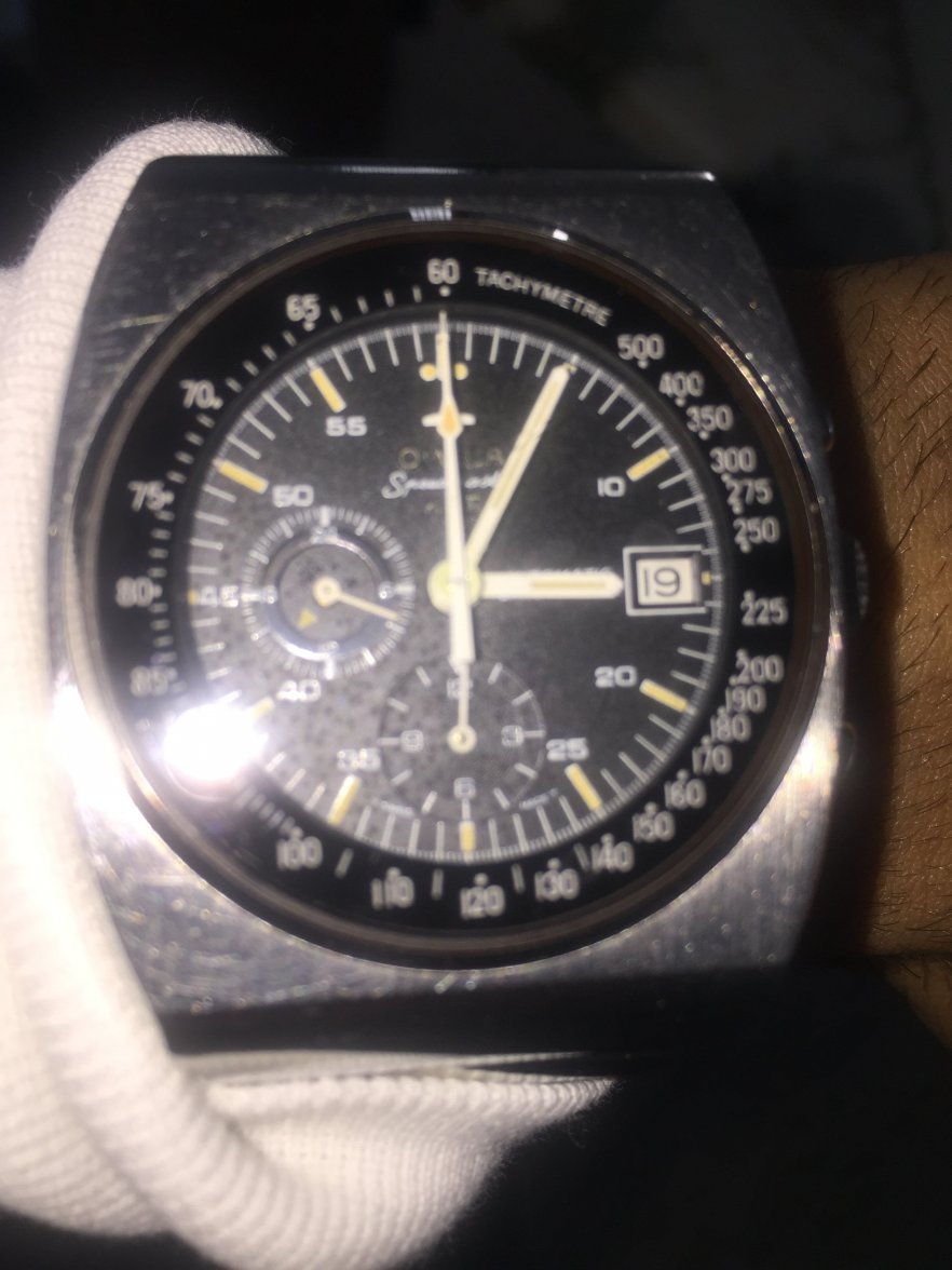

This is a picture of the Speedmaster dial, it is difficult to capture these condensation like marks unless with a flash or similar.
Welcome aboard - the picture is blurry but the patina on that 125 looks superb... maybe linked to humidity. Who knows...

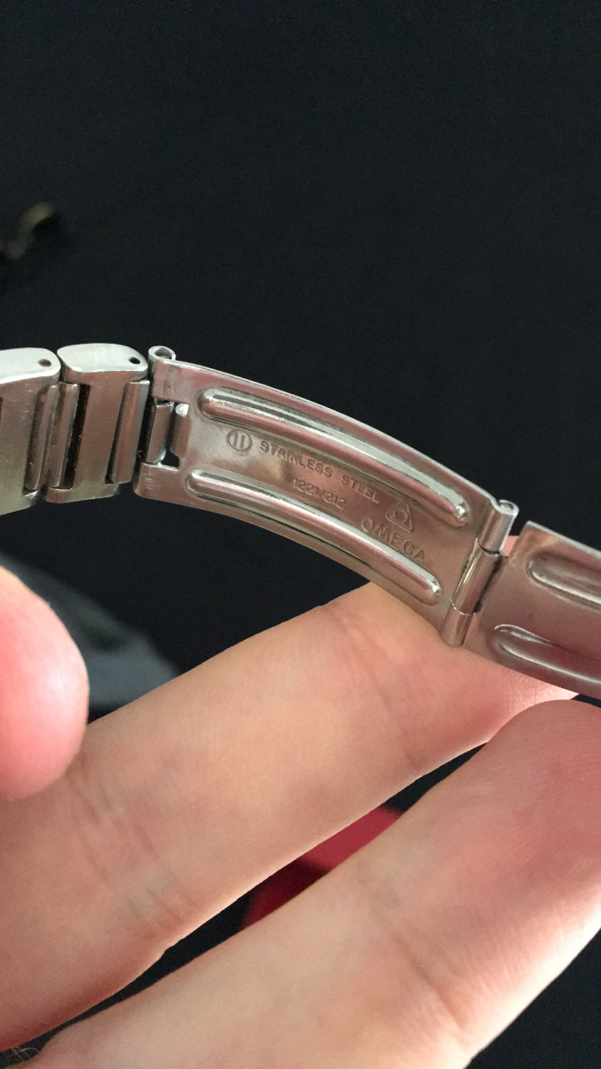

One final observation maybe can somebody please shed the light on, the clasp on my Speedmaster 125 was reversed, I asked my watch technician to put it on properly when he removed some links for me as it was too big, but I have seen some for sale with the same reversed clasp.
Why is this please?
Lovely 125 👍
Other than distracted moments from your watchmaker, I cannot think about a good reason to reverse this clasp....
