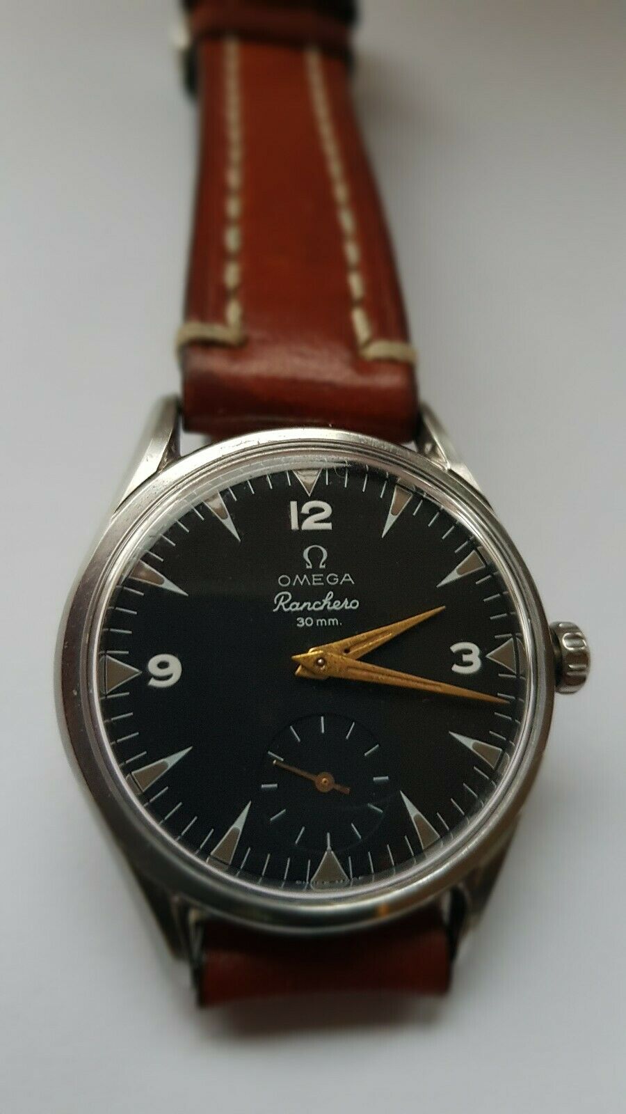

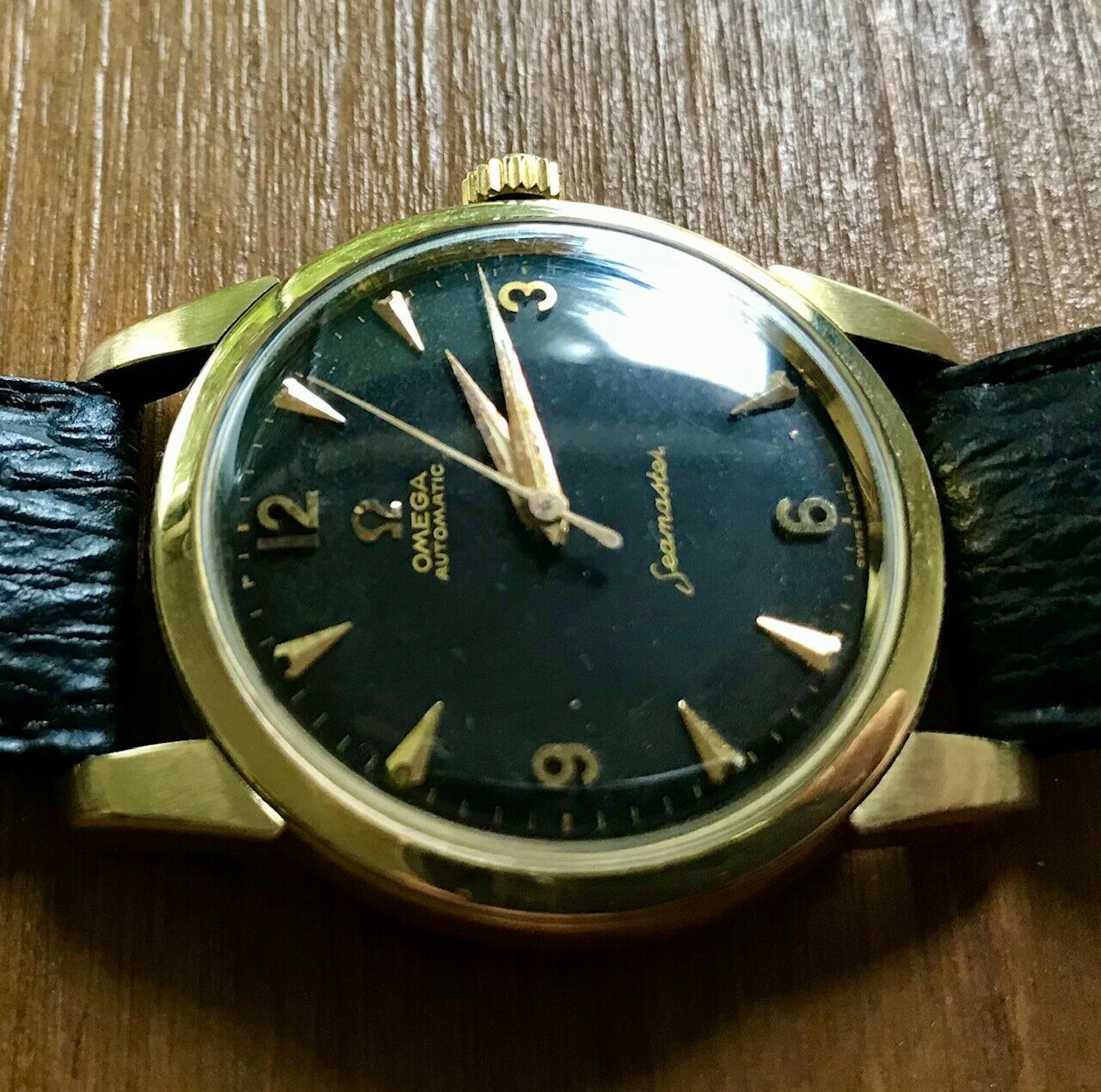

I thought I'd see what 50's blackface Seamasters were around. this is the first thing i saw:
it scores a quite high on my
as did this puppy..

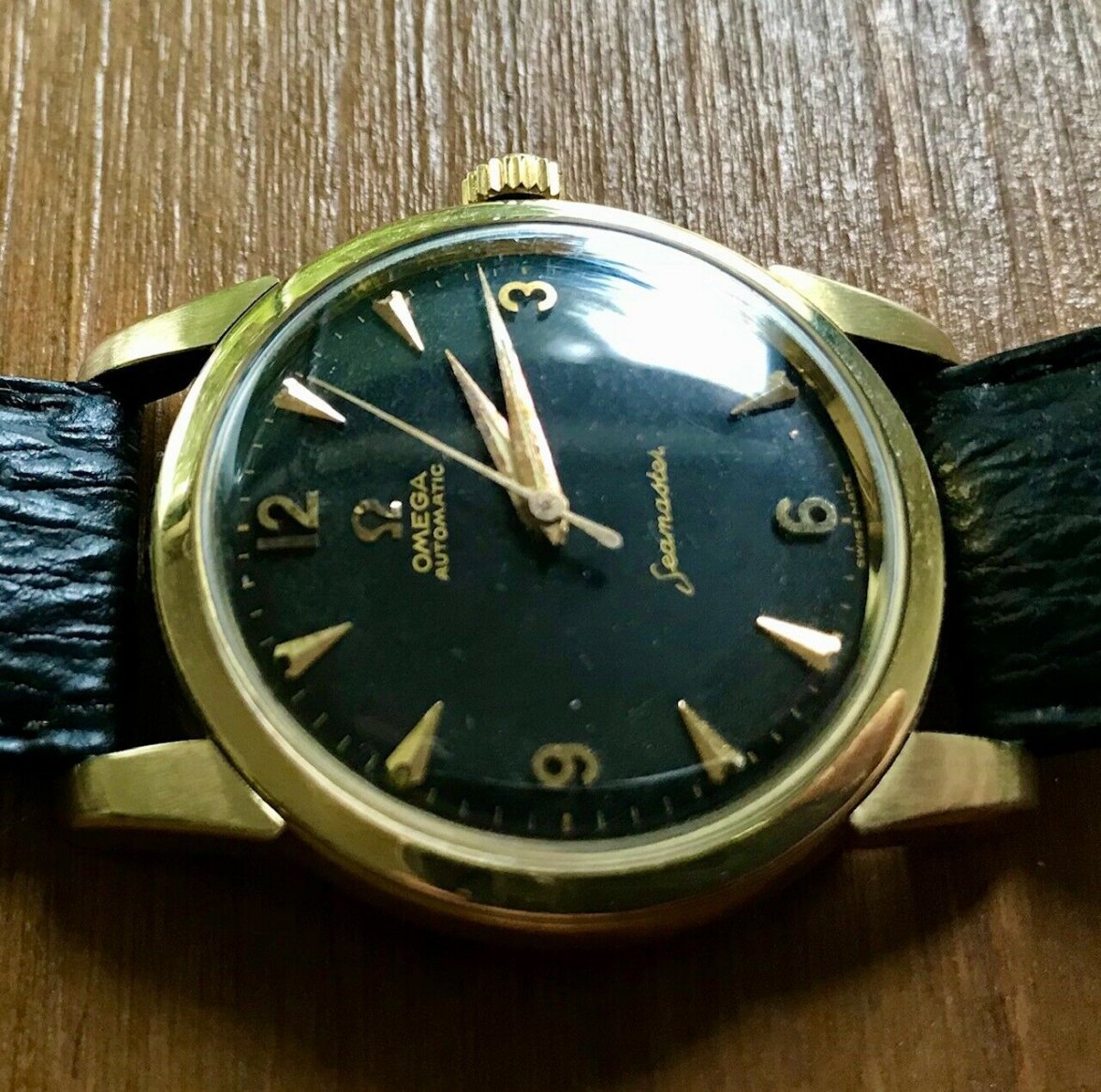

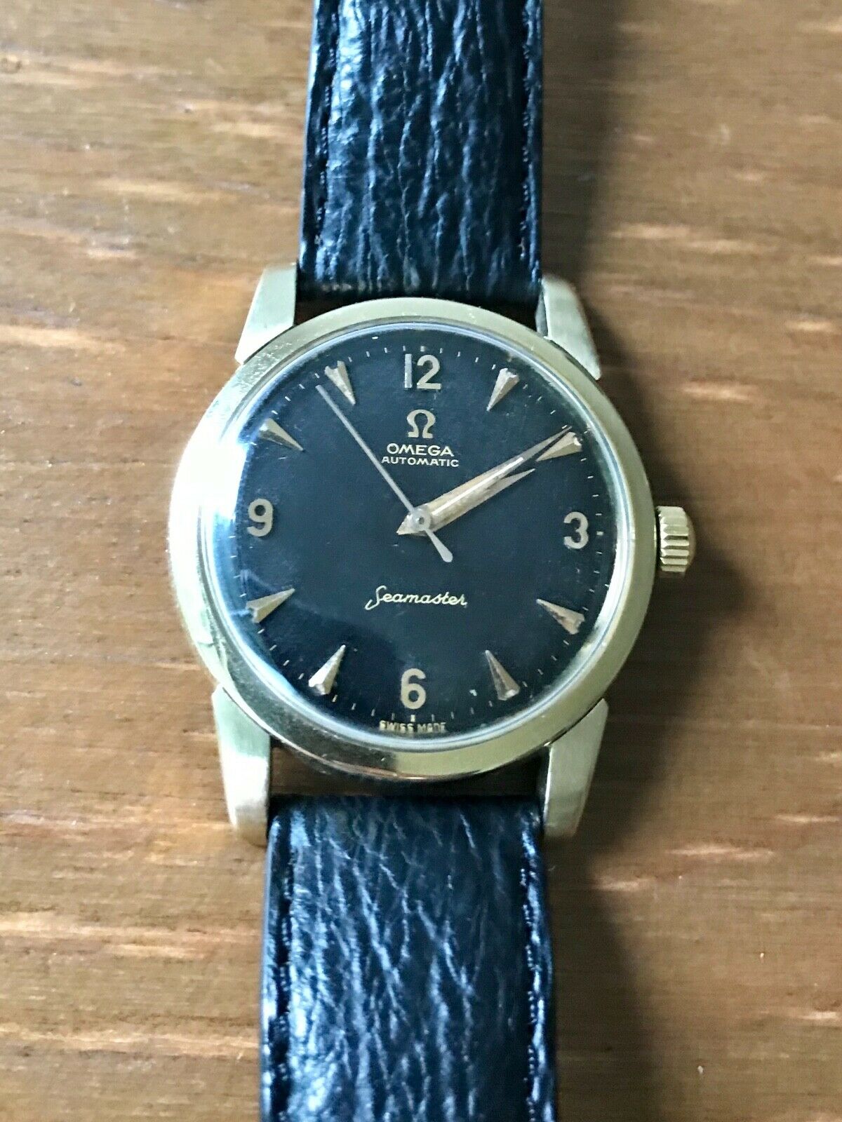

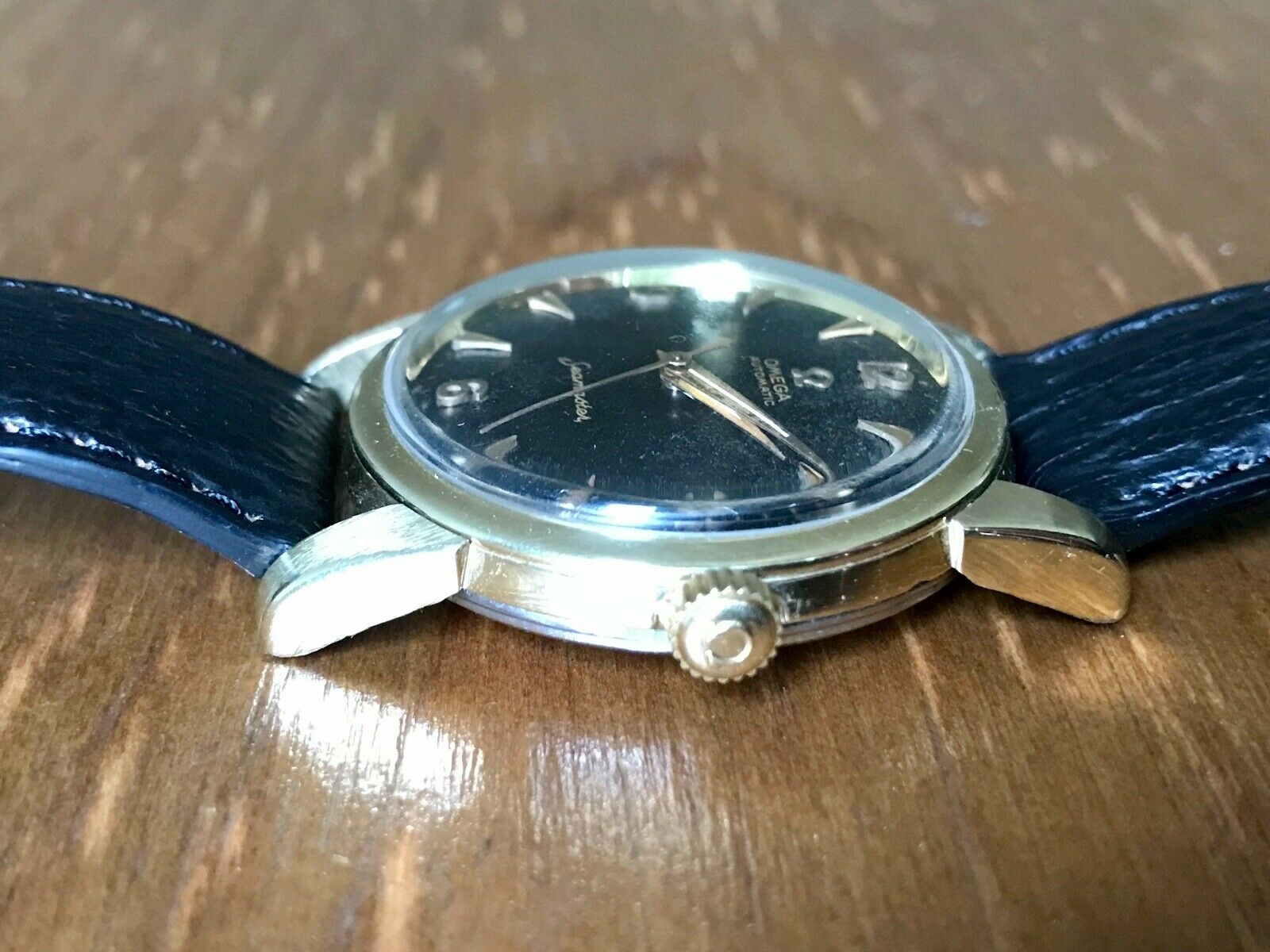

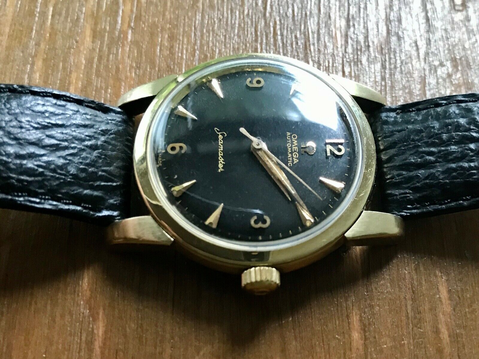

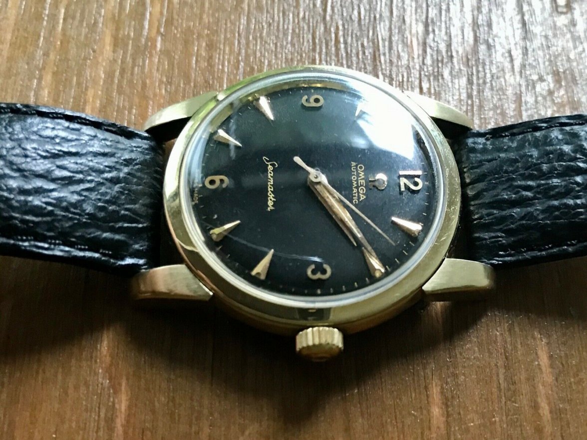

However I find myself slightly drawn to Batchelorette number 3:
but of course this might also be a redial but this movemnt seems about right.
What do we think of her?

The first 2 are non contenders. The third looks good to me. The sweep seconds hand is an incorrect replacement

I think that Batchelorette #3 isn't a ref. 2503. 😕
no you're right the 2503 was supposed to be the first one. Bachelorette number 3 is something else altogether

At first glance I thought of a 2846-2848. But that would be too easy, right?
Edit: Just in case I got you wrong and this is not meant to be a guessing game, but asking for opinions on a watch you intend to buy, what are your concerns? Any more and better pics?

Whilst I"m not absolutely against repaints and redialled watches I"d like to try and buy original ones. I don"t seem to have the eye for it like others here unless it"s really obvious like in pics 1 and 2. If pic 3 get s a general thumbs up I"ll take a further look. There are some more pics but It is priced on the steep side of what it is. Just like to know I"m on the right track...

There's nothing that screams "redial" to me and there appear to be lume staints on the markers, which would be uncommon for a redial. On the other hand, this lume looks pretty bright. Well the photo is bad and there are a lot of reflections...
In addition to the sweep second, hour and minute hand don't look correct to me as well, they seem to be too long.
I have the feeling that I would need better pictures of this watch, especially the dial and that I'd like to see case ref. and movement serial # as well (you most likely checked this already), before I decided to go ahead.

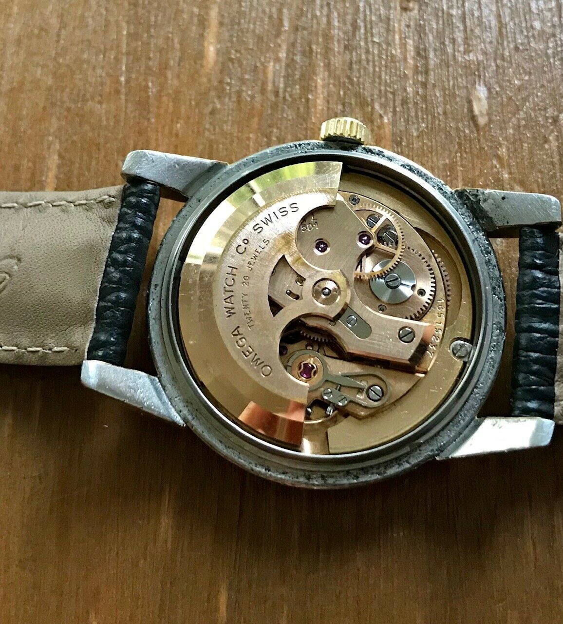

Did you see the corrosion on the case and under side of the lugs?

# 3 looks ok to me, only the seconds hand (as mentioned above) and the crown seem wrong. Should be a 2846 (again, mentioned above).
Maybe a bit of pitting at the back?

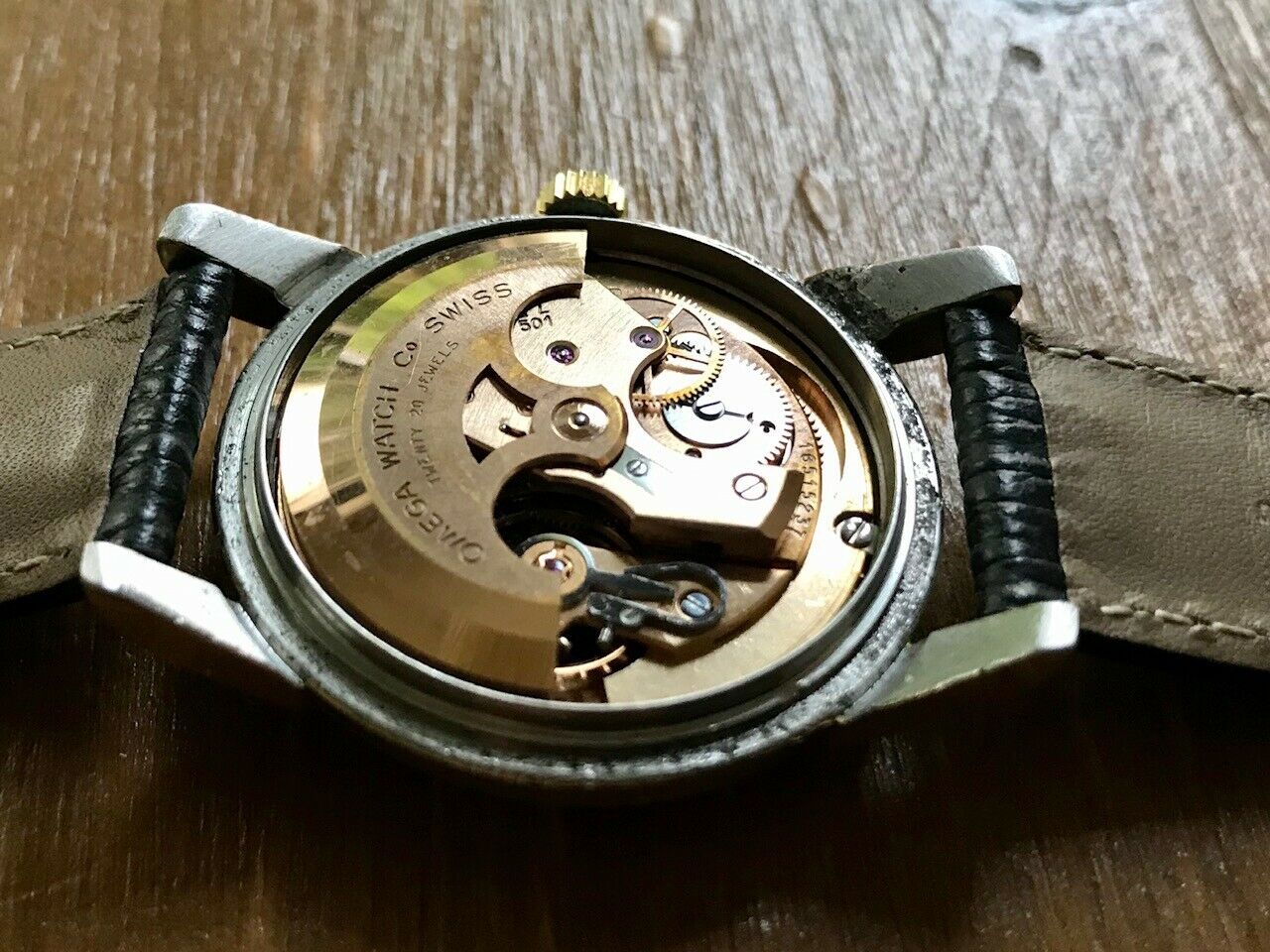

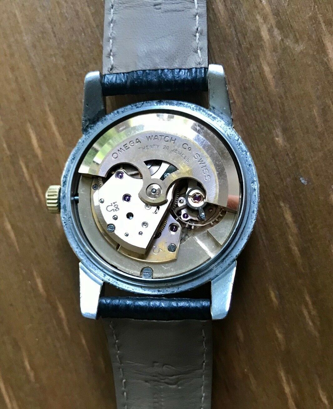

Doesnt number 3 have some severe rotor rub issues?

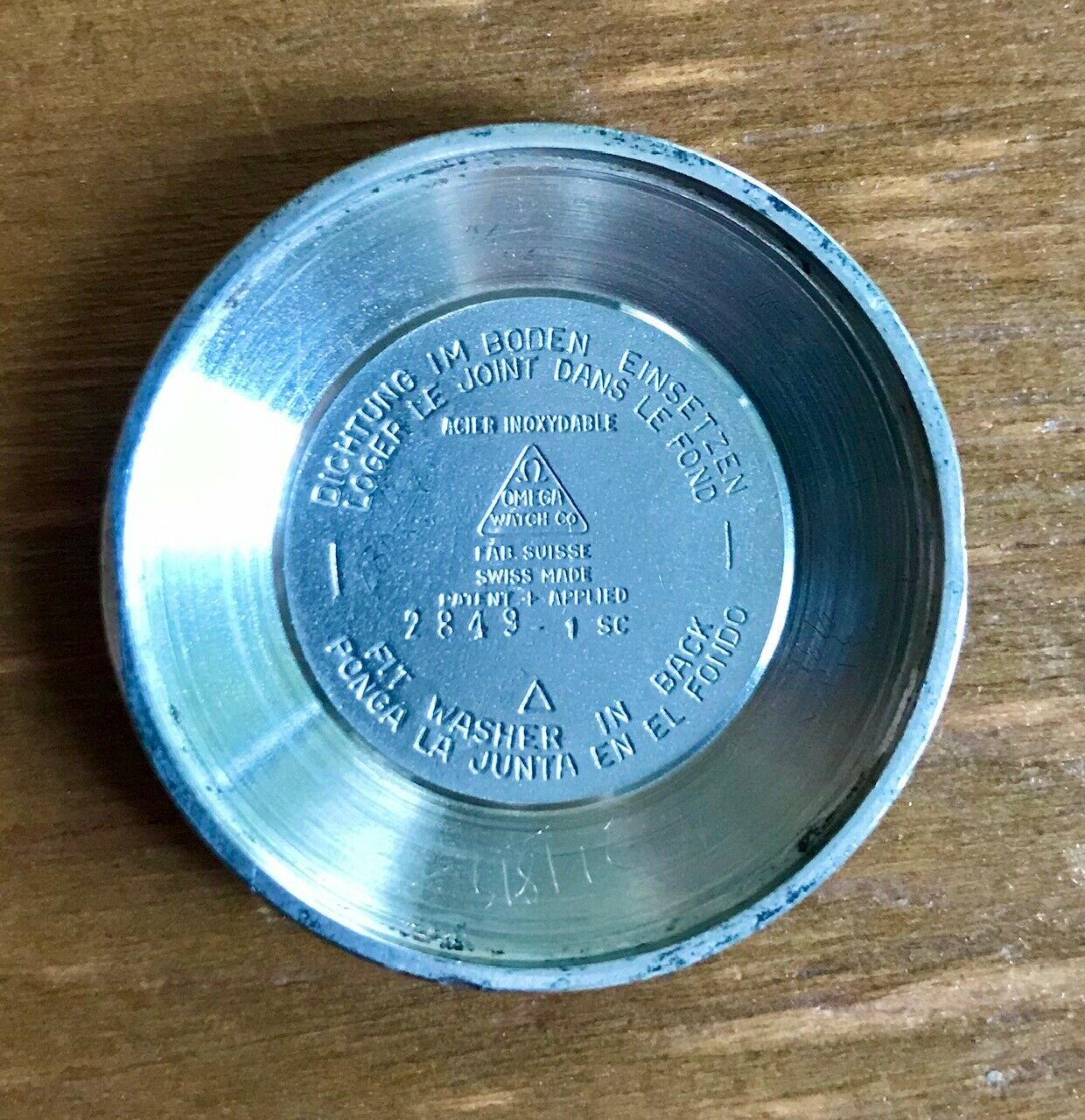

do you have a photo of the inside caseback?
343
1,008
The case back is wrong for that watch. 2849 have a calendar and cal 503.
